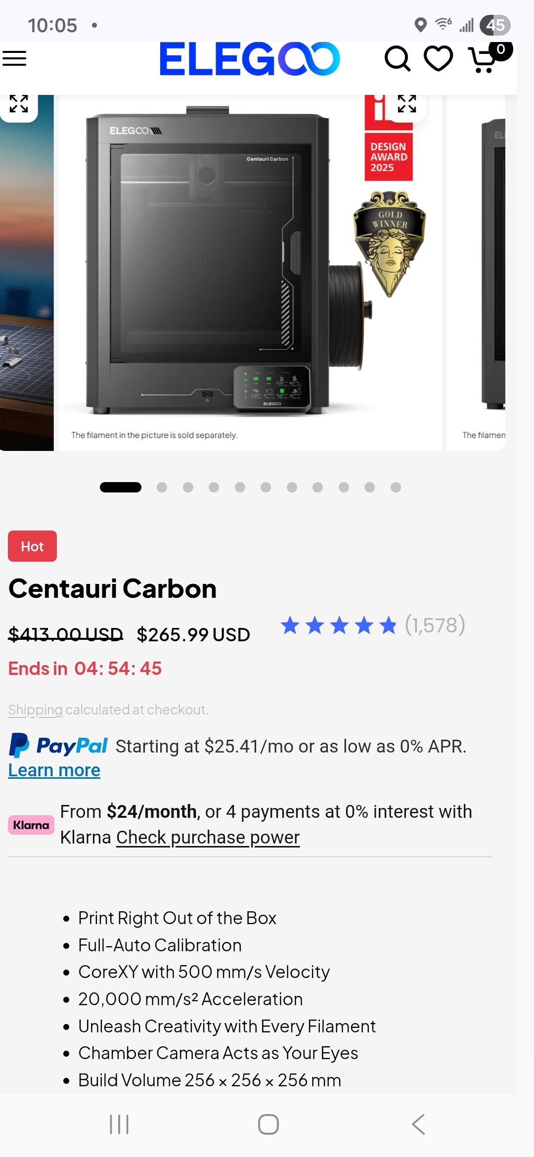

I bought the Elegoo Centauri Carbon. It rocks an enclosed housing. Runs a 256mm cubed printing area. I got the stabilizer feet and a replacement 0.6mm printer head extruder.
Here is a screenshot of the machine and info on it as well.
Supposed to be able to print right out of the box. I will look into repairing the other machine, but will take my time on it. The new machine will get most of my attention at first.

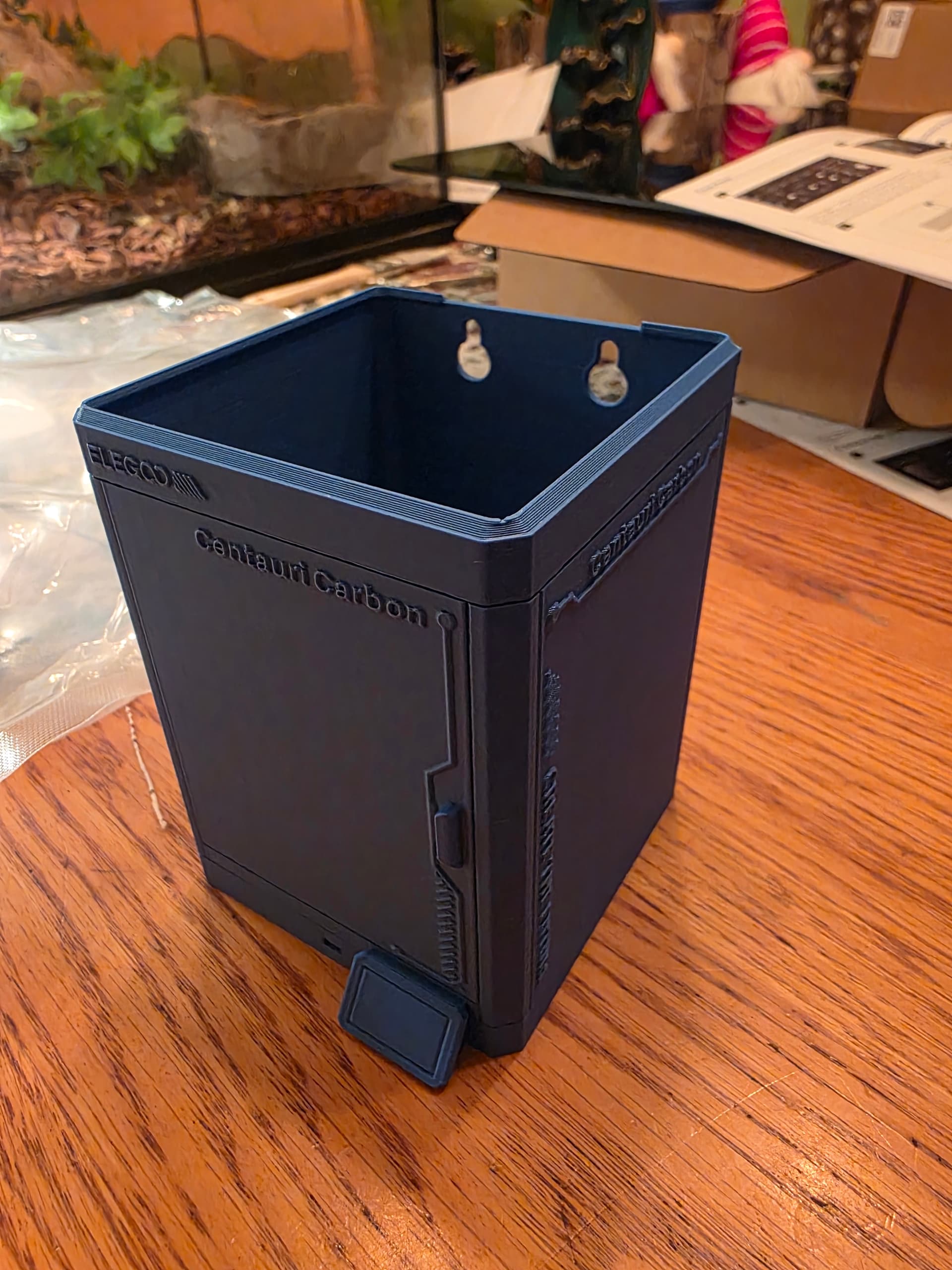

Printed the filament trash bin for the machine as well.
This mounts to the back of the machine to catch the squeeze of filament cleared from the extruder.
