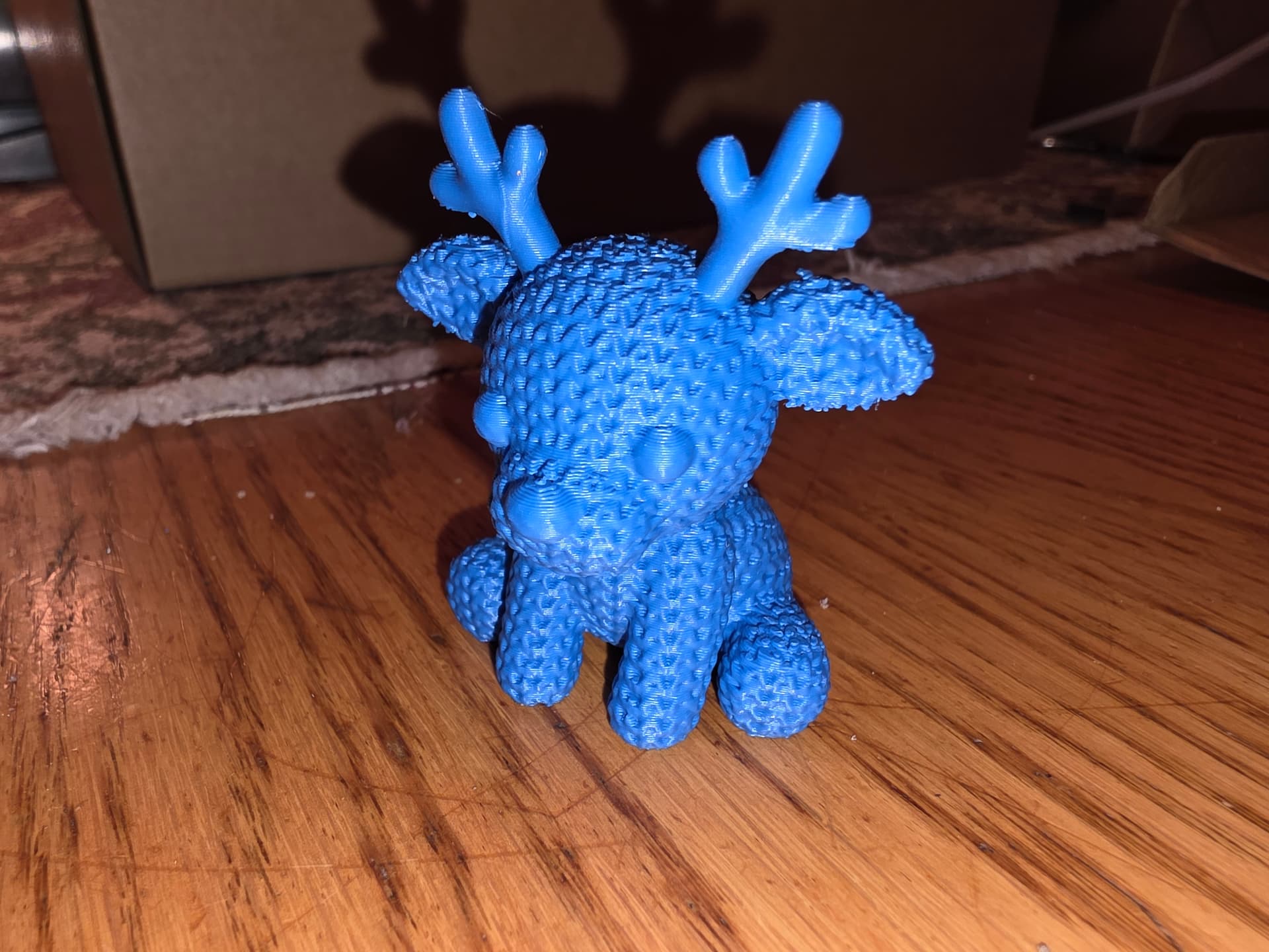

A yon better then the other printer.
The deer came out good this time.

I was going to ask if you were going to try and reprint the Reindeer! What a difference!
I am way ahead of you. Lol. I printed benchy as the first print of this new machine. Then printed the extruder waste bin. Then I printed the reindeer because it was supposed to be a gift to someone. Then I printed 4 triangle pyramids that sit under pieces of wood to lift them up off the table so they can be stained, poly, or painted on the whole edges without worry of stuff getting on the table, or making the wood stick to the table after drying.

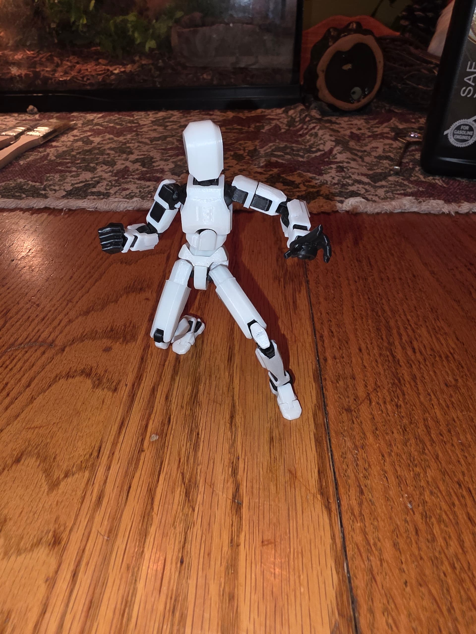

Decided to try my hand at this print and I liked it the way it came out.
All.of the parts are printed off individually and then I had to assemble the robot. It is fully functional where it can move and bend at all the joints.
