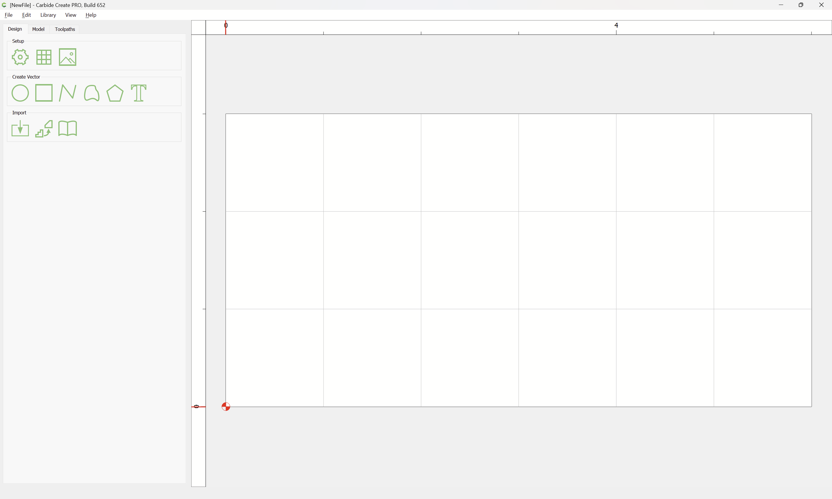

I have brought this up before but, I can’t fine the messages relating to it but, I have been using V7 for the last couple of years. I was using it today on a project that took over 7 hours. It all worked fine and saved with no issues. When I returned to it a couple of hours later the file I created in V7 would not open in V7 nor will my other files. I’m trying to work out how I can convert the files from V7 To V8. In V8 all the Modeling’s components have gone. Any advice would be very welcome.

Not certain about what the problem is here - v7 files created with CC v7 open with CC v7. CC v8 changed the way 3D models were handled & v7 files do not open properly in v8 which means any v7 project has to be re-created(at least the 3D modeling part) in v8.
If your files which were previously saved do not open at all, that suggests a problem with the save location(HDD, SDD, network, cloud) & that the file data is either corrupted or simply not there - which would really suck.
Note that most modern OSs afford a file versioning/backup option — if that is enabled, one can right-click on a file and check for previous versions.

I have spent a lot of time trying to work out what the issue was and it appears that another glitch has caused the problem.
On the surface, everything seemed to have worked fine during the making and saving of the file but, it appears that a glitch, or bug, infected both the file and the V7 program at the same time.
I have deleted and reloaded the V7 download and as soon as it appeared to work super fast in comparison, I realised that it must have been a bug. Where the bug lay is a mystery, whether it was with CC or my Laptop or Windows I don’t know. The modeling’s of the files were lost but the vectors are all intact. It just means I have to redo all the modeling components for a number of files.
