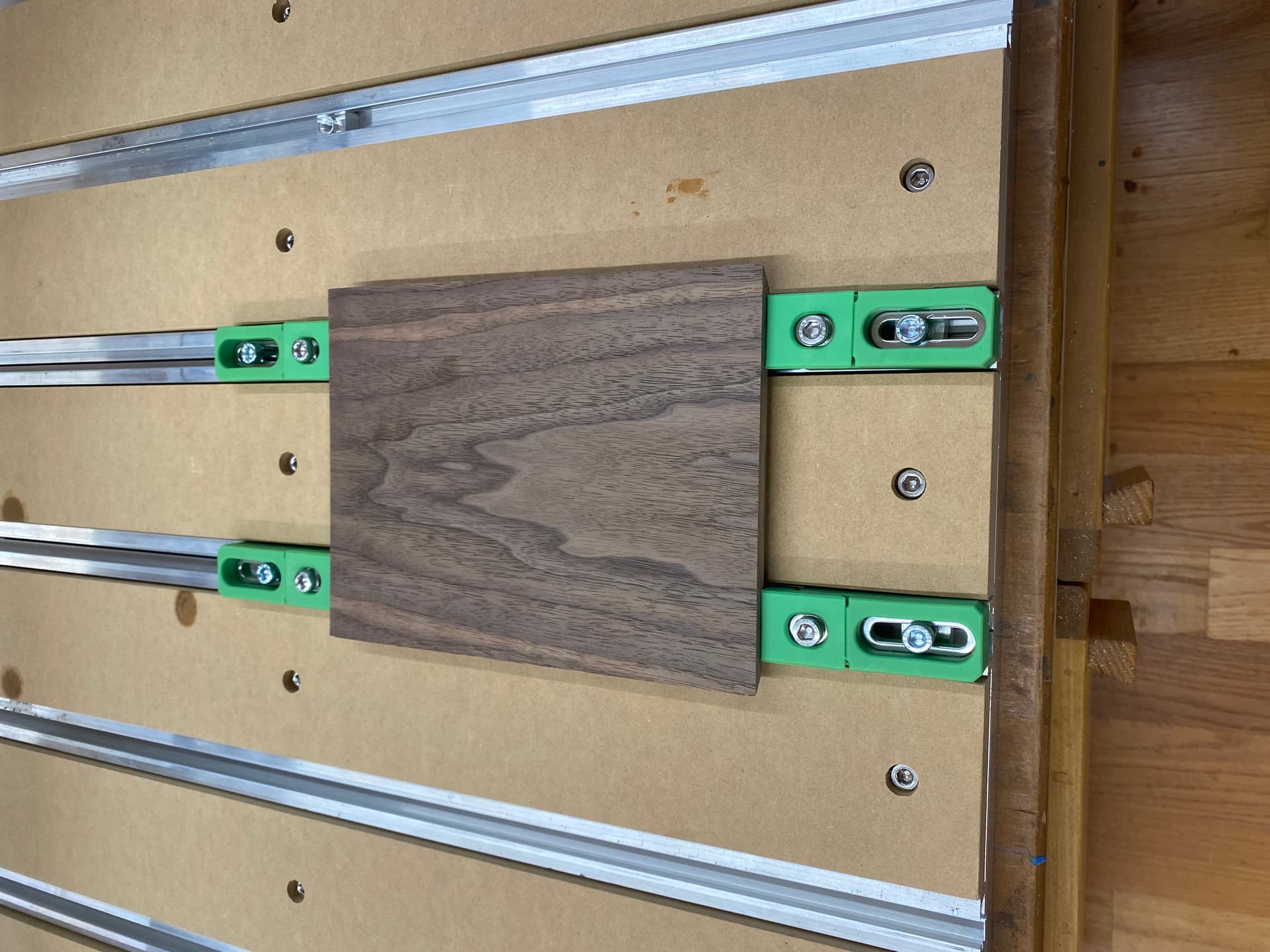

My hats off to folks that have mastered the Carbide software. The learning curve is steep. I’m trying to engrave an urn for my father-in-law’s remains. Set it all up in create, created the necessary tool paths then ran it on a test piece of Walnut. Looks fantastic! Papa would be proud. I replace the test piece with the proper piece (from the same board, same thickness) I set the x,y and z axis and then run the same G-code. This time, it engraves the air, never penetrates the wood. At some point in the many tries I realize the front view is showing me that it is above the stock. But I’m not seeing anything wrong in either the configuration or the zeroing process.

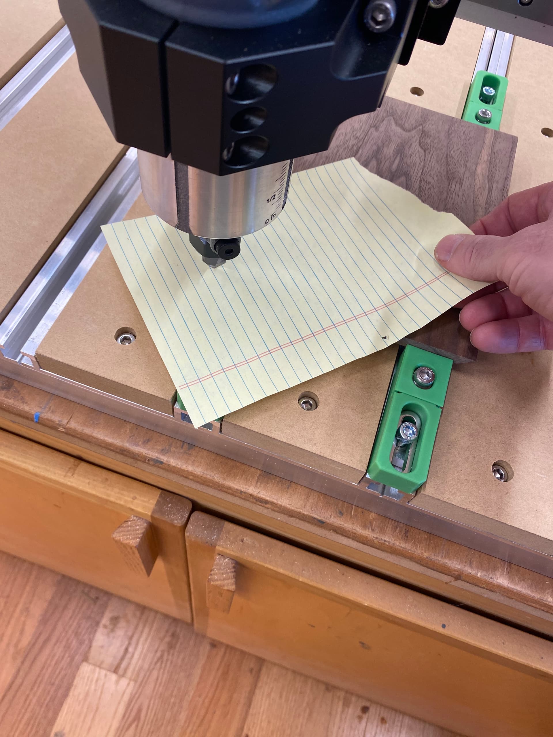

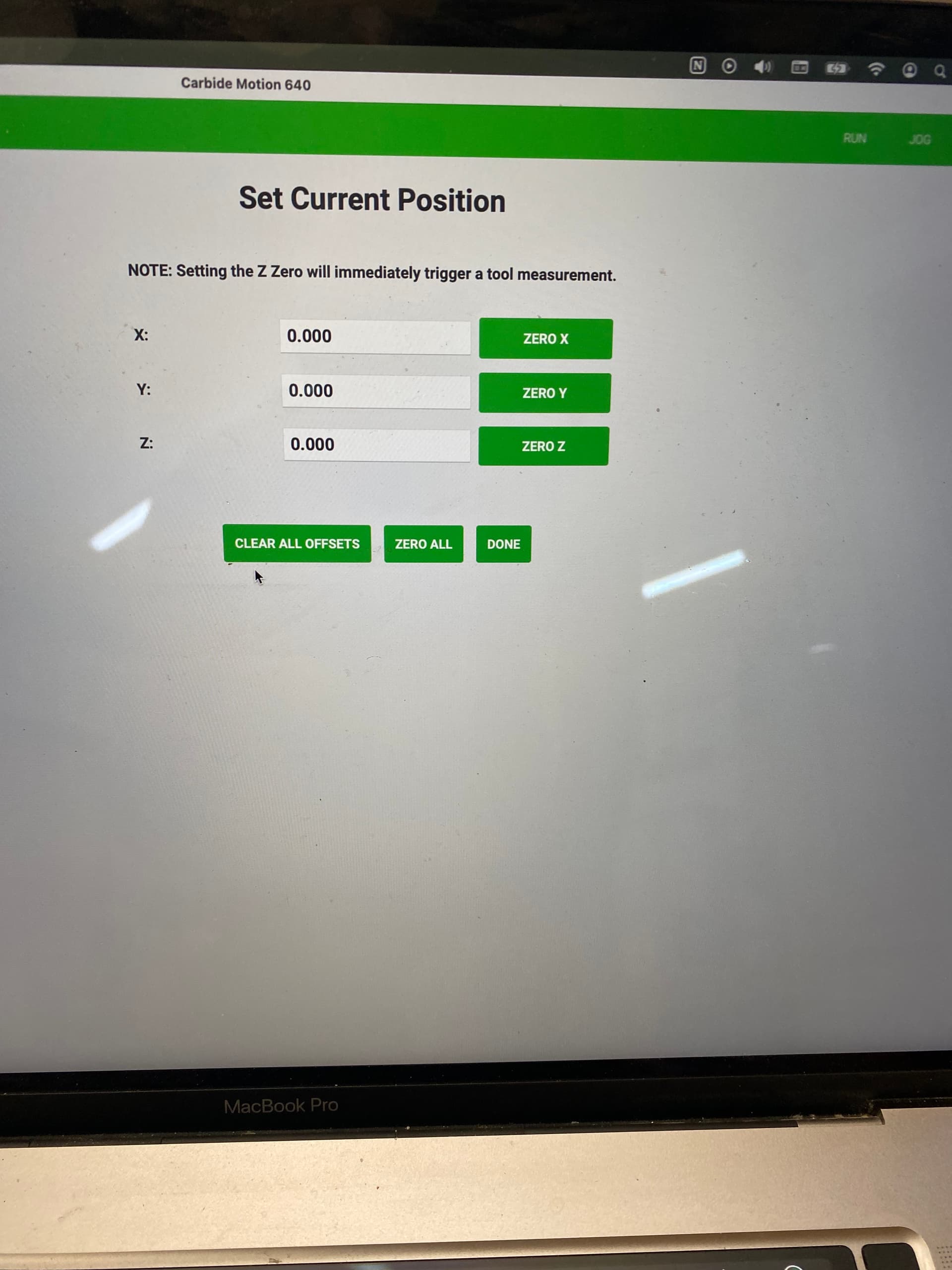

Here is how I’m setting up the job.
Load a New File
Open the Jog panel
Set Zero/clear all offsets
Done
I use the paper technique to find x somewhere on the board and Set Zero.
I then move to the lower left corner and set zero on x and y. I don’t do z at the same time because the paper trick doesn’t work on the corner. (I did try it that way setting all three at once but so no difference in the result).
I jog the machine to x,y,z in Rapid position to verify the settings.
I start the job,
The machine goes to the BitSetter and does it’s thing, then I turn on the spindle and the machine starts to work.
I’m using only one endmill, so no tool changes or resets for this project.
I’ve upgraded your account.

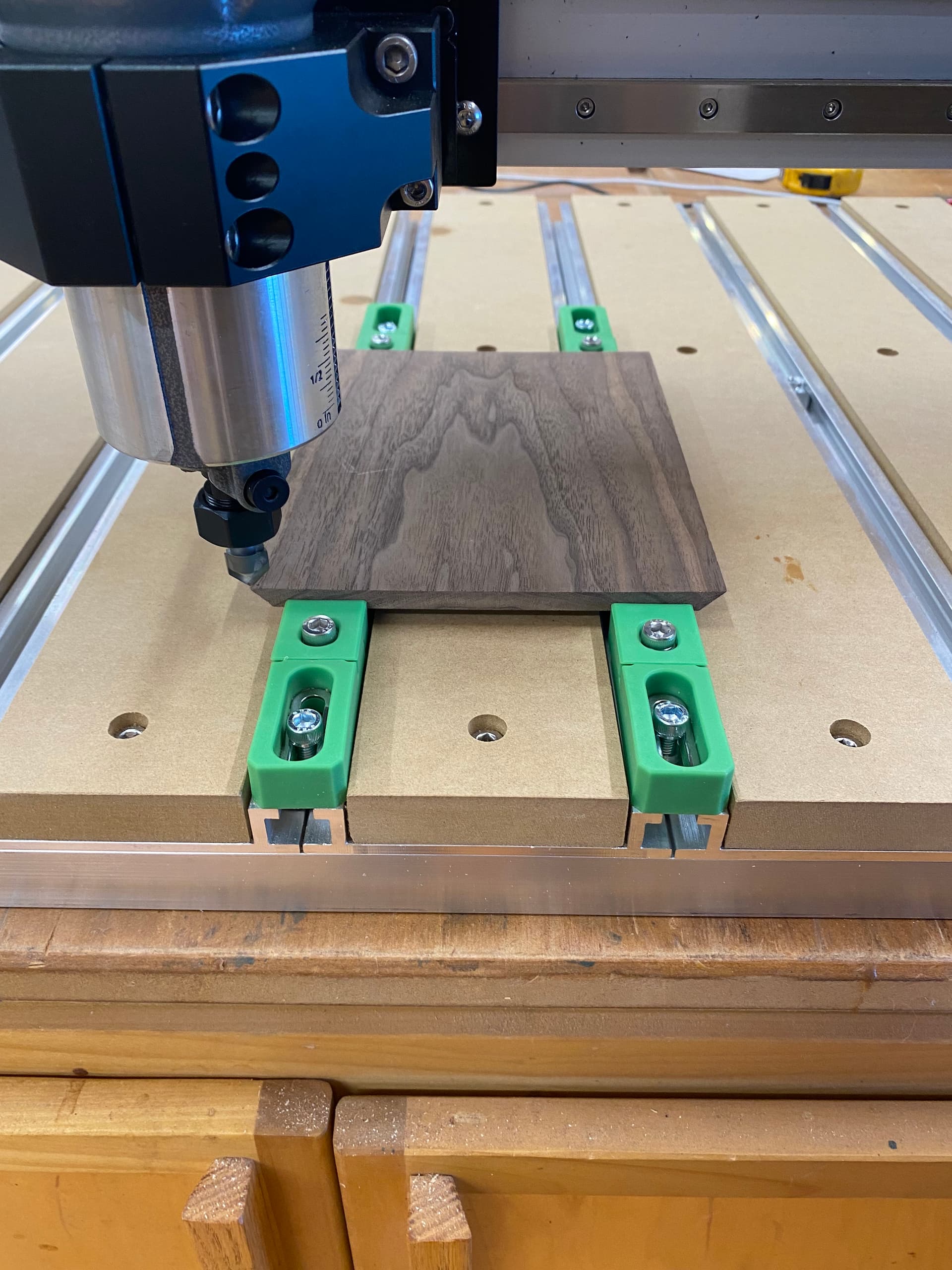

Please post a photo showing your machine at the zero position relative to the stock and screen grabs showing what Carbide Motion shows when at that position for both Position and Machine Position (click on either to toggle).
The thing that stands out is the “clear all offsets” statement. I think the only reason to use that is when resetting the bitsetter location.
The way the bitsetter/tool length offsets work it needs to measure the initial tool you use to set Z zero. Then you set Z zero, then when you run a program it measures the tool to determine the offset compared to the initial tool.
Try your process without “clear all offsets “
Thank you Todd. That is essentially how I started, I wasn’t using that at all and was having the “Air engraving” problem. It was an exchange with AI that caused me to introduce that step. But I will try it again with out that this morning.
Here are some photos Will.
I sort of got this to work, but I couldn’t tell you why.
Here is what I did differently. Per Todd’s suggestion I eliminated the “Clear All Offsets” step.
  • I modified the engraving to go a bit deeper into the wood, to 2mm
  • I modified my Z-axis setting a little. I lowered it until I could slide the paper while just leaving an impression in the paper - as instructed - and then lowered it just a wee bit more.
  • I set the, x, y, and z to zero individually. Rather than using the set all.
I can’t see that any of these would account for the problem I was seeing and I did see it happen again even after I made these changes on one occasion, but I managed to get it to work on 3 of 4 attempts. And more importantly, I was able to finish the Urns.
I’d still love to understand what I’m doing wrong.

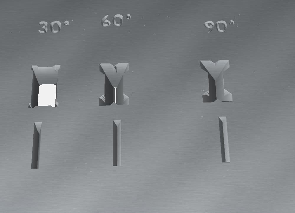

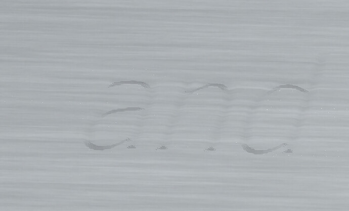

I suggest running a sharper Vbit. IE 30 or 60 and setting the depth to “t”.
The Vcarve toolpath will automatically calculate the max depth of the carve based on the width of the vectors and the angle of the tool.
For comparison:
90 Degree:
60 Degree:
30 Degree:
I hope you can see from the photos how the 90-degree angle is very shallow compared to the other bits.
If you read the G-code, you will see that for the 90-degree Vbit carve, your deepest cut is -0.0239" = .6mm deep.
If you read the G-code for the 30-degree bit, you will find it to be. “G1 Z-0.0892 F25.0”
or -0.0892" = 2.27MM deep. Which is about 4 times deeper.

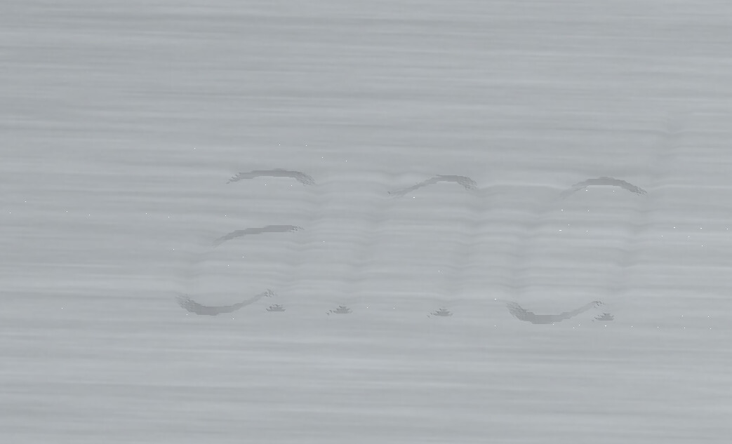

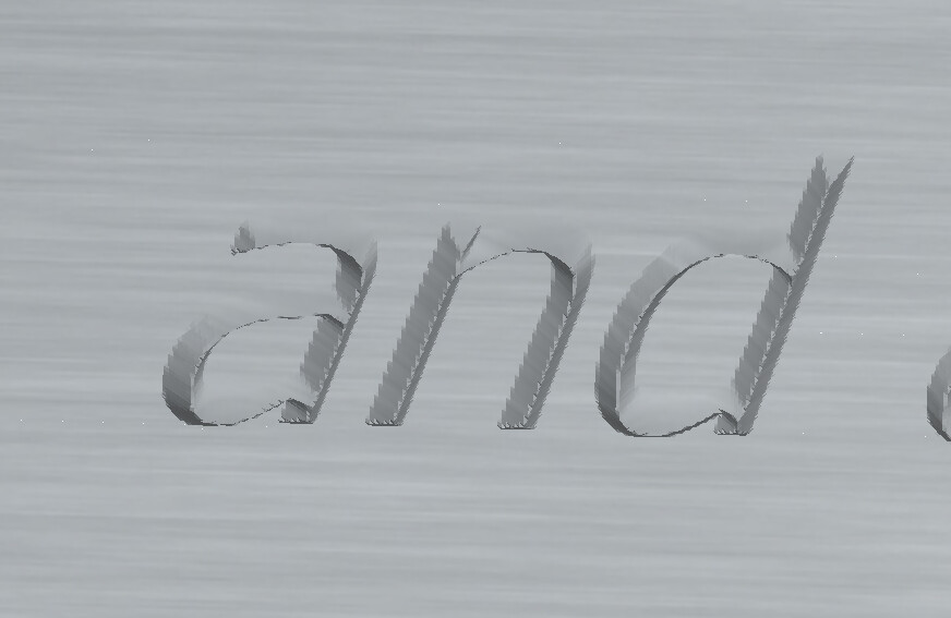

What does the “t” represent? I’m new here, and running a job as I type… my first ever. Having some issues with depth on a V cut, but I figured a way to get it done for now. I need to find the “proper way” when this job is done. The “t” may have something to do with it.
The “t” is simply the value of your stock thickness as you measured it and entered it into CC when setting up a project.
My read on Anthony’s suggestion of using “t” was different.
My understanding was that the VCarve toolpath will calculate t based on the bit you are using and optimize the depth for that bit.

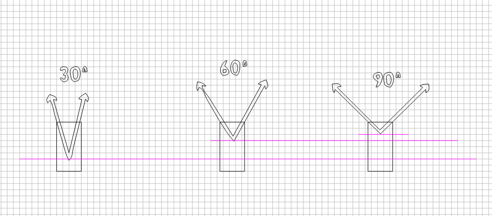

t represents the thickness of your stock. Ie, if you run a profile/contour cut and use t as the maximum depth, it will cut through the piece.
Using t on a v-carve does the same thing; however, the software will calculate the maximum depth of cut based on the tool you select and the width of the vectors.

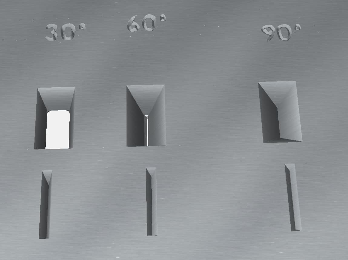

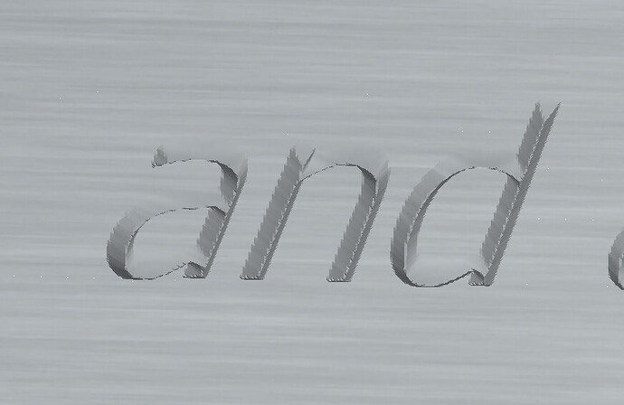

Here is a crude example of what I mean. Each box is 1" wide by 2" tall. If you select “t” as your maximum depth, the software will automatically calculate the maximum depth the bit can carve while staying within the Vector limits. ie, a 30-degree v-bit will carve deeper than a 60 and 90-degree bit.
I created a second set of vectors, each 0.25" wide by 2" long, and you should be able to see that the 30-degree bit extends deeper than the others. You can see how the wide vectors carved through the stock.

The “Dog Bone” shapes are due to the Depth of Cut being “too Deep” for the width of the Bit.
I redid the tool path, but this time I used a 1" width, 30, 60, and 90.
