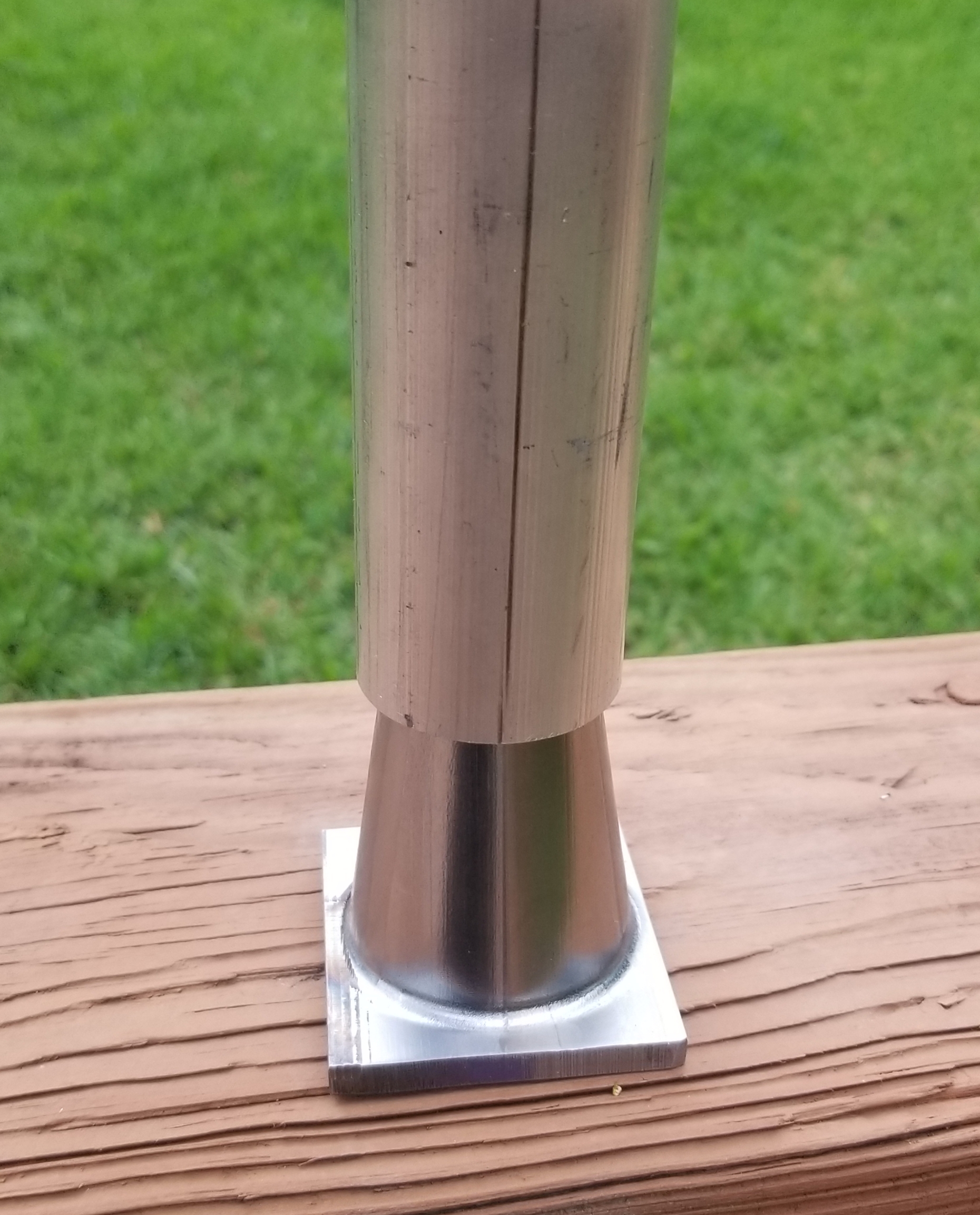

Follow up to the solid steel cnc’d die
Perfect part the first time and hit desired ID dimensions without issues! Cold forging goodness.
Press used was a 50ton custom made*, and the tube started out as 0.125" wall 6061. It was then carefully spot annealed by hand with a MAP torch pre-press and tada, awesome 15° angle to minimize internal flow separation and zero deformation of the tube past the taper.
All thanks to C3D little robots! This job would have taken a decent lathe to do without the Nomad. These parts allow for a much lower cost of materials and higher quality compared to other fabricators out there. Work smarter not harder right :wink:
