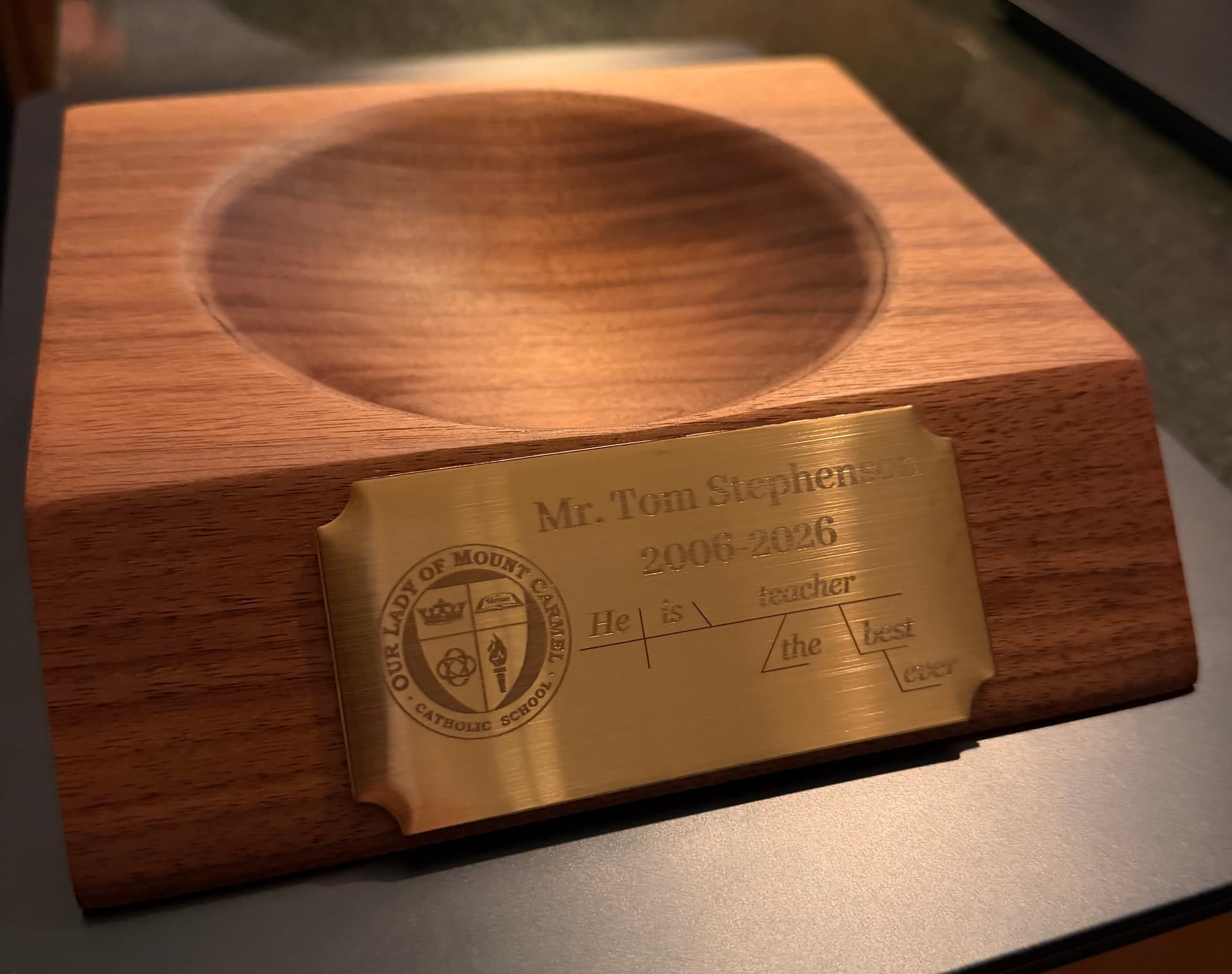

Volleyball Stand

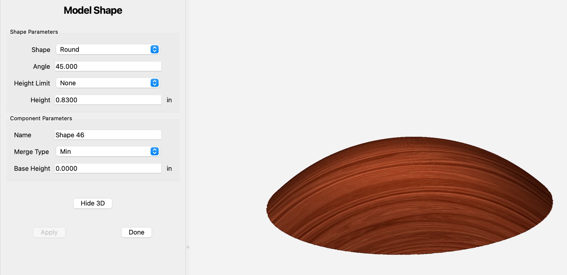

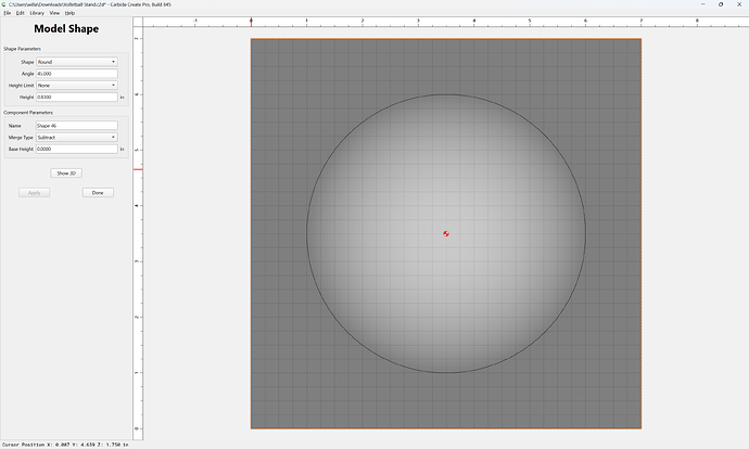

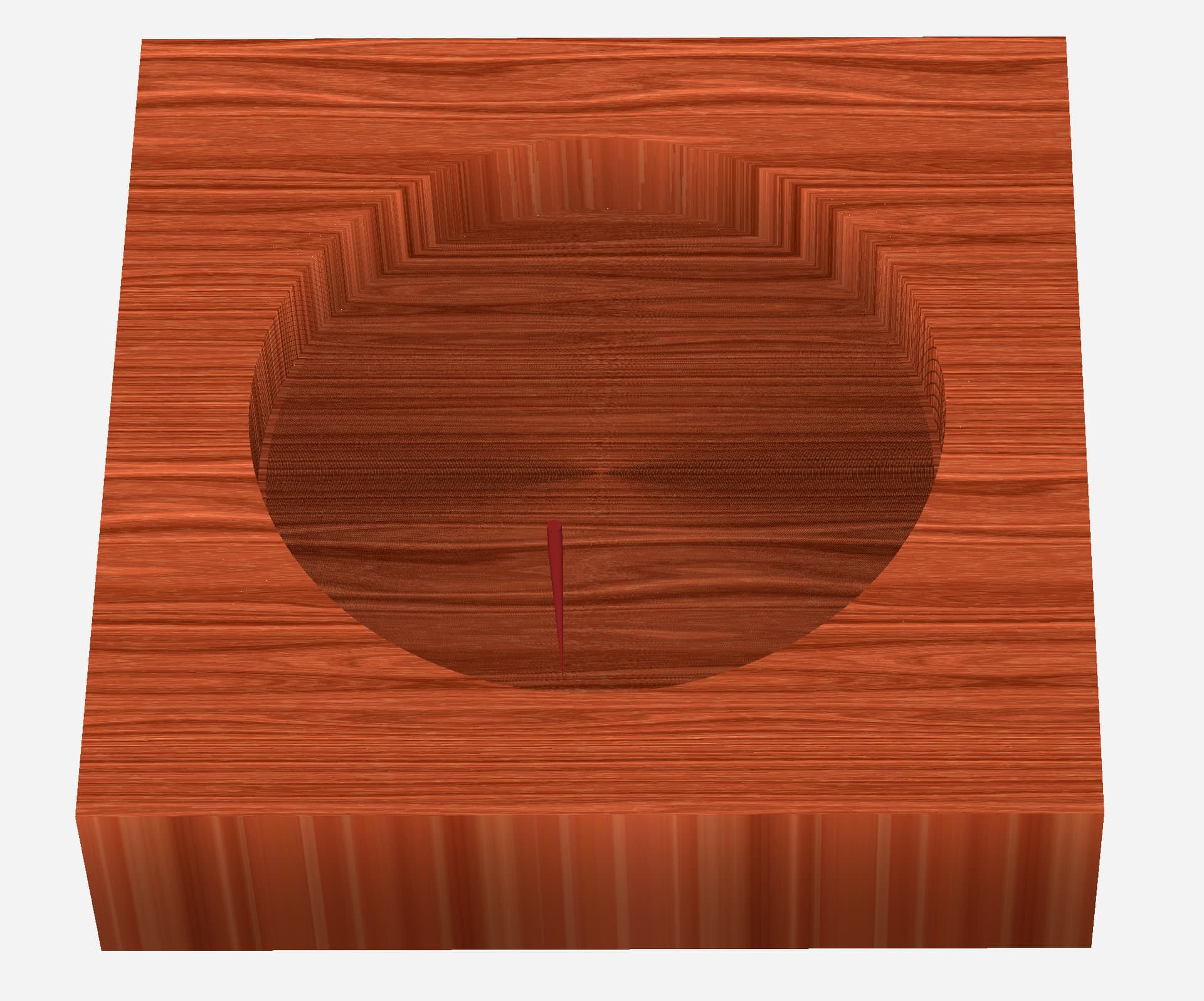

I want to take a real volleyball and place it on a 7"x7"x1.75" block of walnut where the top has a small 5" round “dish” cnc’d into it so the ball can sit. The pocket should be just about .83" deep, so based on the math I came up with using Claude… I may be worn here. The front I will cut with my tablesaw to be on a ~60-degree angle and place a brass plate that I laser engrave with the details of his retirement and service.

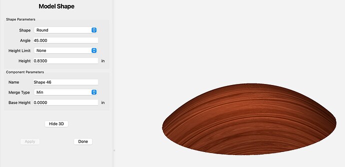

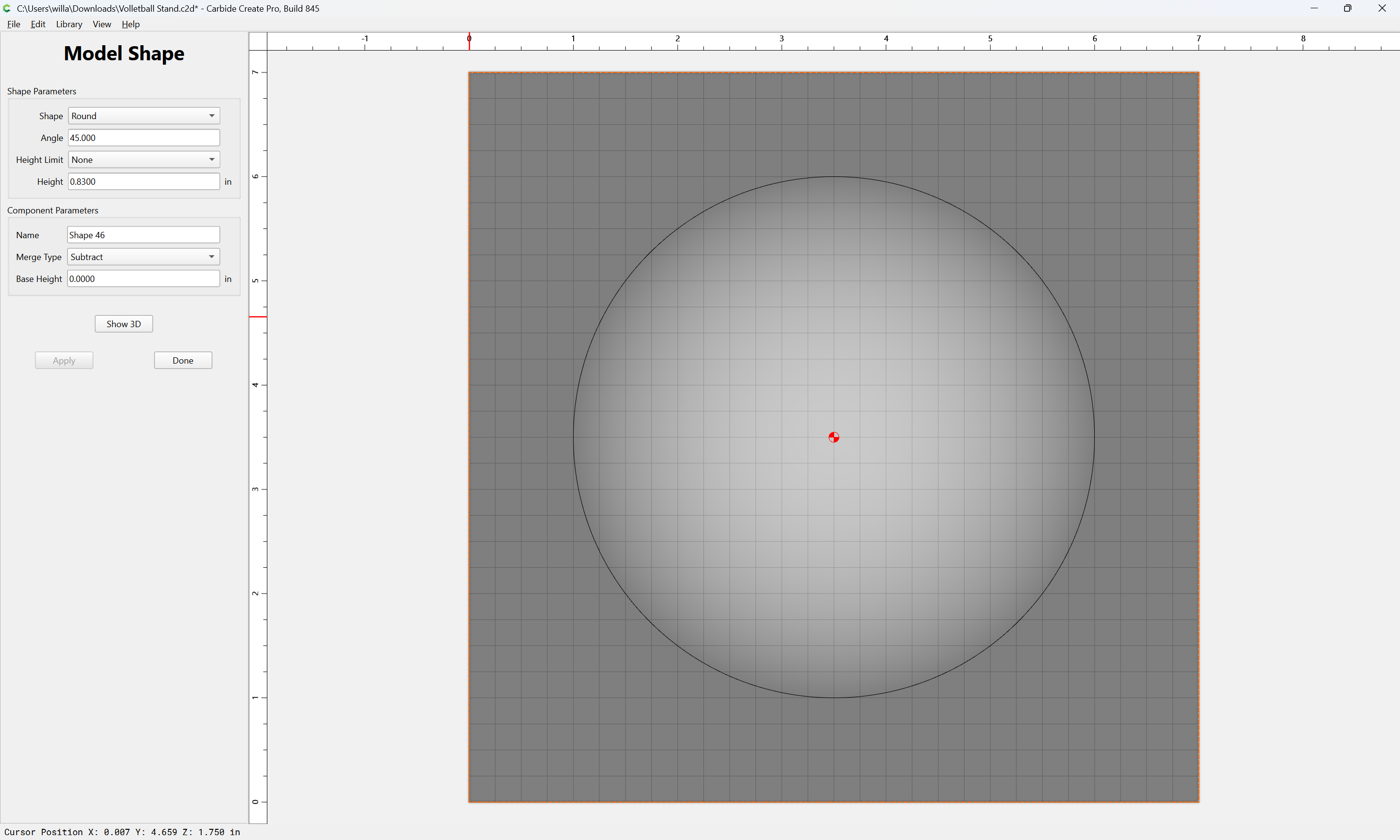

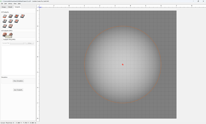

I model the circle and add a round shape using the subtract merge type, but no matter what I do, the opposite of what I want is shown in the preview… What am I doing wrong!?!
Also, maybe it’s just me, but whenever I select “subtract,” it changes to “Min” for merge type.
This is in Carbide Create Pro 842.
Thanks as always in advance!
Volletball Stand.c2d (2.0 MB)

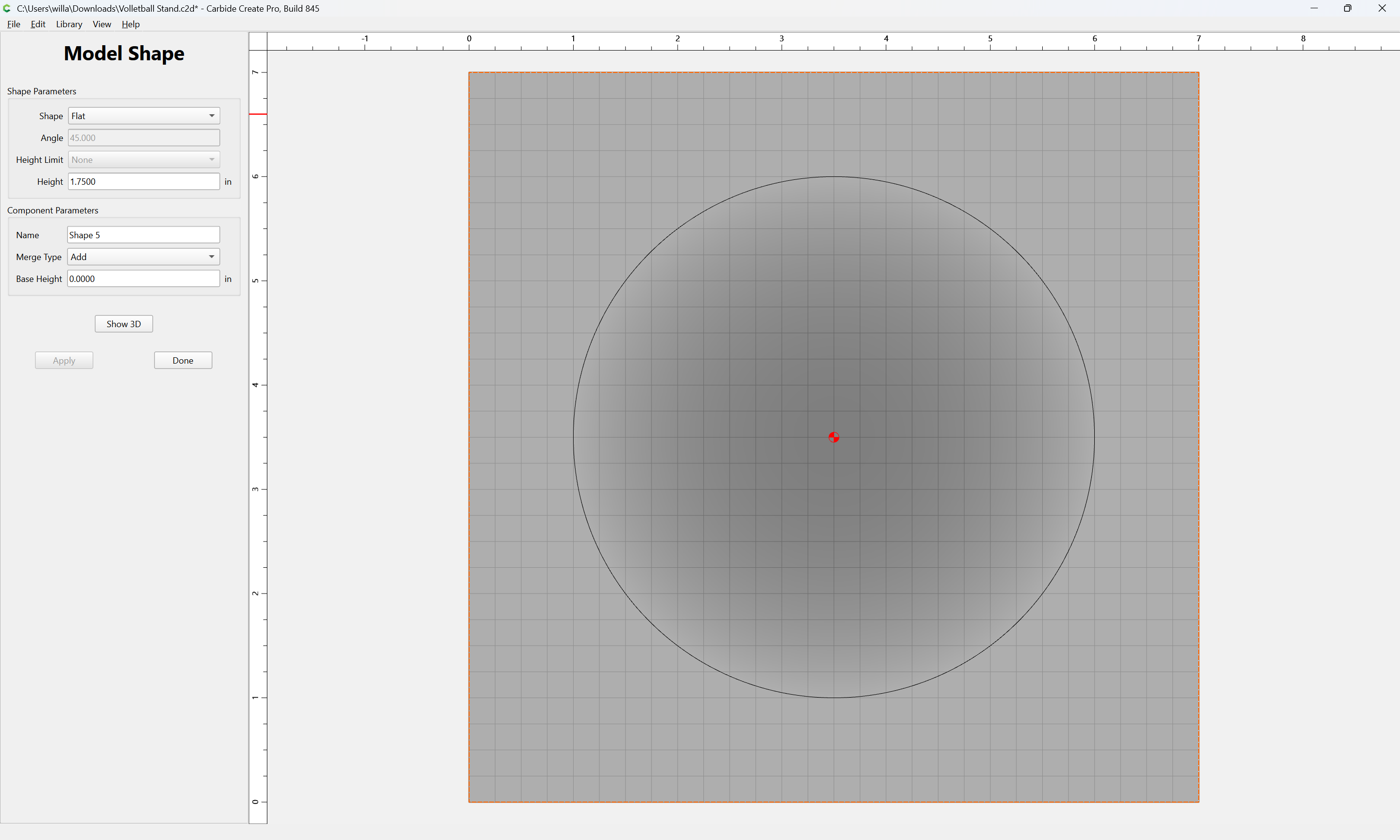

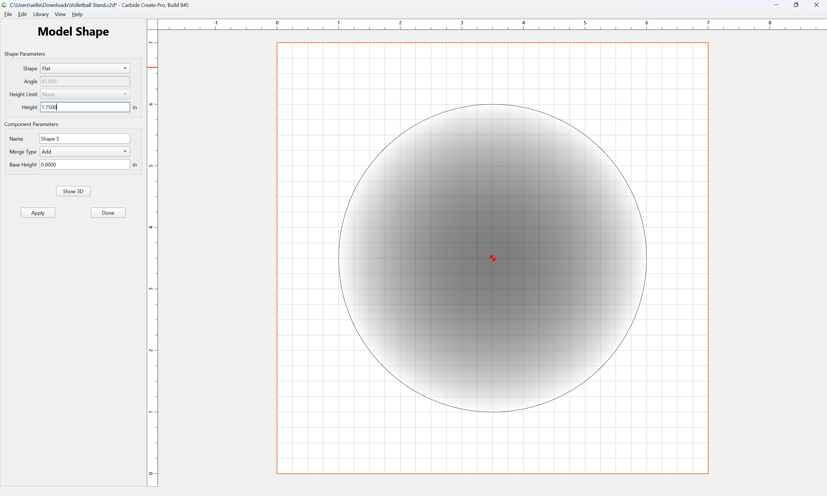

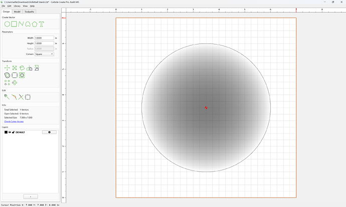

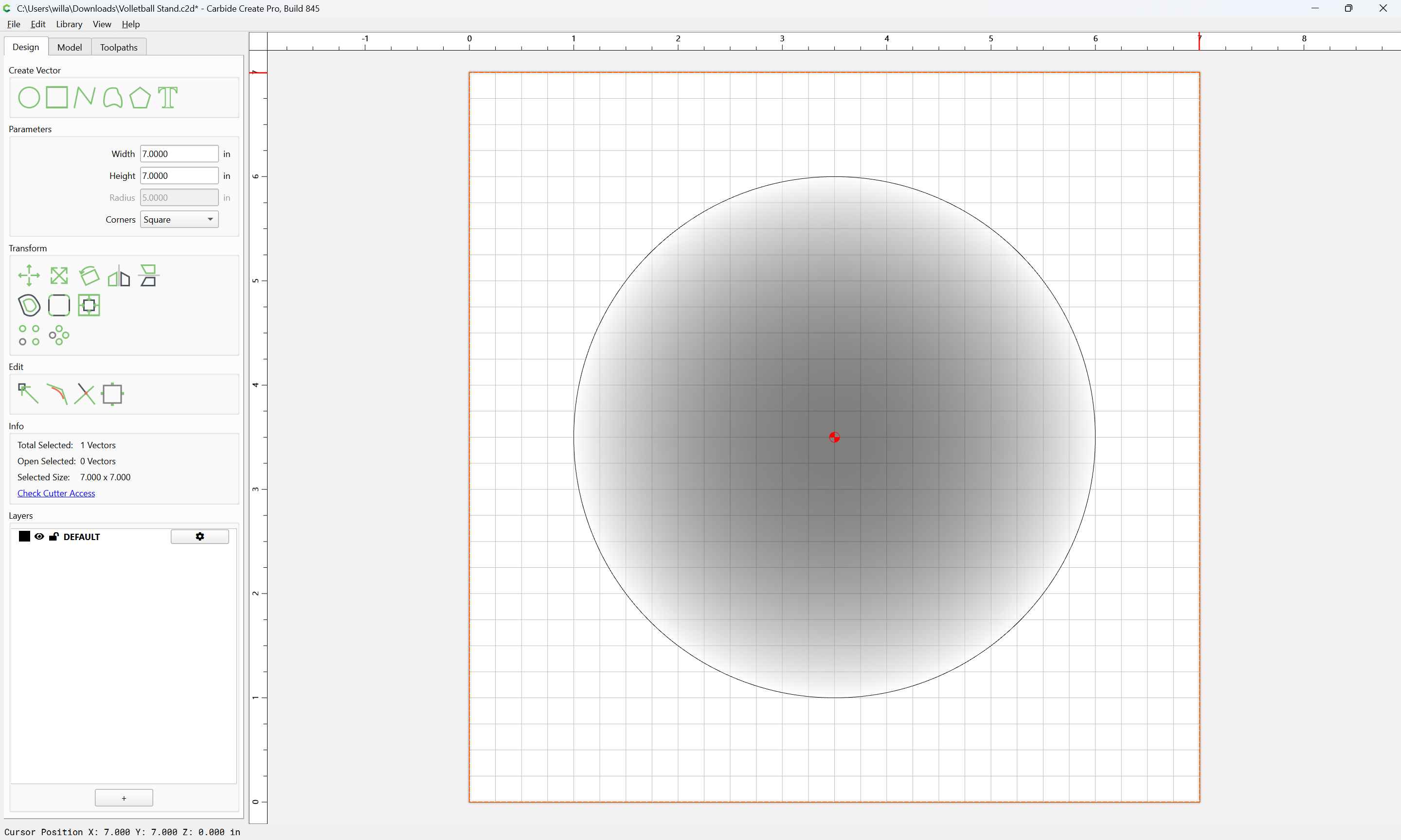

In order to subtract, one has to have something to subtract from:
Apply
Will, you truly are the best! I tried the outline square but did not give it vertical “shape”…
Now on to the CNC to make chips!! Appreciate you!

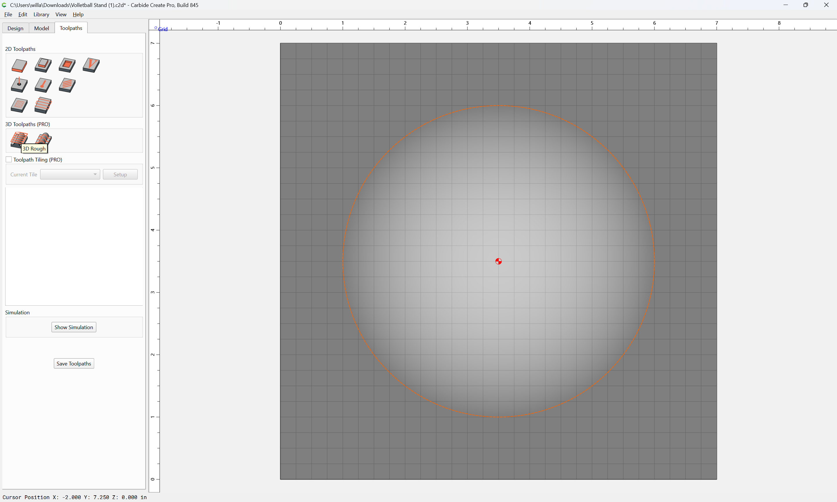

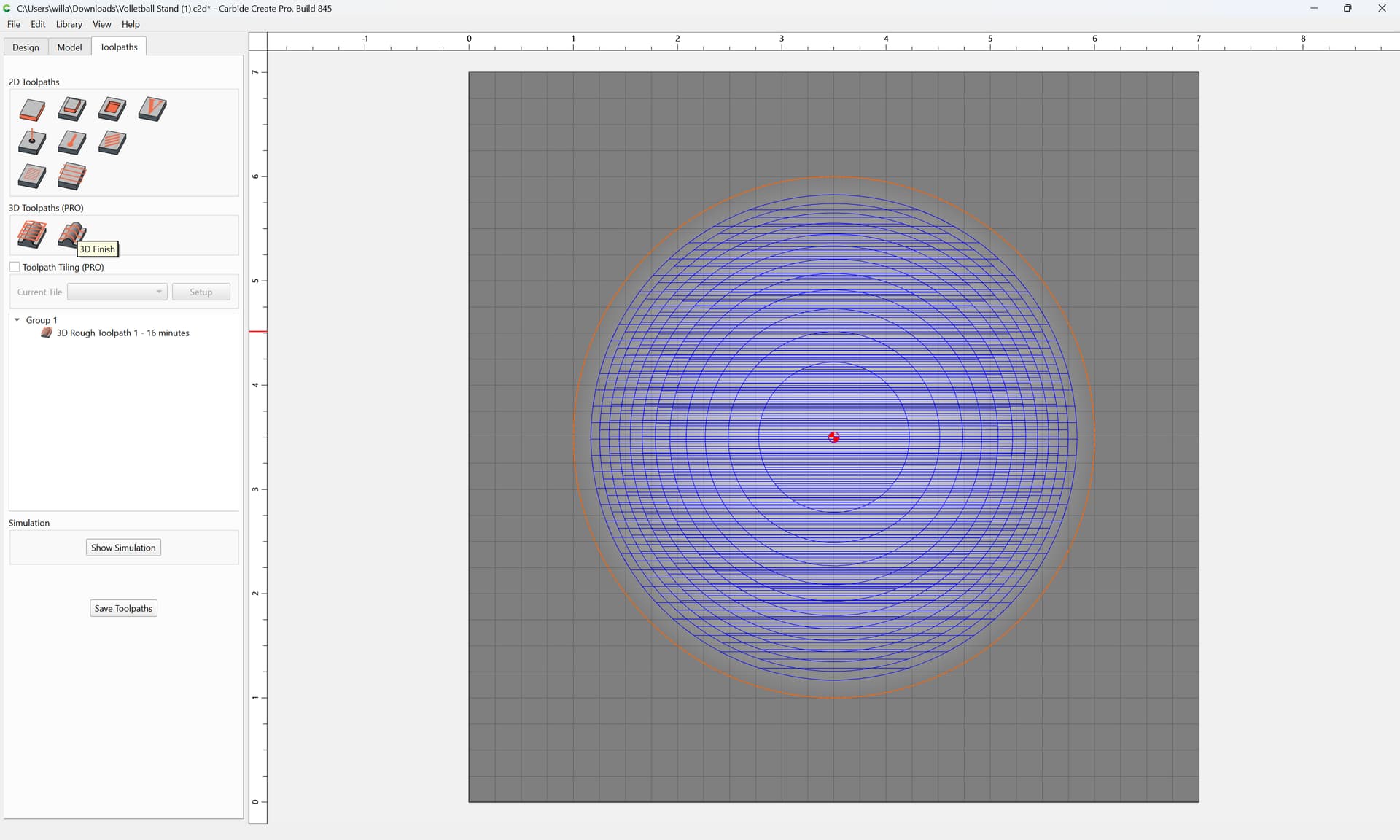

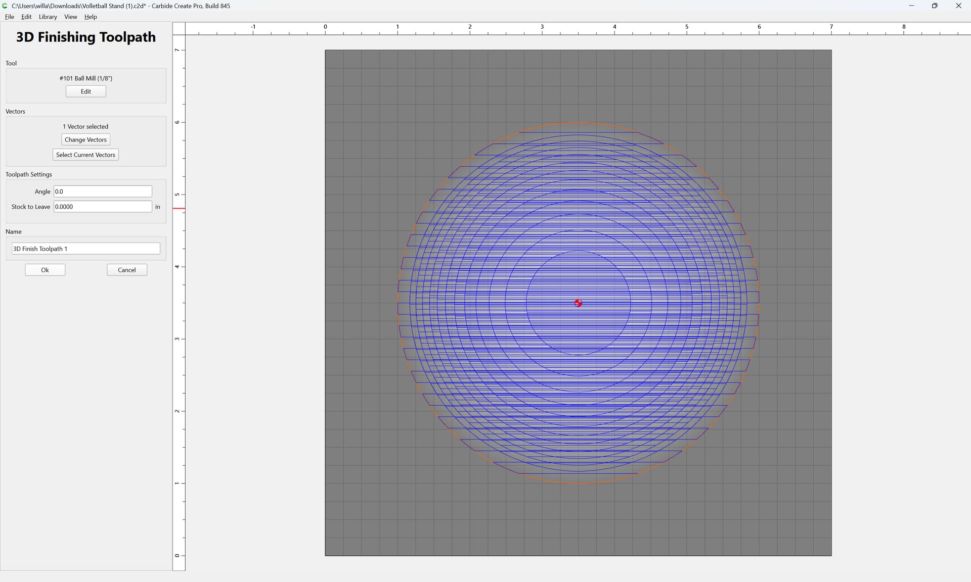

One more quick follow-up regarding tool paths:

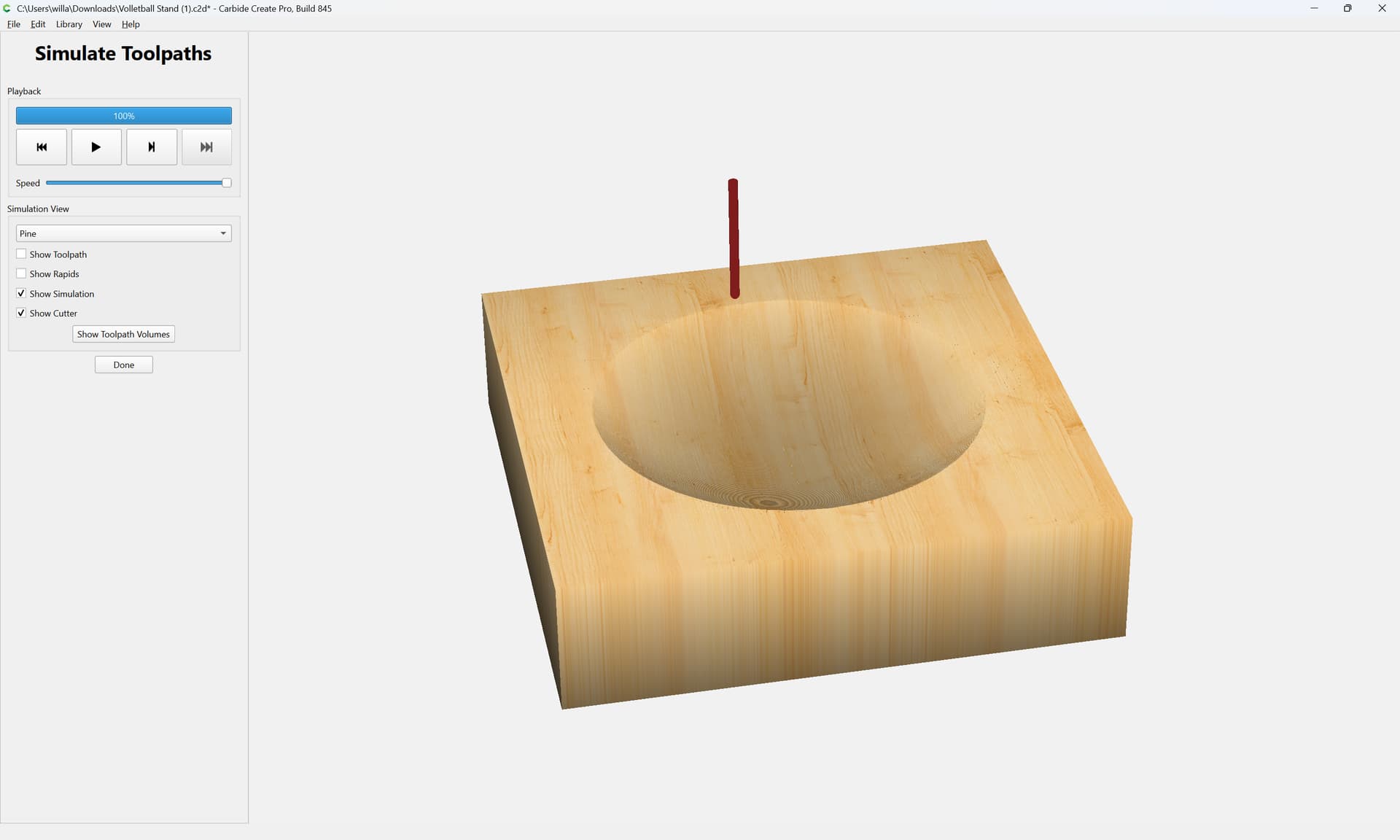

Would a .81" 1/4" roughing bit pass followed by a 1/16" ball nose with a start depth of .81" and a final of .83" be the right way to carve this? This is my first “3D” carve, and the simulation shows a flat bowl.
Volletball Stand.c2d (1.7 MB)
You do not want to use a Pocket toolpath to cut a 3D area.
See:

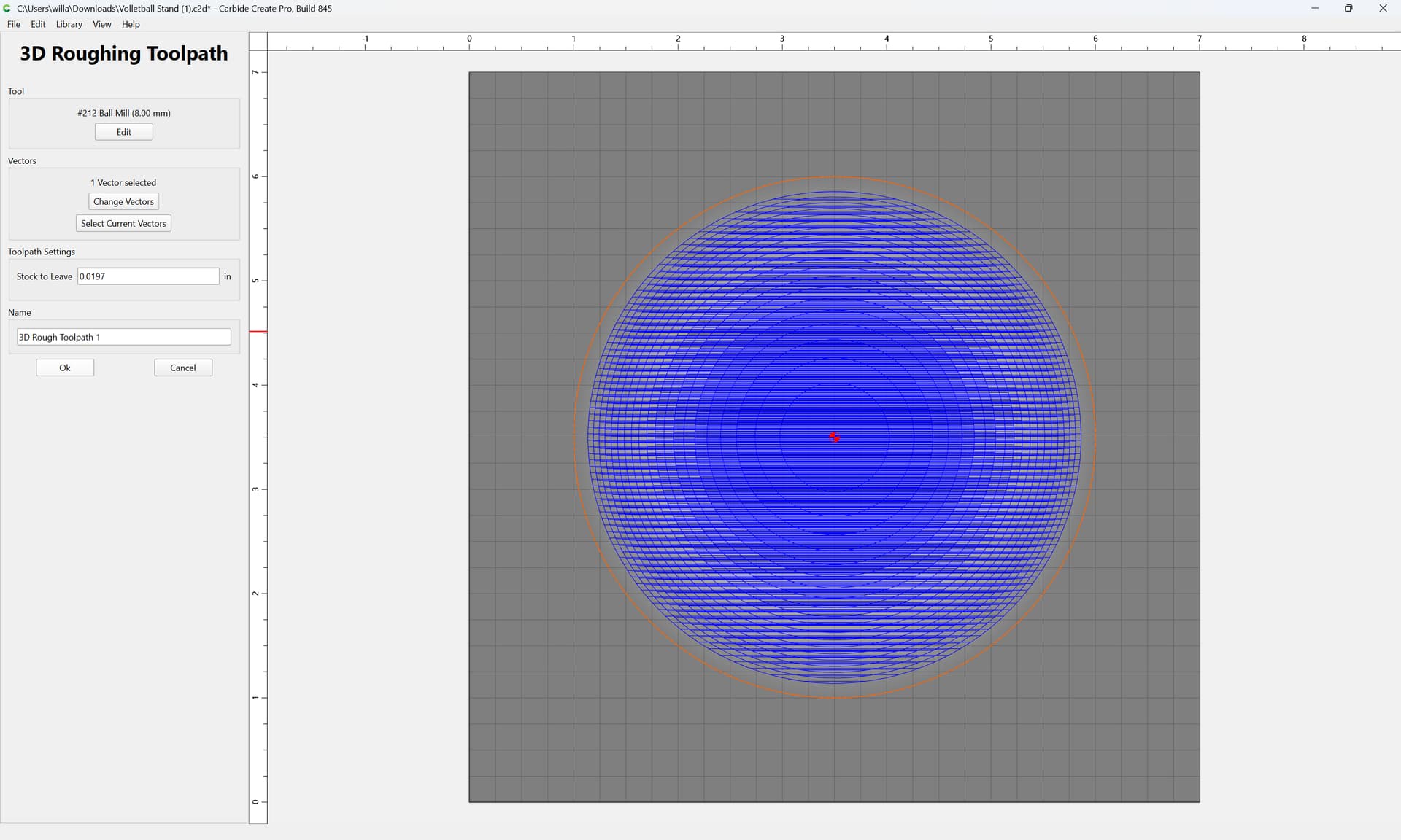

Instead, use two (or more), 3D toolpaths see:
(also adjusted the stepover)
Pro tip: use the largest radius ball mill you can to get the detail you need.
A bowl has no detail, so the largest ballmill you have.
Use smaller ballmills to get into details, nooks and crannies the larger mill won’t fit.
The larger ball will allow you to increase feed and stepover to get a better finish in much less time
@WillAdams I feel like a dolt, those 3D toolpaths were right in front of me! Like I said, first 3D carve here, even if it is simple!
@Tod1d Thanks for the advice. Would a 3/4" bowl bit work for the roughing pass to make short order of it? My selection of ball nose bits is limited, but I do have a 1/4" downcut ball nose to do the finish pass with.
Thank you both, I plan on doing a test piece this evening before going live with the walnut block!
Carbide Create does not directly support the typical bowl bit w/ flat-bottomed geometry, so such tooling can’t be used for 3D — the 1/4" ball-nose should be fine, esp. if you use a small value for stepover for the finishing pass.

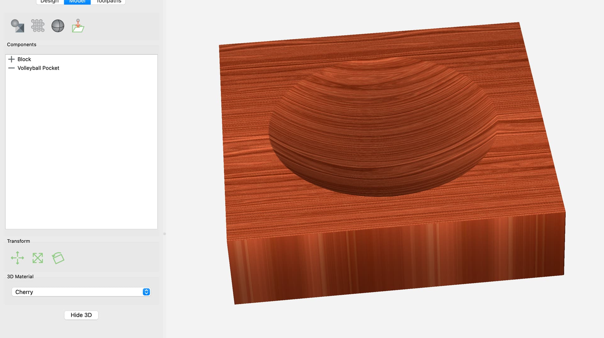

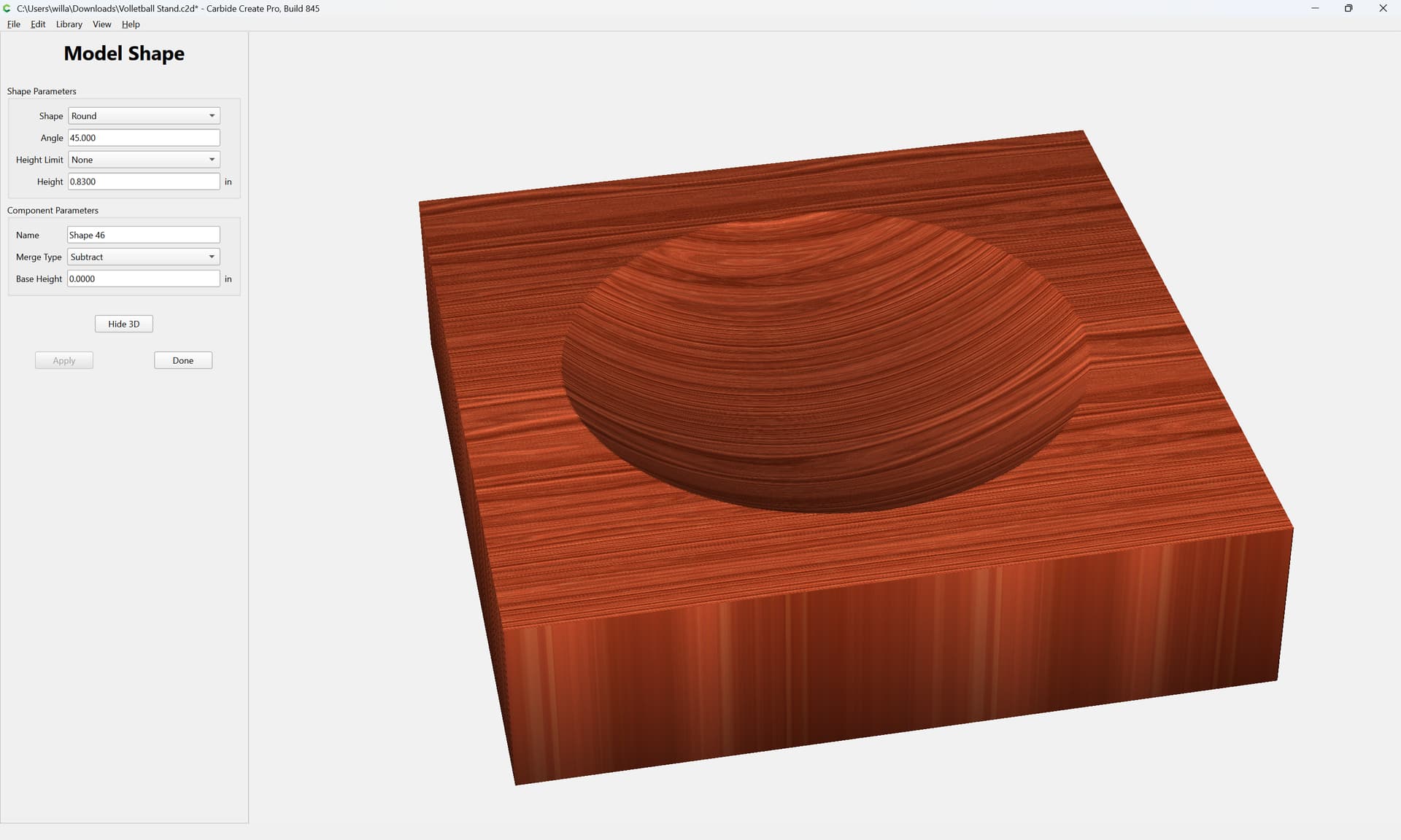

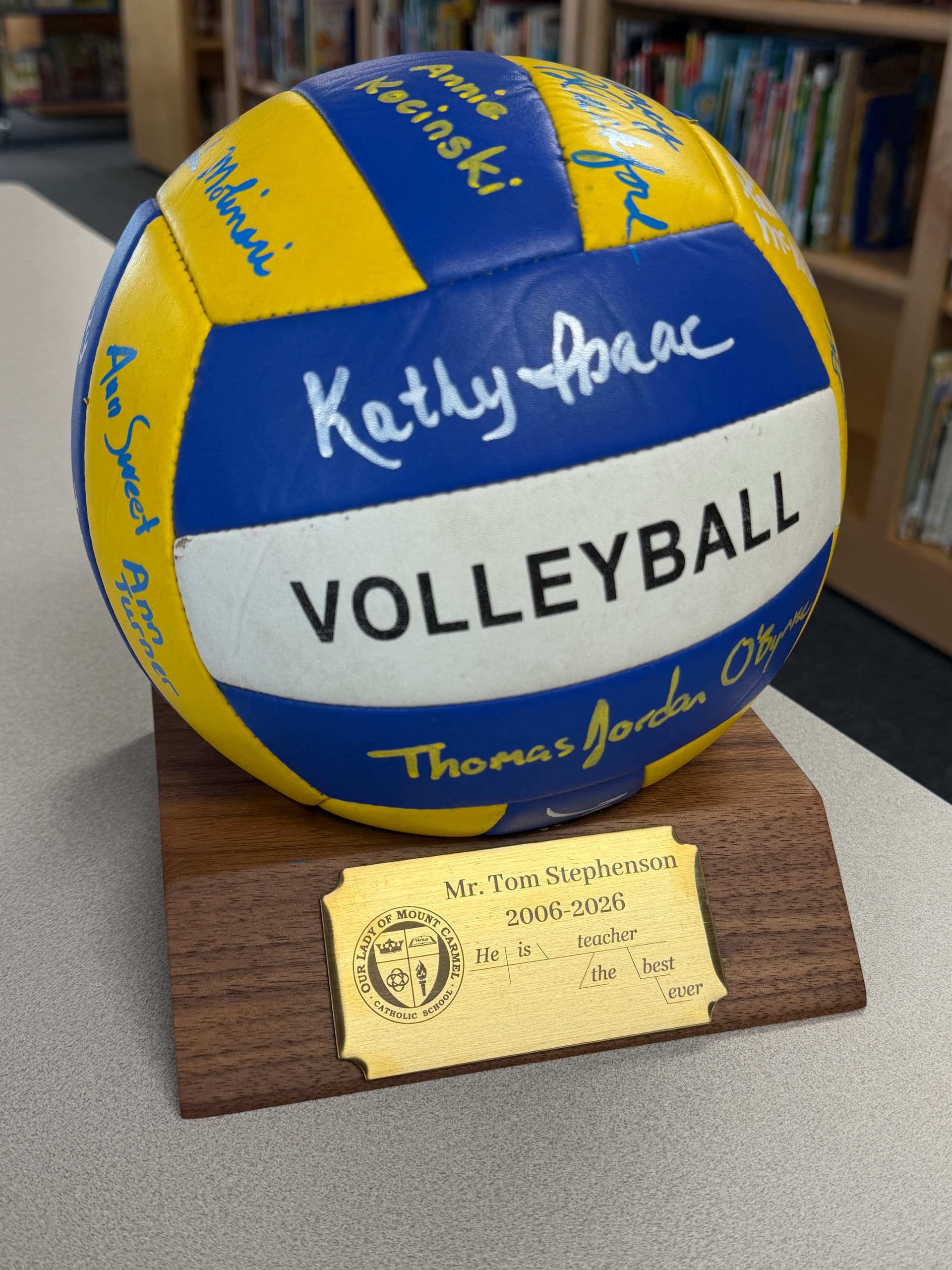

Thanks for all the help here, guys! I forgot to come back with the finished results. I was very pleased, and the recipient was very grateful!!
This community rocks!
