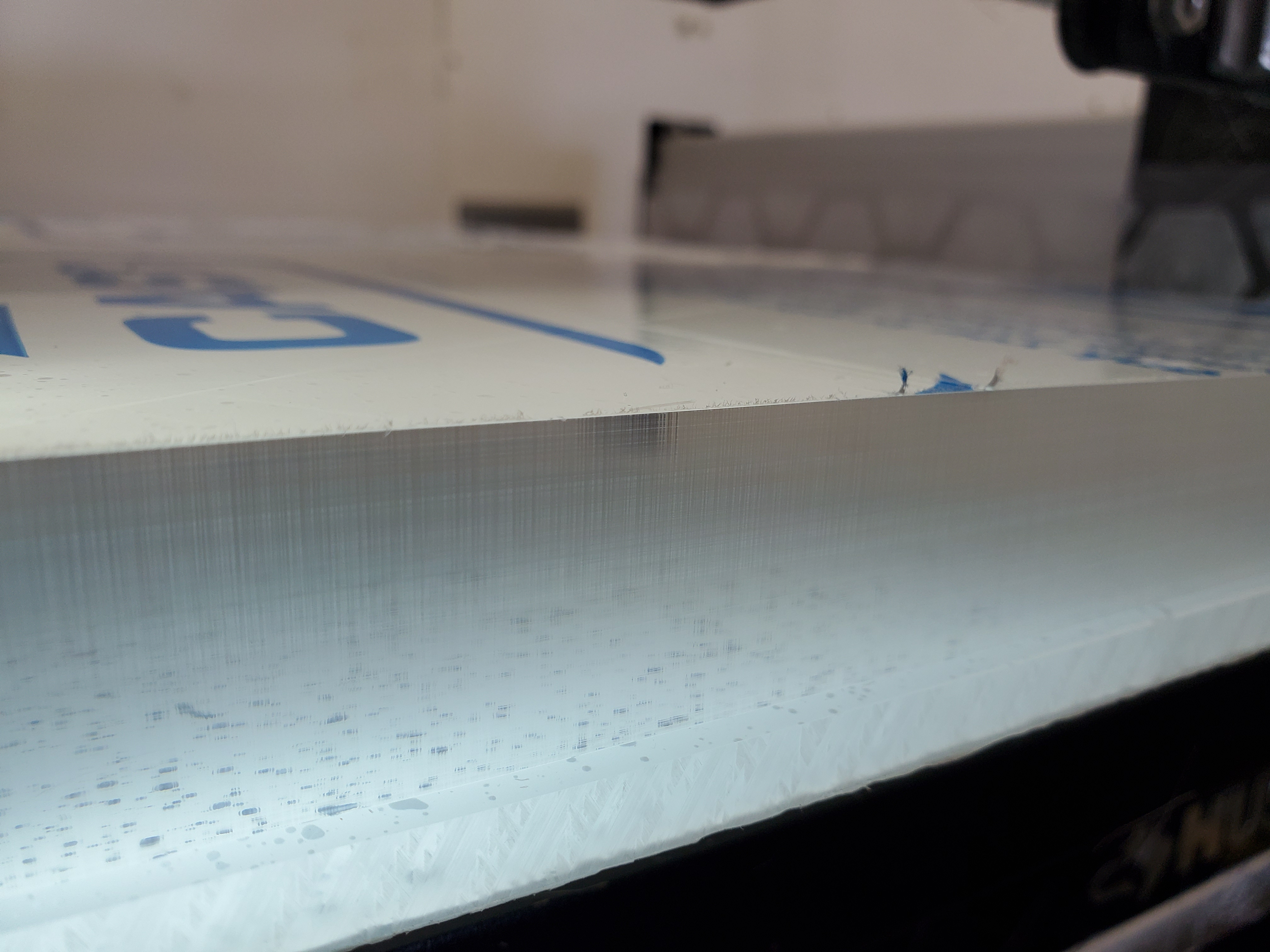

Not quite a $30k Slow-mo camera, but thought I would post this to see what everyone thought. I’m leaning toward bit deflection.
This is the 2nd of two finishing passes (with a ramp) with a .02mm stepover removing a total of .04mm of stock to leave. Adding a spring pass didn’t improve much. C3D router at setting 5.

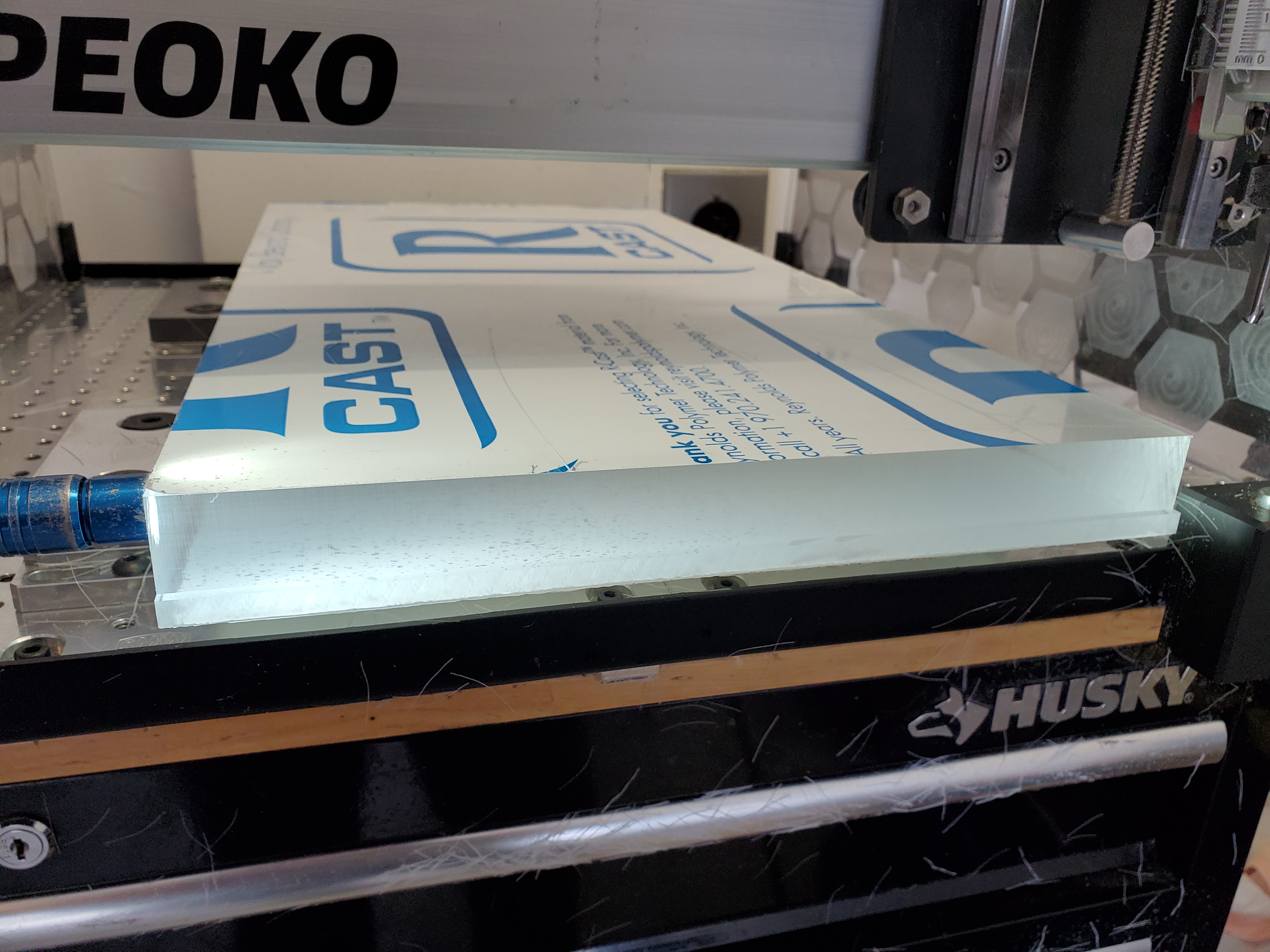

This is what it looked like when done:
I’ve temporally stopped doing any work for customers with my Shapeoko. Ordered a few newly offered acrylic specific cutters, and plan to run a bunch of experiments when they arrive. Back to chatting with tool tech support, working on some minimum WOC and chip load ranges. I’ll share whatever they work up.

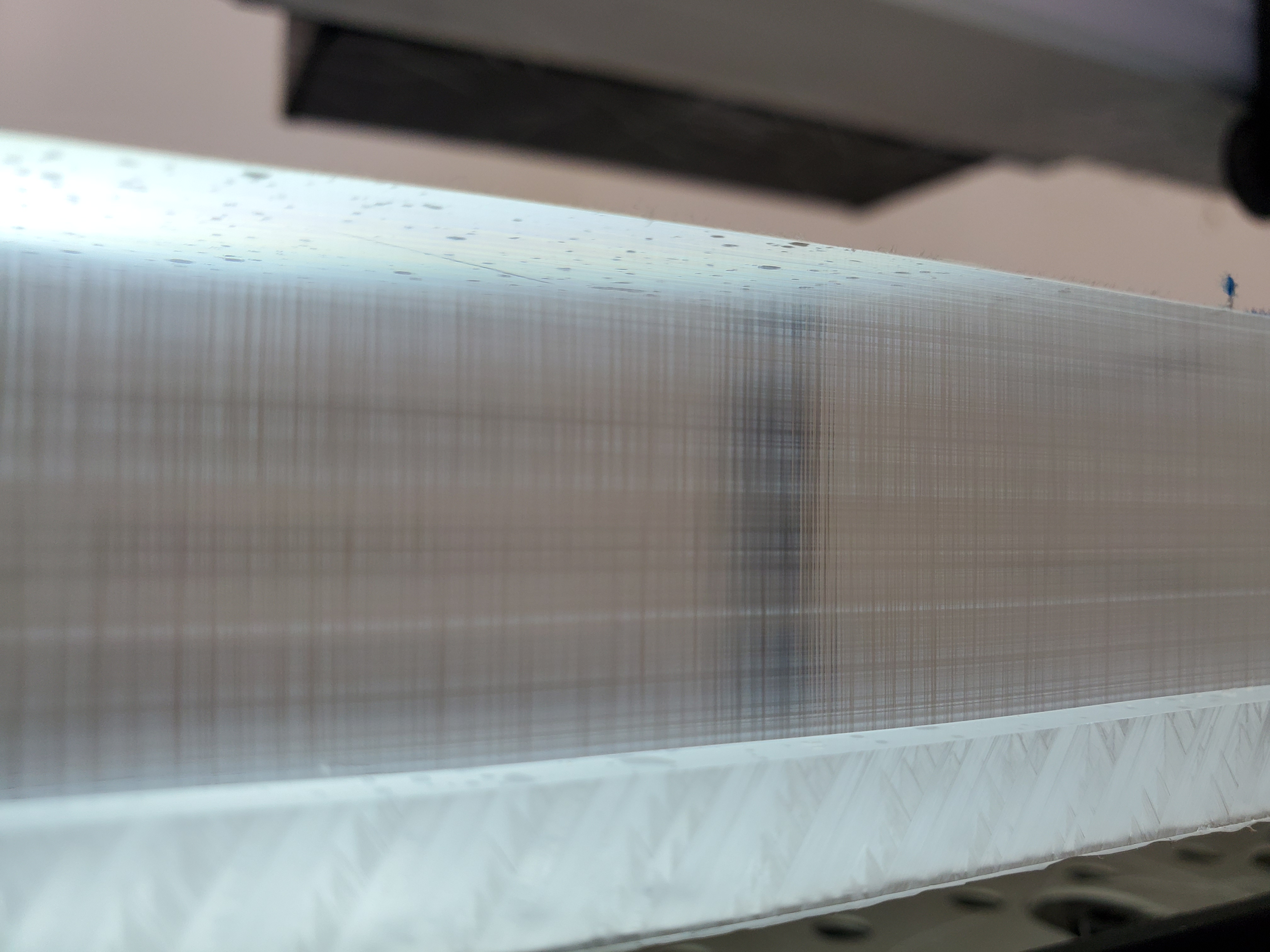

After watching the very exciting, riveting videos by @LiamN about vibration, deflection, and backlash…I am wondering if the fact that your machine has the standard waste board and is sitting on the floor is causing an vibration that is translated into the cut…
In the video some chatter & vibration is definitely audible, the question, as you correctly identified, is what is causing it? I have personally found plastics to be the most challenging to get really clean surface finish on, give me a bit of hardwood or Aluminium over a plastic any day.
It could be the cutter, but that’s not very likely, it should be relatively easy to check in Millalyzer what sort of cutter forces are in play here but I suspect they are small. The cut is on an outer edge with excellent flying chip evacuation, it appears that the cutter is moving fast enough to not be locally heating and melting etc.
The acrylic itself is probably large, heavy and rigid enough to not be vibrating that much, but it’s worth checking. If the baseboard is ringing to the tone of that audible vibration damping it down may well help.
My completely unsafe methodology (which I don’t recommend anyone else try) when I hear that sort of vibration is to use a wooden dowel in my hand to check the router / spindle clamp to see if I can feel the vibration there, then on the X beam to see if it’s still present at that level. Sometimes you can feel the vibration most clearly in the wasteboard (well away from the spinning metal please). It’s rather primitive in the level of scientific process and measurement, early days of the Royal Society, but I’ve found it does help if you can find out where the vibration is most clearly evident.
During some of the excellent feedback spargeltarzan gave me on the vibration video one of the key ‘aha’ moments for me was when he pointed out that if you have vibration or chatter in one pass of a cut, the physical profile that vibration leaves in the material may well be sufficient to re-trigger that exact same resonant vibration mode during the next pass of that cut.
It may be that the pattern developed in the early passes at the top are to some extent just being copied down the cut as the passes get deeper. A close up video of several passes would probably give some evidence for or against this hypothesis.

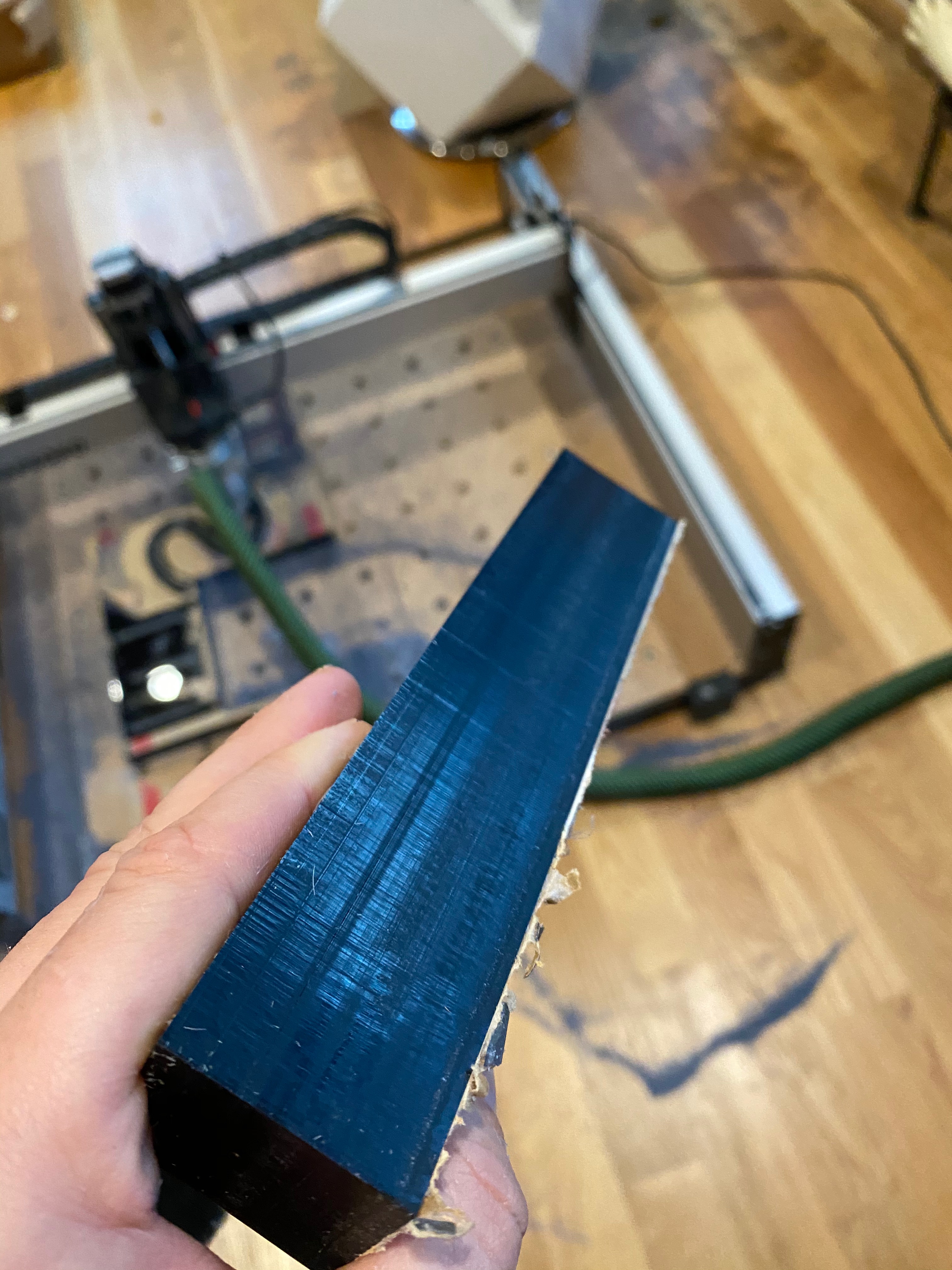

Finished up a few recipes for wall contours today. Found out conventional isn’t always the best way depending on depth of cut. I’ll upload the wavy contour photos later but for now here’s a straight line cut.
8mm Datron 4-1 @ 20krpm
1.000 depth of cut
This recipe preferred a climb and a bit of soapy water really helped. Optical clarity is pretty good.
3F 8mm YG1 @ 12krpm
1.290 doc

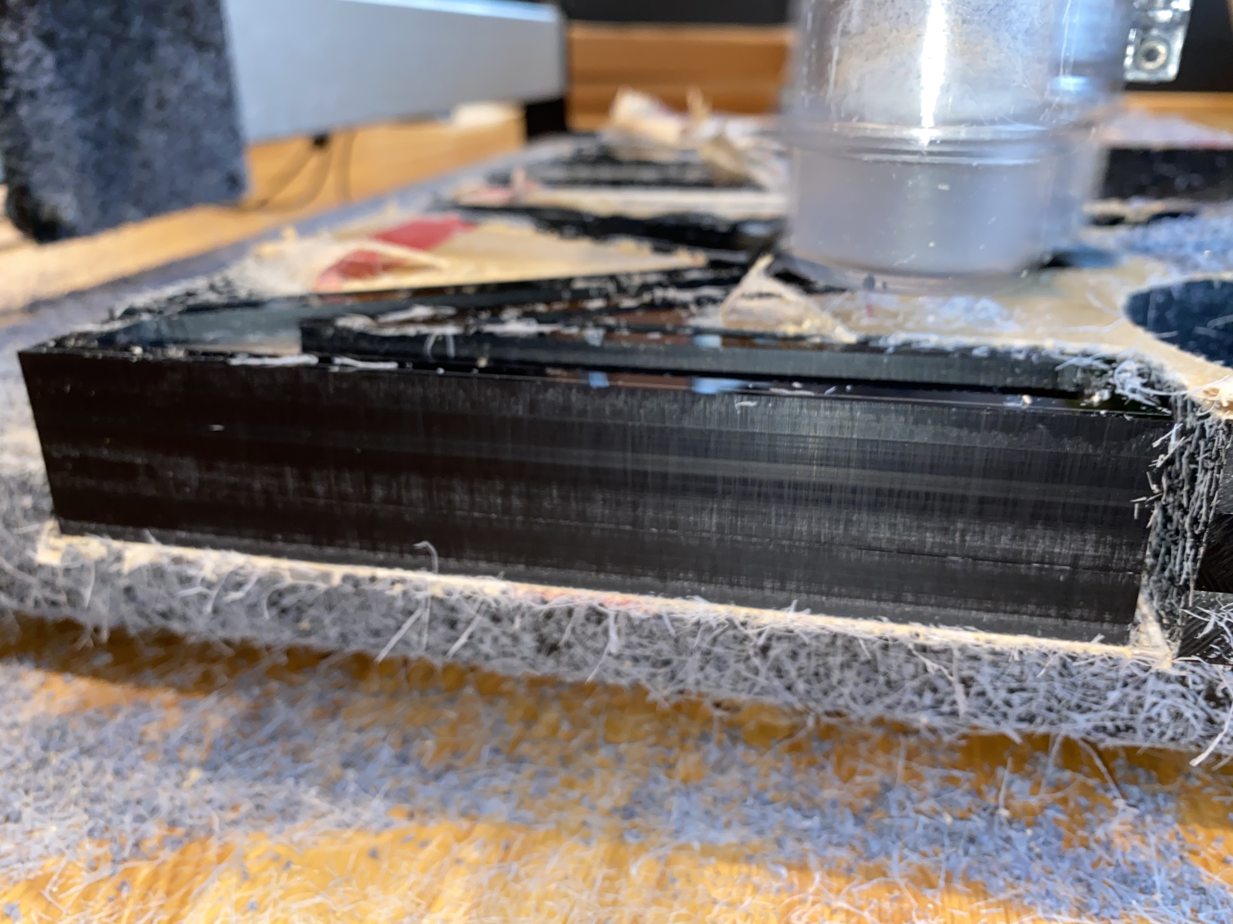

Interesting, Pretty similar I think to my results except that Black probably shows way more imperfections.
Can you add some detail on the tool-paths, feeds per tooth, ramps etc… Looks like a FDOC based on the shaving hairs around the first picture.
I’ll see what I can share later but it looks like the 3F needs curve testing as well. A good cut shows very consistent machining marks.
The 8mm shanks definitely moved around less than the 0.250 tool.
I feel like I have gotten marginally better surface finish by using a conventional finish pass with a 20% of diameter stepover, but it really could have been placebo effect as the difference was small.
