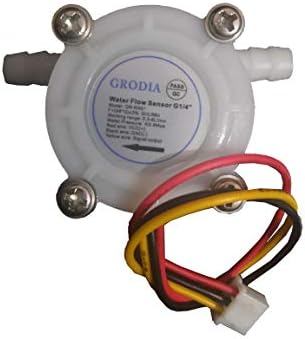

Quick survey for those of you who own a water-cooled spindle, do you have some kind of coolant flow indicator installed ? After I installed everything it hit me: the coolant pump that came with my spindle probably costs 20$, and its failure can probably kill my 200$+ spindle in a few minutes.
I see some of you use a visual indicator in the coolant line, I’ll go for that as a minimum:
but I have a dream about some kind of inline flow indicator that would embed a bit of self-powered electronics to either produce a beeping alarm when the flow stops, or better yet trigger a signal that I could then wire back into the VFD controls to do an automatic emergency stop.

Both are basically a switch, so you could wire that back to the vfd as a stop signal on an input.

I’ve built a simple arduino based flow indicator that displays the flow rate and coolant temp. It will also start and stop the pump on a signal from the VFD (haven’t got that bit working yet - as I need to repackage the whole thing in a decent box first).
You can just start and stop the pump via the VFD - but I like to complicate things and have lots of readouts to look at - bells whistles and lights etc.

But it’s pretty simple, just a flow sensor very much like the one pictured earlier in the string, a temp sensor, an arduino nano, and a recycled Nokia LCD.
Like I was saying I want to integrate a relay so the pump can turn on/off via a signal from the VFD - but I haven’t gotten that far yet.
