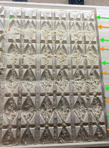

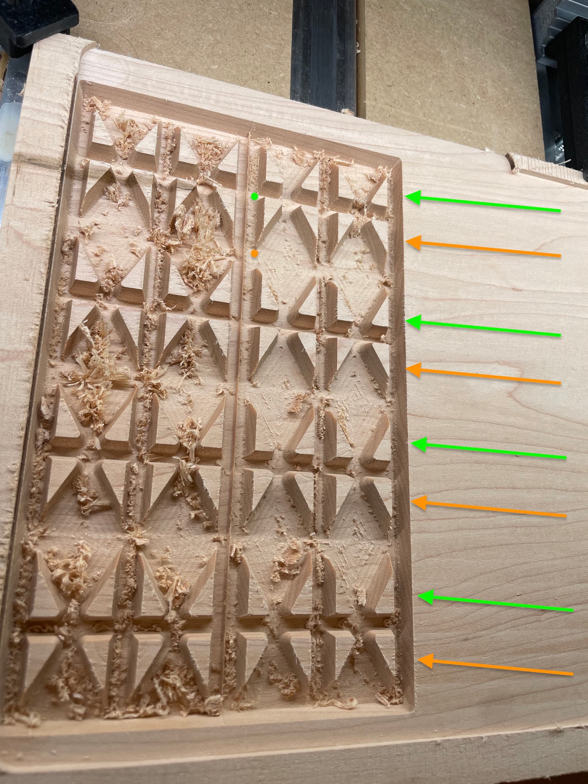

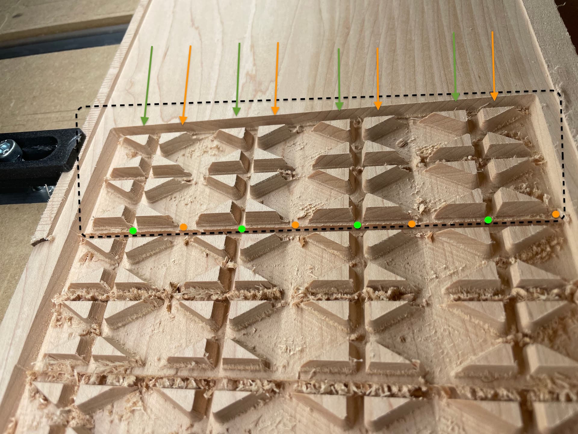

Photos:
Green arrow rows (Where fragile detail faces UPwards) - these are the consistently the pristine ones.
Green dot (Plunge entry point) - the observed entry plunge position on ALL the pristine ones.
Orange Arrow rows (Where fragile detail faces DOWNwards) - these are consistently the chipped ones.
Orange dot (Plunge entry point) - the observed entry plunge position on ALL the chipped ones ones.
Photo of part of Test batch 1:
Material - tulipwood (poplar for the yanks)
~600 janka hardness so would expect higher probability of chipout. Started with this because I had it ready to hand for quick vibe test a variety of different approaches to establish a procedure for myself to make facegrain inlays. I tested a variety of different approaches but there was one consistent trend that came out no matter what extreme or conservative approach I took. I noticed a pattern toward end of my tests.
Photo of Test batch 2:
Material - Maple
~1500 Janka hardness so should eliminate the variable of hardness being a contributory factor. The issue persists on this wood too so there’s something else at play. Here, the results were a bit improved but the pattern still persisted where the one faceing upward are 100% pristine and the ones face 180deg downward, a number of them were chipped still
Observation
Notice how the chipout is all happening primarily on the ones where the tool plunges at the tip of the fragile detail and the other that doesn’t plunge at the fragile tip is regularly pristine and undamaged?

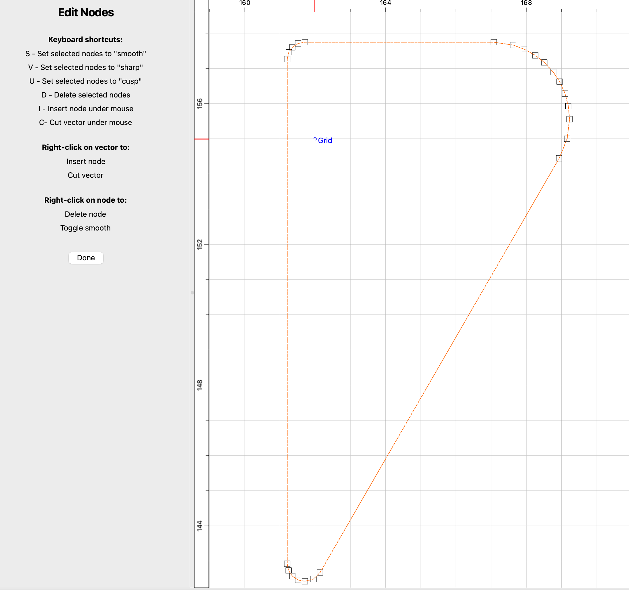

@tobwhy I’m not sure if it’s possible in CC like it is in VCarve Pro, can you select the Node that you want each vector to start at?
You can’t iirc - That would be an awesome feature to add if C3d decide it better to outsource this solution to the user to control instead of doing it blanket as above. You raise a really interesting point for the feature request to consider that might be easier for C3D to implement than what i’m suggesting. No idea if its easier but, logically thinking, it might be so thanks for that valuable input!

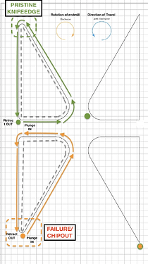

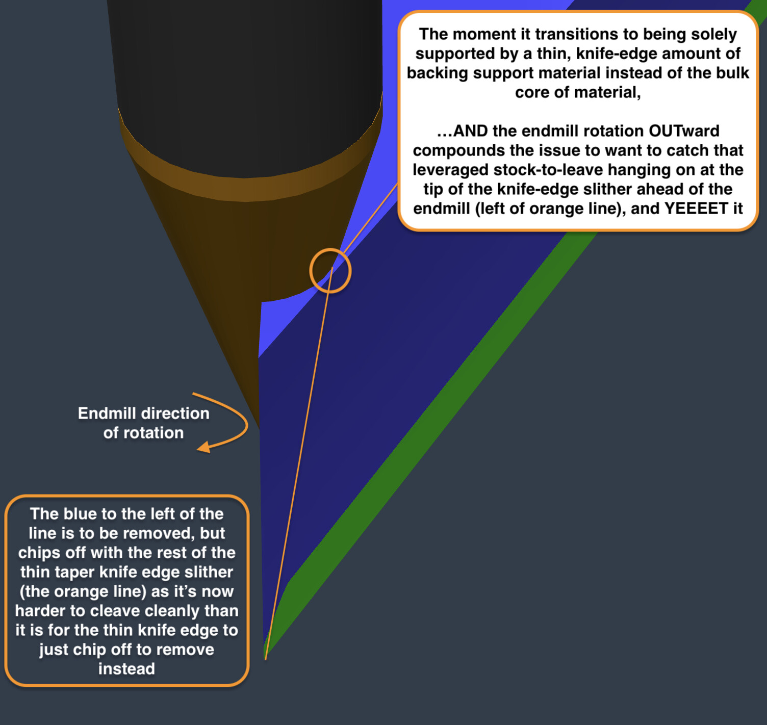

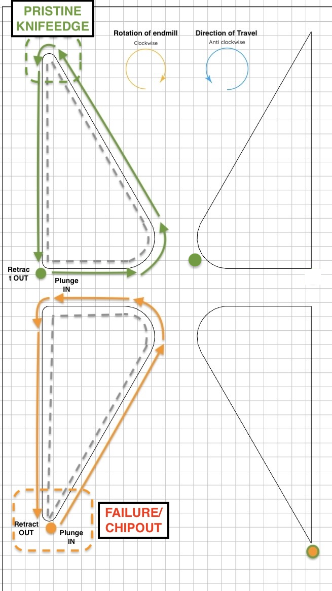

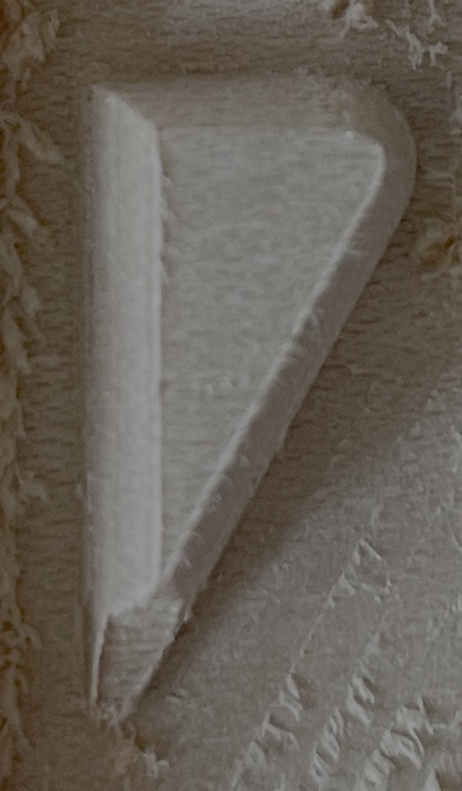

Okay, I have run the test again.
Observations:

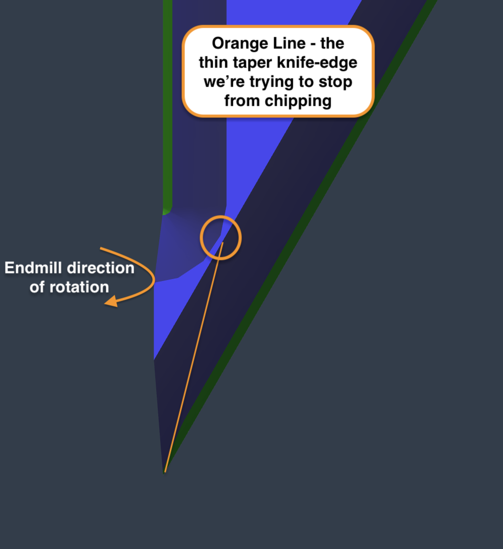

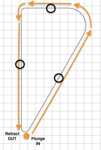

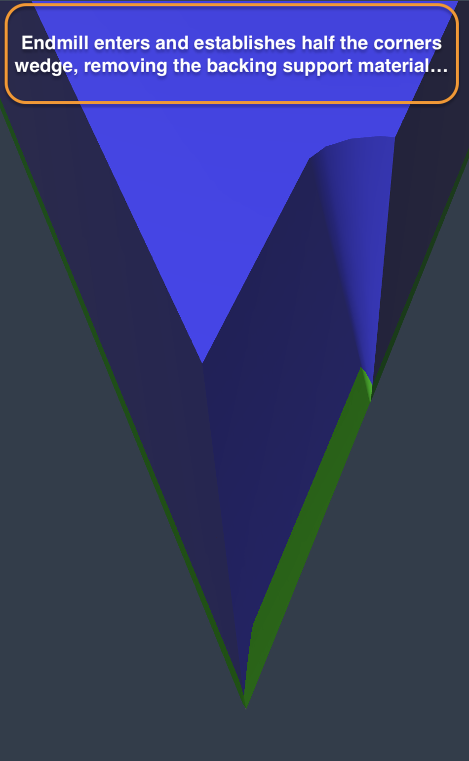

Orange - the failure example:
  1. Tool enters cut at fragile tip. No damage is caused at this point.
  2. Tool goes anticlockwise all the way around the perimeter of the shape with the vbit. No damage still
  3. Tool is coming up to the fragile tip to finish off the cut. The motion of the tool shaving off chips clockwise (away) from the material core (while the other side of the fragile tip was already removed in 1) chips and damages it.
Orange Cause - The combination of:
  1. Half the fragile tip’s taper backing support stock-to-leave being removed by the vbit on the tip → increasing material engagment portion of the pass prior to the other half of the fragile tip cut (the approach of increasingly disengaging the material to end on the tip); compounded by…
  2. …the clockwise motion of the endmill cut
    …come together in an unholy combination causing the knife edge of the delicate taper tip being chipped off.

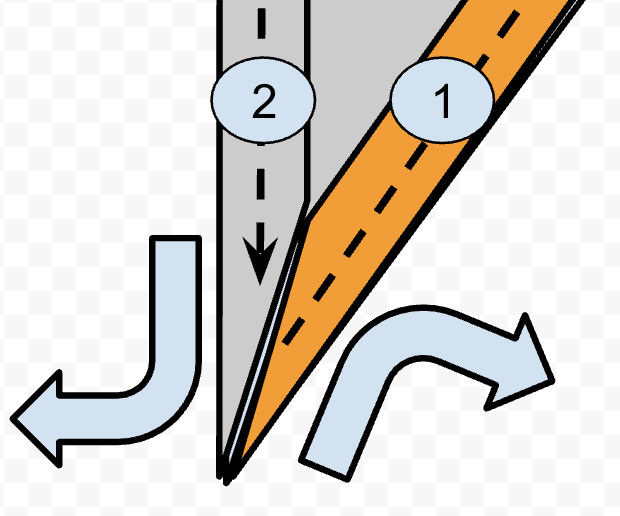

    Figure - #1 and #2 represent the first and second cut order, Orange shading indicates where material is removed from tip section first; Grey shading where material still remains after 1st half of taper tip cut; Large outward blue arrows represent endmill cutting rotation; black dotted arrows indicate the spindle direction of travel; Small blue slither at the knifedge is the thin taper feature of the inlay that keeps getting chipped.

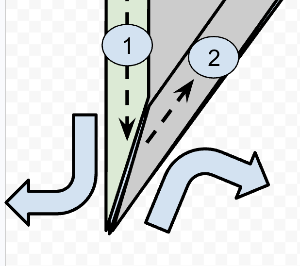

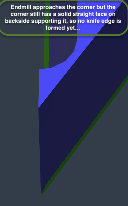

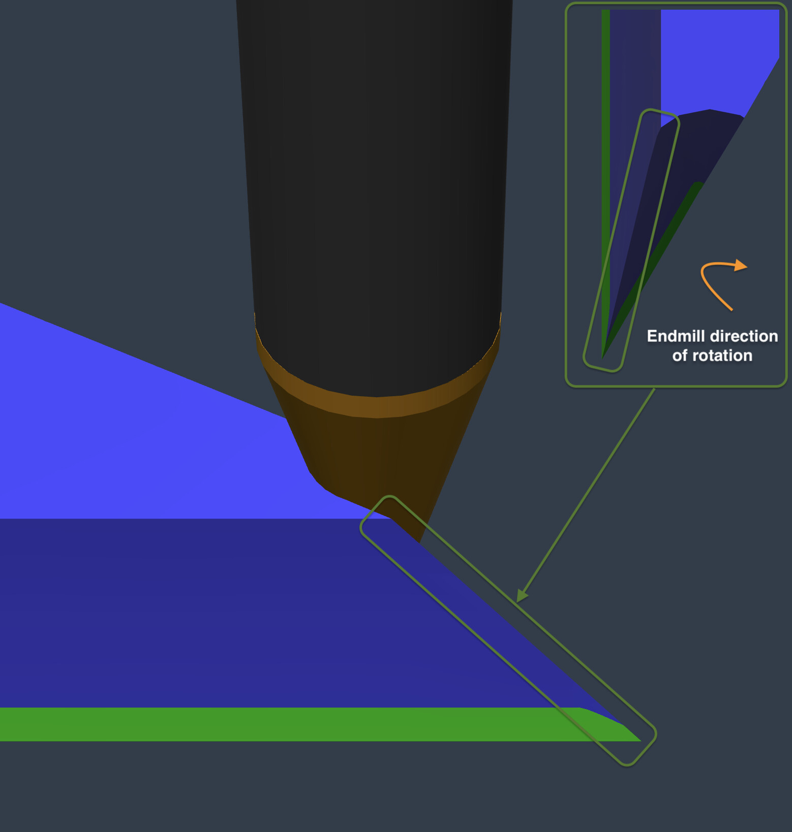

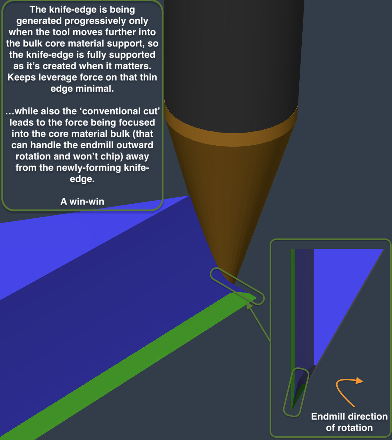

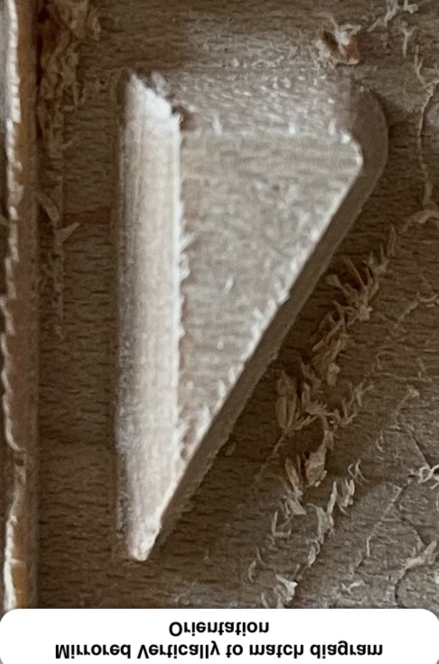

Green - the pristine example:
  1. Tool enters cut AWAY from fragile tip. No damage.
  3. Tool approaches the fragile taper tip segment BUT it still has all the stock-to-leave backing material so is fully supported. The motion of the tool shaving off chips clockwise (away) from the material core doesn’t chip because the tip feature is not thin enough to a taper knife edge at this stage, unlike ORANGE.
Green Cause: As the tool comes back into the material after reaching the tip and creating half the taper knife-edge, you would think it would have the same chipout behaviour at this point because the material removal from 3. However, the key difference is the spindle direction of travel is into increasing greater material engagement. Therefore, although the endmill is still spinning clockwise and creating the knife edge, it’s creating the knife edge while moving into increasingly more material and away from the fragile taper knife edge, preventing the chipping, rather than creating the knife edge while reducing material engagement to just the knifeedge tip which radically increase chipout potential.
Figure - #1 and #2 represent the first and second cut order. Green shading indicates where material is removed from tip section first; Grey shading where material still remains after 1st half of taper tip cut; Large outward blue arrows represent endmill cutting rotation; black dotted arrows indicate the spindle direction of travel; Small blue slither at the knife-edge is the thin taper feature of the inlay that is preserved in this scenario.
Conclusion:

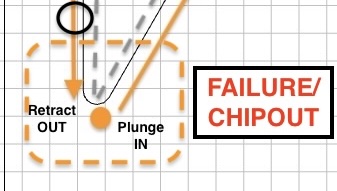

Tool start/end position is 100% the cause of this fine detail chipping issue with CC advanced vcarve toolpath
. It’s not specifically the active motion of the plunge in or the retract out BUT it is 100% the entry and exit position set on on the fragile tip that leads to the conditions of terrible stock removal order which is aliased by the entry/exit point POSITION that is causing this.

  4. [MOST VERSATILE]…OR/AND create a UI option in the SW so the user can select the entry/exit position node as @Pchuk mentions above - This is probably the most versatile fix to resolve for all edge cases. Could be laid out like your current ‘edit nodes’ UI but for selecting the entry/exit point, so can cannibalise a feature you already have

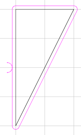

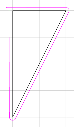

Current:
Proposed:
C3D - please seriously consider this feature request applied to both the ‘advanced vcarve - endmill and vbit’ toolpaths to promote the green scenario. It would paradigm change the performance of your advanced vcarves for Facegrain (and by extension, endgrain). I have used your advanced vcarve toolpath extensively so I wouldn’t bring this up if I didn’t feel this is worth your time to improve the competitive edge of your product.

  1. [Best Manual] Custom select entry point via node selector using same UI component/view as your ‘Node editor’ - This is probably the most versatile solution out of the lot but might be a bit more involved to develop. However, you can canibalise some of the feautures you already have to save on some dev time.
