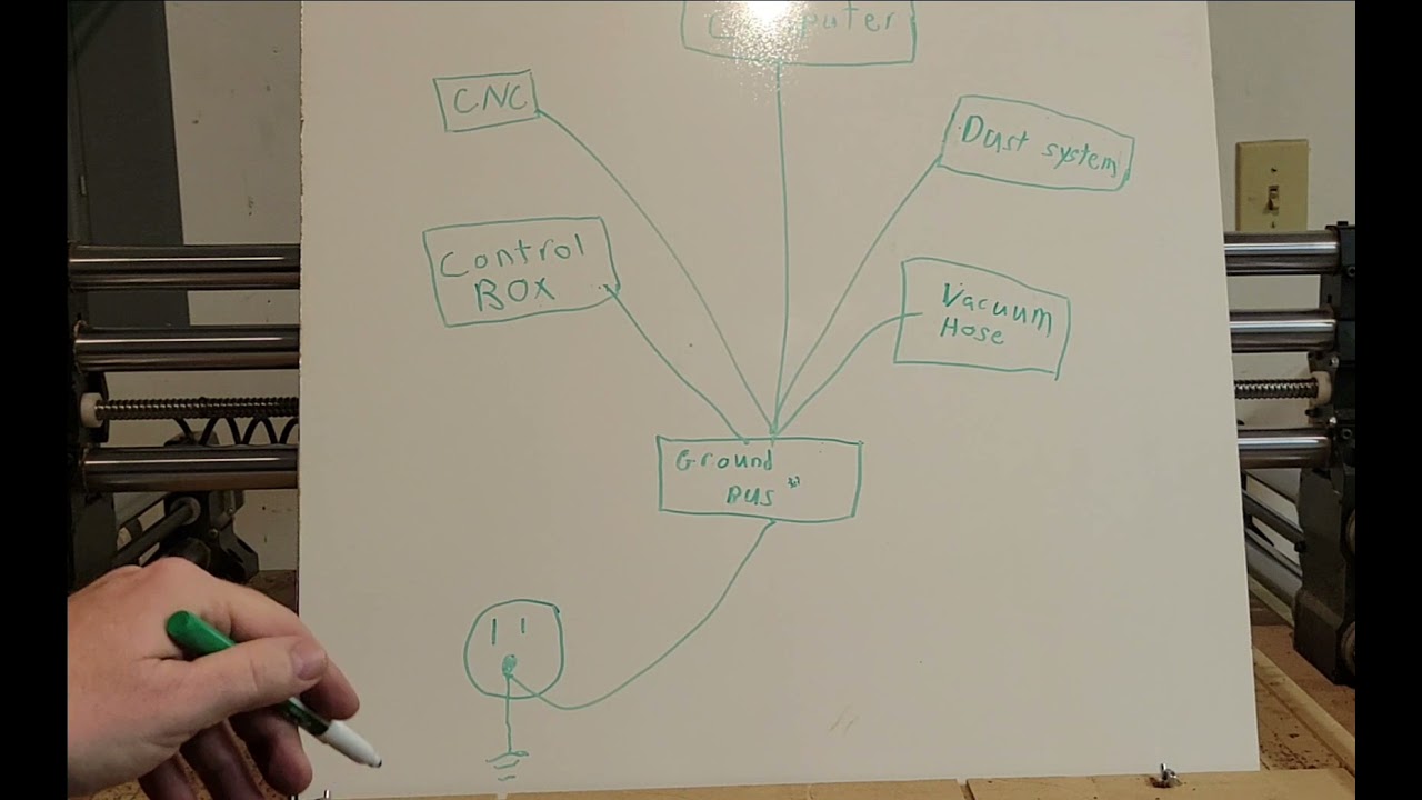

I have been thinking about how to ground out my different leads off of my machine and thought of a clever way to make grounds that are removeable. By taking an extension cord and taking off both leads on the plug and leaving the ground bar at the bottom, the ground can be ran back into the panel ground that goes outside. Also, I can run my own ground outside close to where I can install outlet box, can split the outlet to have separate individual plugs and run two different grounds out of this outlet to outside and on separate grounding rods. I think this would be better and even better looking then having wires ran all over and just dumped at random places to ground out static.
First, thanks everyone for the help and all the messages. Sorry if I get confused sometimes.
Do you think I can do that? Would it matter if the ground of the computer, CNC, and board are going to this rack, then to the house ground, or can it “back up”?

Being the kind of person I am, I took my ground buss and went to two ground rods on either side of my shop and the ground from my circuit box. If a little is good a lot is better for me
Do you have all the equipement on the bus ?
All of my CNC equipment. The Router has ground to the electrical system. It all eventually goes to ground that our electrical system goes to. I am just insuring it happens. Static electricity will find the easiest path to ground. Like I said, I am insuring it gets there.

I attached a stranded 14 AWG wire to the CNC frame grounding screw and took it back to the the same ground as the CNC and router are plugged into. I have metal electrical boxes so I can just attach it to the electrical outlet box.
Now to reduce the small ground loop that was created with the now two paths back to earth ground. Keep the new ground short as you can to get to the same ground as your CNC. smallest ground loop as possible.
Take the controller’s DC power cable ( the one that plugs into the controller ) and wrap the excess wire in a 2 inch ish “loop”, Use some zap straps. to make it look like a doughnut. This creates a poor mans choke. Choking this ground path. The easiest path is now the new ground wire you added. And not through the controller.
And I cant emphasize it enough, keep that vacuum noise away from your CNC machine. Do not run the AC power cord past any other sensitive equipment. If you are grounding the hose, only ground it to the vacuum ground, not the CNC ground. Not all, but a lot of vacuums make noise. If you can see through the vents to the motor, you see all those sparks, that is noise. We want that to go the other way :slight_smile:
In my case I ran the vacuum electrical cord by the CNC P/S. Ay-ay-ay The noise got coupled over into the CNC power supply and then up to the controller. :frowning:
In your example he uses a Ground Buss. Which can be correct. However I am worried that in “this” case you may create excessive ground loops as the CNC components parts are already tied together. It may work or may create other problems. My suggestions above are tiring to make the exciting ground work better for a more nosier environment.
Try your best to keep the grounds in a star / tree shape, weird things can happen when you start slapping grounds everywhere creating loops. if you create a loop, keep it small.
