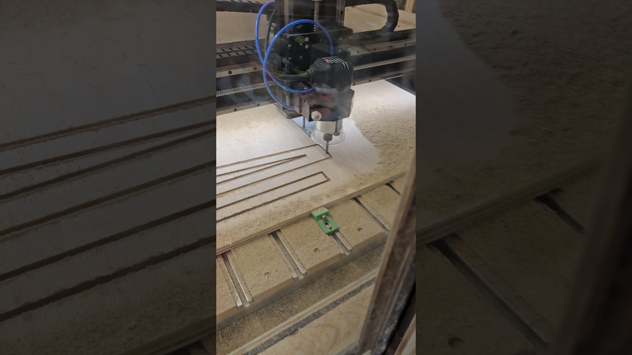

Very first job on our S5 Pro and it’s doing this weird stuttering in the corners:
What is weird is it didn’t do it in the interior contours.

Oh interesting. I had opened the debug console a while ago in Carbide Motion and never closed it. Just noticed it was open and closed it and the issue stopped.
