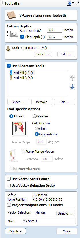

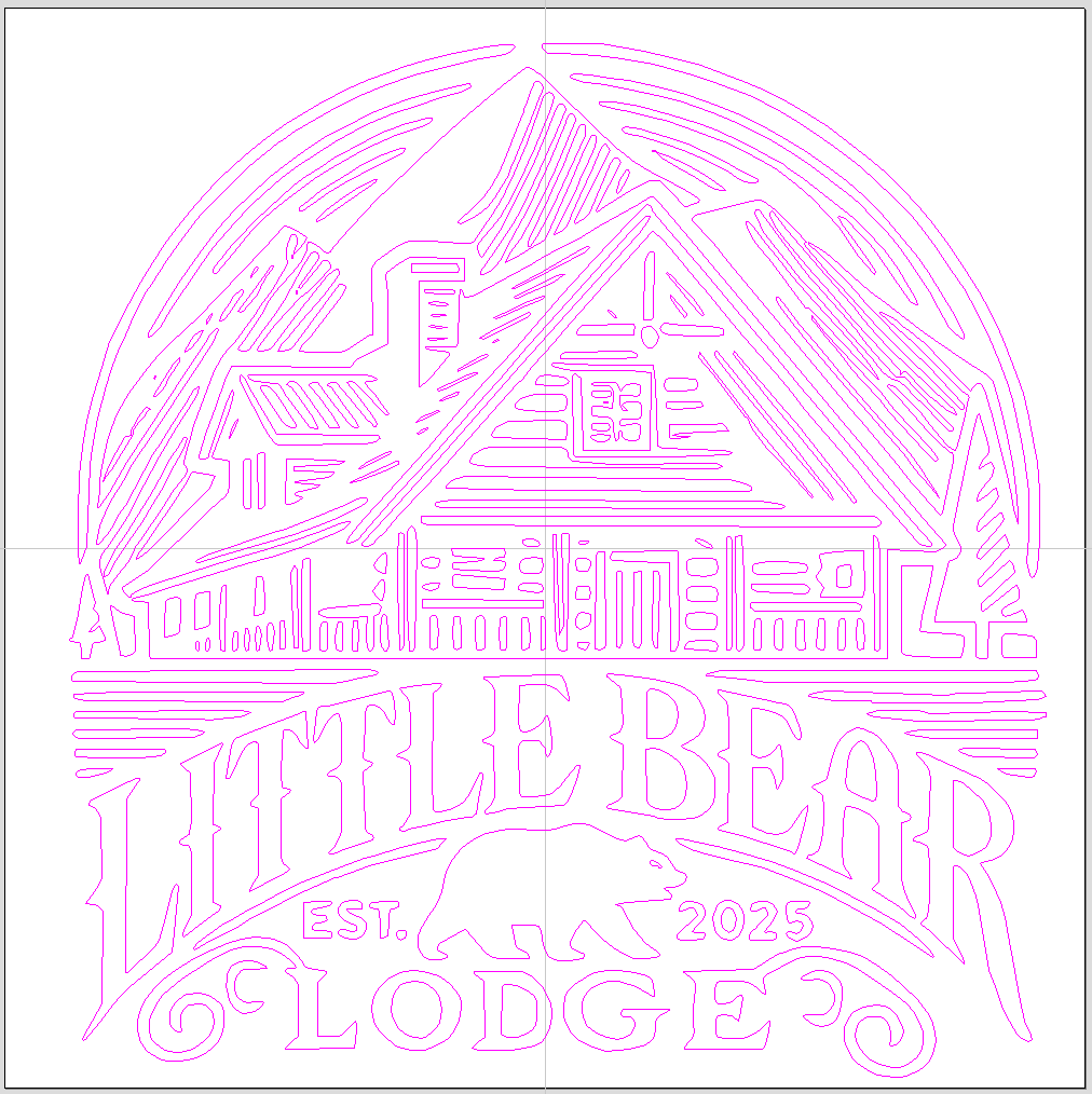

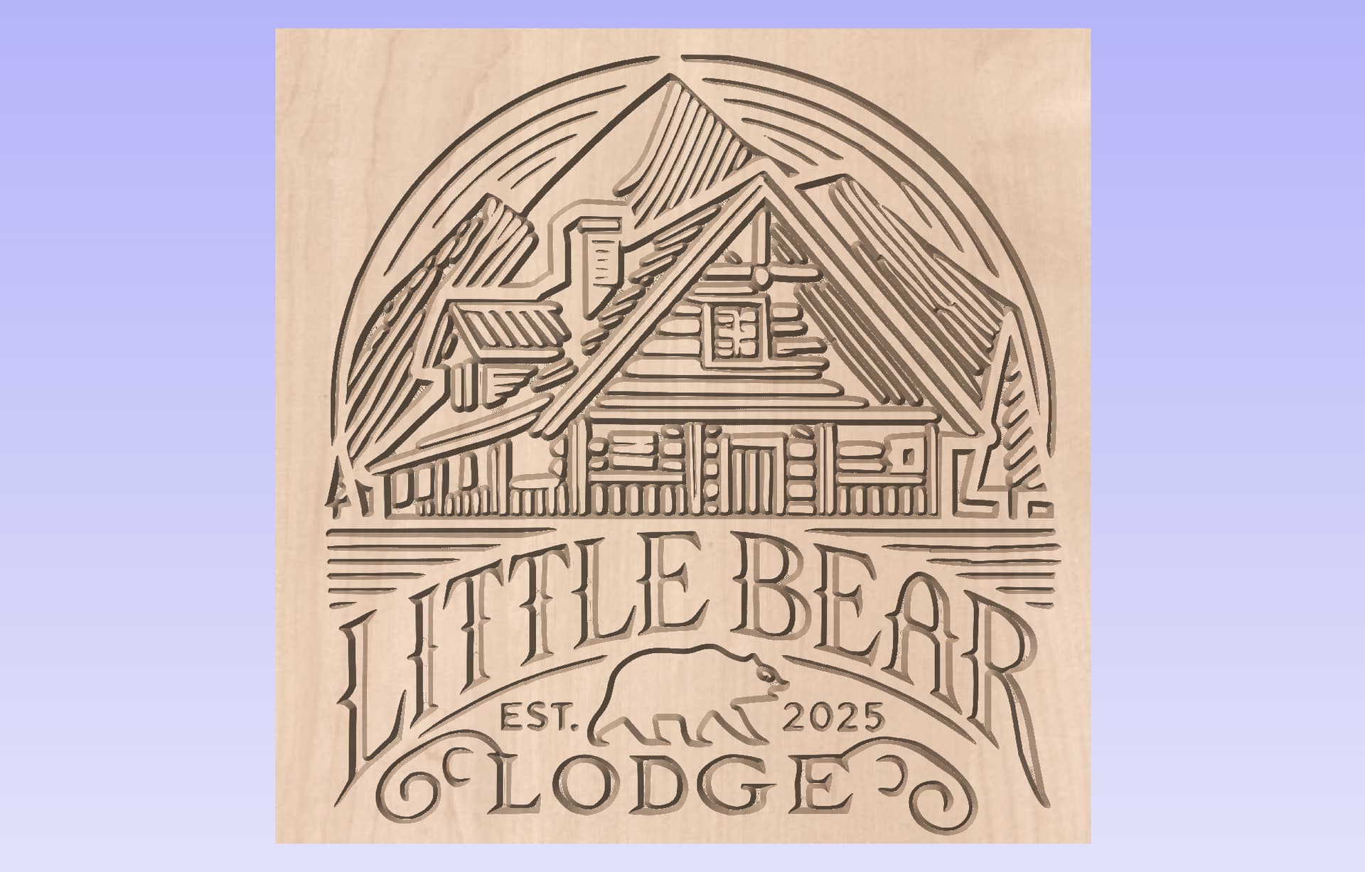

I was doing a VCarved sign on a nice maple slab when I encountered an odd issue when, I hope, I can recover from. As you can see in the VCarve Pro images, there are three toolpaths: 1/4" Clear, 1/8" Clear, VCarve. The only thing I added to the default toolpath was the 1/8" clear. Calculating and performing a Preview showed zero issues, as you can see from that image.

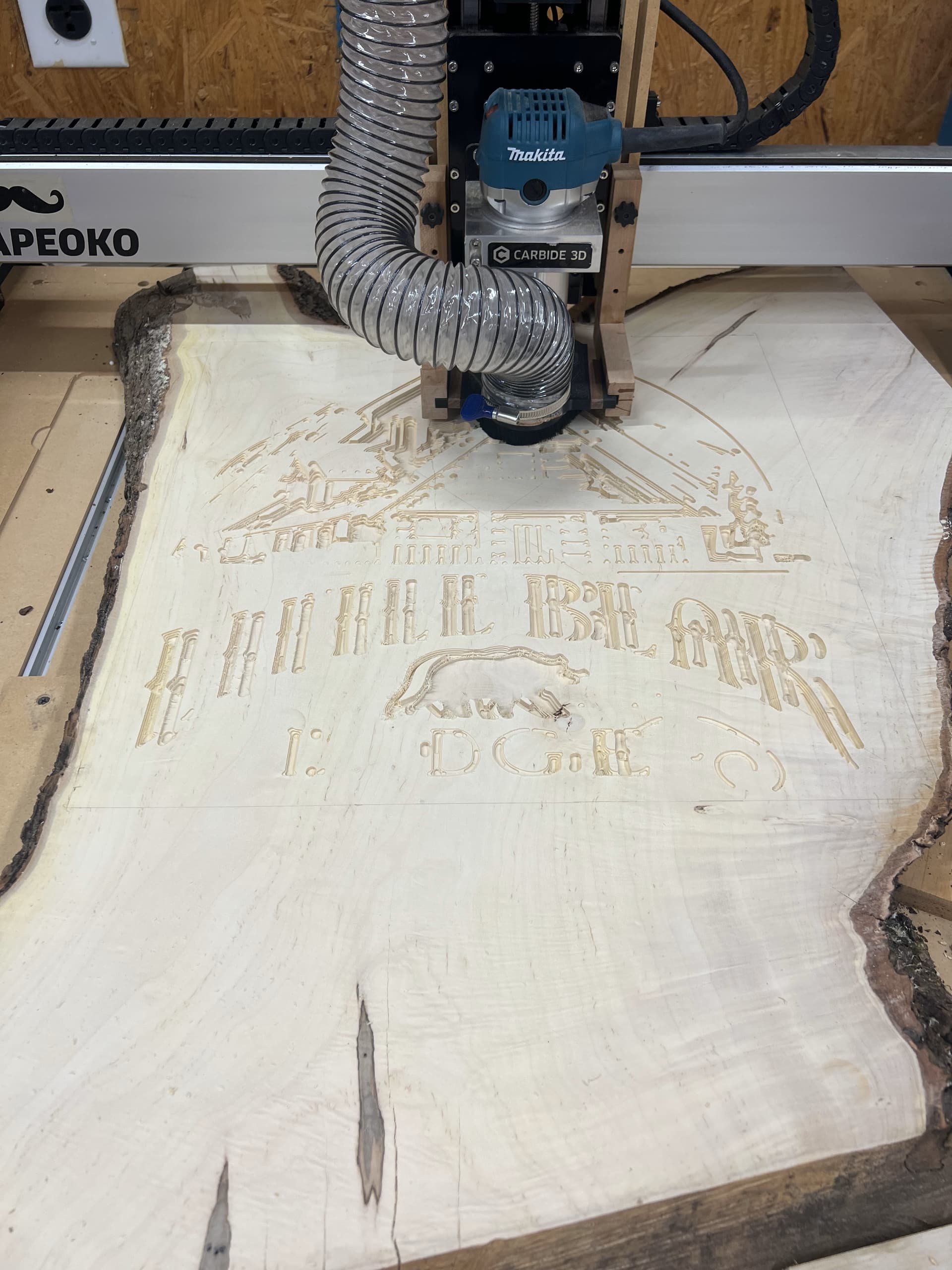

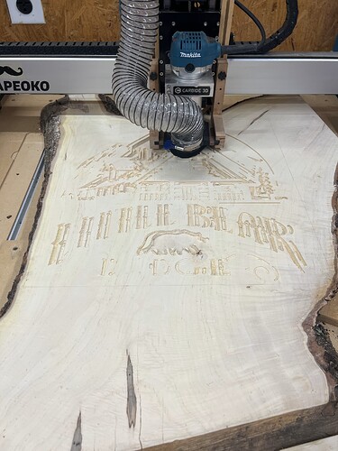

However, when I actually ran the job, the 1/4" Clear produced an odd, “ghosting”, duplicate of the original, as you can see from the image of it on the machine.

Lost steps on the X-axis caused by:
  • insufficient belt tension/damaged belt
  • loose/missing pulley set screw
  • loose Delrin Vwheel (possibly on the Y-axis, check all)
  • loss of electrical continuity (check all wiring and connectors through the full range of motion — ensure that the wires leading up to and away from the connectors are positioned and secured so that they do not more relative to the connectors)
  • mechanical interference (a wire or hose getting in the way, dust/dirt interfering with motion)
  • feeds and speeds too aggressive causing a loss of steps
  • excessively high tooling engagement if cutting a slot causing loss of steps
I figured out what was causing the problem. Apparently, there is no left side X axis limit switch. There are only three switches, X, Y & Z. However, only the right side X axis switch is present. When I do a fast travel to any of the three left X axis locations, the machine skips a few belt teeth since there is no switch there to stop it. I probably never noticed this before because I rarely if ever travel to these locations. I’m not sure what to do at this point, as there appears to not be any bolt holes or such to mount a switch for this and there wasn’t a fourth switch included with the HDZ kit. Also, I’m not sure where to plug in a left X axis switch on the control board. Any thoughts?
Losing steps on an axis is not caused by a lack of limit switches - the switches are only used during initialization to set the machine 0-point. All movement from there is via dead-reckoning which assumes that the machine mechanics move/respond as the controller tells it to.
Most likely in your case is that the motor connector for the X-axis is loose/vibrating & not maintaining a solid connection to the controller - thereby losing steps. You can easily test this by fiddling the motor connector while having the machine jog the axis across. Any jerky movement/grinding-type noise indicates that the connector is not maintaining a solid connection.
Securing the motor connectors or zip-tieing the two sides together so they can’t wiggle/vibrate separately/apart may fix the issue. Also ensure that the connectors are not being strained by vac hoses or sides of an enclosure.
