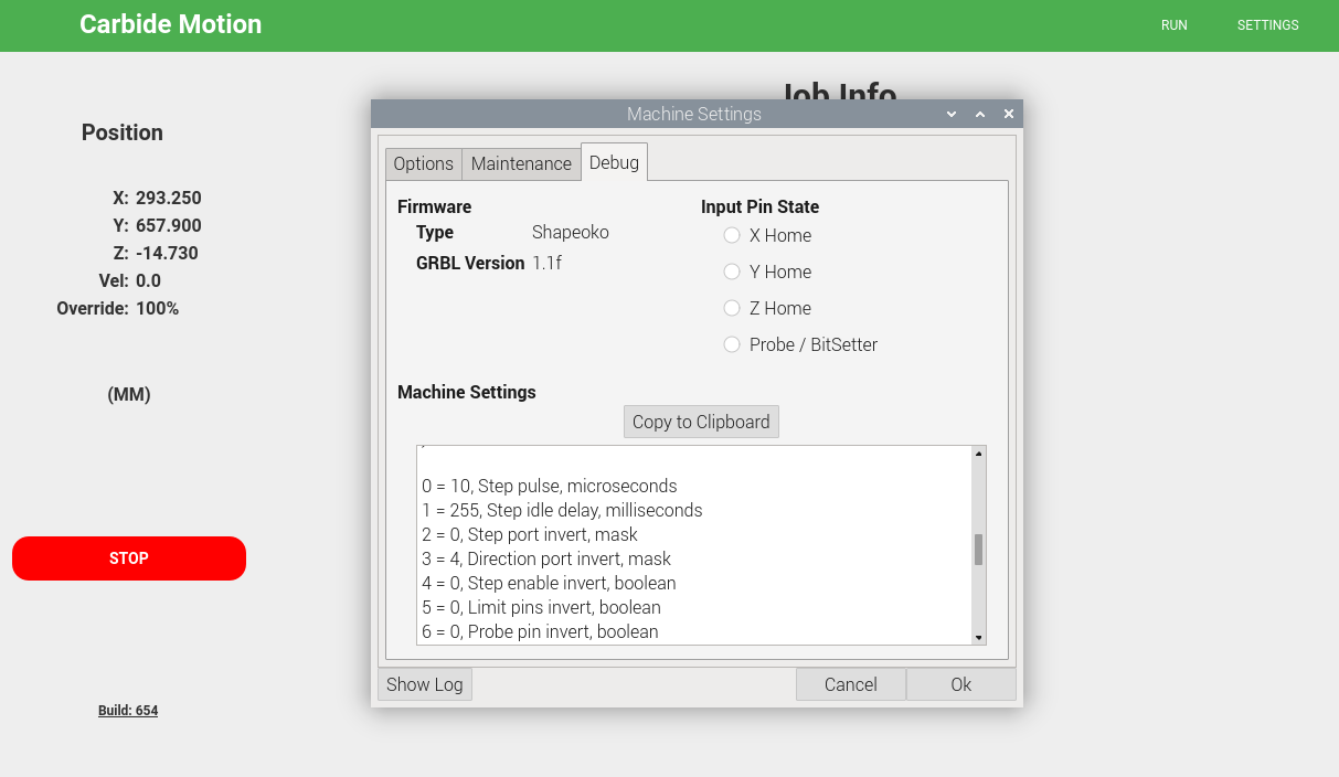

To see the GRBL settings, type $$ into the MDI

MDI in carbide motion never displays responses on my shop laptop, although it will accept motion commands. I’ll get another terminal installed and see what my machine settings are later tonight.

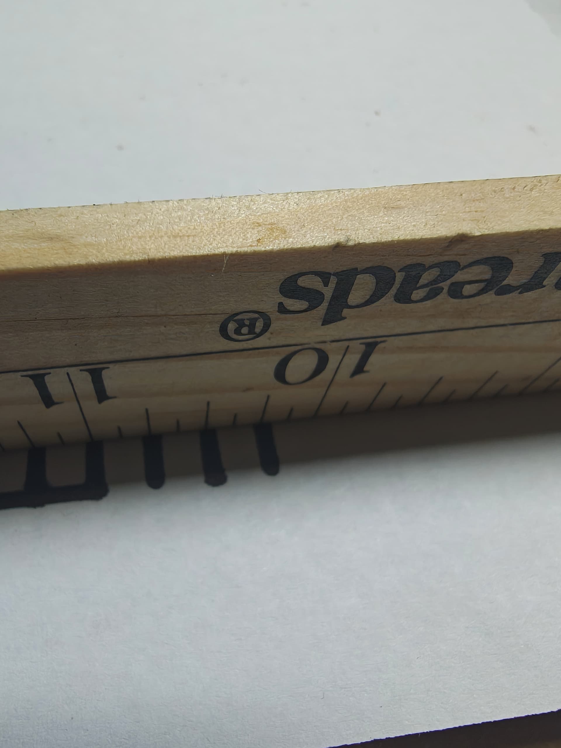

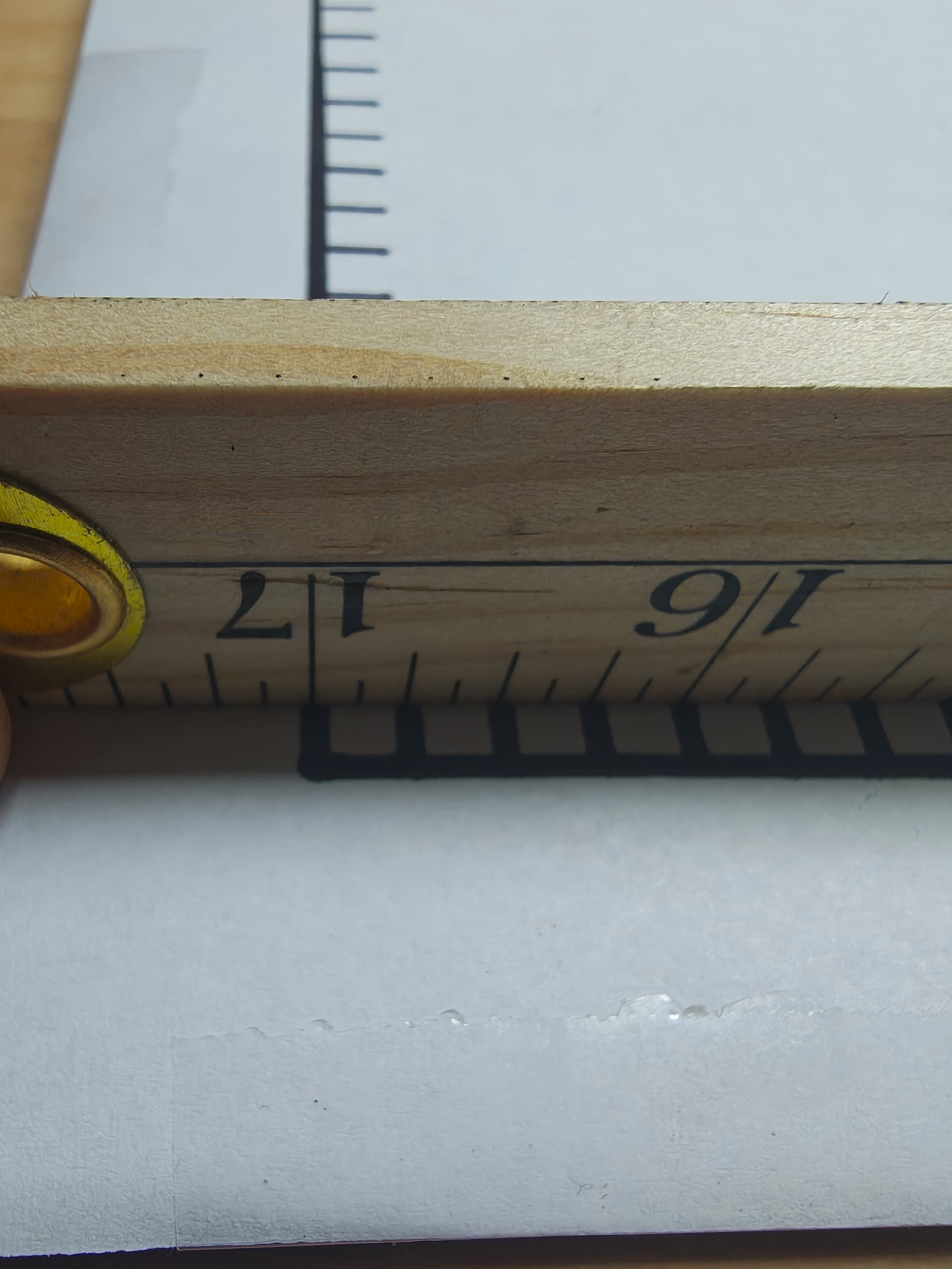

I have stared at the c2d file, your picture with the ruler, and the toolpath simulation way too much but I have about convinced myself that your cut has errors in both x and y such that the machine is moving only 85-90% of the distance it should be in both axis. This might suggest a configuration error ( or a Bozo error).
You have to open the listing / info window to see the feedback from the machine. :wink:

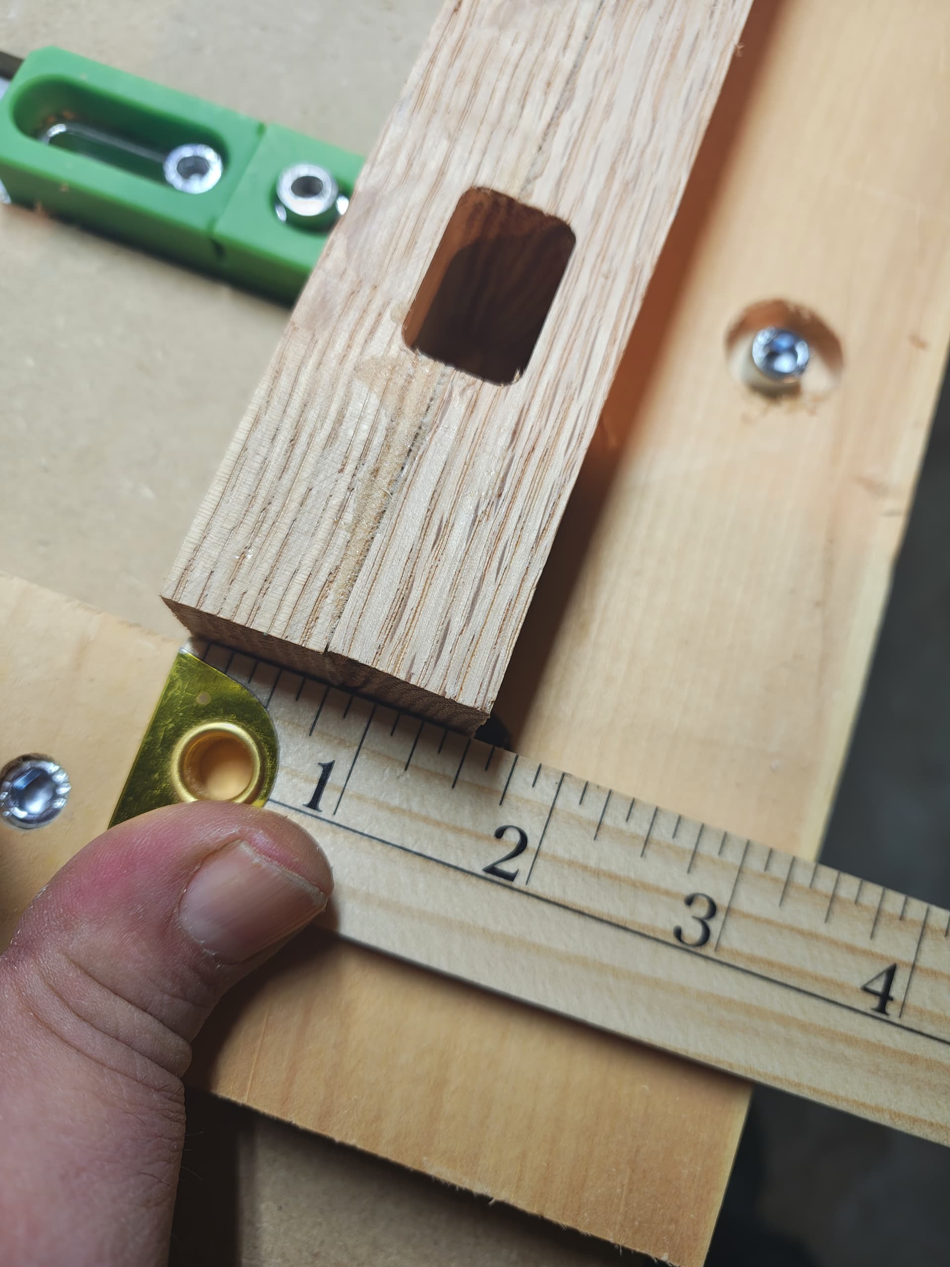

I measured x cuts quite a few times, it’s accurate. the thicker lip on the right hand part of the work piece was intended, as I wanted a place to confirm depth of the cut easily.
if multiple axis were shorter than expected, it would be much easier to figure out what’s going on. Just one is weird.
the weird part is that it consistently cuts 1/8in offset on y, all of the operations are 1/8 inch offset on the Y axis, not just the one that left the visible flaw. same amount of offset on both front and back, i.e. mortise is correct width, just 1/8" off center. so i don’t think all ops are short.

The rectangular pocket measures 0.625in tall and 1.0 in wide? I tried to gauge its size from your photo and was unable to confirm those dimensions (parallax made it difficult). I kept getting it undersized by something around 0.1 inch.
You may also just simplify things and cut a contour of a circle and square, looking for accuracy.
You can find your Machine Settings in the Debug tab under the Settings Window - no need to muck with the MDI command line. It shows all the Carbide Motion program settings for your machine & lists the Grbl settings in your machine controller along with definitions of what the values represent.
While it seems unlikely that your machine setup is incorrect, it’s not impossible. I’ve had my Grbl settings inexplicably get changed/reset/corrupted a few times. Then if you can verifty that your spindle movement matches what you tell it to move, that helps a lot with troubleshooting.

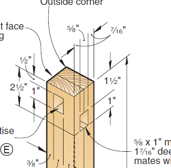

the mortise pocket was exactly 1" along x, and 5/8" along Y, and 1 1/2 from left edge, all correct as designed
looks like i didn’t take a picture of the mortise (rectangular pocket) showing that instead of being 7/16" from each edge, it was 5/16’ from one side and 9/16 from the other.

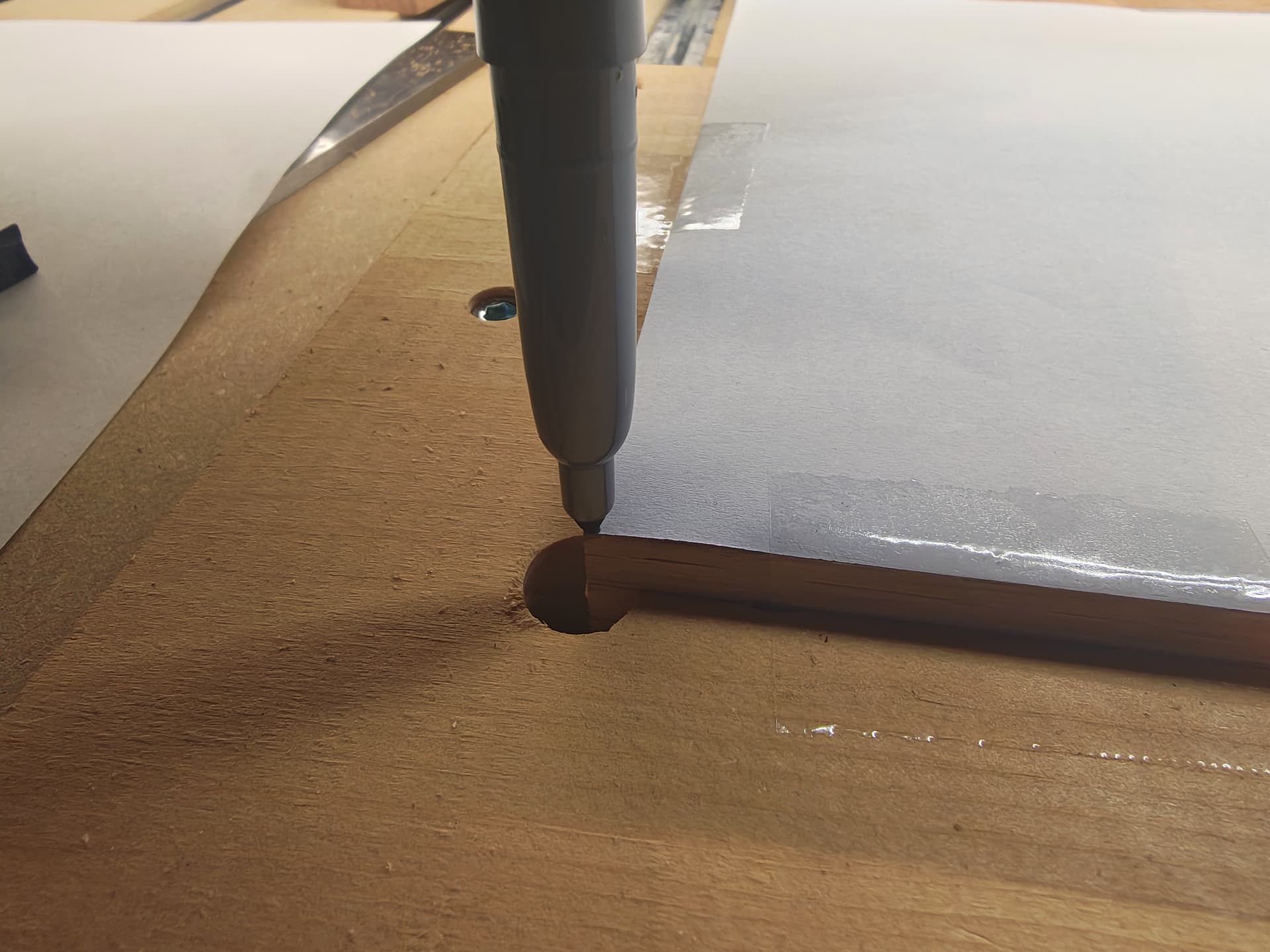

Tonight, I’m strapping a maker on it and drawing a bunch of lines ever 1/4", starting 1" from origin.and will measure them.
I’m thinking that I know I resized the work piece after adding vectors in ‘job setup’. I re-centered, but I’m wondering if the old size is sticking around somehow. If that’s the case, drawing a grid will draw perfectly, and my solution is to never redo ‘job setup’ with existing vectors, even if you re-center than.
?! That is the equivalent of $$ output?! I guess I haven’t been paying attention because this is the first I’ve seen of that… Maybe too much mucking with MDI… :slight_smile: Thank you for pointing this out.

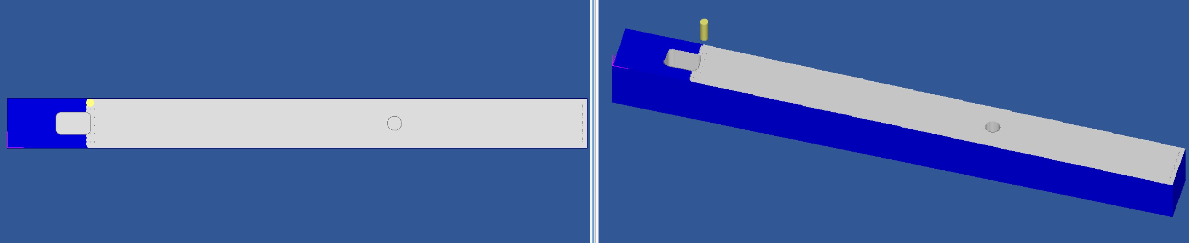

@Bozo here’s the gcode from the design the produces the offset.
in case you want to replicate exactly, the stock is 18" along X, 1.5" on Y and 1.75" along Z. rectangle pocket is pretty deep, so the 1/4" endmill needs to stick out at least 1.5 from collet.
end result expected would be a 1/2" lip on the far right (x axis), that is 1/4" deep.
OK, I zoomed in on your earlier photo and realized that the rabbet radius looked larger than 1/8" [edit]Running your gcode through CutViewer Mill (the ancient, standalone version) shows a proper cut…

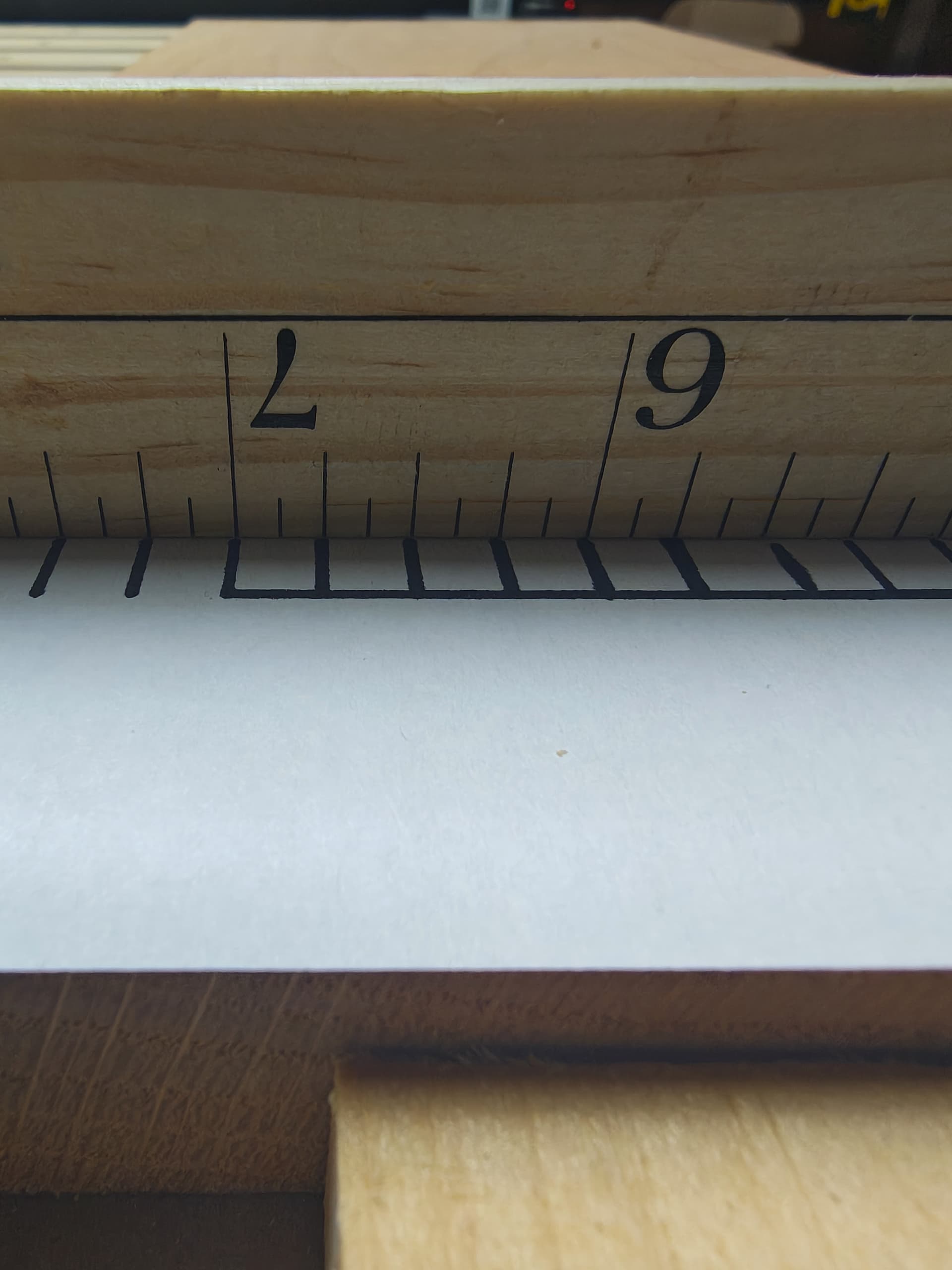

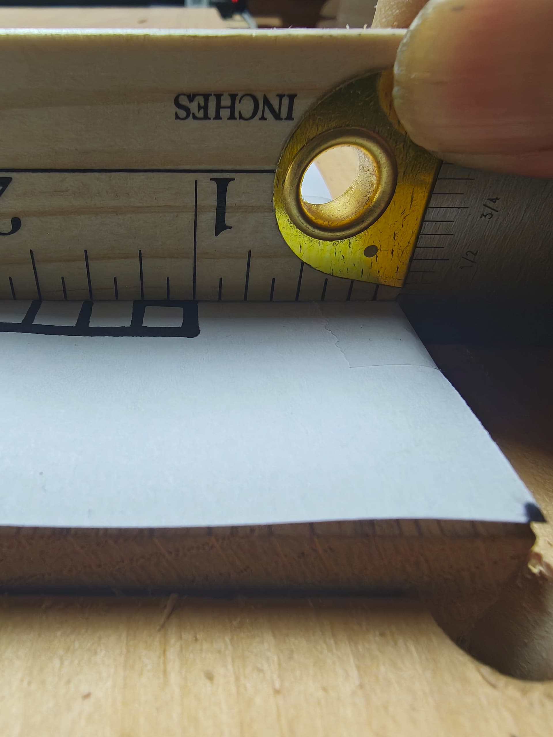

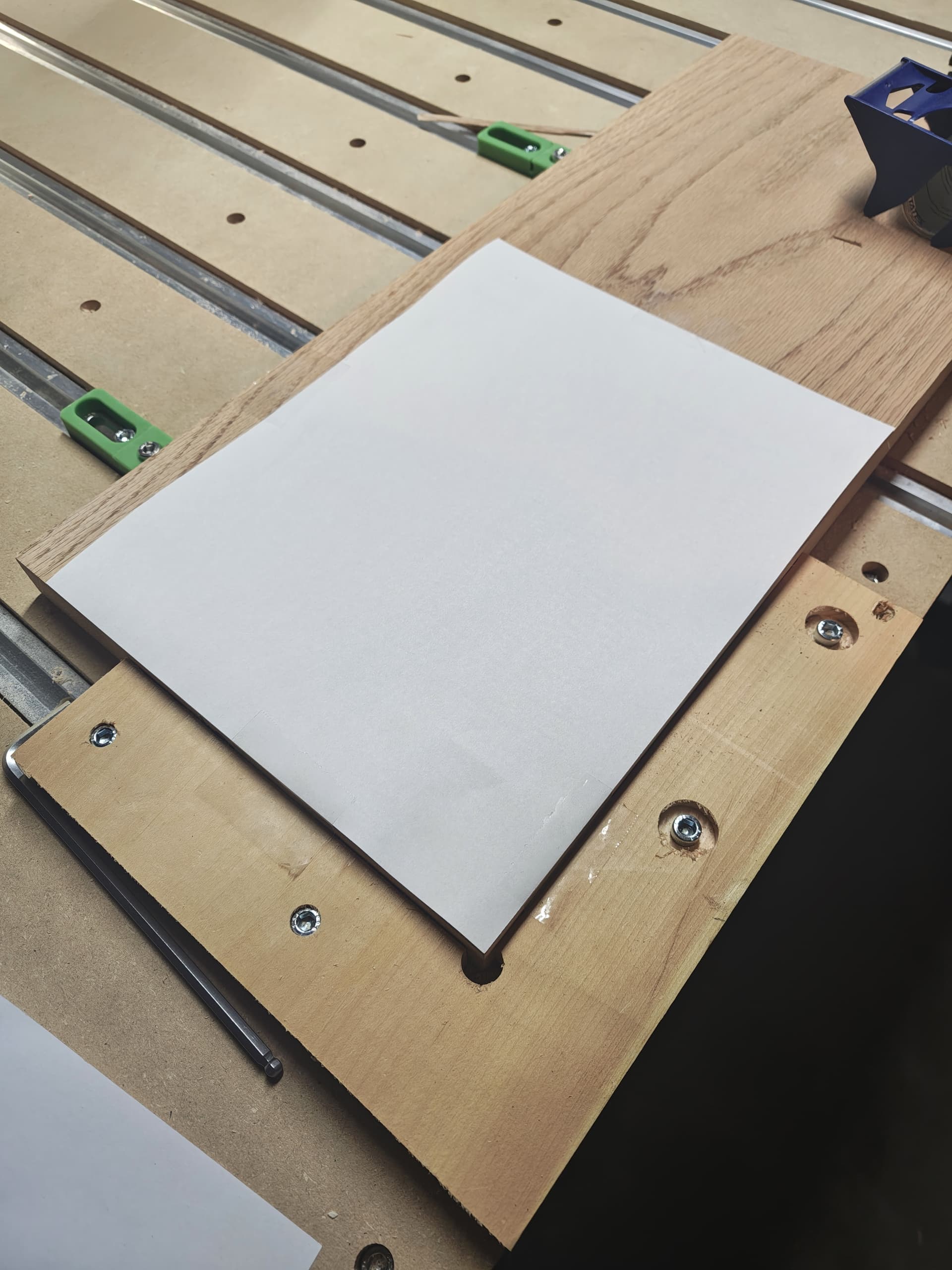

okay, drew grid. no offset.
so the differences between this grid and the design that had an offset (other than the different things to draw/cut!)
  • design was never resized via ‘job setup’
  • zero was manual instead of bitzero v2
  • machine wasn’t cutting.
    photos first, and my thoughts of how to test these scenarios at the end.
setup was the same square, so operations were taking place at the same~ish place on bed:
Manual Zero:
Y axis (where I had offset before):
X axis that was fine both times:
Now my thoughts on testing, and I’d love feedback, on best ways changes as few things I’m not testing for
Test 1: design was never resized via ‘job setup’
resized design → draw a square on paper, centered, run it.
resize paper via ‘job setup’ recenter square, run it.
if the job setup introduced an offset, and it’s repeatable, the second run will have an offset
test 2: zero was manual instead of bitzero v2
cut something zero’d with bitzero
cut something manually zero’d
if there’s oddness with my bit zero, i should see the offset on the first, but not the 2nd
test 3: machine wasn’t cutting.
test 2 should have offsets on both cuts if cutting is causing the offset
anything y’all suggest to alter on the tests about, or something else I should test?
