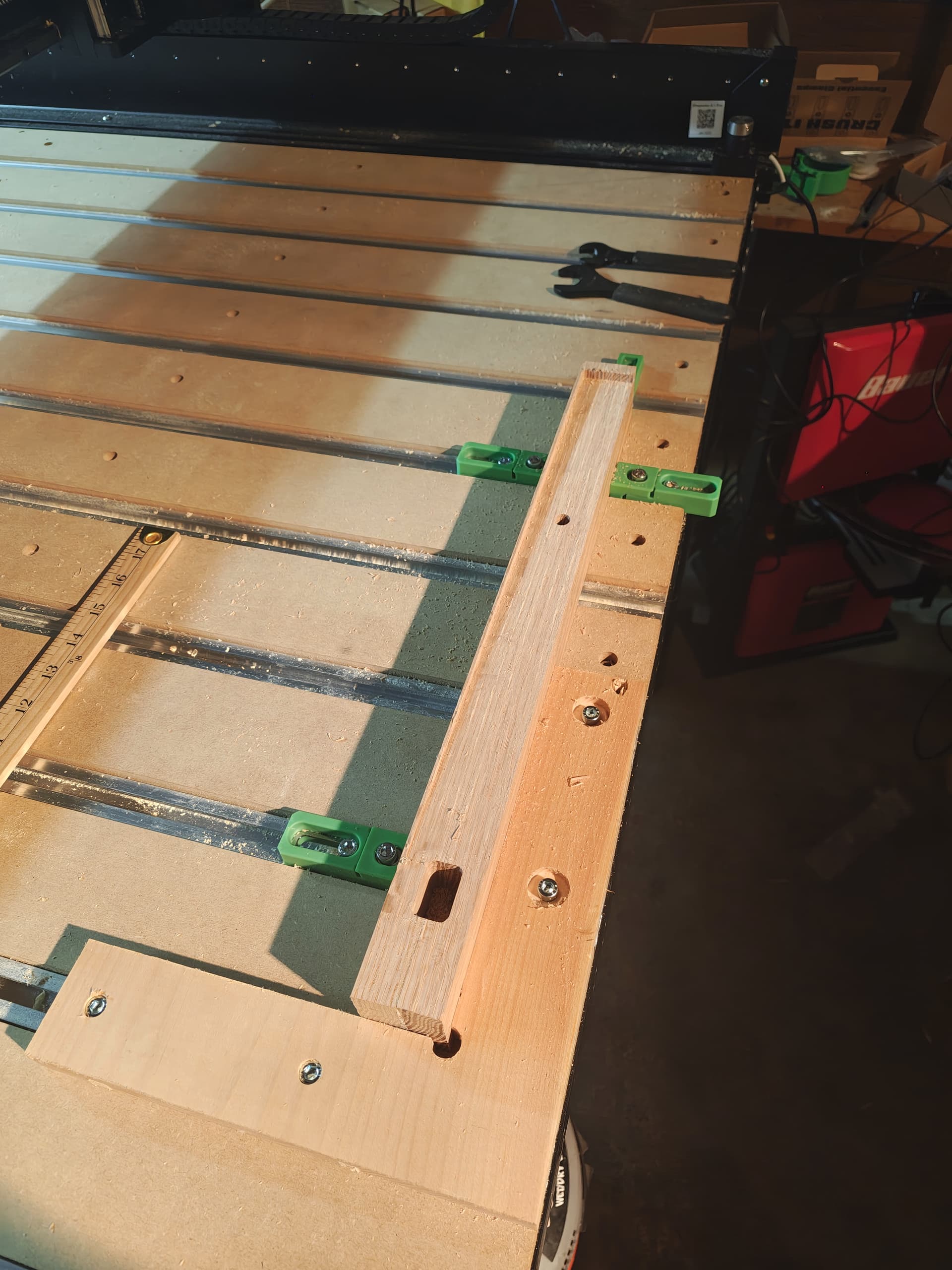

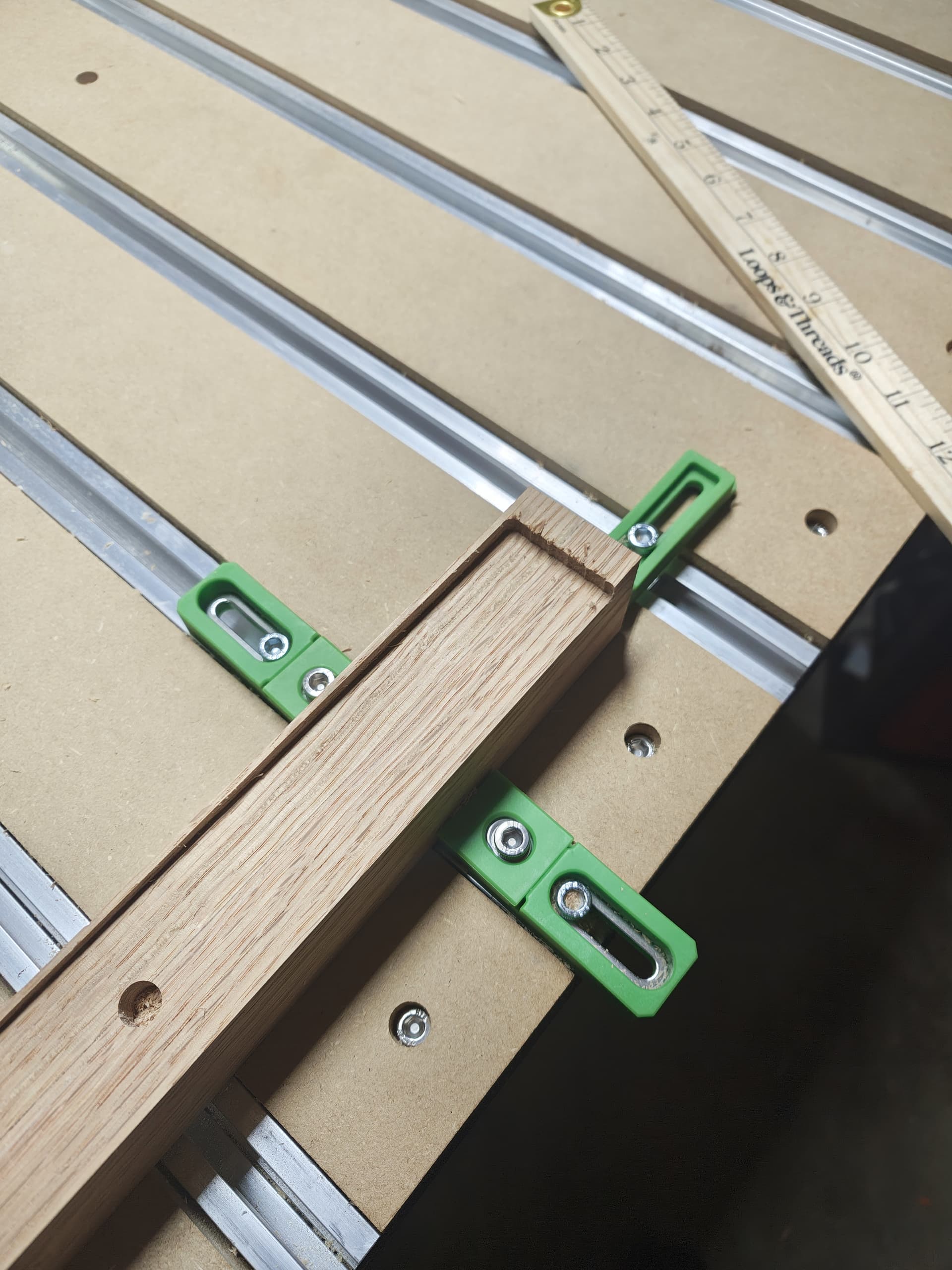

I’m not sure what is wrong. the operations cut 1/8 inch off from where it should in the y direction the work piece. x and z cut exactly as it should.
My thought is, that if I used my bitzero on the corner incorrectly, it should be off by the same amount both x and y.
I know i could redo the bit zero operation, jog it the 1/8in and reset the y zero, but that seems like a crappy work-around.
Pictured is the issue, it should have not left the 1/8th inch lip, all other features are also 1/8th inch off center
Photo of the entire part?
Where was zero set relative to the part?
Where was the origin set in the file?
How did you square up the stock to the machine?
I set zero via bitzero so it should be the front left top of the part.
I’m not sure how to set origin using carbide create.I’m fairly sure it’s always front-left-top in carbide create
I previously cut an L- with spaced holes, to use the rails to keep everything square to the machine.
I also checked with a ruler, my amount of inaccuracy doing that is good enough for the work piece.
If I have a piece of stock where I want to hit dimensions exactly, I mount a sacrificial piece of MDF, cut a pocket (with dogbones at the corner) for the stock, then clamp the stock in the pocket.
That makes sense, I cut out an L-bracket to hold it square to the machine
