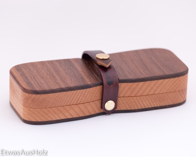

Finished a couple of these yesterday.
I tried to go all natural and finished the wood with linseed oil and wool fat. Probably overdosed the fat, you see fingerprints on some boxes.
Will return to bees wax next time :wink:

Superb. I really like the interlocking lip on the box pieces. I assume you glued the walnut on before doing the machining.
Makes me wish my glasses weren’t on my head 100% of the time.
Thanks.
No, the glueing happened after the machining.
That way I can do a contour cut instead of pocketing.
The inner cut out part is good for further machining into bottle openers :slight_smile:
