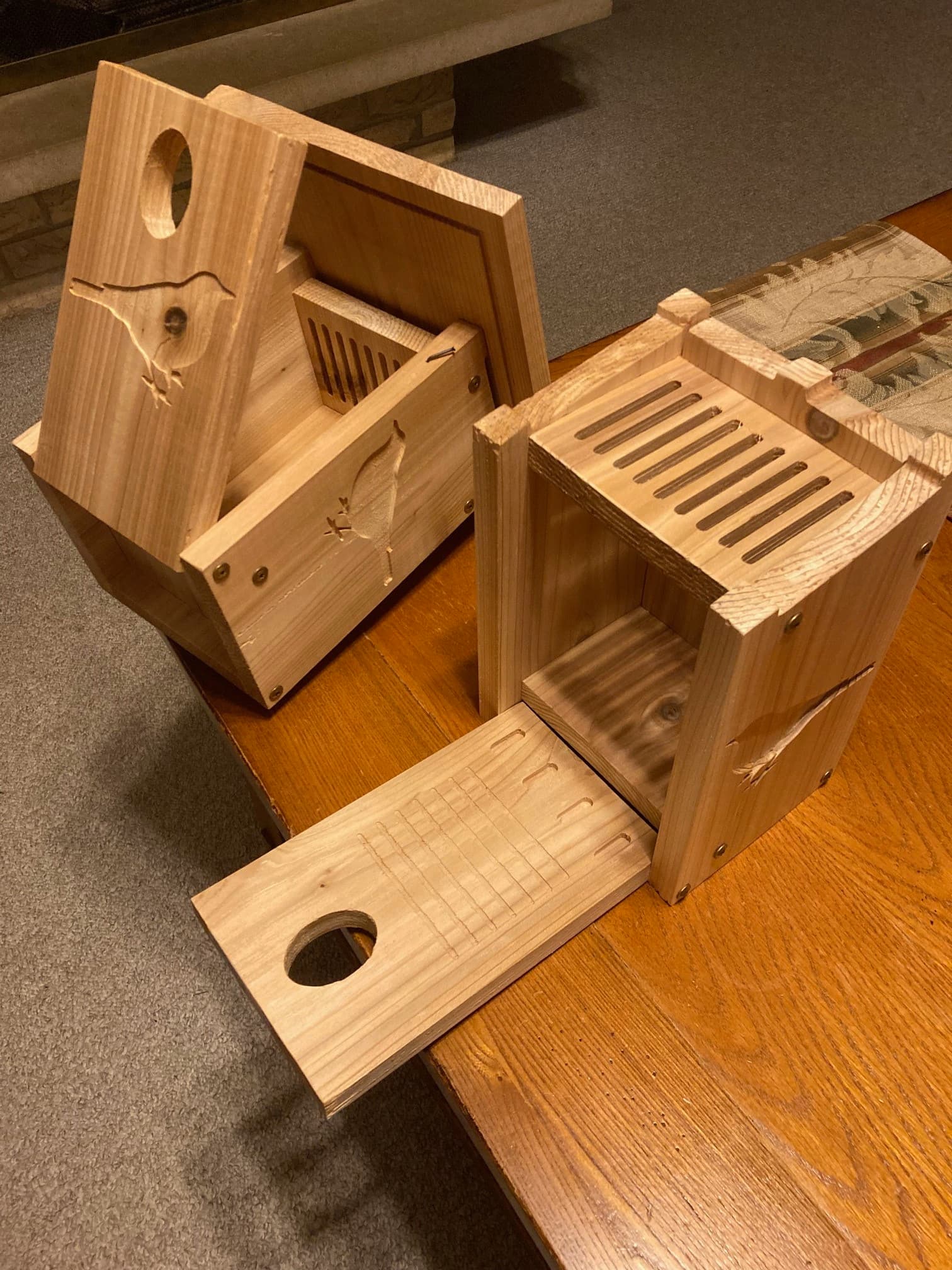

Bluebird houses (1 less its roof to show ventilation detail). 4 ft cedar 1x6 for the box and a section of cedar 1x10 for the roof. 1/16 endmill to pocket the birds. Turn over board and finish with 1/8 compression and 1/8 upcut bits. Dados in the back and blind dados in the sides to accept the floor and ceiling. All press fit. All screw holes in faces are pocketed by the shapeoko 3. Finish cuts are all done on the cnc. Tried to maximize top ventilation while minimizing water intrusion. After months and 23 toolpath revisions, finally have a birdhouse people want to buy for less than the cost of the wood :rofl: I have given away 20 and sold 1. FYI they do attract bluebirds.

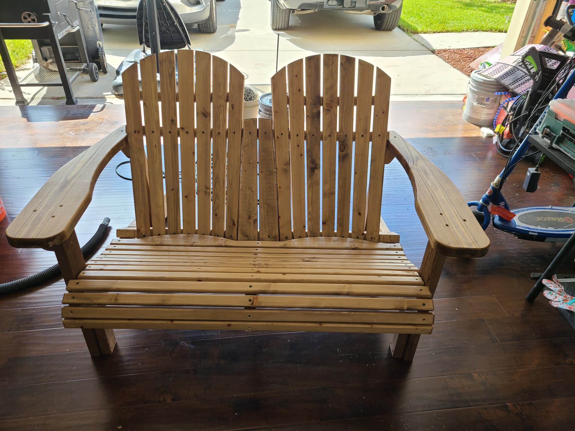

Makes sense I made this out of pressure treated decking boards 5/4 priced at lowes for $6 and took 7 boards so not too bad. I have the double and footrest as well as standard and folding adirondack chairs from rockler. My daughter built the double for a school project a couple years ago. If the storm doesnt wipe us out too bad i could copy all the templates and give them to you for some walnut!

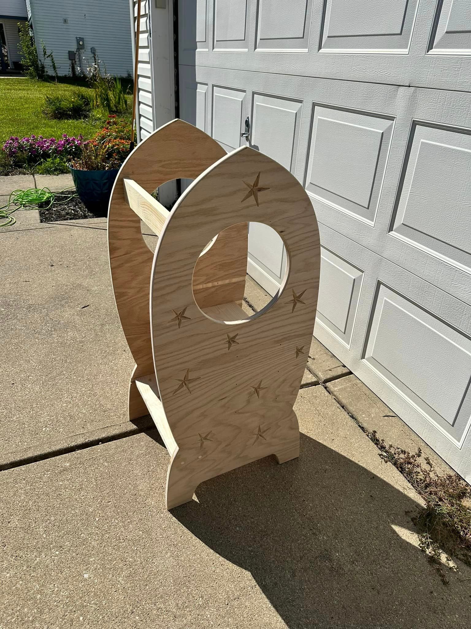

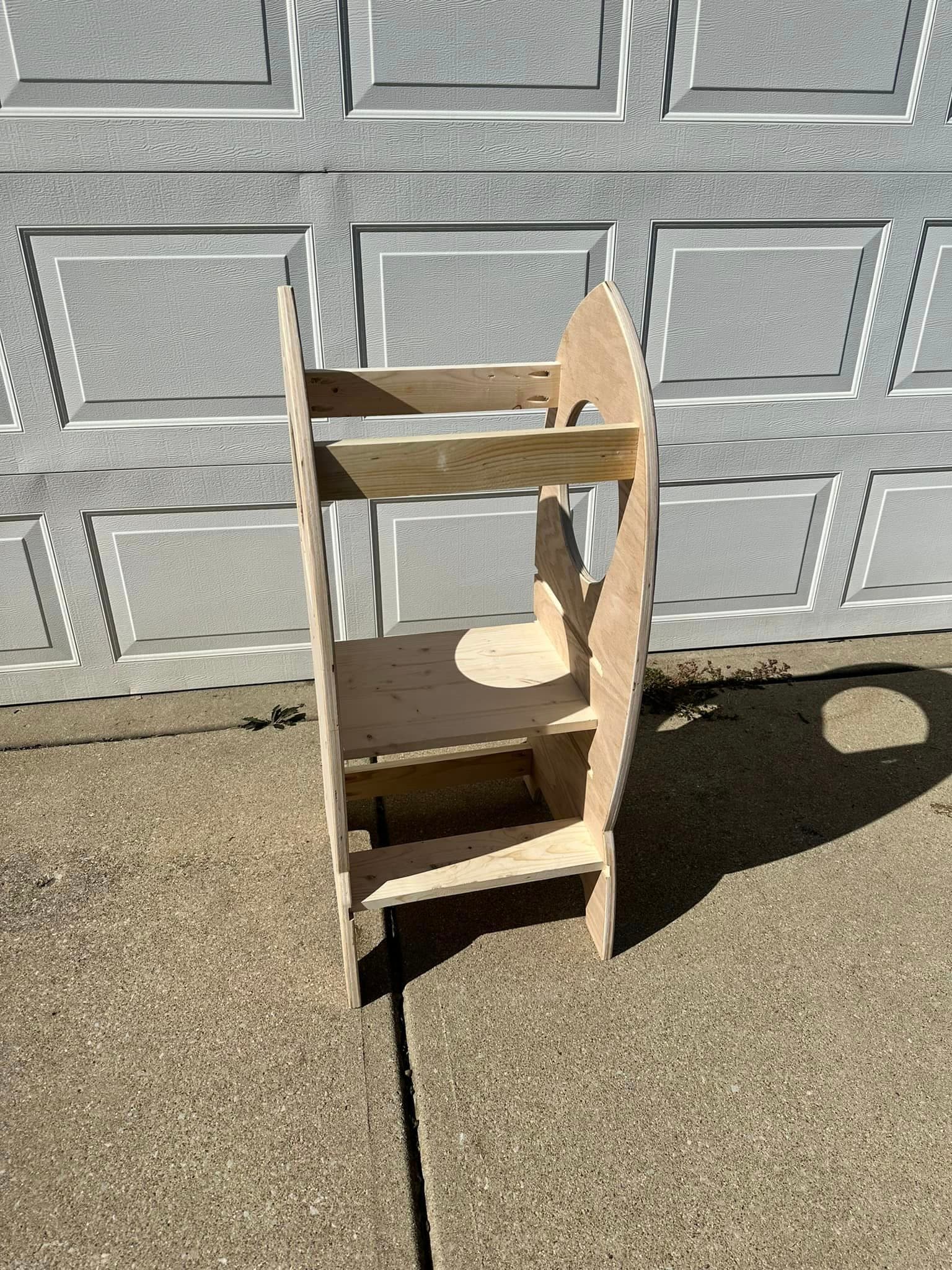

Today I cut and assembled my first large scale project on my S5P! A kitchen helper step stool for my little ones. Decided to let my 4x4’ stretch it’s leg on a double sided project. Wanted to challenge myself. Eigenbot posted similar plans on cutrocket but with tiling, and since I have a machine large enough to cut it all out in one cut, I decided to use inspiration from their design to model it to my liking and give it a shot. I also wanted to vcarve the stars so we could paint them.
I’ve only been using a CNC for about a week. I’ve never done woodworking before, although I have used a chop saw a few times in the past. There are a few things I’d change but overall I’m pretty satisfied with it. The machine did its job very well, even on the oak plywood.

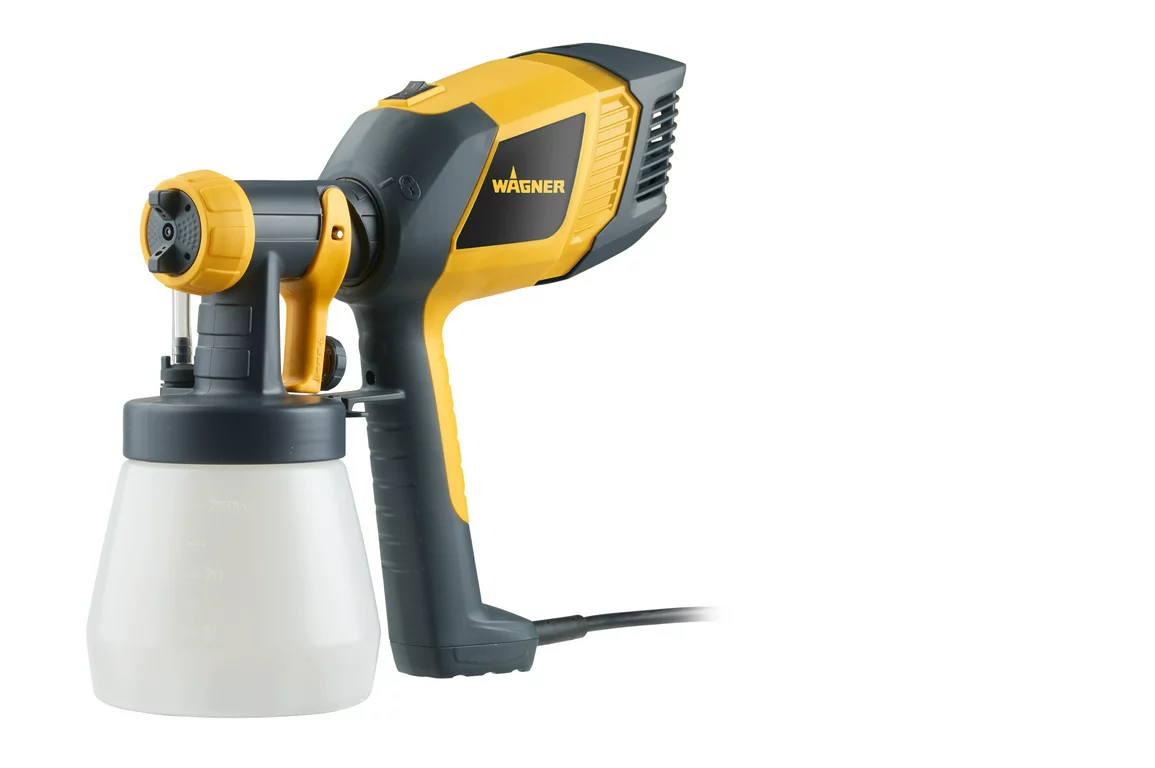

I use a Wagner paint sprayer to spray the stain. The stain is quite thick but the Wagner works good. I have an Earlex HVLP sprayer but it will not spray thick paint/stain. It has to be quite thin to spray. So the Earlex is good for polyurethane and other thinned paint. I have used Floetrol to help thin paint and get it to flow better on the surface.
I just used the Wagner today to spray a cabinet. The paint was very thick.
The sprayer is easy to clean up for water based paint/stain. There are only a couple of parts to clean. The Earlex takes over an hour to clean thoroughly so I only use it for large projects.

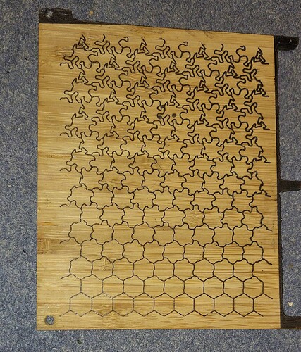

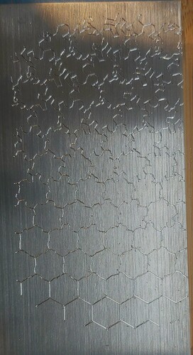

I thought i would have a go at some Escher-esk design, the tesselation design.
Still early days. I have a method of creating a design using the resource from this great website on Escher and the approach in this YT video by Entagma using a free version of Houdini by Sidefx. I modified the program a bit.

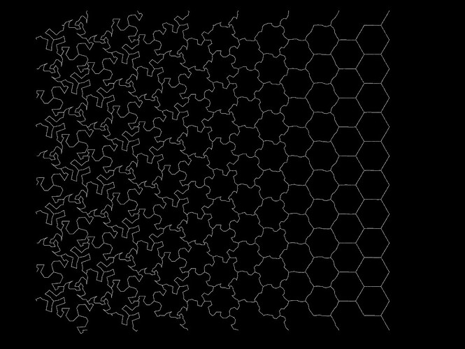

I have attached an image of a quick engrave using the diamond bit etcher on Aluminium. Its hard to photograph the aluminium because of the reflections but if you zoom in you should see some squashed lizard/tortoises tesselating and transitioning to hexagons (hmm, isnt it always the case, when you post something you see something wrong - a couple of my lizards are headless - thats tomorrows geometry problem). I think i should try it as an inlay with constrasting woods, meanwhile i have attached an image of the file.
Any thoughts as to what would make a good tesselating shape (Escher is quite the genius)? Any thoughts on application? (i was thinking of an Hexagonal chess board
Machine: Nomad
Material: Aluminium
Bit: Diamond drag bit
Software: Houdini and VCarvePro

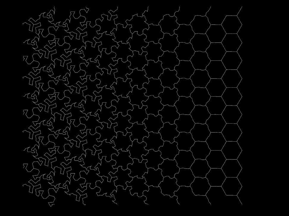

EDIT:
I resolved my pattern issues. See Below:
The challenge now is that I would like to do an inlay project but the I think the design is so tight that I can not get enough width in the lines for an inlay.

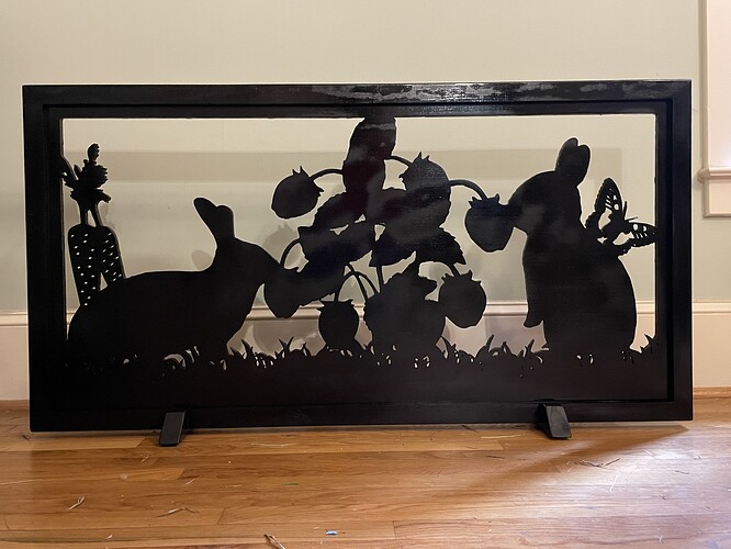

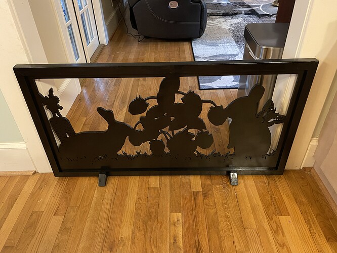

I finally had time to finish my Bunny Barrier to keep the rabbit out of the den. Used tiling to cut the 48” piece of plywood. Then cut a frame and feet from a piece of 2x4 and painted black.
Before painting I put wood putty on the exposed plywood edges and then a coat of shellac to seal the whole thing.
Super happy with the tiling process. I feared trying it but it went smoothly.
Things seem to be just hopping along for you. Cute design. Lets just hope your rabbit does not try to eat the wood strawberries/flowers or the carrots on the screen.
Yes that is a concern. He didn’t go anywhere near it last night but we will see what happens moving forward. Hopefully the smell of the paint will put him off.
