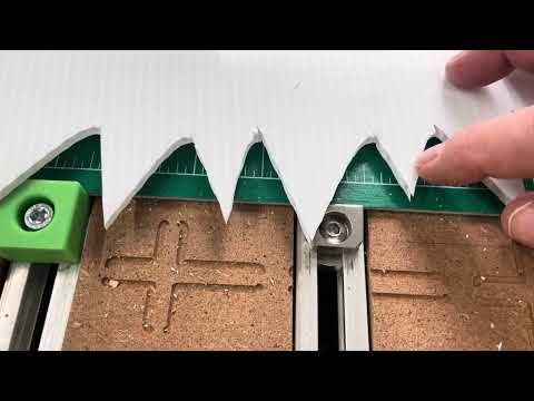

Our Cub Master wanted some plaques for popcorn sales and wanted them to look like popcorn boxes.
I didn’t want to cover nice wood completely with paint so I used PVC. This is what I came up with.
It still needs a little cleanup and a clear coat to give it shine. I am not happy about the visible brush strokes. I masked the whole thing to make painting after carving a little less messy but still have some issues.
I used a #302 for the V carving bits and then an 1/8” O flute bit and a 1/16” upcut.
It took a lot of cleanup after the carve mostly from the V as someone mentioned in a previous thread even though I had RPM pretty low and feed up high. After painting I decided to do a test (should have done it first).
On the left I used the same set of bits but ran the V carve passes twice. It didn’t really help.
On the right I used only the 1/8” O flute and a 1/16” O flute that I forgot I had. So the letters are “square” instead of having the V appearance but the cleaning will be MUCH less.
I guess 2nd and 3rd will get nicer looking plaques than 1st unless I have an abundance of time.
I always lower Z-zero by 0.002" on the second pass; even in wood.
I could try that. In this case I expected the second pass to clean up a little of the mess left from the first but it really looks no different.
I can do some experimenting with other V bits that I have, but for this “job” I think I will forgo the V.

For the red, you could spray paint the PVC first and then cutaway to the white areas. For the popcorn where you want it to still be elevated, you could do a 0.005 pass to just clear off the paint. Just a thought. Looks great!
Thanks. I thought about that and may give it a try. The black outline of the popcorn at the top makes that a little tricky as I painted those grooves with the masking still on the popcorn. I would have to do that, peel the mask and then cut that paint layer.
Or, if I am precise enough I could mask the top only and paint just the lower section with red. And then cut through the mask at the top and shave the paint off the white portions.
My original plan was to paint black in all of the v grooves but decided that was going to be a pain. Would it enhance or detract? What about the black outline of the popcorn? One of my kids asked me why I did that. I thought it would help it stand out but maybe it adds no real value.
You may not need the black, but maybe a ‘buttery’ (light/faint) yellow to give it some division. If you paint the whole piece red, mask it, cut it all out, then cover the bottom with some painters tape so you can then paint the popcorn area and level cut the popcorn high surface area to remove the masking and red paint and cut them out. Remove all the tape and remaining masking and you should be good to go.
It’s a pain to put it back on the table to finish after painting the second color, but since it’s a small area you could mask the wasteboard and machine with some heavy paper and paint them without removing them.
If you want to add a little darker yellow/orange for the kernels that could be done quickly by hand - they are recessed and probably don’t need to be super-sharp anyway. Again, just some thoughts, the yellow separation lines may look weird or be unnecessary.
Hope something there helps LOL
