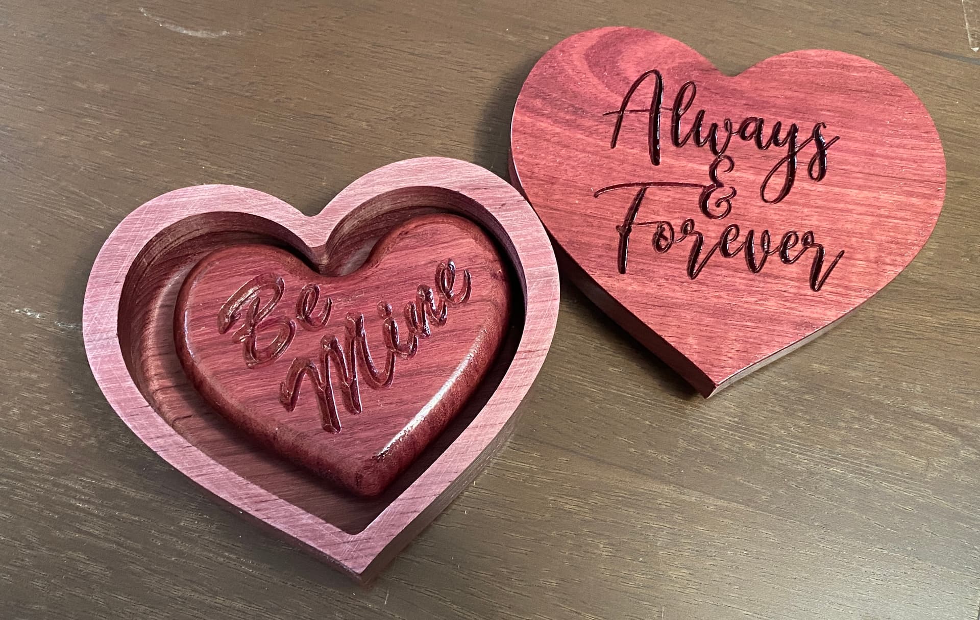

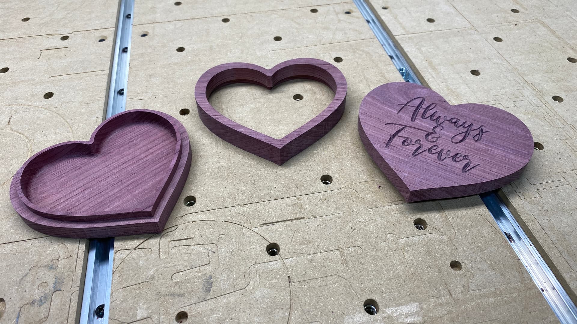

That came out really nice. Just curious, do you know the font name used for ‘Always and Forever’? Thanks.

Unfortunately, no. That text came from a vector in the Carbide Create library. Sorry.
Very good. It’s popular font and wanted to add it to my collection. Thanks.
