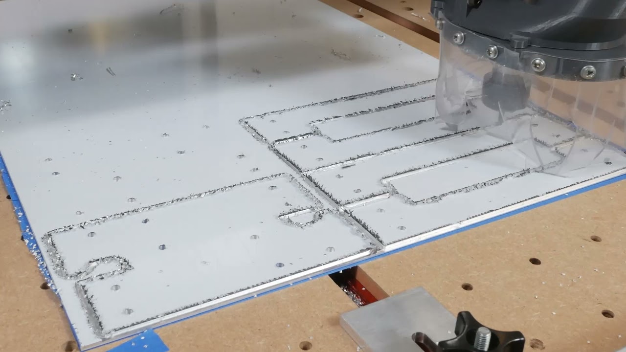

In the meantime, some easy metalwork. I needed to knock up some Aluminium plates to work as decorative / reinforcement plates for some wood strips we’re using as hangars for acoustic treatment panels. A friend is covering the ceiling of his studio in aluminium trusswork and acoustic panels. Yes, the same person I built the desk for.
A quick job, 3mm 6083T6 aluminium sheet.
Z zero on two layers of blue tape on the spoilboard, tape and glue only for workholding
Op 1
4mm carbide spot drill with a squirt of Isopropanol as lubricant to make the holes
Drilling op 3,500RPM in the spindle, plunge rate of 60 mm / min, pecking at 1mm depths
Op 2
4mm APT DLC single flute aluminium cutter
22kRPM
Boring at 250mm/min to keep the speed at the outside of the hole down, 2 degree ramp angle, finish stepover of 0.1mm
2D Contour at 1,000mm / min feedrate 1mm depth, ramping into the contour at 2 degrees, single finish stepover at full depth of 0.2mm to clean up the edges
Op 3
Trend 90degree wood chamfer cutter getting more abuse
22kRPM
2D Chamfer, 0.5mm, 1.5mm tip offset, 800mm/min
