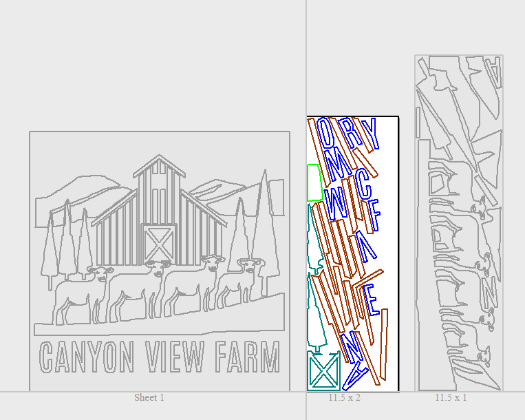

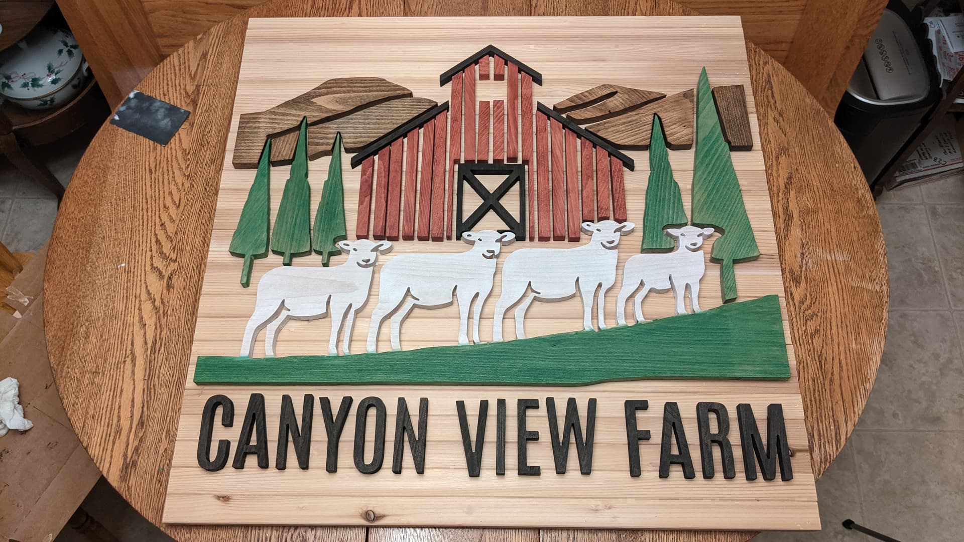

I’m working on a project for a friend. He will have this hanging on his barn facing the west which gets the wind and rain. I live in eastern WA where it is more arid. Thoughts on how to finish this project up. The pieces aren’t glued yet. I’ve thought about boiled linseed oil and and exterior poly. Wood pieces are 1/2 in thick beech. I’m going to use a water proof glue and also use a pin nailer. Thoughts for those that have made exterior signs to take the elements of the weather.

My friend gave me an AI-generated concept that he wanted to turn into a sign for his barn. I took the image and, piece by piece, created vector shapes to have a sharp file to work with. I used 1/2 inch thick beech for the pieces. Using Vectric, I nested the pieces to optimize my wood. Note to self: Set a larger gap between pieces so the wood is stable as the pieces are cut. The base is 1/2 in ply with cedar slates. Sanded all the project pieces and removed tabs. Stained. Now I need to finish things up with a finish and a frame.

Looks great! I would put a good 5 coats of exterior poly on it to help prevent the weathering.

Sending that over to the wet side from the dry side of WA (“where we always have perfect weather”), i agree with Derek. I would make sure it it sealed with at least 5 coats of a material like Spar varnish. Nothing is perfect but that will keep it from needing to be resealed every year due to the constant humidity on the west side.

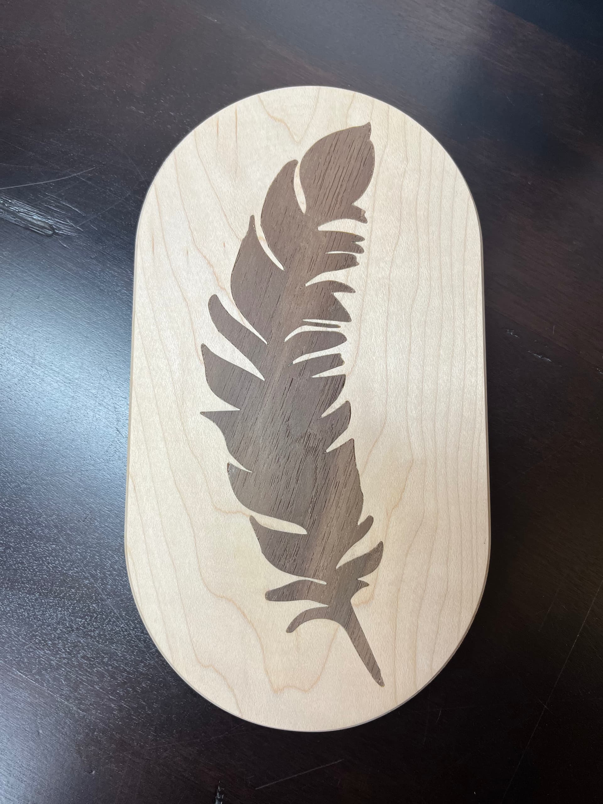

I finally got to doing the inlay in Maple and walnut. I’m really happy with the way it turned out. I did take gdon’s advice and used a 30 degree vee bit… advice well taken judging by the outcome :slight_smile: There were still a few small gaps but I filled them with mixed walnut sawdust and glue, sanded it smooth and you would never know they were there.

Came out really nice! Do you mind posting your tool path settings for the pocket and plug? Thanks!
Sure…
Feather 30 Degree Oval.c2d (164 KB)
Feather Inlay Plug.c2d (128 KB)
