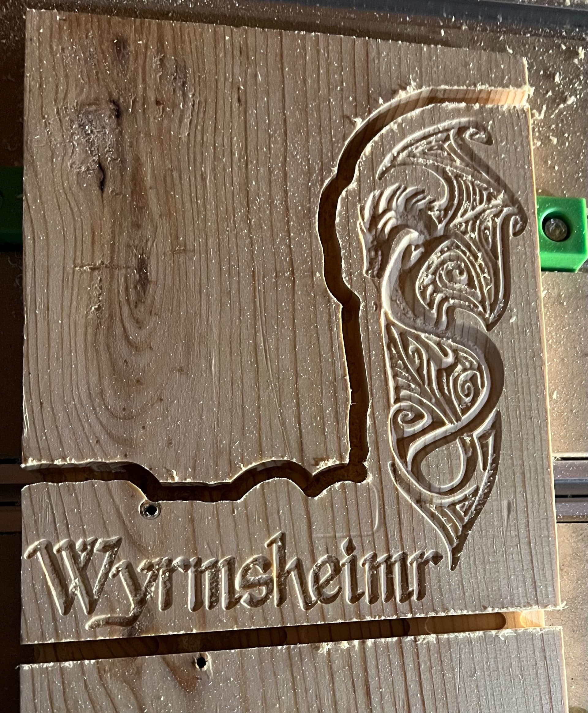

My second project-a sign for my shed. My husband thought Wyrmheimr was a better name than the Dragon’s Lair, and I agreed.
