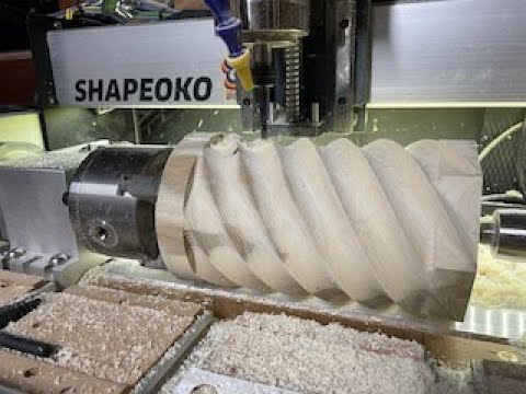

I have been adapting my ShapeOKO 3XL/HDZ to have a 4th, rotary axis. Various experiments and improved decisions on the head- and tail-stock (and stepper torque) have resulted in a very pleasing addition to my machine.
The video shows it cutting a piece of Cherry to make a lamp base. Cut from a felled tree on my land, air dried (ish), rough-turned on my lathe to get a 120mm (circa 5") blank. Created a twisted pentagon design in OnShape which blends from a circular base to a pentagon-ular (?) top as this both looks nice and also presents a number of rigidity challenges that prove or disprove my machine’s new axis.
I intend to write up the mods, but in short form: Replace controller PCB with a 5-axis equivalent, install and configure GRBL 1.1F Mega 5X fork (does 6 axes), mount and true the head-stock and tail-stock, use Vectric VCarve in rotary mode, prove out the Post-Processor (thank you @neilferreri), run some torque and movement accuracy tests and adjust the current (torque) drive into the steppers. Make an enclosure for the PCB and mount it in place of the original. Job done!!

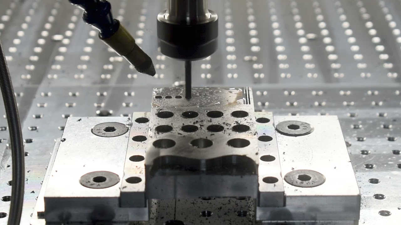

Drilling 4140 Steel on the HDM, no problem.
0.158" 2 flute Carbide drill going 0.500" deep…no pecking. I do recommend the 2.2kw if anyone is going to be doing cuts like this on their HDM though. Mist with Qualichem 251C, 10 Brix.
