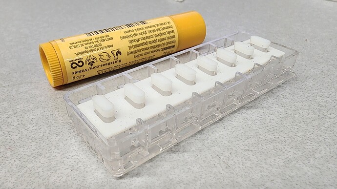

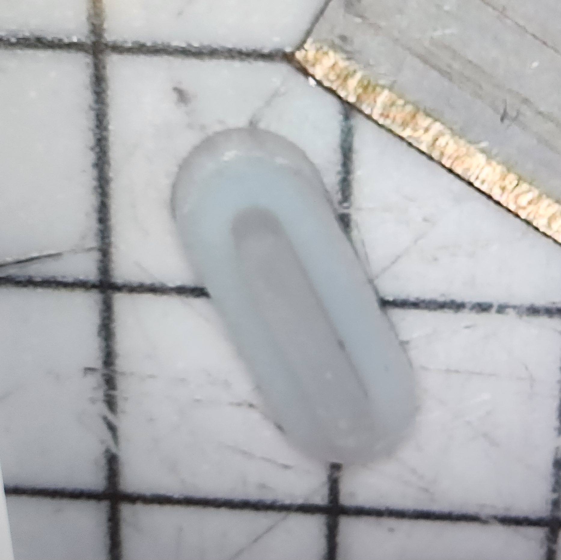

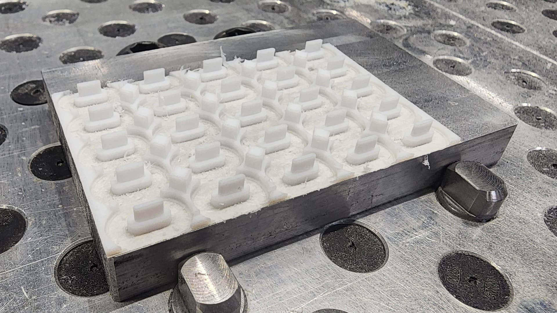

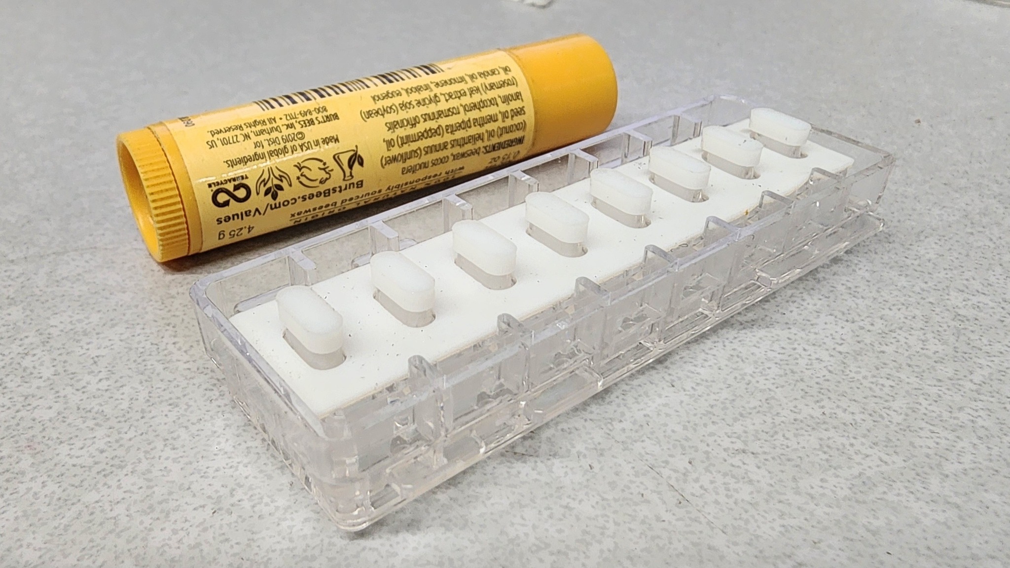

I watched the Carbide 3D YouTube video that @wmoy did about how small a S5Pro can machine. At work we got a job for 125 of these varying Teflon pieces, so I decided to continue the small trend on our HDM. We had made a batch before on one of our mills, but they took a lot of time and needed a lot of deburr work with fuzzies. They fit into the clear injection molded piece pictured and help some medical researchers with a project. The smallest features are 0.15 mm and the overall larger part is ~5 mm. I ran some test pieces to nail a very critical dimension with a negative stock offset. After that I programed the 5 different variations and got to cutting. They were dimensionally accurate to 0.001" and all 125 were repeatedly within that as well. I made extra in each variety in case the double sticky tape let go, or there was a variance. But every part stayed still and was within a very narrow variance and usable, so they get extra. :slight_smile: I switched to a new 0.125", single flute downcut and the parts didn’t require any deburr. They were consistent enough that I found the expensive medical part they fit into had an inconsistency. :crazy_face:
Burts Bees for scale

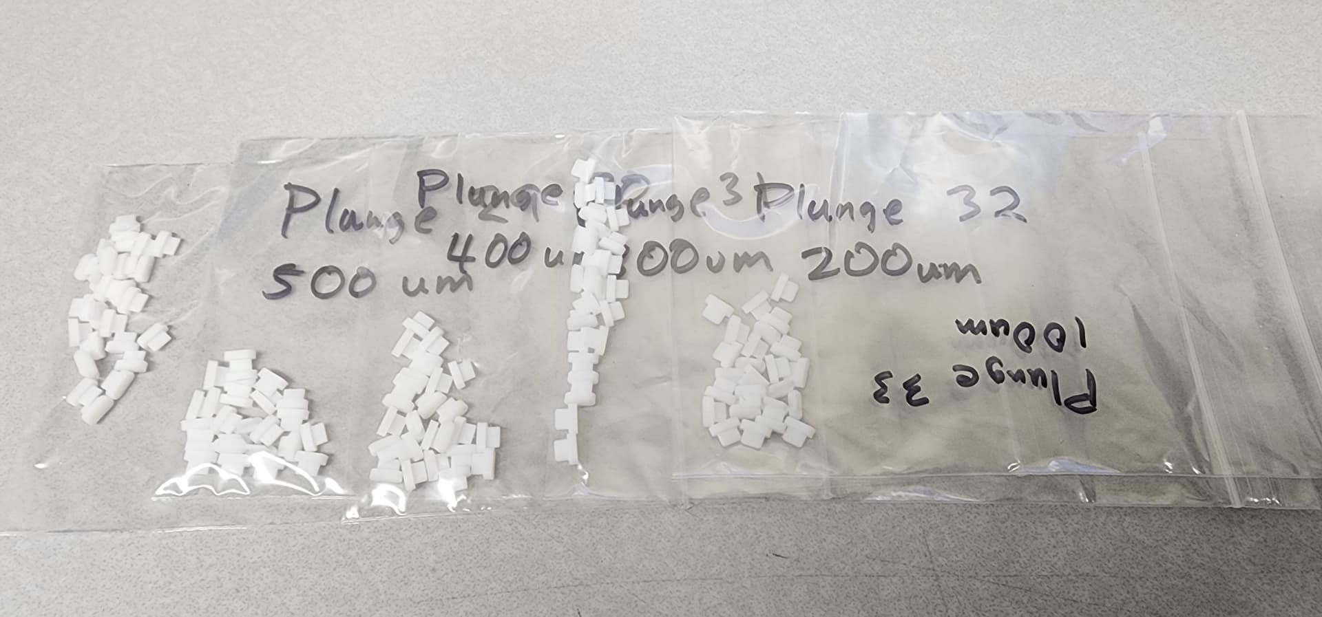

The squares on the mat are 5mm. Razor blade for scale.
I did an array of 25. The aluminum block was machine leveled and parts held down with Nitto double stick tape. Legging a 0.010" onion skin on the bottom until the very last operation kept them in place.
125 super accurate Teflon parts bagged and ready to go.

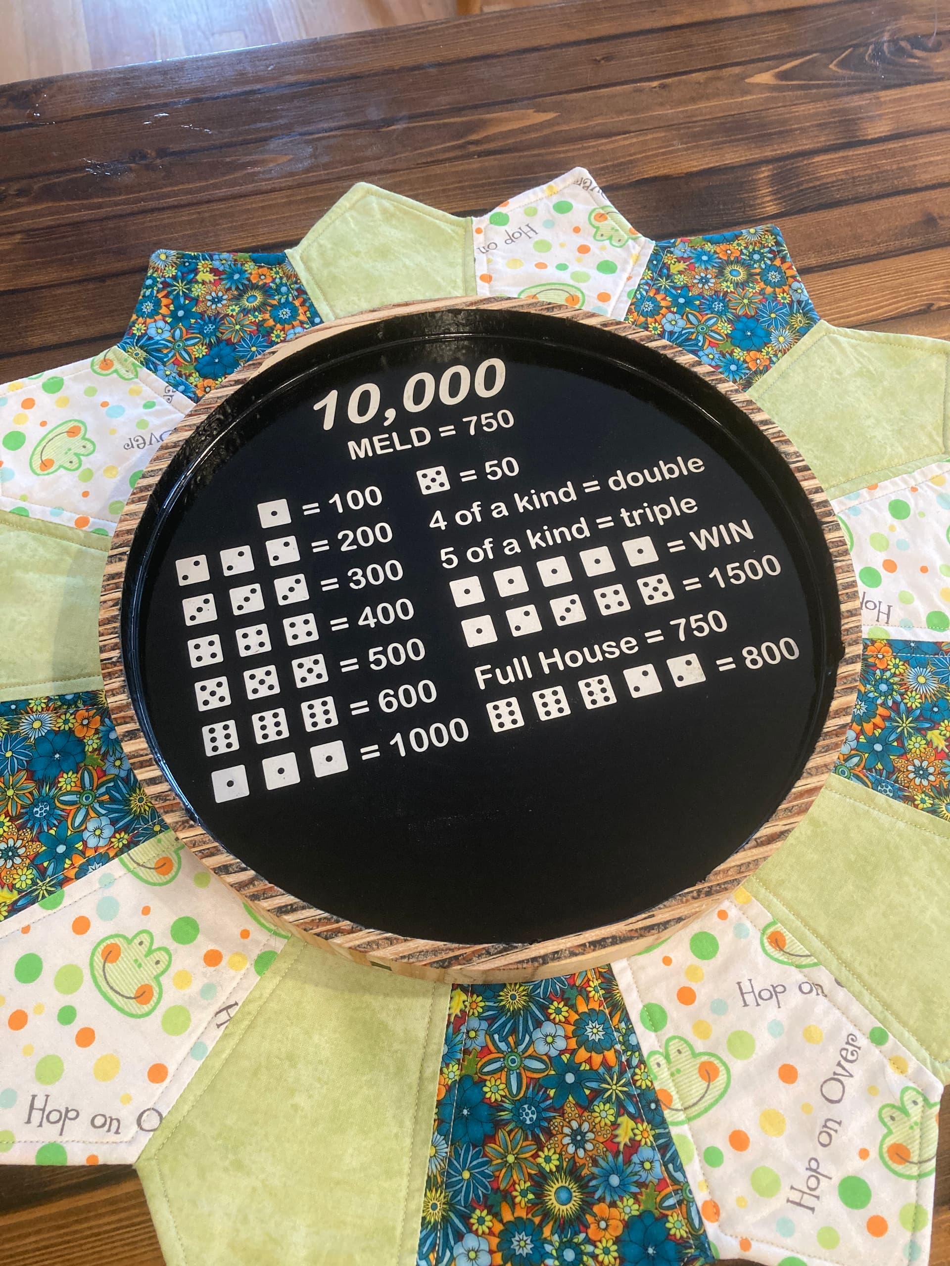

A friend saw a Farkle dice tray & wanted one for 10,000

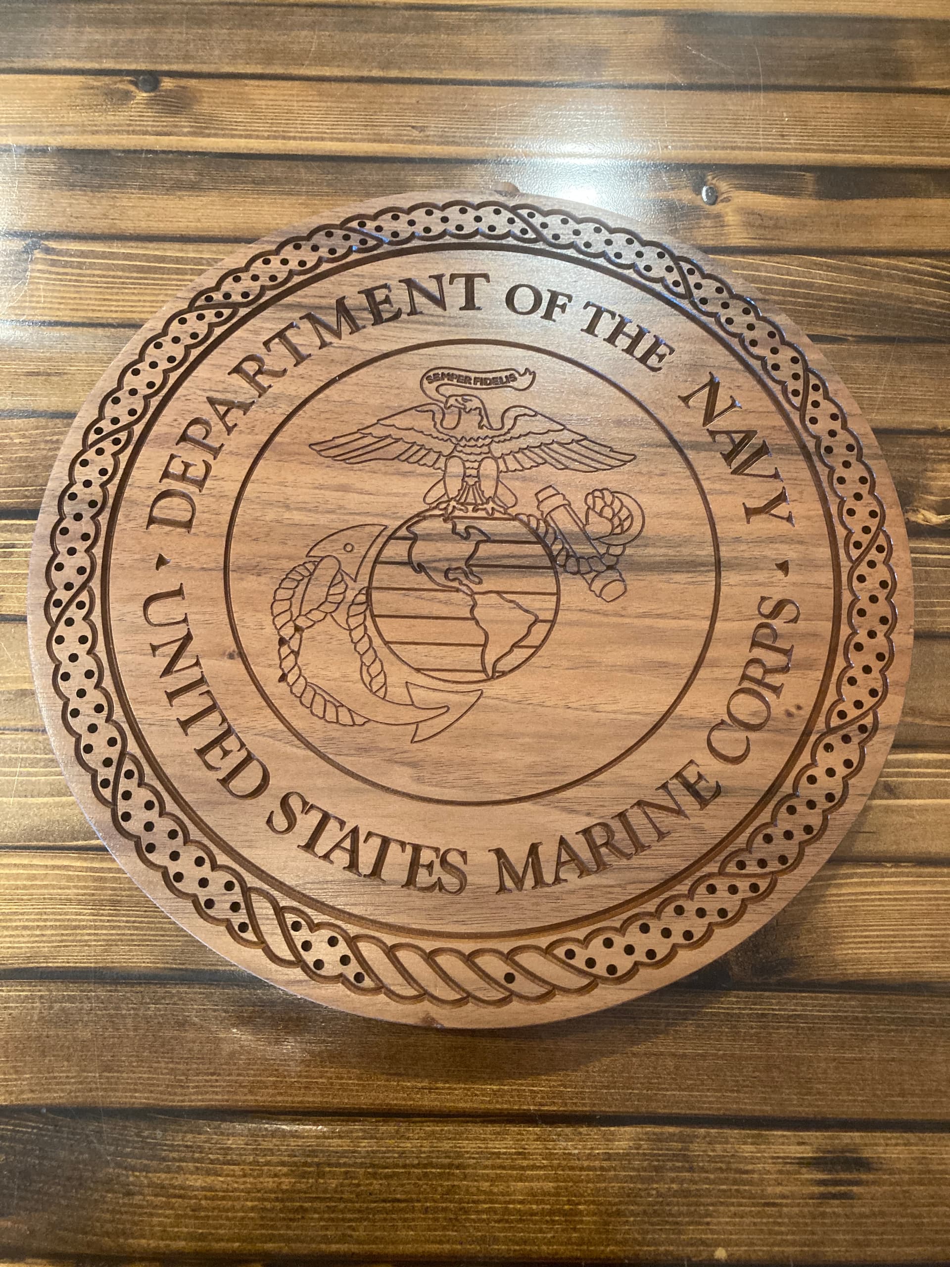

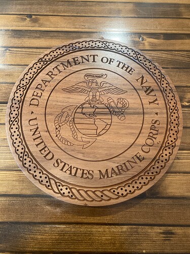

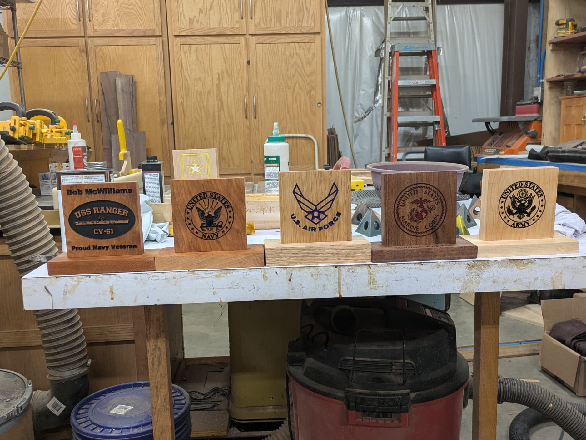

I made some plaques for my woodworking club door prizes for last Saturday. Had Army, Navy, Air Force and Marines. I would have though we had some Marines but either none showed up or we dont have any. I did not make a Coast Guard and had one CG veteran so I need to make him a plaque. Your cribbage board is very nice.

Nice work!! How did you finish your dice board?
The black & white are epoxy, so just one coat of polyurethane to bring out the luster.
On the Farkle tray, a couple of questions.
What is the “container” made of ? Looks like ply’s of something on edge.
I have never done epoxy.
What order of operations did you do the epoxy ?
This made my brain spin.
Yes, plywood strips glued on edge. It’s what I had :smile:
I cut the pocket, then poured black epoxy. Then I V-carved the lettering and rather than wait another day for epoxy, I used white bondo to fill. Then surfaced off the excess and cut the outside profile. A little hand sanding and a couple good coats of poly for durability.
Thanks for the info !
It’s interesting to hear someone else that can’t wait for something to dry.
White bondo, I would never have gone there.

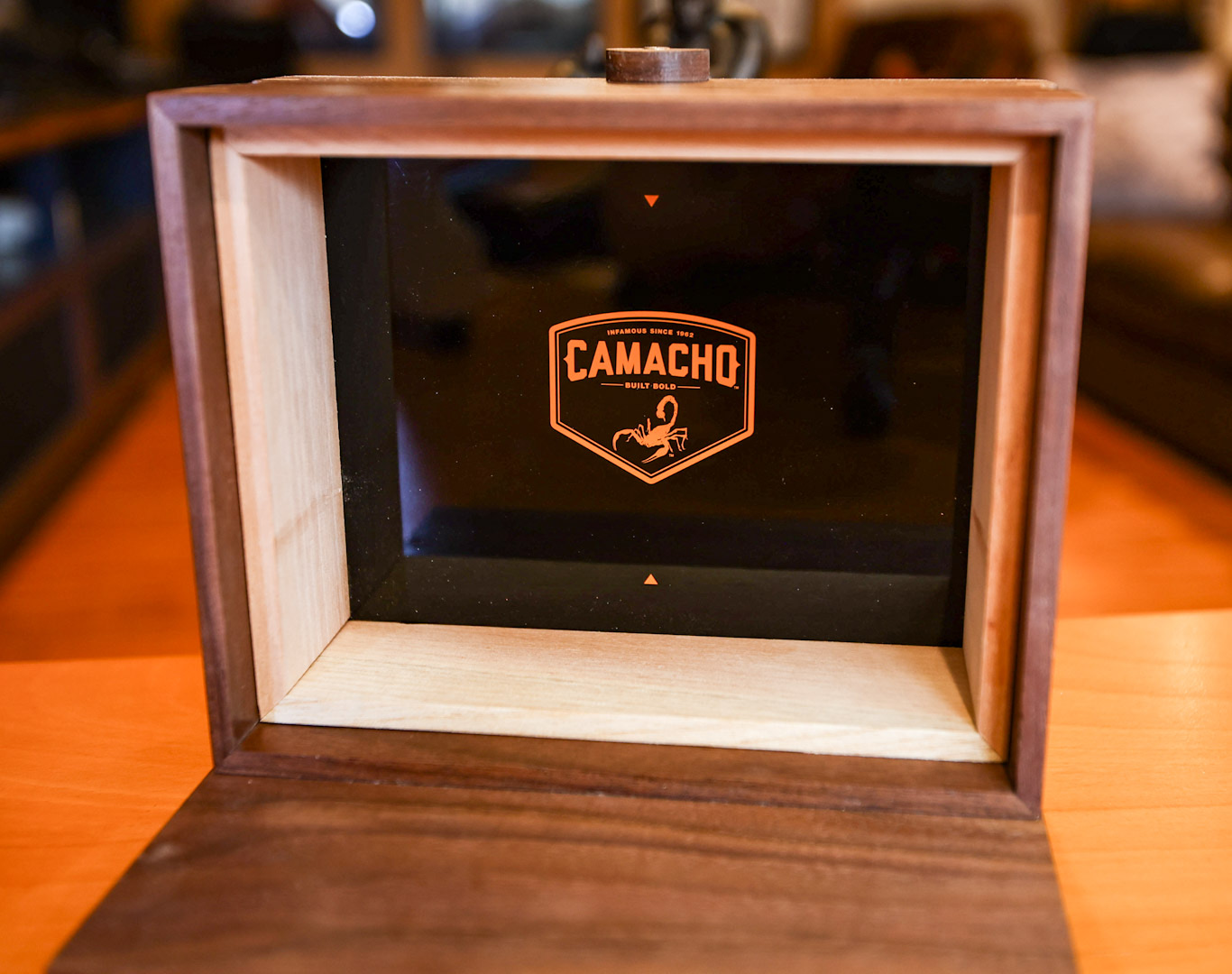

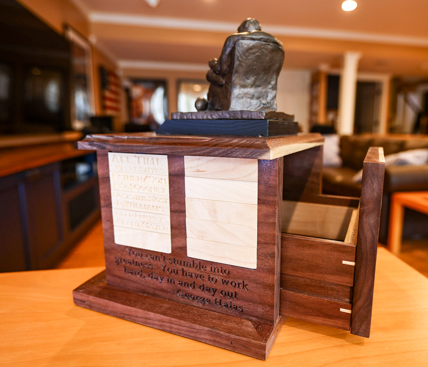

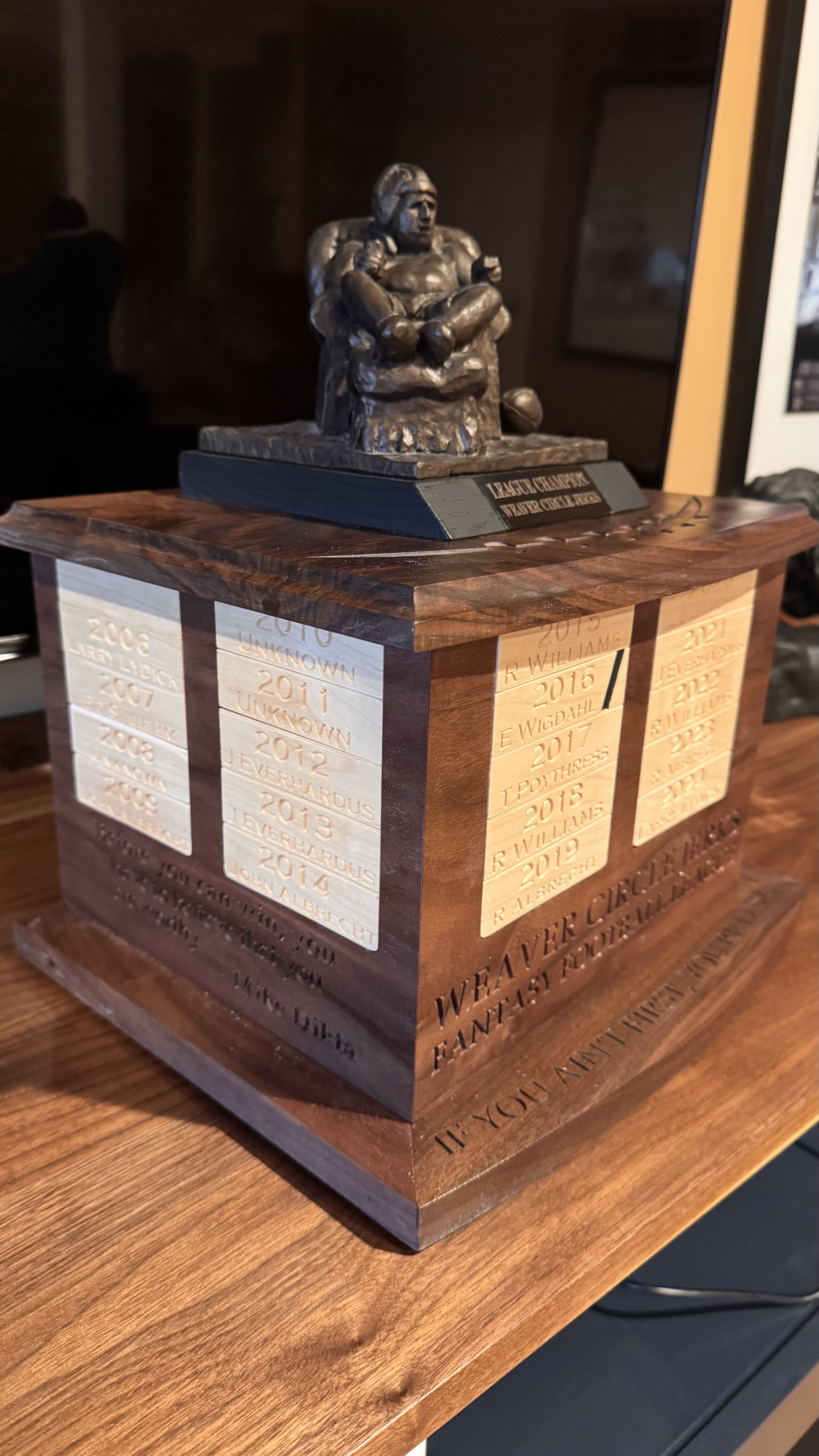

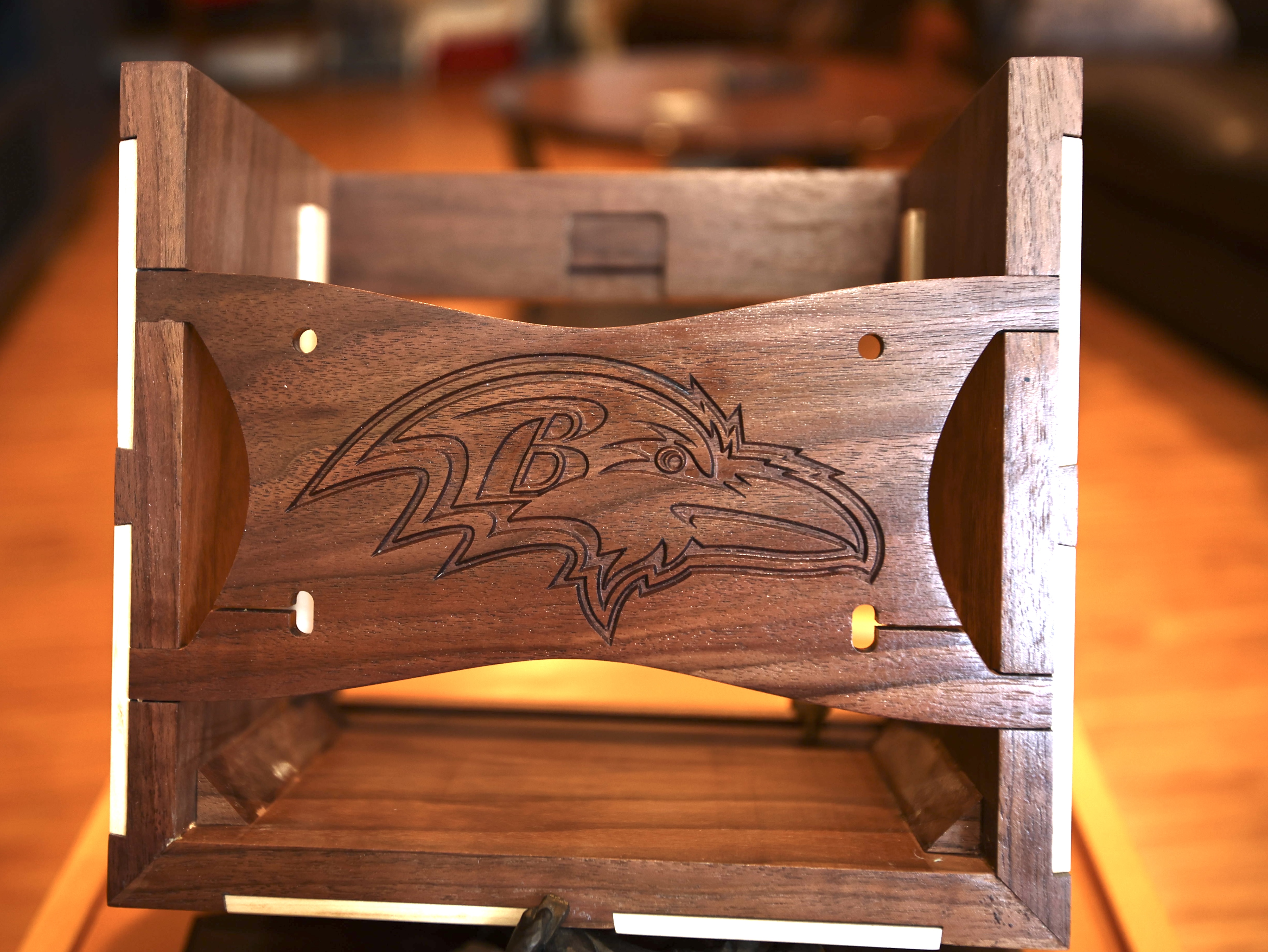

Fantasy football trophy. Walnut and maple. Drawer lined with repurposed cigar box. Removable top locks in name plates. Plates sit in a sliding dovetail.

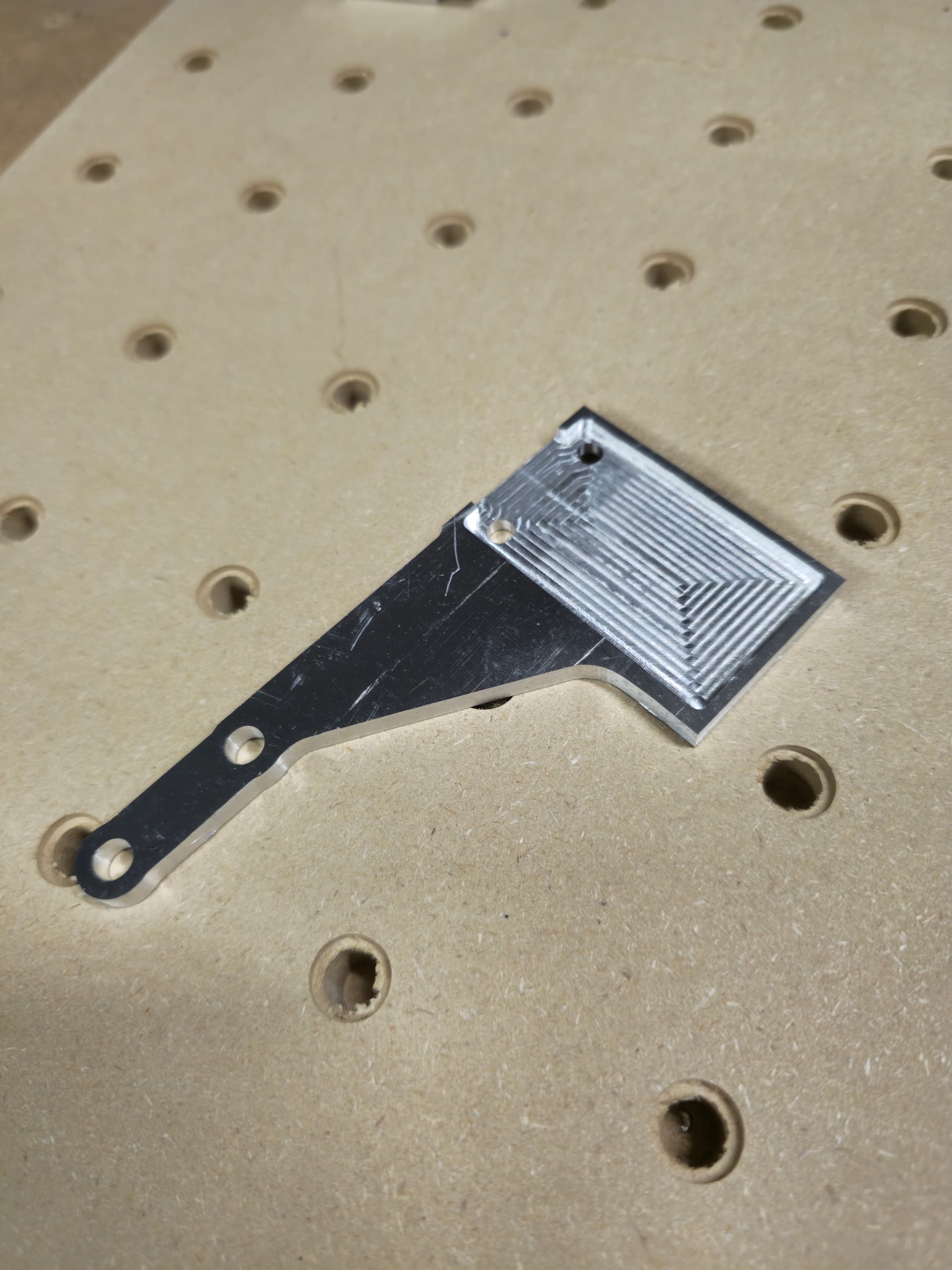

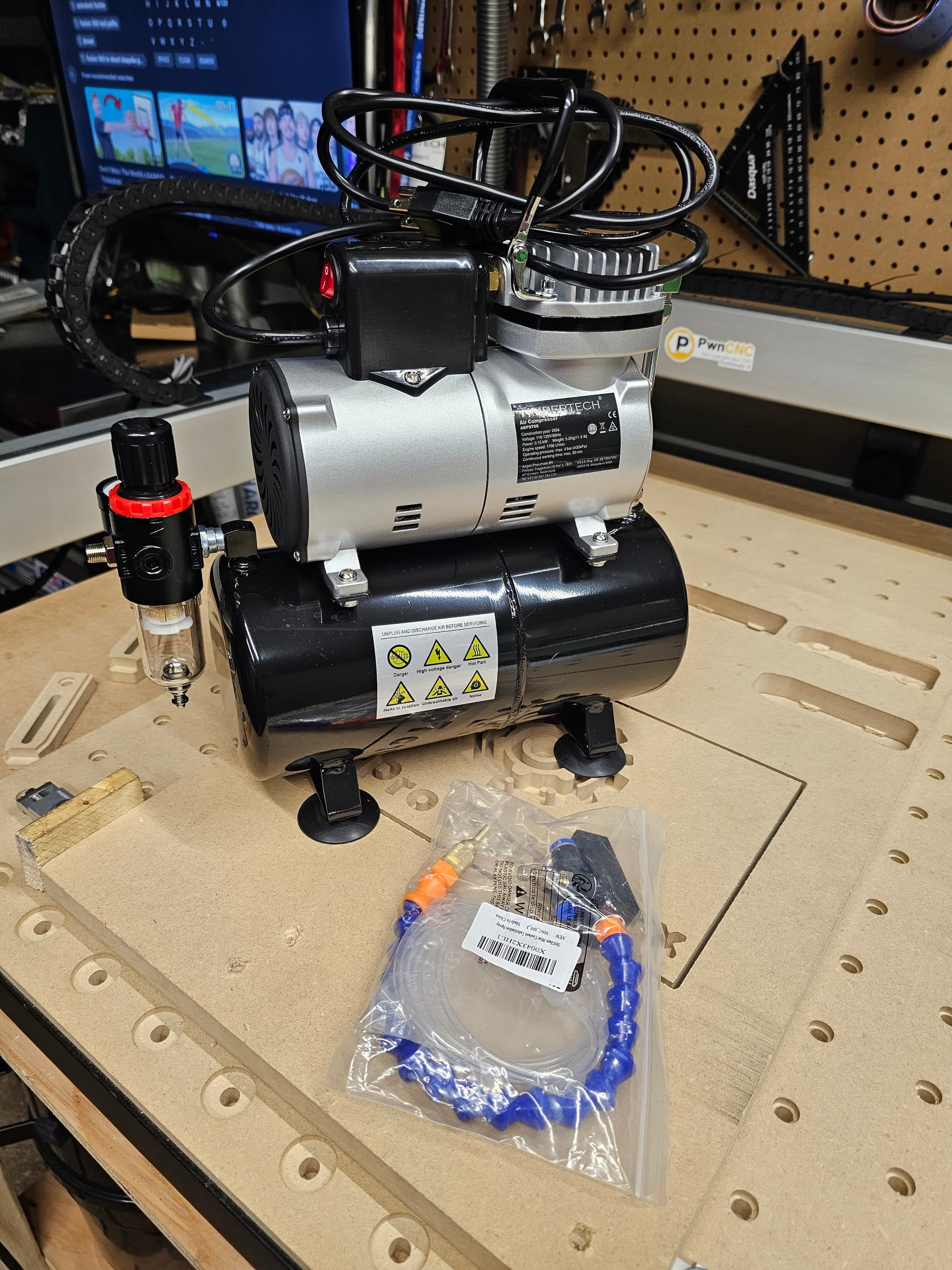

My first aluminum part. I took all the fancy features out of it, and had to adjust the mounting hole spacing for my Z+. Im pretty stoked about this machine.
Mounting plate for a air misting unit?
Correct. I have gathered all the parts now, I’m just waiting for some free time between jobs to set it up.
I have a small compressor just like that. I use for airbrushing my CNC projects.
I am hoping it will be sufficient for the mister :crossed_fingers:
It wont, you need something rated for continuous duty. That compressor will have a 95/5 duty cycle (5% of the time it wont be charging) You’ll have success at first but after a while I was having major problems even with a CAT 1060S, id say minimum 2gallon tank with a 70/30 cycle rating, unless mine is just abhorrently high airflow lol. Running that longer than an hour or two at a time might prove to be difficult or smokey.
