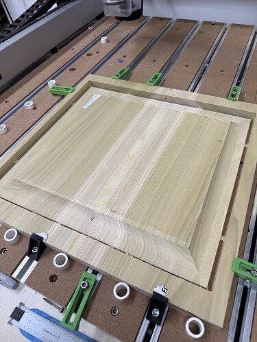

Then I worked on the center panels.
There was a little cleanup with the sander but not bad at all. I put a few pieces together to see what it would look like.

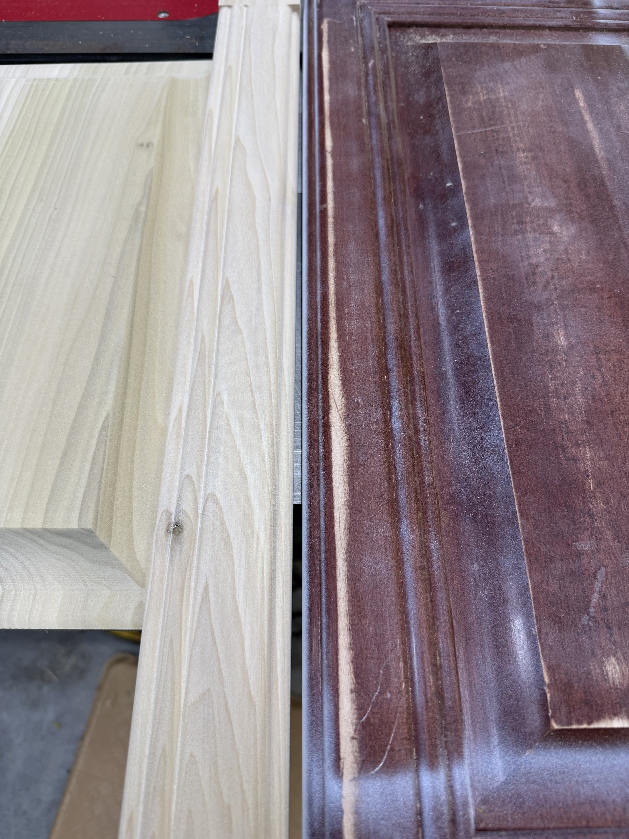

Here it is compared to the original I copied.

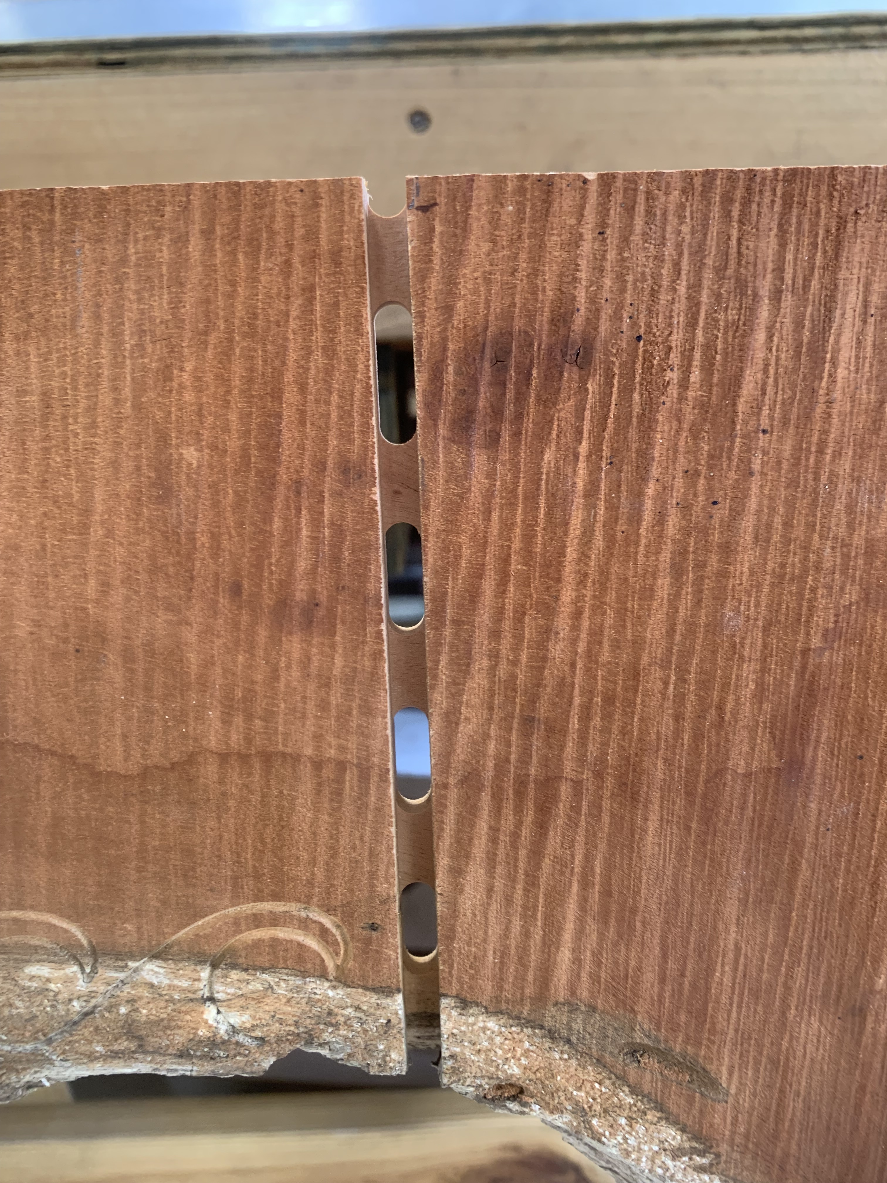

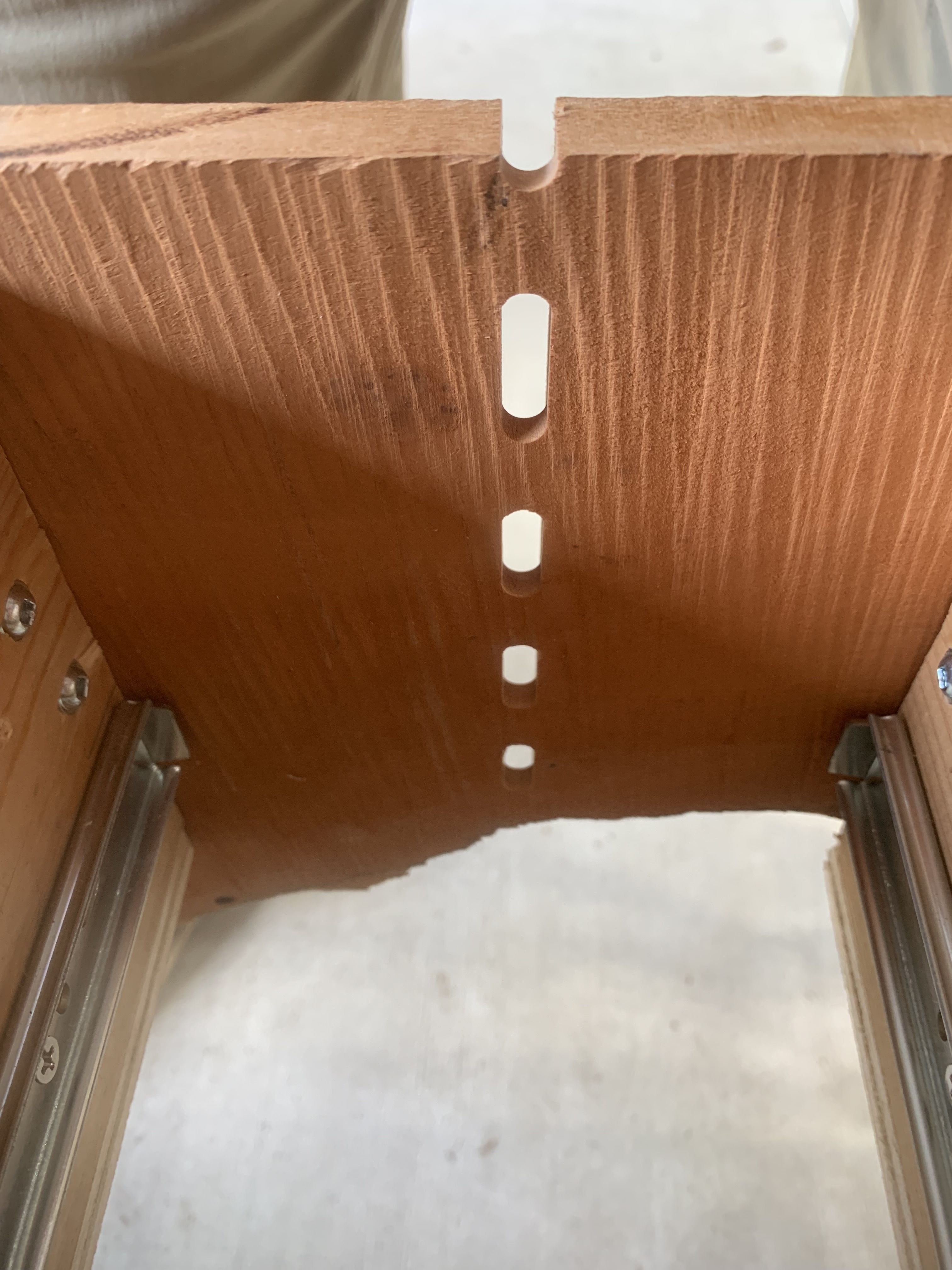

Finally getting around to getting the drawers/fronts installed on my table. Used one piece, cut down the middle with some extra thick tabs to hold together for mounting, cut apart with a slim pull saw after attached. It’s hard to see, not sure if I’m going to pour some resin or paint into the Vcarve/Countour cuts. It will probably stay just like it is, its a tool. This was good practice for aligning and using center zero. Could have been shifted slightly higher by a .25” to .5”

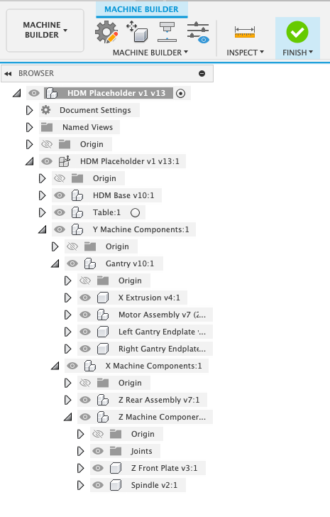

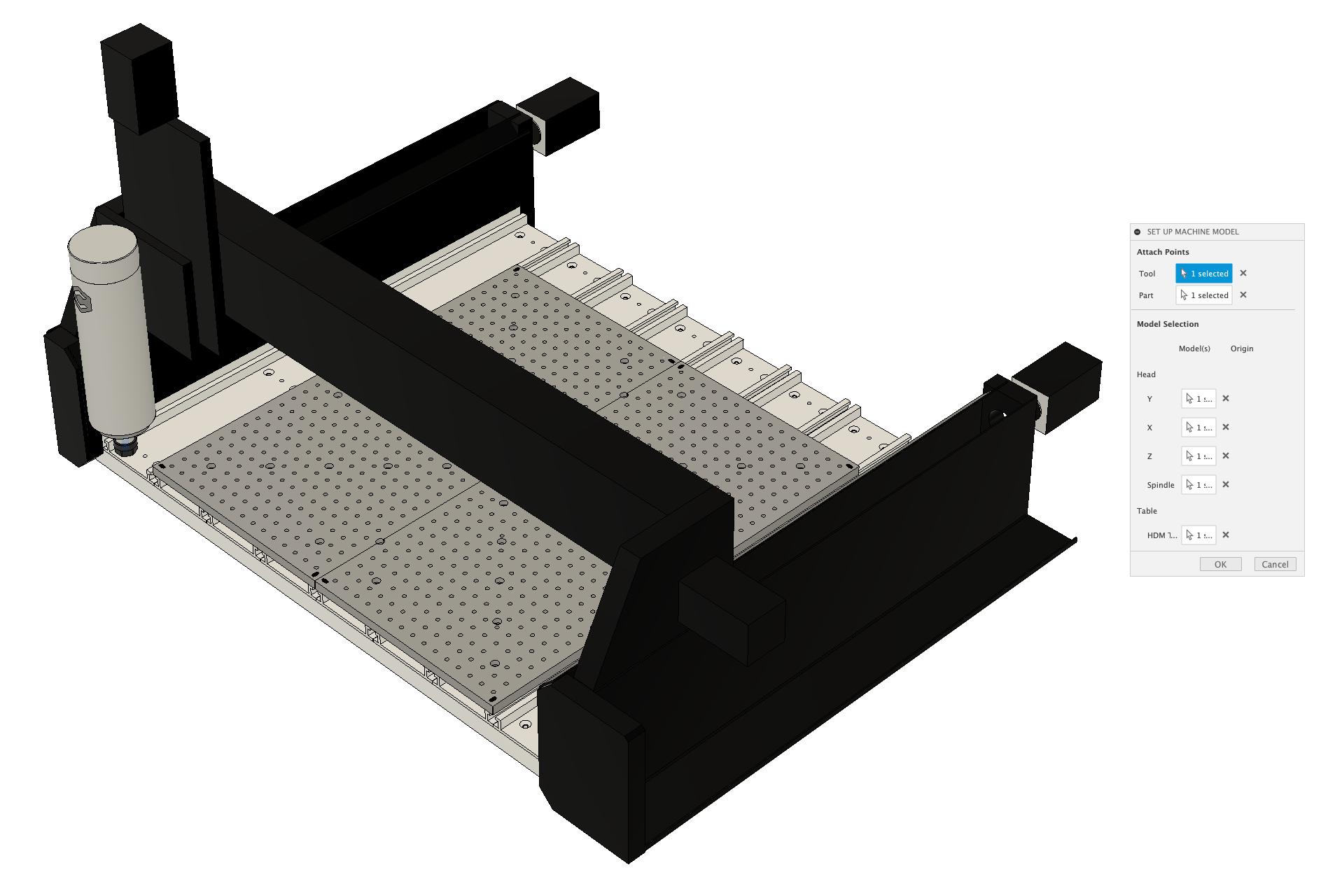

Cut nothing IRL. I did get the HDM configured in Fusion, mostly.
I got half way to doing this for my SP5 pro 4x2 .
I got a model created, but I did not get the movements assigned.
I am a bit confused somewhere along the line. This maybe tonight’s effort !
It’s a bit hokey the way they implemented it. Be sure to organize your components in a hierarchy in the source model. So, I did Y, then moved X into Y, Z and Spindle into X. I left the table separate in the browser.
Also, it seems the “home” location is backwards in the model based on what you put in the configuration. So, I set the model to front left, then the config in the home states and it worked.
Thanks for the pointers ! 20 chars
