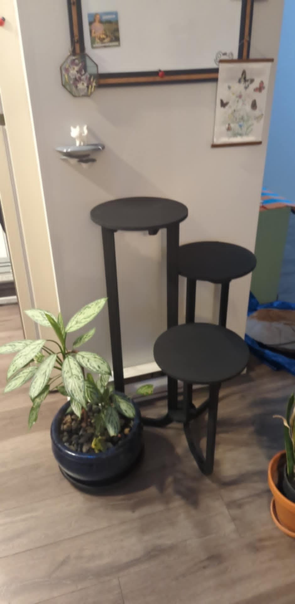

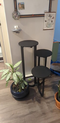

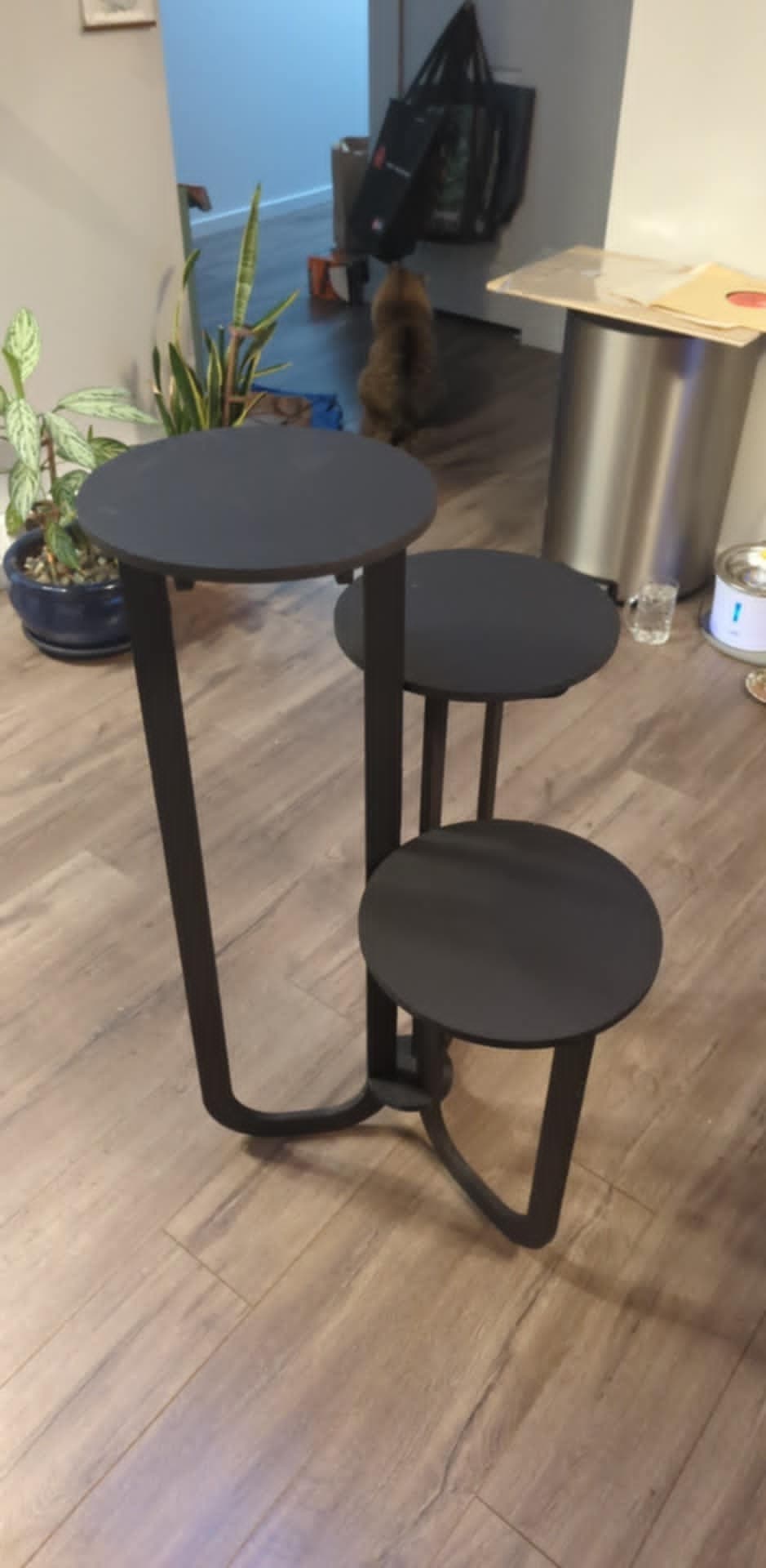

Really nice job on the stand, especially set up to be flat packed for shipping. Lots of folks could use these!

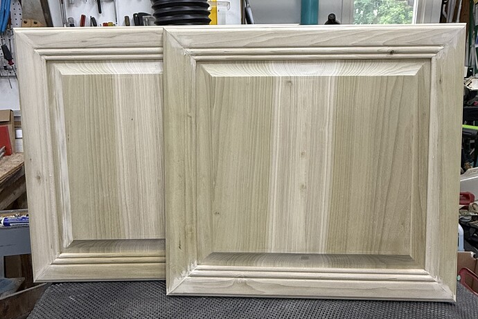

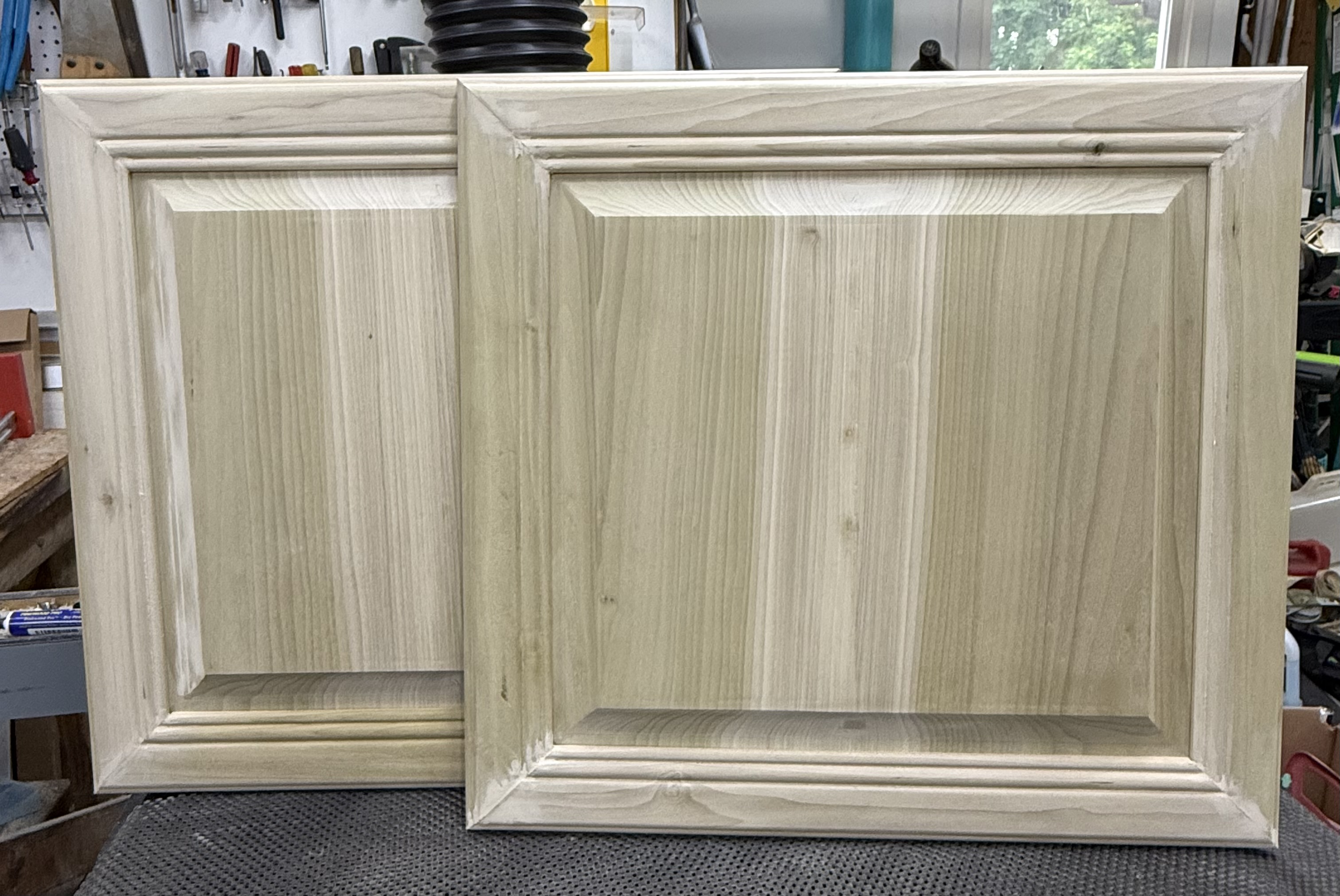

Why don’t you cut the miters on the cnc? Make a jig to hold the stock, set a stop at 58” off one end of the cnc bed, set a tool path at 45 deg and mirror it for the opposite corners. I’m not sure this makes sense without illustrating it. Sorry.
One of the most important things for tight miters is to ensure the stiles and rails are dead equal in length and obviously a true 45 deg miter.
I use #201 as a roughing bit and then #202 as a finishing one. Used the molding toolpath in Vectric.
I used to have a shaper but gave it up many many years ago as it was underutilized. It took about 40 minutes per panel not counting the rails/stiles, so a shaper would have been much quicker but would have had to have the right knife for it.
I could do that, it would certainly take longer, but precision is more important for this job. I could machine a sled in place with a pocket to align the material. That way I can be sure of a 45.
The main profile on those pieces is going to be done by a millwork shop given the quantity and size. I will cut a rabbet on the back and then the miters and glue to a backplane. I used biscuits on those small cabinet doors. In this case I could machine something on the backside to help lock the pieces in place. Ooh, another jig maybe. Put the mating pieces in at the 45 and machine a pocket for the locking key in both at the same time to insure proper alignment.

That would ensure good alignment on the miters. What is the width of material for the frames? The wider the material dictates tighter tolerances on miter joints as I learned the hard way many, many years ago…
They boards will be 3” wide. I will have to see how far back I can get them on the machine and still have the other end poking off. Of course that will necessitate movement of a bunch of junk in the garage.
