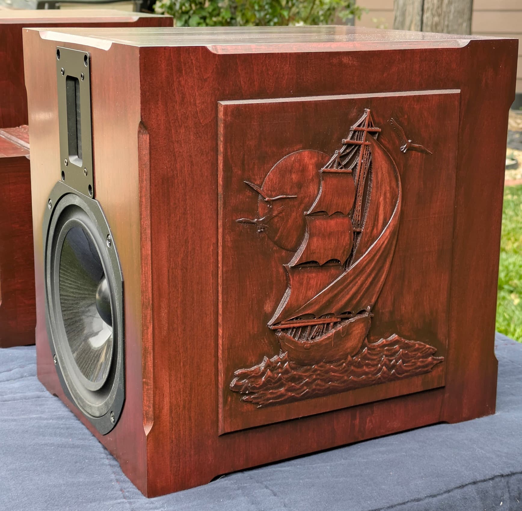

I like this idea very much, although speaking personally, I would not want to use a grip that had such a well-defined pattern as the hexagons. May I ask what finishing cutter you used? I ask because I have obtained a reasonable finish using a two-fluted, carbide, ball-ended cutter with a diameter of 0.25mm (0.009") to shape and finish the wood. The ship’s helm illustrated below is carved in olive wood. This was the first side of a two-sided carve, which was carved without any finishing by way of sanding.

That Helm is Awesome, great wood also

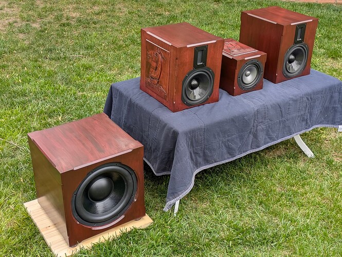

Thank you… I adore working with olive wood. It is a combination of the heavy figuring, wood smell and the finish one can get. I would usually sand to a polish that is hand-finished with 10,000 grit sandpaper then coat the workpiece with a light coating of beeswax. The beeswax accentuates the patterns of the wood, plus it adds something to the fragrant smell of olive wood.
The very heavy figuring found in olive wood does not suit some highly detailed subjects, but it is always fun to try and make nice things. Olive wood is very easy to machine while being just hard enough to contain tearout. The cutter was set to 18,000RPM and 2,000mm/min, which translates to 78.7IPM of traversal speed.
The toolpath was Carveco’s excellent circular toolpath which always produces a great finish on 3D carves. I start in the center and work outwards. The tip of the cutter is never following a raster path. The cutter tip is always carving new material with a circular toolpath. The cutter dimensions were taken from the first one in this list.
Looking closely along the internal curves of the helm, there are the tell-tale signs of chatter. The next piece will be carved a little less speedily in IPM terms. The tool stickout will be reduced by 25% in an attempt to control the chatter. I may increase the cutter speed to 20,000RPM so that I can end up with a workpiece that requires very little finishing.
