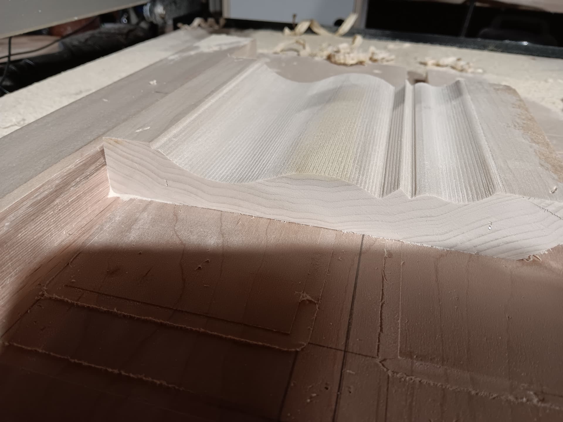

Its time for you to do a 3D carve given your HDU work and an awesome painter in house.

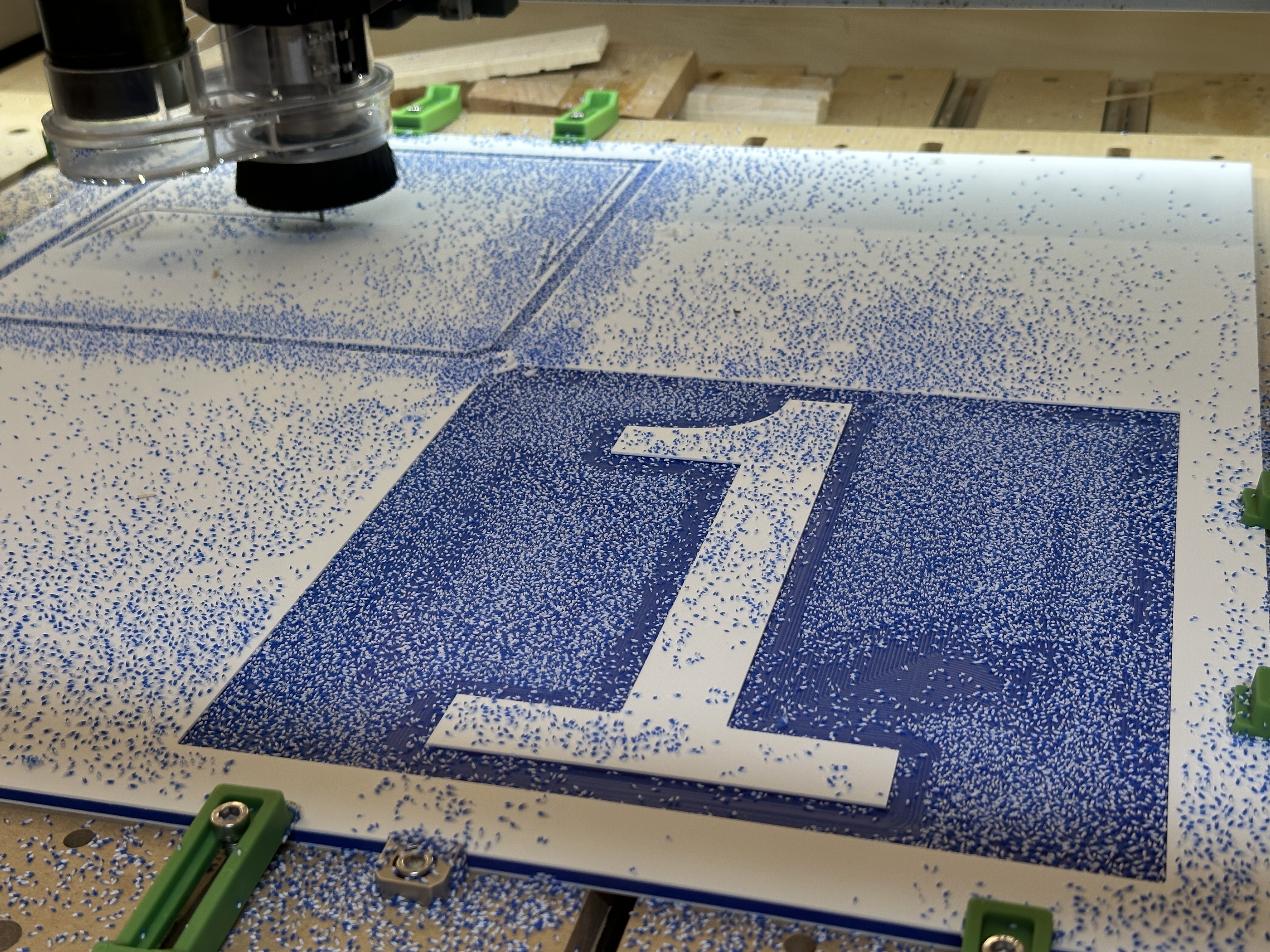

First time cutting ColorCore and first time using O-Flutr bit, seemed to work out so I am happy with it.
Felt a little weird not to have to be thinking about changing wood grain or potential for fuzzies or splitters, lol.
If the central color is darker I have never been happy with the pocket surface from an O Flute. It always looks hazy. It’s not an issue when the central color is white.
I use a regular upcut endmill at about 8000 rpm for pockets and get an almost glass like surface.
I still use the O flute for cutting.

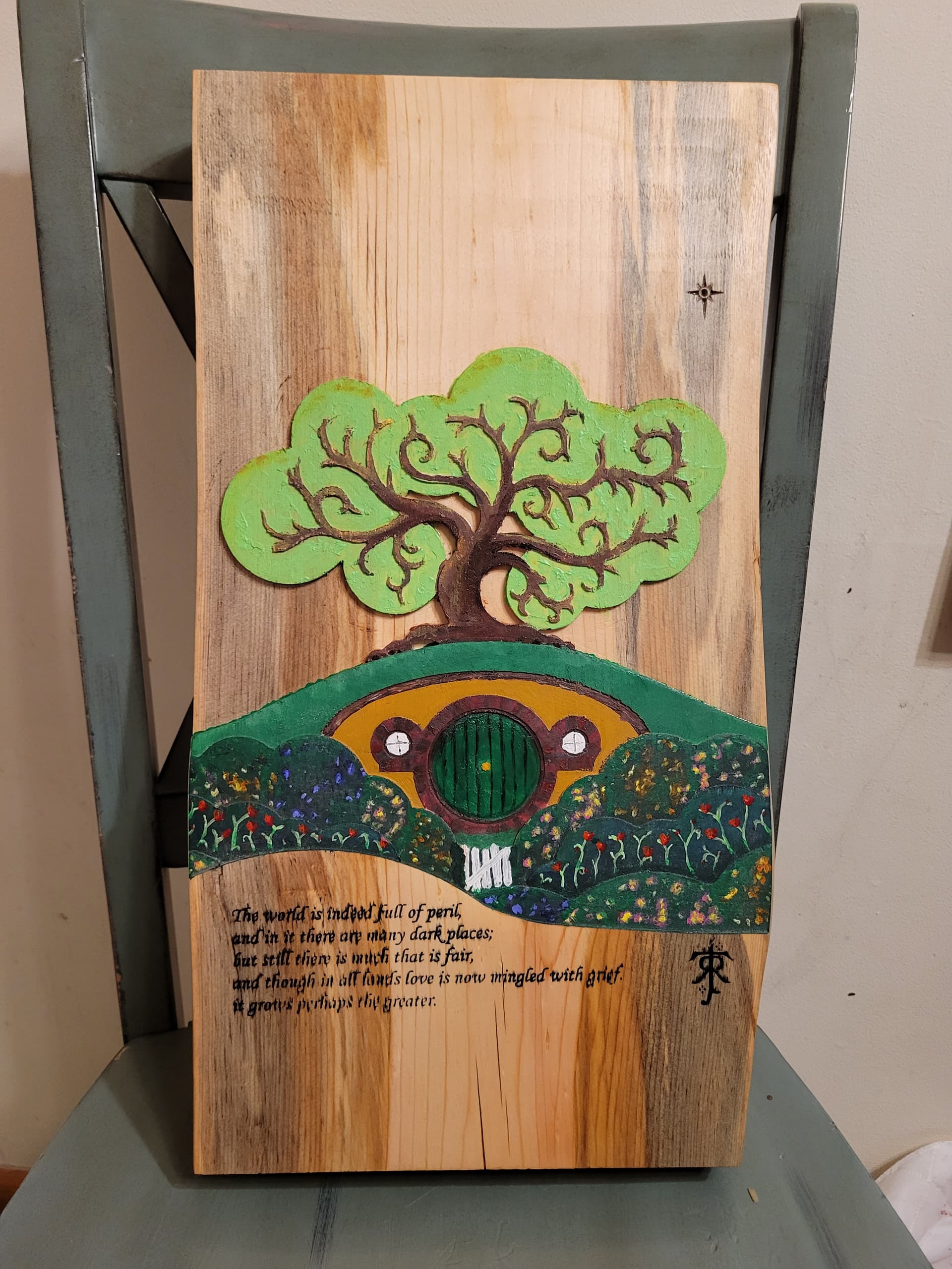

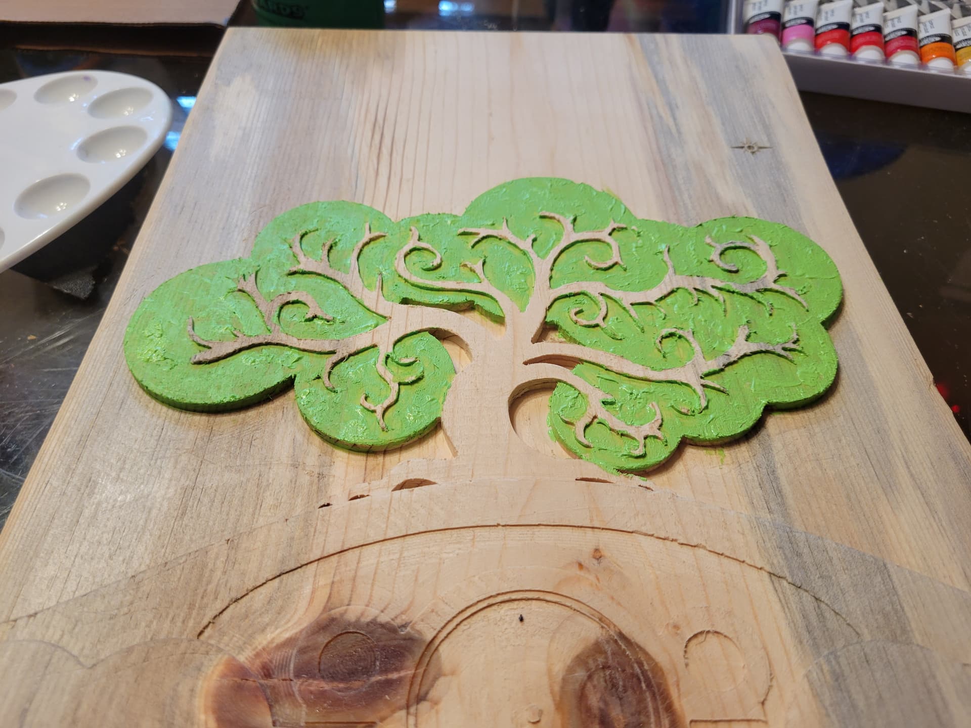

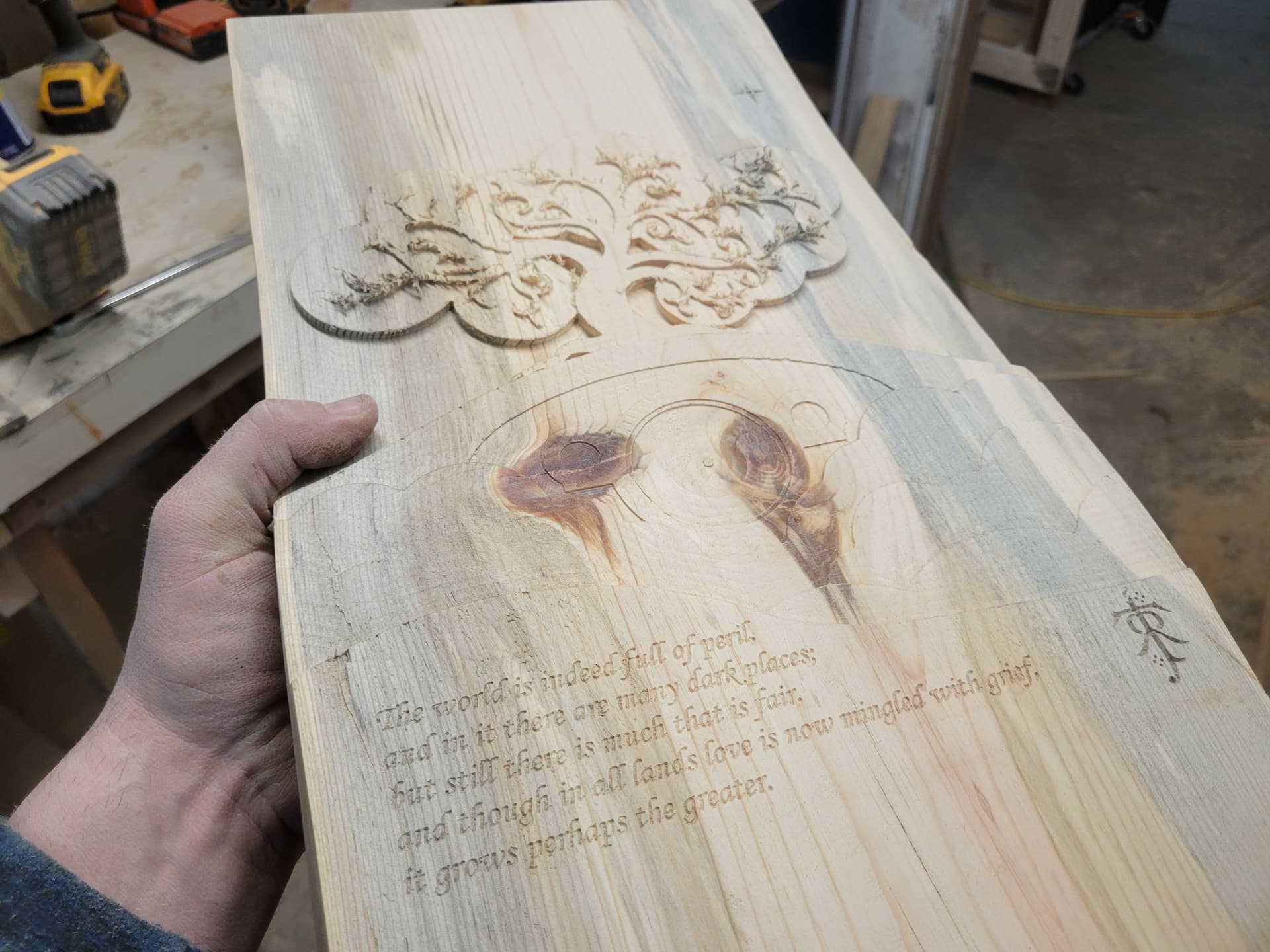

In progress. On to some hand sanding and paint. If I make it again I may carve the tree trunk out of walnut and set it on.
Very cool from what I can see and thanks for sharing. Get that sucker wet and then take a pic.:joy:
It’ll be paint through the middle and odie’s on the top and bottom. Lots of “paint by number” style layers to help me along the way.

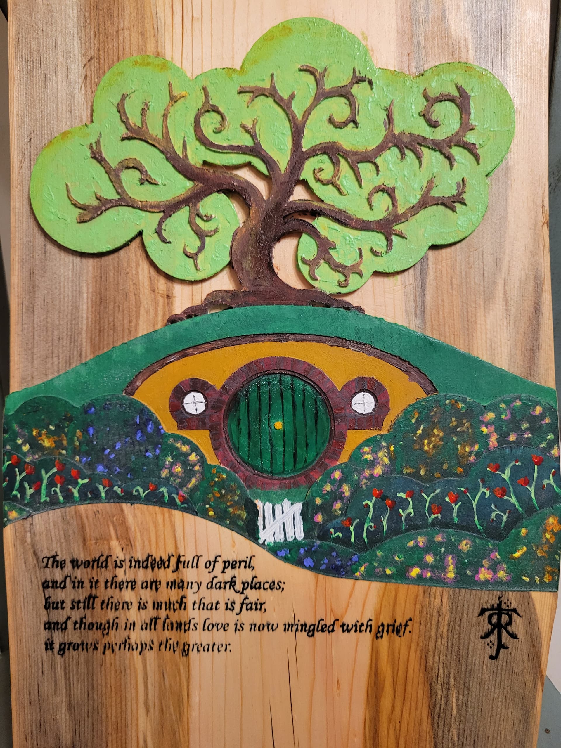

I’ve got a little heartburn about the text, but overall I’m happy.

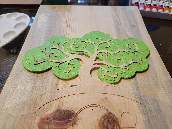

Hey Mark. How long did this take to cut? I recreated the file and guessed at your size (12x16) to see how long something intricate like this would take. I’ve only put paths to the sky, the foliage and the tree and I’m over 600 minutes. Crazy. I’m just trying to learn whether it’s easier to break images up by size. For instance if a 1/16" bit is needed in smaller areas, like the tips of the tree limbs, would it be easier to put those on a separate layer so a separate path can be applied? Just curious. Looks good.
This is African Mahogany inlayed with Maple. Made to order for a friend.
I cut most with a quarter inch endmill to speed up things. I then used two contour cuts around the tree branches to get sharper corners, 1/8th and 1/16th endmills.
A little past 2 hours of 1/4" endmill and then a bunch of small cuts.
