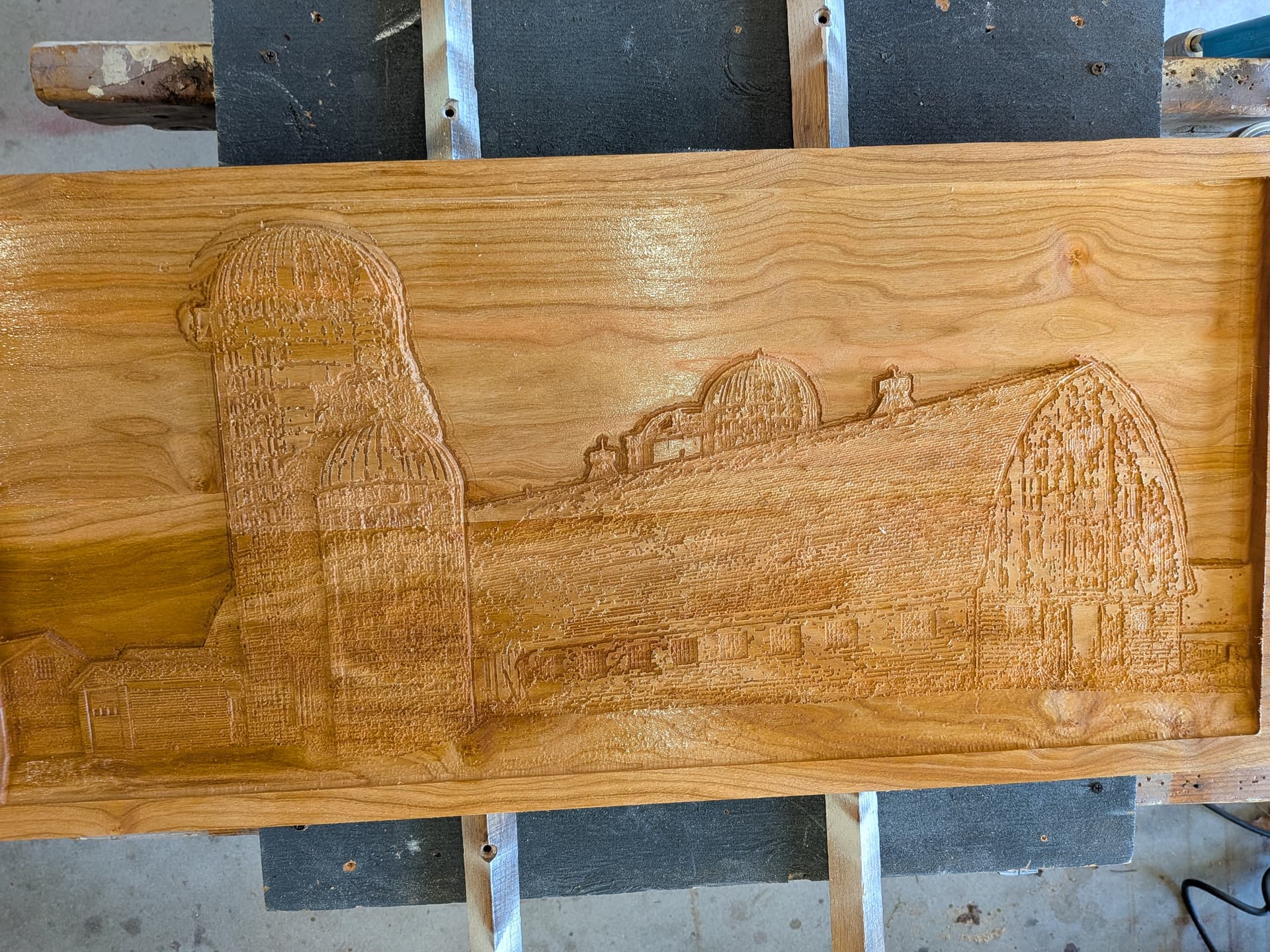

Not my best effort, but learned something.
I skipped from 1/4 to 1/16 ball end mill
I should have used an 1/8

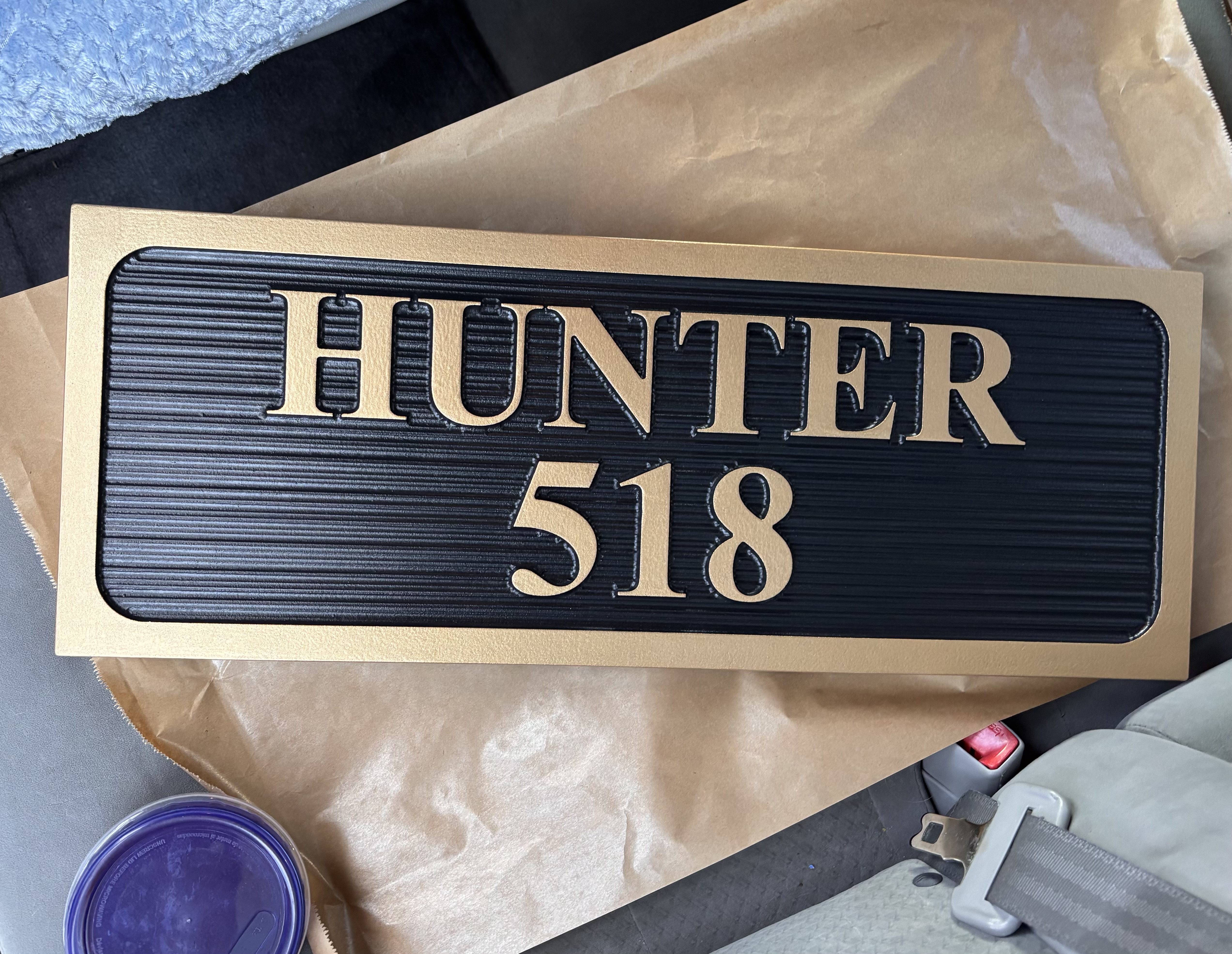

New community signage. The first. Gave this one to them as a sample and immediately got 4 more. Good day.

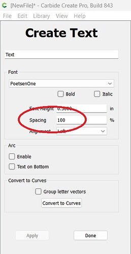

That’s what I settled on also. I’m using Walnut and having to keep increasing the size of the letters to keep from some of them breaking out. Using a 1/32, but still having challenges at 3/4 inch high letters.

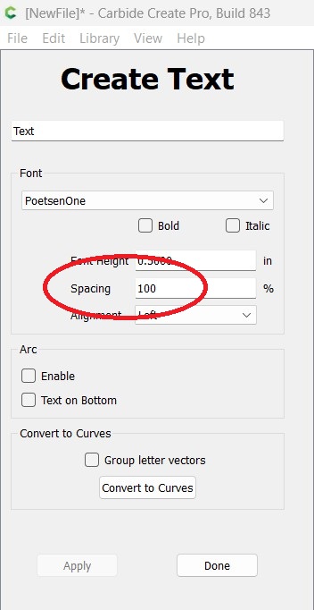

You can increase the spacing of letters in the create text.
Appreciate that. I do usually space the char. out between 110 and 130 based on what I’m doing. The problem is, I think, that my 1/32" bit is only about 3/16" long on a 1/8" shank. As such, trying to have up to .75" high letters, causes the top section of the bit (1/8") starts rubbing on the letters as the bit goes deeper. I could use/do a 60 degree bit, but don’t prefer that look on this project.

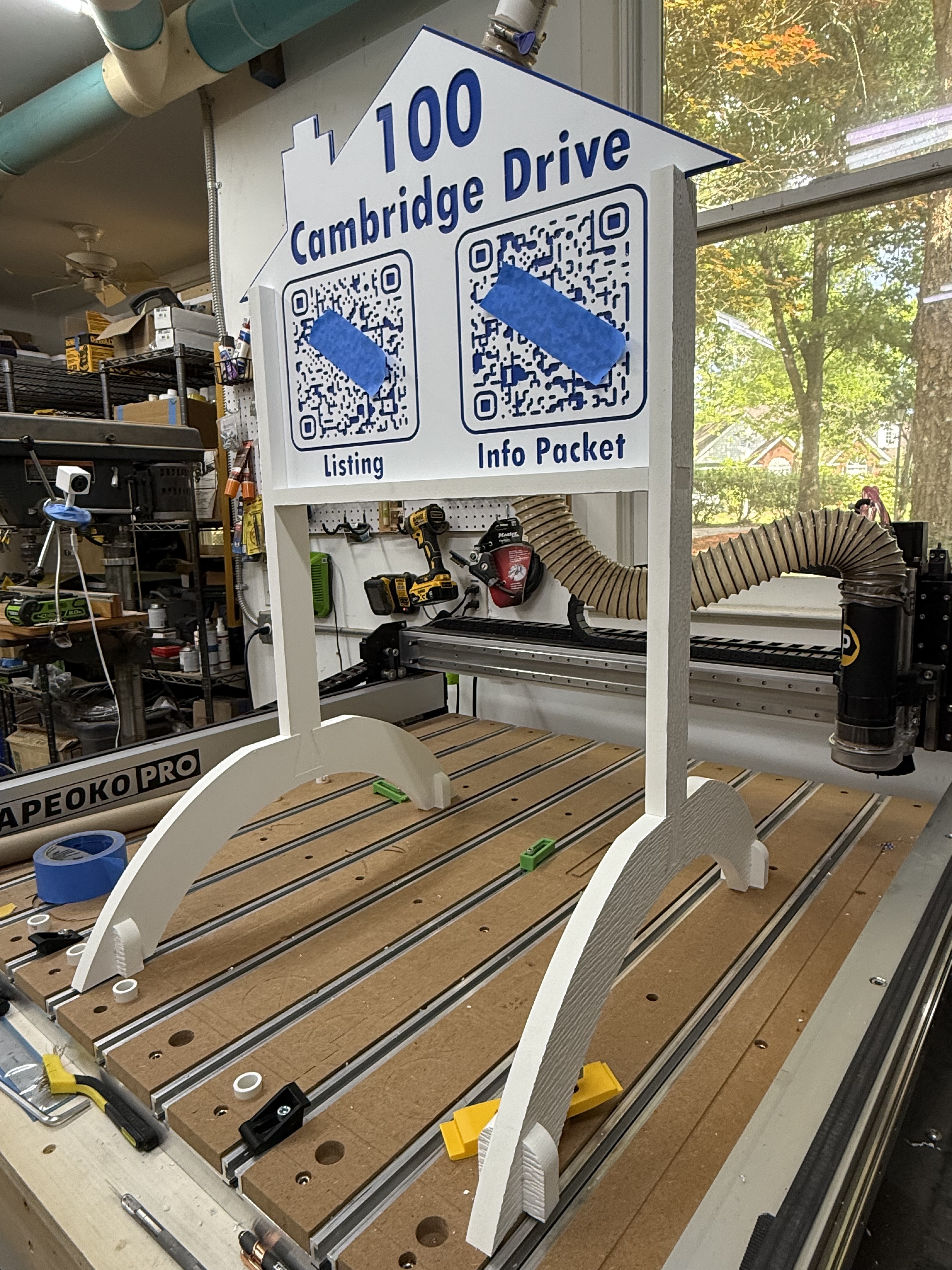

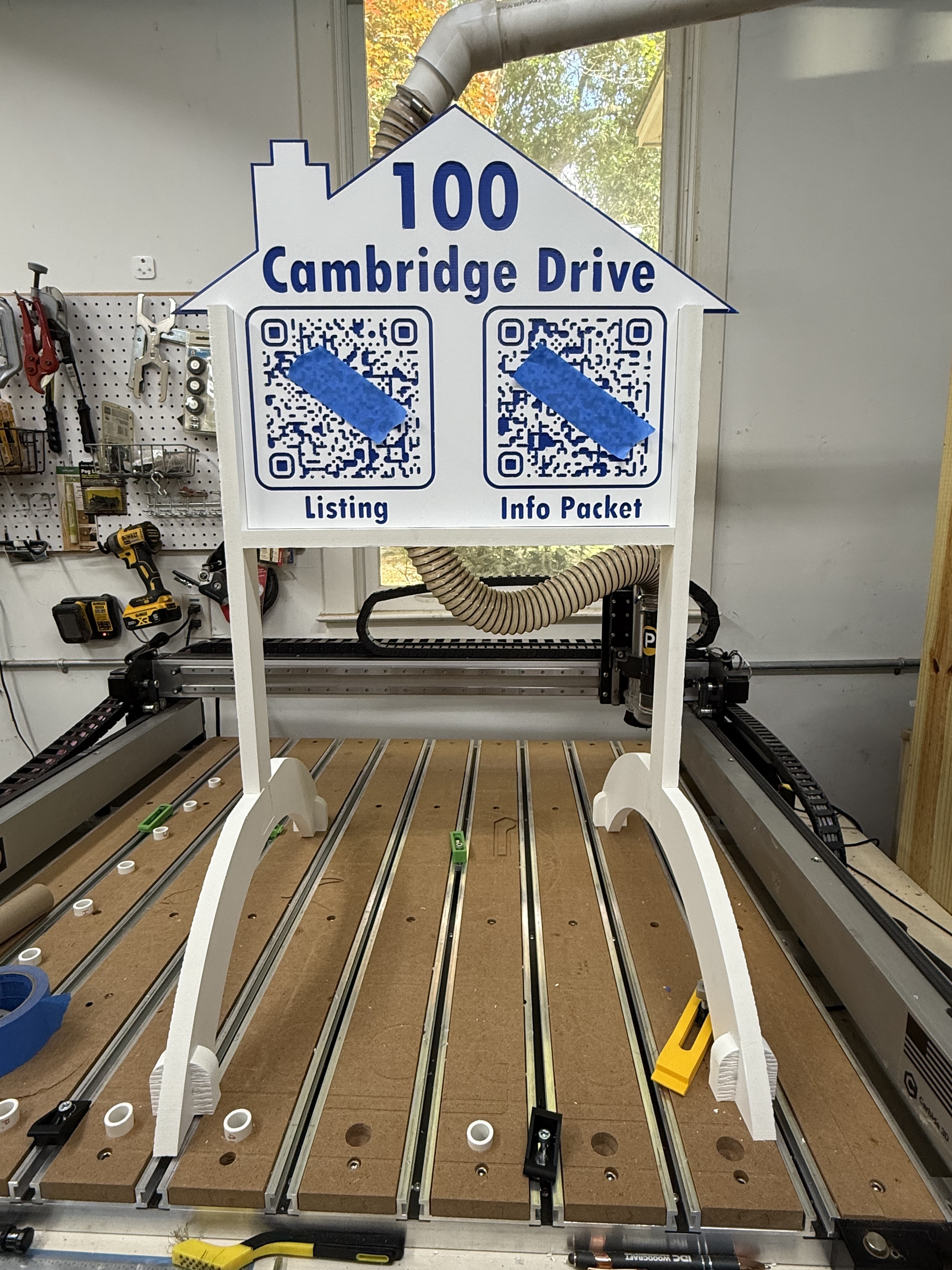

We have been trying to sell our house for a while so that I can have a proper shop. Today I made a sign with QR codes to direct people driving by to our listing and to an info packet that I prepared.
It’s 1/4ā€ ColorCore for the sign and pvc for the stand. I carved both sides of the ColorCore to get them coming and going. The QR code is obscured in the photos but it does work. I didn’t get all the fuzzies cleaned up but since it works and it’s for me not a customer I let it ride.

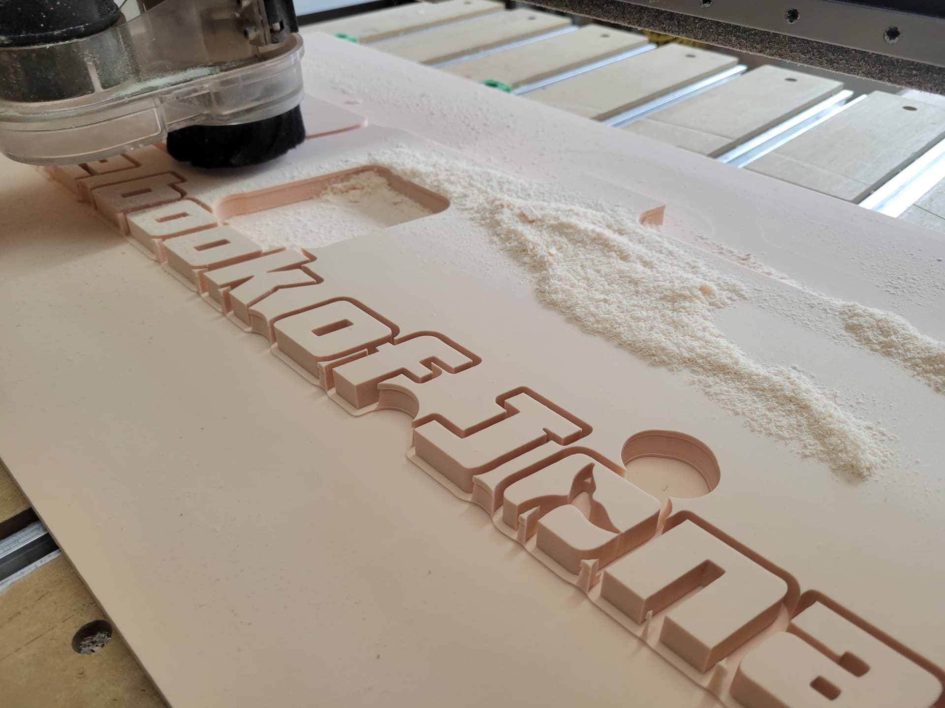

I’ll cut the whole height with an 1/8th bit and then cut it with smaller bits only at the max depth of each tool. You can barely tell if you look hard and it never seems to me to look like cheating.
Your eye follows the sharp edges of the letters that the smaller bits create and kinda just summarizes the rest of the shape in your brain to match.
I’m traveling at the moment but you can see what I mean a little in the whale tale of this pic.
I like the idea of cutting short with the 1/32 on a final pass to square up the top edges. I will give it a try. THANKS
