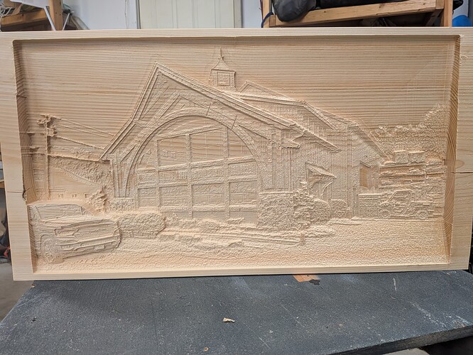

Very Nice chunk of wood here
Yet another relief cut. This is a company Production giving me free pine.
They get a freebie.
@jtclose Nice job Jim! What are you doing for finishing on your reliefs…just a clear coat?
That is bare wood. I am putting a couple coats of thinned out Shellac.
That way if someone wants to paint, it’s good to go.

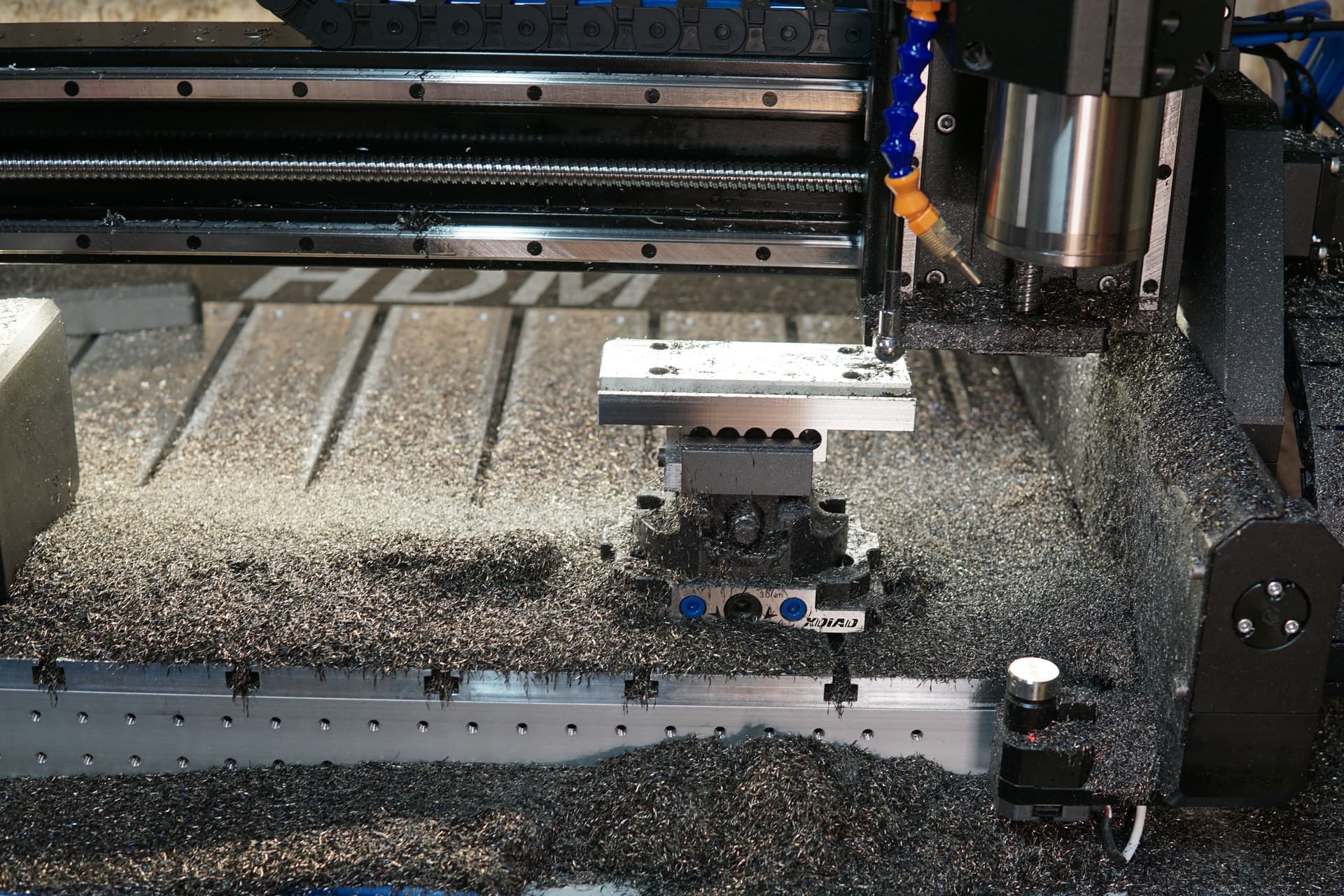

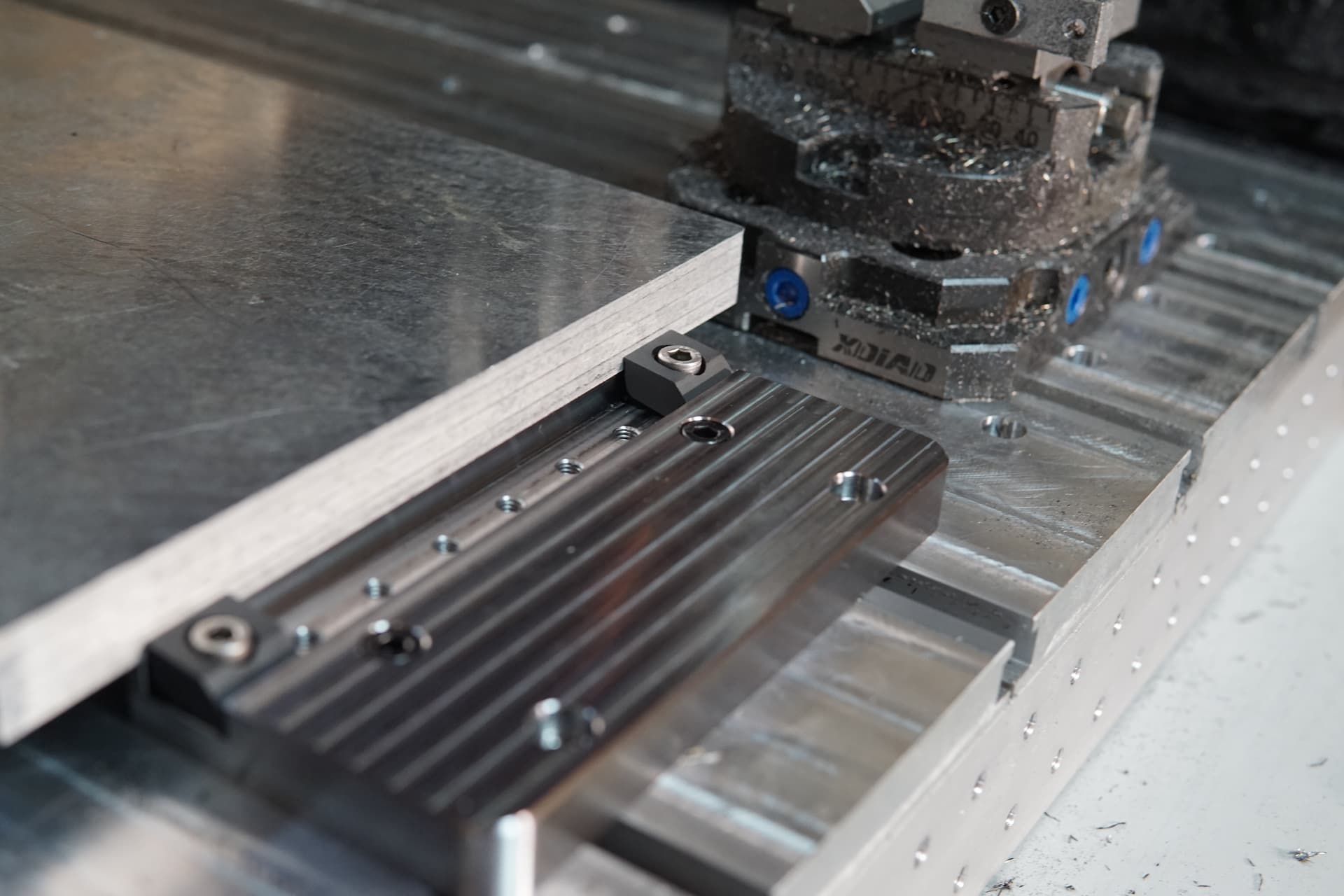

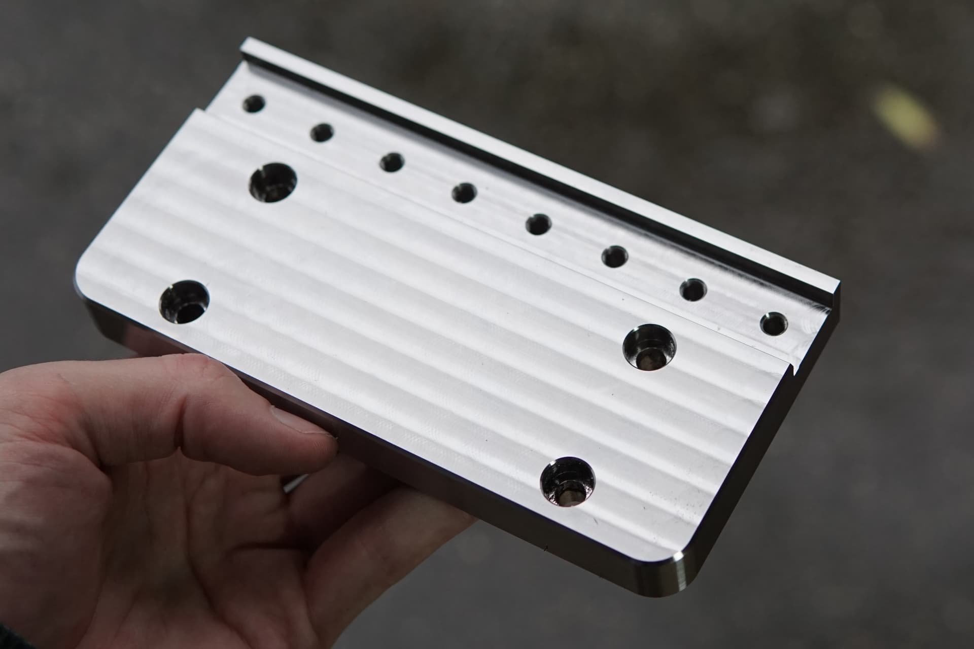

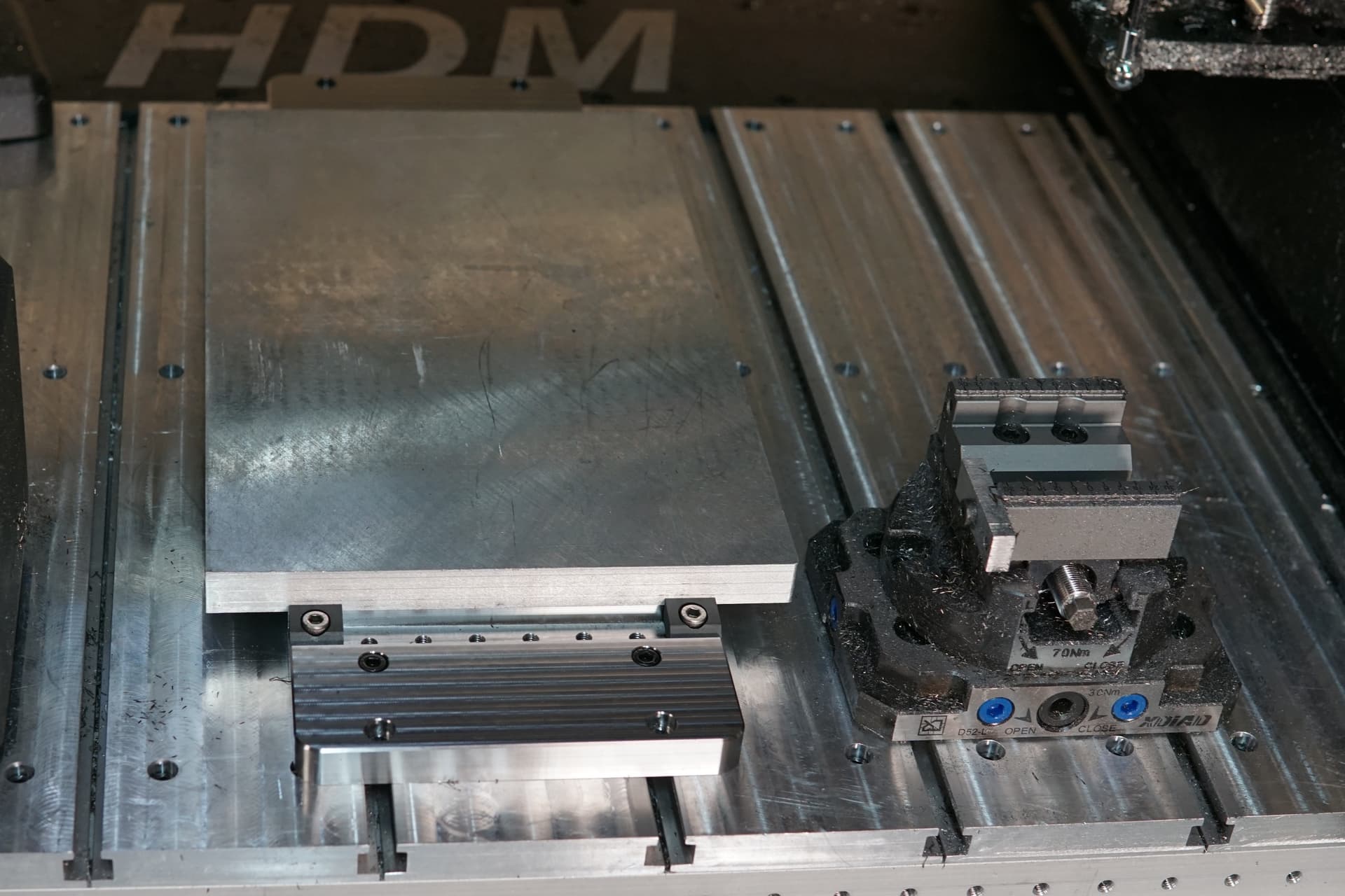

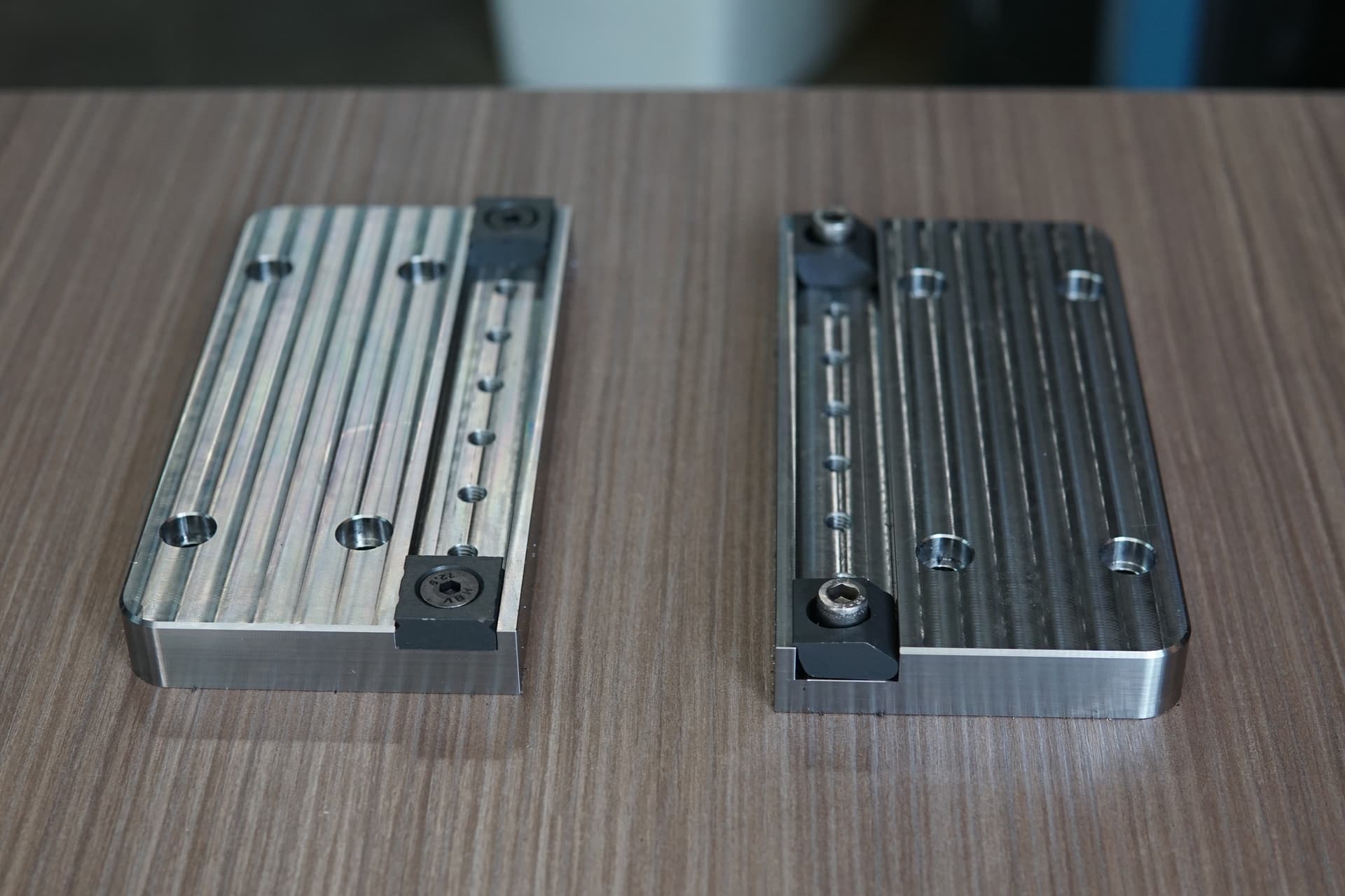

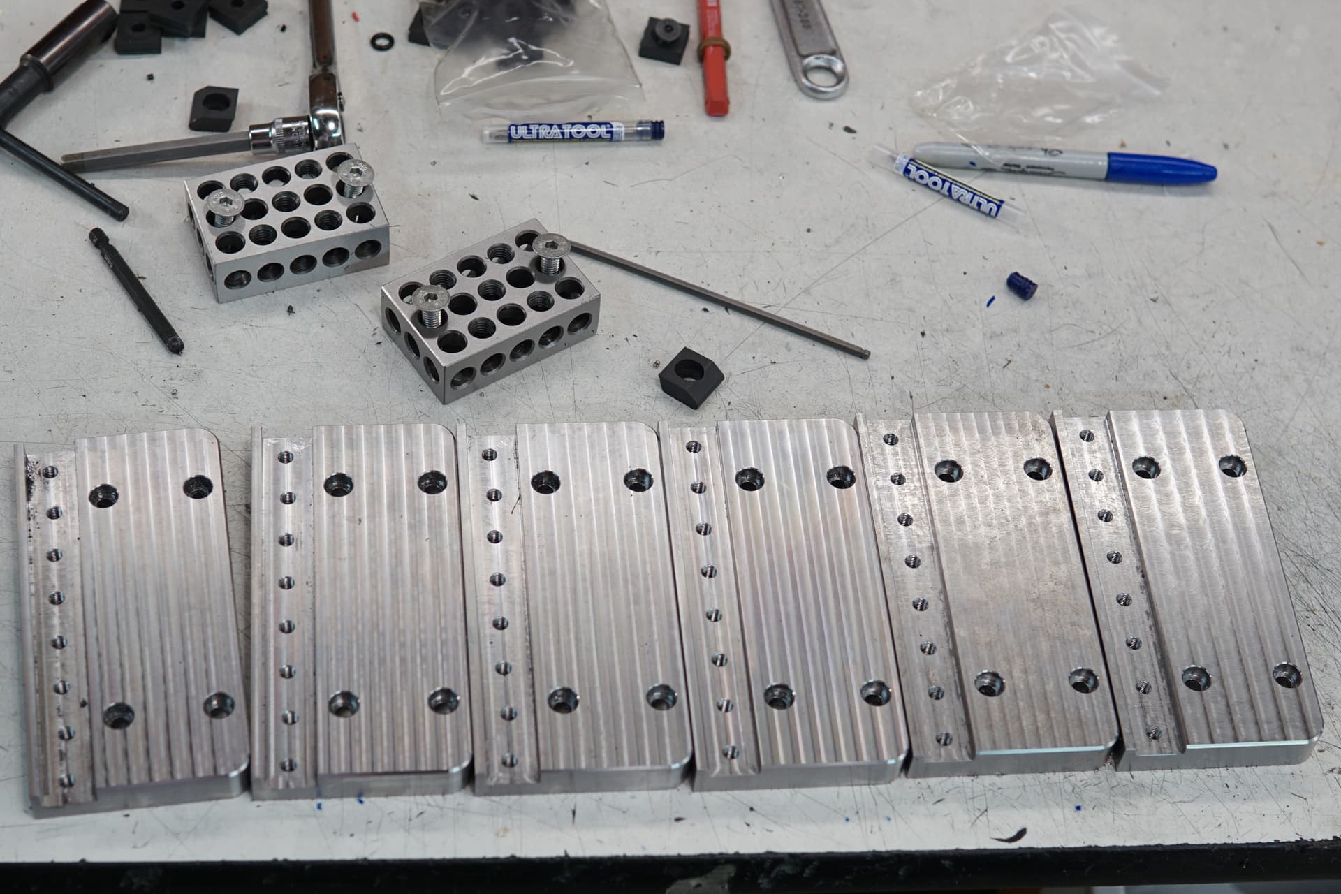

Made 3 pairs of low-profile vises for clamping big stock over the last couple weekends. First time machining steel on the HDM (4140 HT), went great!
pile of steel chips:
6x parts done
They use Mitee-bite Talon Grip style (as in cheaper aliexpress knock-offs) clamps on the fixed side, and Pitbull-style clamps for tightening down.

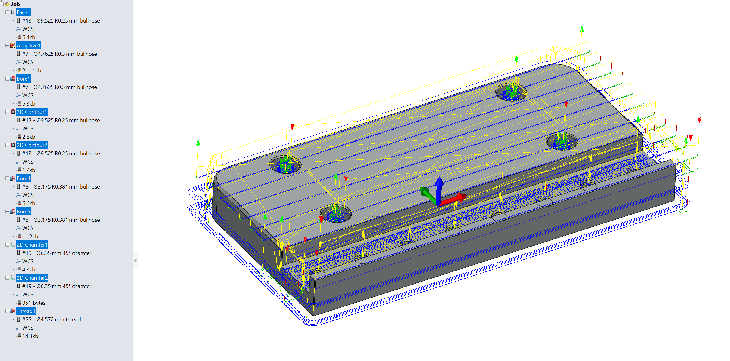

Feeds and speeds? Toolpath strategies? Coolant?
Inquiring minds want to know!
Roughing: 3//16" corner radius end mill, 4 flute, AlTiN coated. 8200 RPM, 1100 mm/min, 10mm stepdown, 0.5mm stepover
Facing: 3/8" corner radius end mill, 4 flute, AlTiN coated. 8000 RPM, 1500 mm/min .25mm stepdown, 8mm stepover, .05mm final stepdown
Side finishing: same 3/8" end mill, 8000 RPM, 1000 mm/min, full depth (16.5mm), 0.1mm stepover + spring pass.
With mist coolant (Fusion Cool 2240). Coated tools with a corner radius help a lot over plain carbide square corner end mills.
