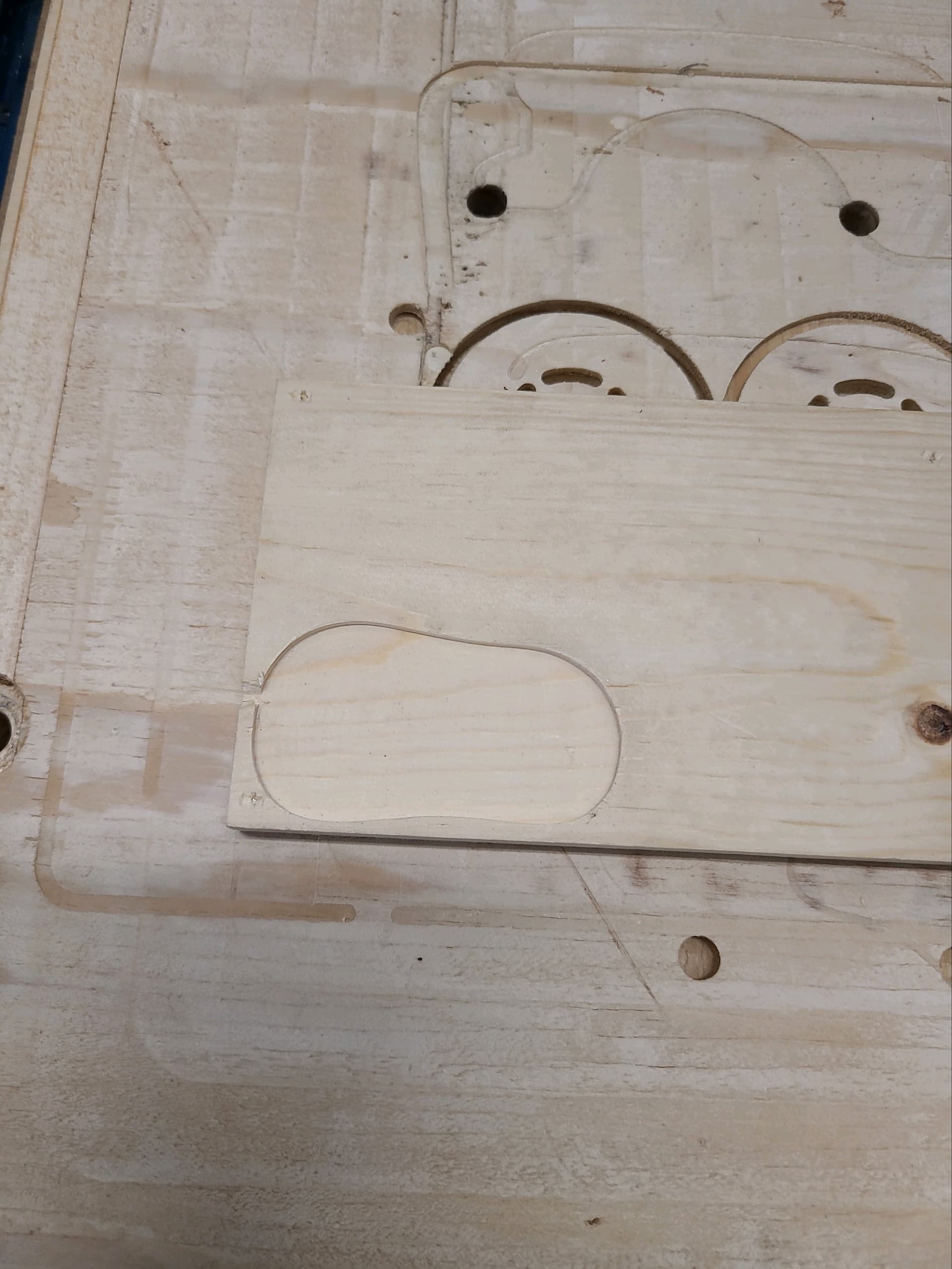

When I made my first hinges a month or so ago I was using some brass I had on hand 1/2x3/8 I think. Easy to set up in mod vise but required 2 sided machining to remove the waste.
Since I’ll be making a number of these, plus I’m a cheap b***ard when I can be, I decided to see if I could come up with something better.
Back to my old favorite workholding, tape and ca, Same feeds and speeds as the vise work. Cut materials cost by 1/2 and time by a third. I’ll take that any day.

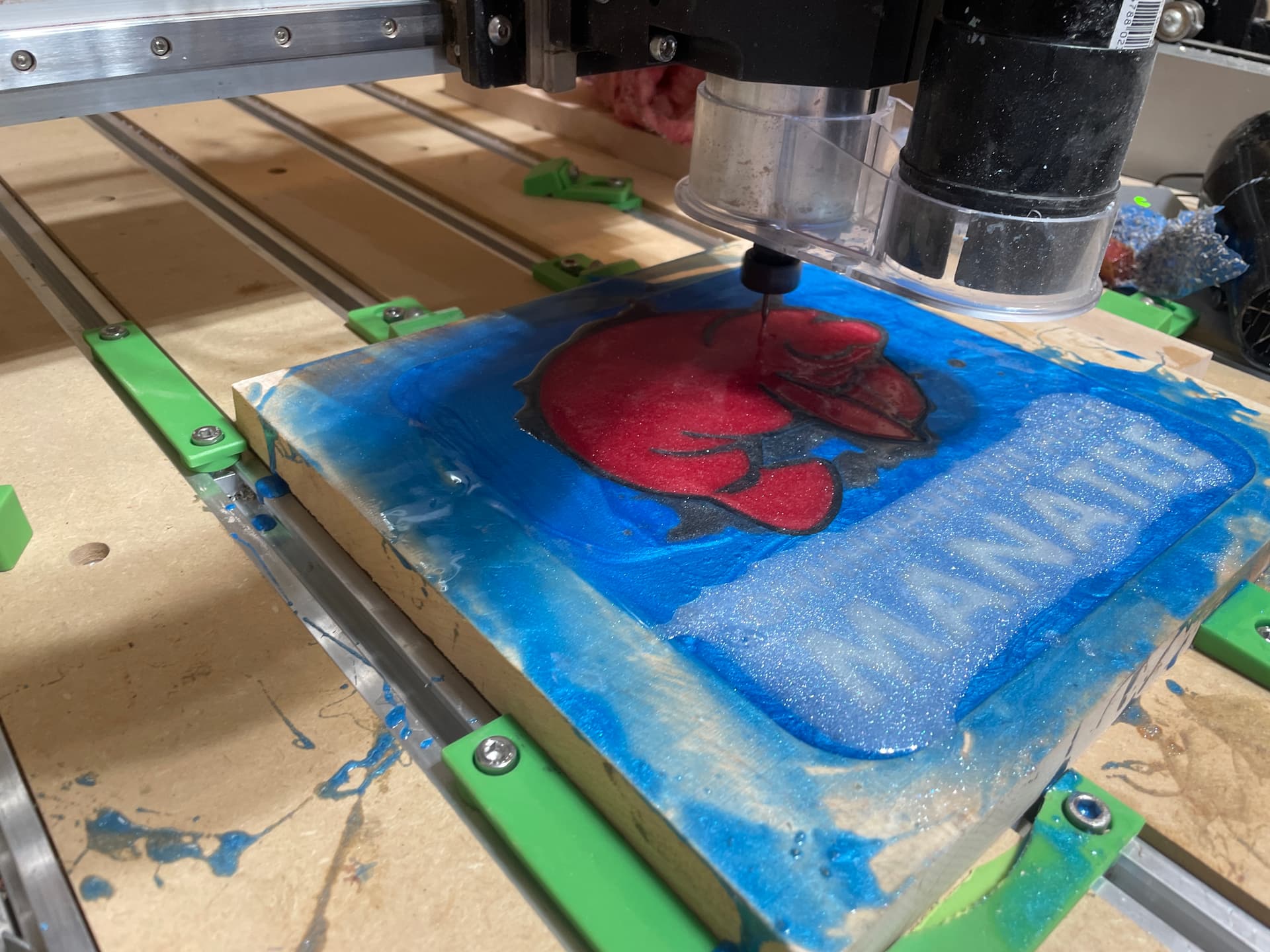

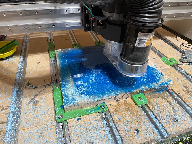

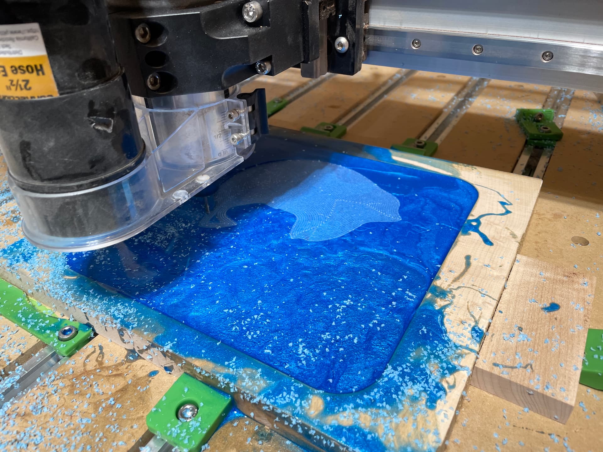

Making a mess with epoxy. Cut into birdseye maple. A little meme for my little boy’s room
Looks awesome, Griff! I’d like to learn how you were able to use only a finishing toolpath? I would’ve expected to stall the CNC carriage without a rough cut first. Maybe the sloping insides of the box gave enough “introduction” to the bit?

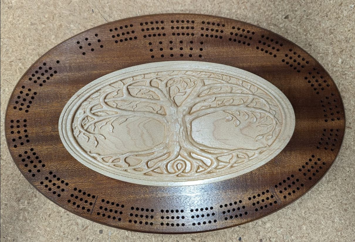

Did my second 3D carve and got it finished. This time it was a tree of life topper for one of my cribbage boards. Sapele base and a Maple topper. Really love the detail and the contrast. I think I might run another finishing pass on my next one though at a different angle or with a tighter stepover on the 3D. I like the way most of this looks but a few of the tighter spaces have a little left over still.

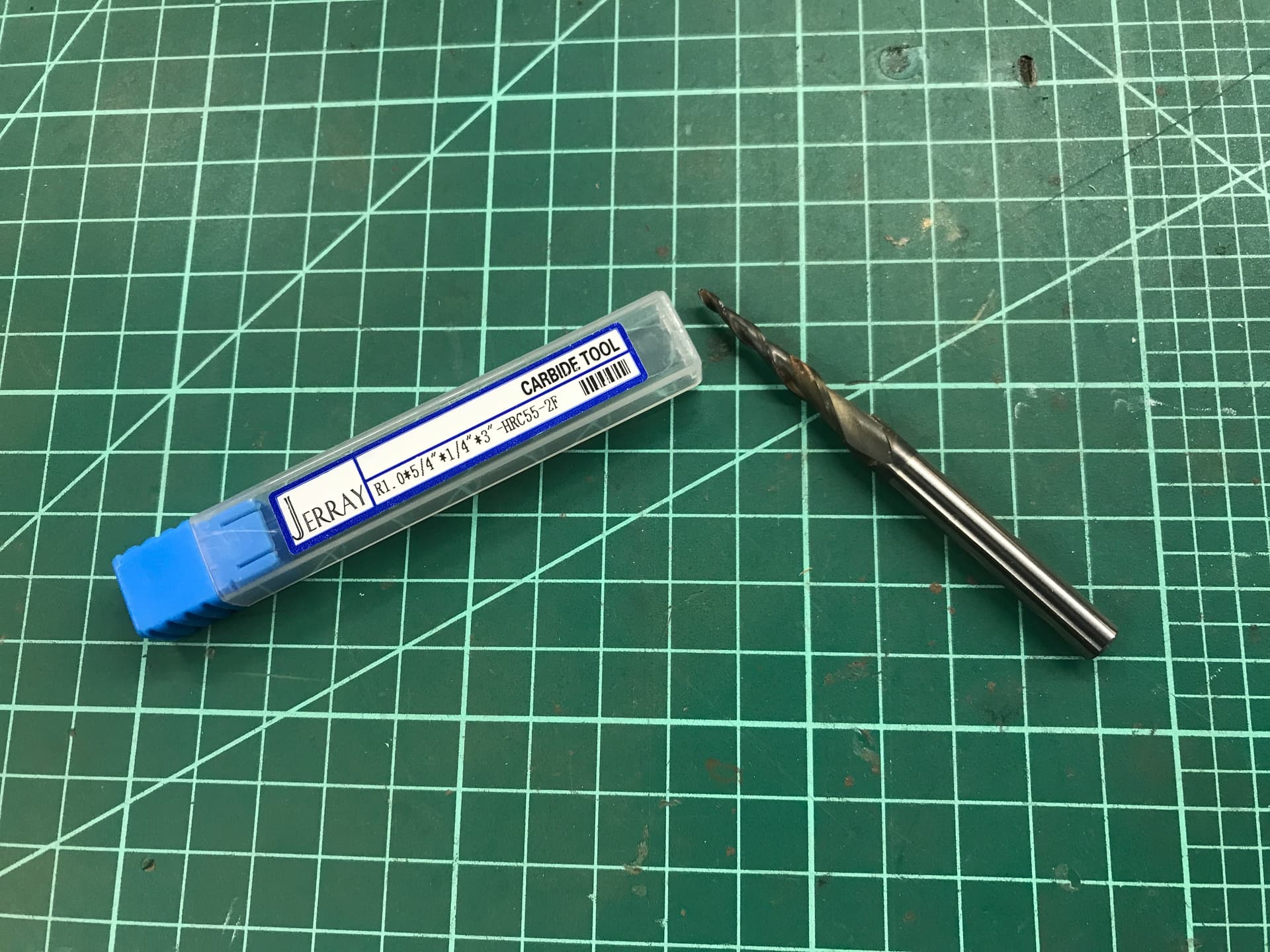

First, I used a quarter inch tapered ball nose end mill. 200 ipm.
Second, I used an HDM w/1.5 kw spindle. Nice and rigid, plenty of power.
Third, excepting the initial plunge, cutter engagement is very light. Stepover is only .004”. Max height of model is .93”. So once the edge of the model is reached the DOC to clear the rest becomes .93”. Again, since the load is so light you can run deep and fast. And still take 5 frickin hours to complete. Zero sanding though. I hate sanding more than @Julien
Here’s the Wiz stained, 2 coats poly.
Obviously this is not the most efficient way to accomplish this. Cutting all that empty space with a tapered ball nose at .004” stepover is silly. But the requester wanted the shadow box effect. I had other things to do and didn’t feel like messing with toolpaths at the time, the machine was idle so…
Great approach, thanks for the info! A rough cut would’ve probably added time, since the tiny stepover made sanding unnecessary. And I suppose if the initial pass is too deep (like it would be for my finish router), an initial roughing toolpath clearing out just the first quarter-inch slot would solve it.
