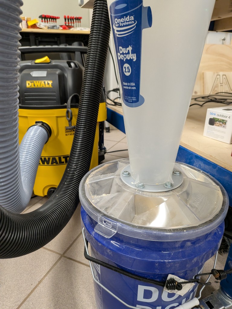

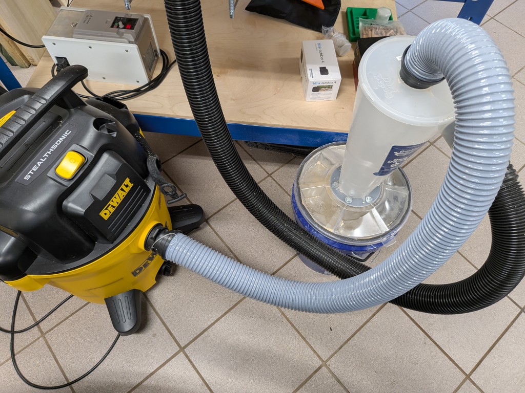

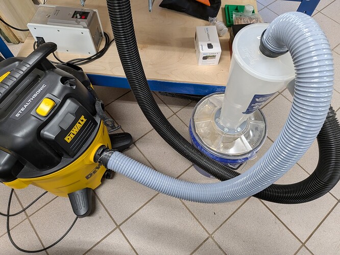

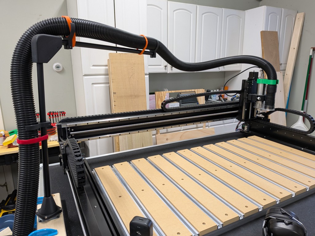

I’ve attached pictures of my setup, not sure if I’m doing it right but it Works For Me™.
I’ve got a Dewalt Stealthsonic attached to an Oneida Dust Deputy, which is then attached to the Sweepy. I picked up the boom arm from Etsy.
I believe both vacuum hoses are standard 2.5" ShopVac size?

Where do people get that green hose bracket? I’ve seen them in grey, which I like, but don’t know where to purchase.

I 3d printed that green bracket myself.
Carbide3D has a “3D Print Library” where there share several functional print designs:
https://carbide3d.com/3d-print/

As noted, I just run my hose through a bungie cord looped from the ceiling — lots of different approahces.

Where did you get the swivel arm that your hose is attach to?
Picked that up from etsy:
https://www.etsy.com/listing/736098852/vacuum-hose-boom-for-small-medium-and
