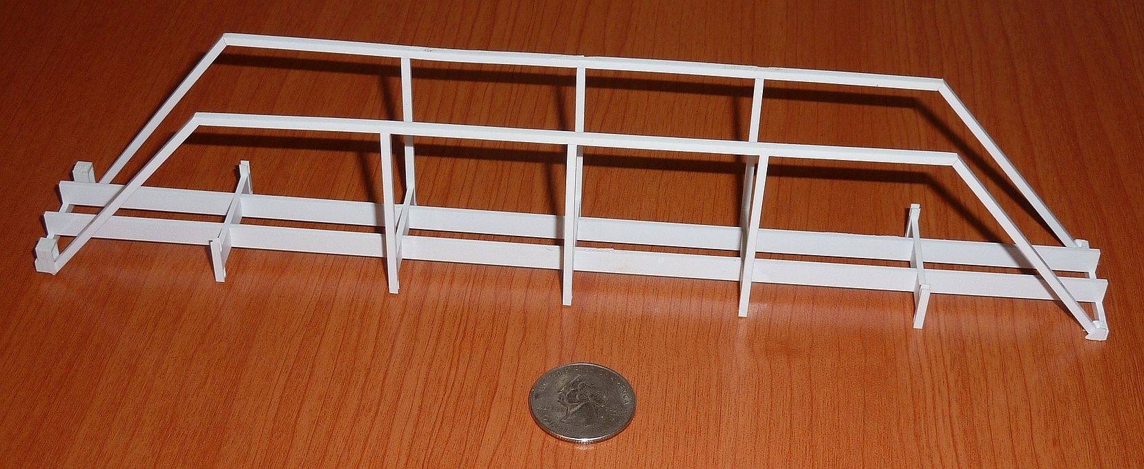

@1st_Kiwi_Nomad, I’m not really experienced on the Nomad yet, but I’ve been using MeshCAM since the early betas. I’ve machined parts on a Sherline mill, an Isel gantry table, a Tormach mill and now the Nomad. I have sleep apnia, and every night I use a custom nose mask I’ve designed and machined in 3D with MeshCAM (I’m on my 11th prototype). The most extensive machining I’ve done on the Nomad is on my model railroad bridge mockup, which I’ve machined from stock styrene shapes. This is where it stands now
and from here on I’ll add bracing members hand-cut from thin strips of styrene. But the Nomad machining involved cutting pockets in the wasteboard, indexed machining of the main beams which are longer than the X travel, etc. It has been a good learning experience.
The biggest 3D machining was my ill-fated Millenium Falcon, which led to discovering the step generation errors, but I haven’t gone back and done a successful machinng yet.
