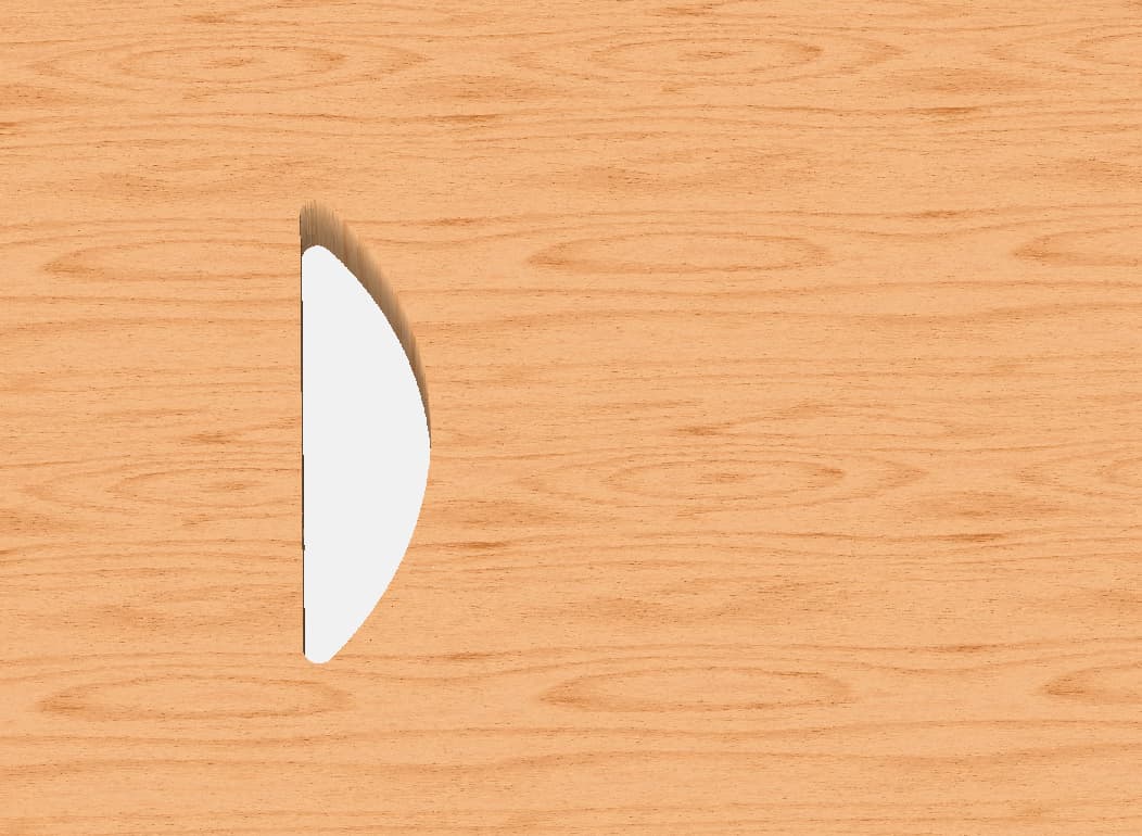

I’m designing a tray with handholds on both ends. I plan to route openings for these handholds using a pocket toolpath with a #201 (1/4") end mill, setting the maximum depth to the bottom of the stock, which is 3/4" thick. Since I’m new to CNC, I’d appreciate any advice to ensure this turns out well.
I’d add tabs to make sure the piece you are cutting out does go flying once it’s almost cut out. That would also help keep it clean and not have any tear out.
Since you are pocketing - I don’t think that a piece flying out would be a huge risk. With pocketing - maybe .03 stepover at full cutter tooth depth would work depending on the rigidity of your setup and the power of your spindle/router.
Some other considerations:
Consider using a profile cutting path - with roughing passes and 1 or 2 finishing path.
Consider a couple of countersunk screws to hold down the part if you are using a profile path
Any square endmill should allow cutting a clean flat bottomed pocket (agree that you either want to use a pocket and remove the material compleatly or use tabs to hold the center part in place — it also looks like your stock is thick enough that you should use offset geometry to cut as a pocket down to tab height or the penultimate pass).
You might want to use a roundover tool, or even a V tool to ease or at least chamfer the edges, see:
Here is how I would do this, assuming that the center portion was large enough to be worth saving (I have a tall stack of bins where I sort pieces by size):
Use the endmill diameter plus 10%
Apply
which would work if using workholding such as Blue painter’s tape and cyanoacrylate which would hold the stock in place. If that’s not the case, or if one wants belt and suspenders:
reduce the thickness by the height of tabs:
Then select the outer geometry:
and assign a No Offset Contour toolpath:
and assign Tabs in the Design tab:
Ok
which then previews as:
If you wanted to ease the edge with a suitable tool you could offset a suitable distance:
Apply
Ok
which would then preview as:
Thanks William. Appreciate your suggestion and quick response. This is very helpful. I will try your suggestion. Thanks again.
