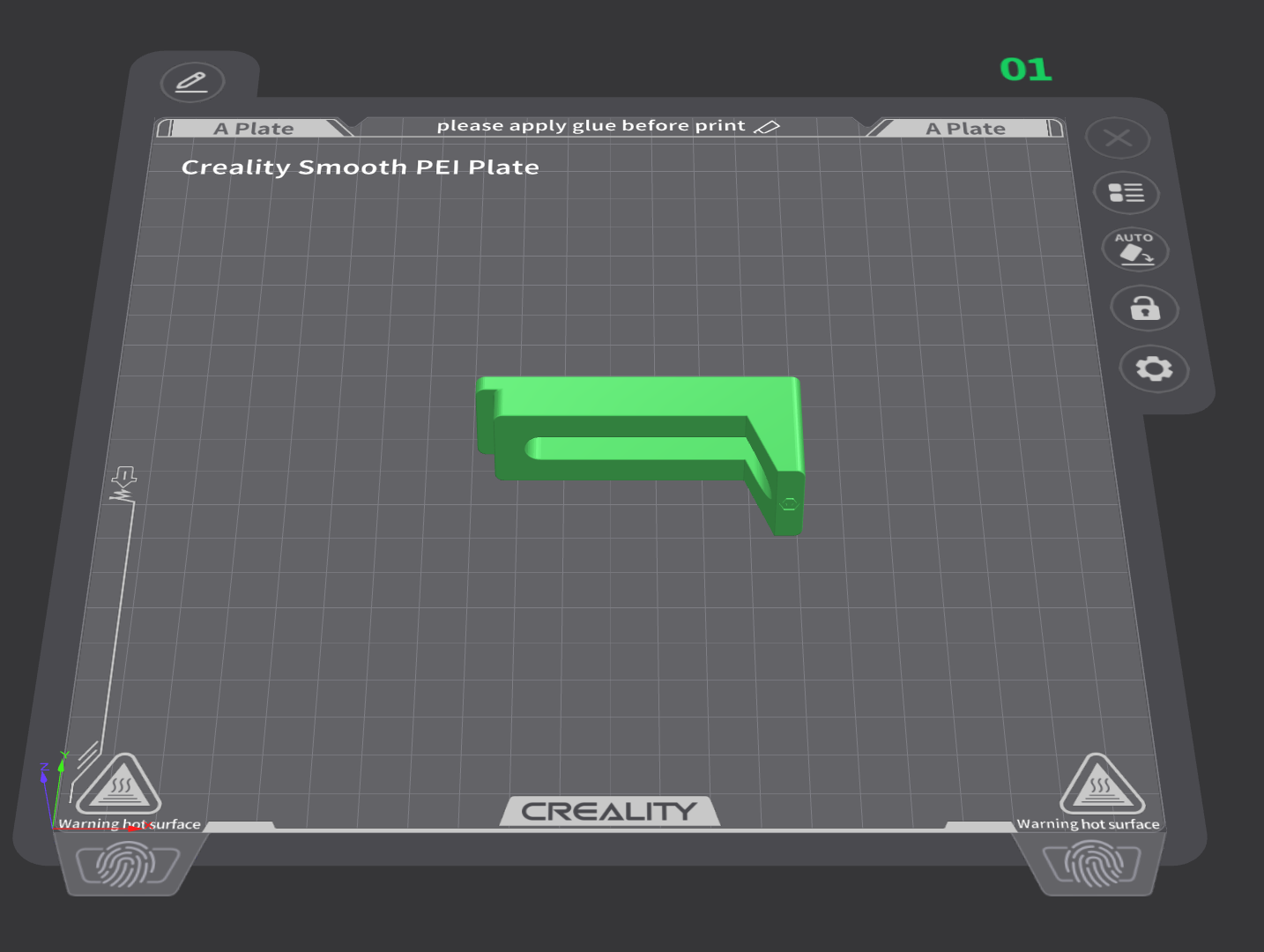

Bought a 3D printer (Creality) to print some of the hold downs, trays and such. Bought a spool of PLA filament. The hold downs do not require a lot of force before they snap. Is there a different type of plastic I should be using? I understand that it won’t ever compete with injection molded hold downs, but hoping to get a little more flexibility in them.
What infill did you use?
Is your printer well-tuned to get good adhesion in-between layers?
I use PETG. It’s stronger, has the added benefit of being more suitable for the summer temps in my shop, and doesn’t have the smell of some of the other higher temp filaments.
Make sure to print in an orientation that best resists the force you are applying. The material is going to be weaker between the layer lines than across them. Similar to wood grain.
The problem I think here is that I know next to nothing about 3D Printing. Not sure what infill means, nor how to tune a printer.
What I’ve done is try to use your essentialclamp1.stl file. I layout a bunch of them on the printers table top in the program they provide (Creality Print). Then just send it to the printer which prints them for me.
What I’ve had happen is as I tighten a project down (using the clamp steps for the proper height) the clamp separates at the lip from the body of the clamp (where the clamp comes into contact with the project) if I apply to much force on the bolt.
With regards to what Shane mentioned, these are laid out so the print head is running the length of the clamp. Don’t know if that matters.
Try printing them on their side with supports, should be quite a bit stronger.

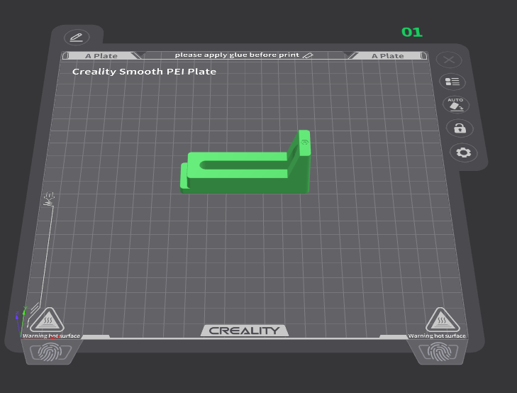

I have found with hold-downs the orientation of the hold-down is far more important than the material. 3D prints have a “grain” like wood. So you can print a part in one orientation and it is super weak. Rotate it 90 degrees in the right way and it will be strong. Can you post a picture of the clamp and I can recommend an orientation?
As @dakyleman suggested, 90° on one of the sides will be a lot stronger. You’ll have to use supports, but that orientation will work a ton better. :slight_smile:

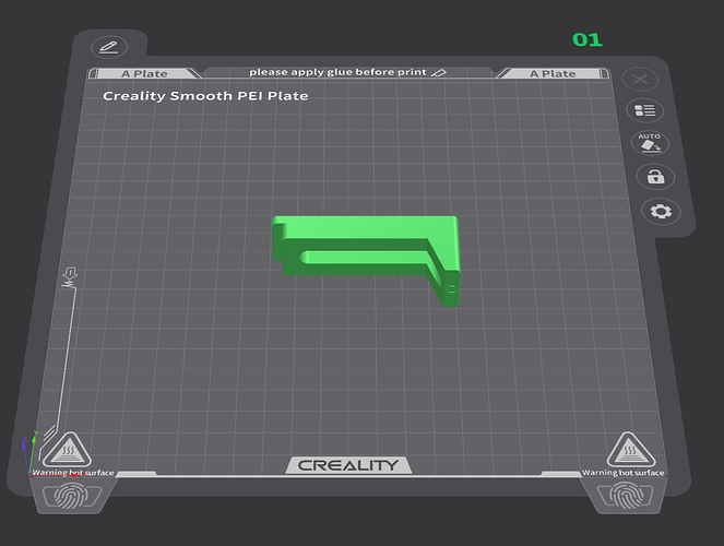

Like this?

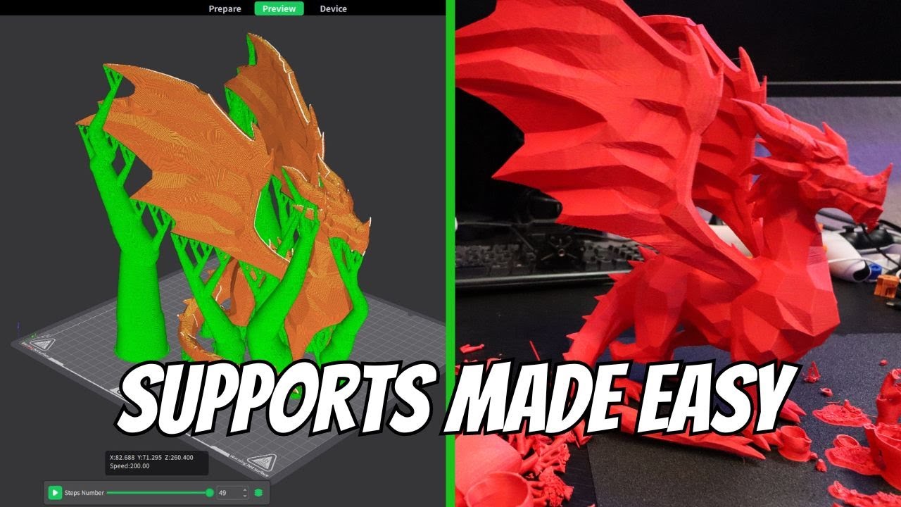

And what do you mean by using supports?
Correct. Supports will keep that slot from sagging down. Give this video a watch:
Thank you so very much.
