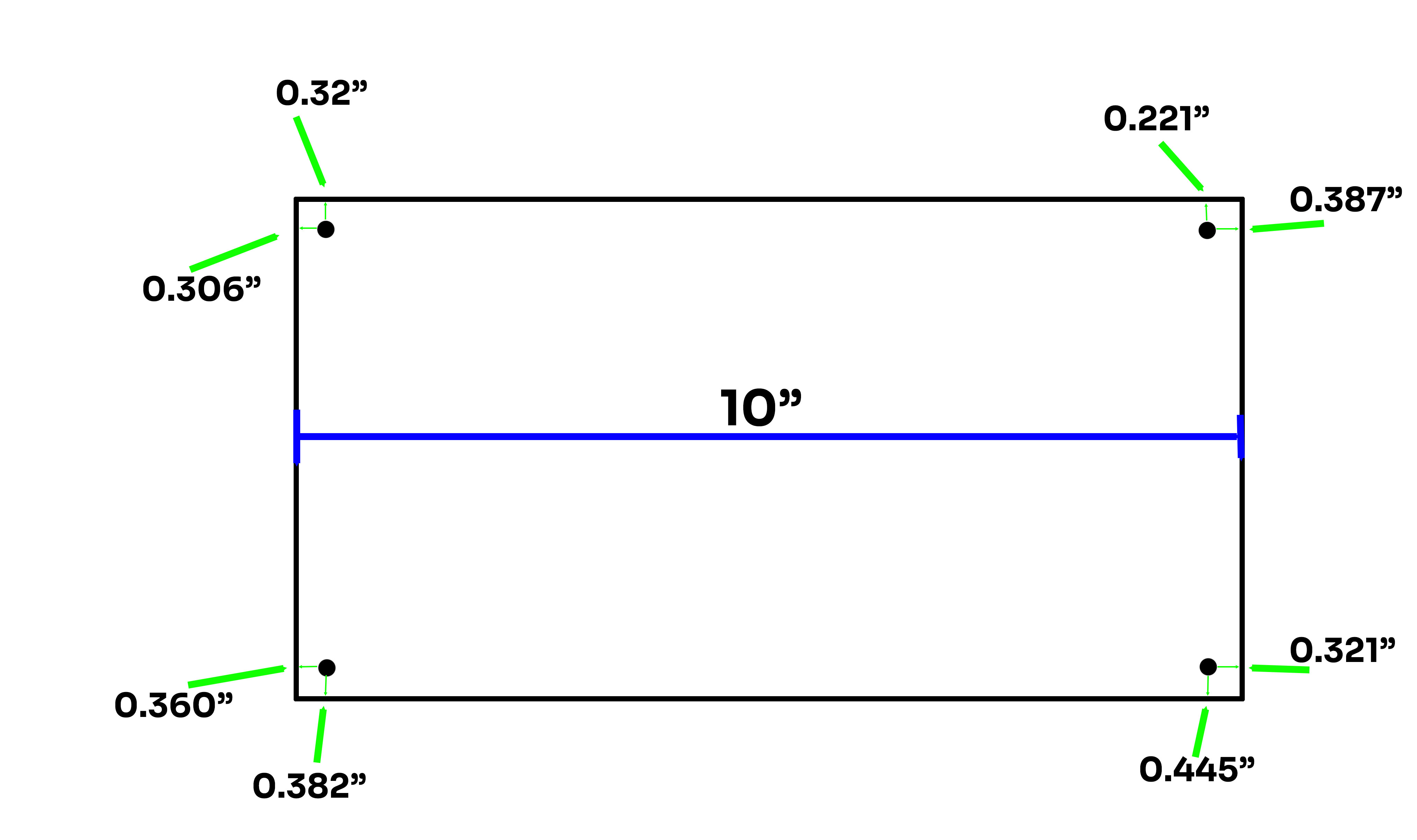

What's causing these hole location inconsistencies?
I have my work piece clamped onto a 90 degree fence. To make sure it was square I jogged the end mill from end to end while tightening. I’m not sure if it’s perfect but it seemed good.
I’m drilling holes on each corner of my work piece and getting major inaccuracies. I made an image to show just how significant. Any ideas what’s causing it?

Are you measuring to the center of the holes?
If a belt-driven machine have you calibrated for belt-stretch?
You’ve entered your measurements with 3 decimal places. How are you measuring that accurately?

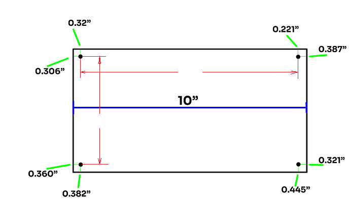

Also, it looks like you are measuring from the nearest edges, when it was all programmed from, I assume the lower left corner. What are these dimensions?
I have a S3 XXL HDZ with dewalt router.
I measured with a caliper from inside the hole to the outside edge.

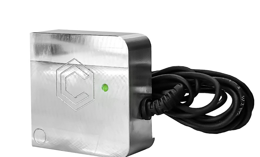

Also feels like a retarded question, especially since I’ve been using the CNC for so long now… but I’m getting some problematic inaccuracies using the bitzero. I’m looking to test manually zeroing my work piece. For extremely good accuracy should I zero using the center of a vbit?

What bit are you using when using the BitZero? You can use any bit for probing Z, but a VBit is not the right bit to use for X & Y.
If you also have a BitSetter, then the best ‘bit’ to probe with is the dowels that came with the BitZero.
If he has a 3 then it is unlikely he has the bitzero V2 which comes with the probe pins. I originally had a V1 and it was used but I assume it did not some with the pins either since you have to pick the bit when you probe.
I bought some 1/4” steel pins and used that even with the V1 though.
Just looks like your work piece was rotated ~0.75 degrees clockwise due to fence being out of square with machine.

With the bitzero the major inaccuracy that I know about is on the z-axis. Usually -0.035" compared to if I set the z-axis manually after the x,y,z corner probing cycle. I probe with either a 1/4 or 1/8 end mill. I would only use a vbit for manual setting if that’s a good idea.

Did some tests on the X,Y for bitzero and it’s accurate. It’s just the Z axis which is off and that’s not a big deal.

I don’t usually probe just for Z but as I understand it when you don then entire Bitzero should be on the surface of the material, not resting over the corner. Have you tried it that way?
I assume by your description of looking for a non scarred pet you are only doing Z since when doing the corner probe you have no control over that.
I have crashed into my BitZero multiple times by forgetting to attach the lead. At least that is a slow crash but makes me slap my head anyway.
Ohh yea didn’t consider running just the Z probe, I’ll try it out so see how accurate it is. Usually I do the corner probing (x y z).
