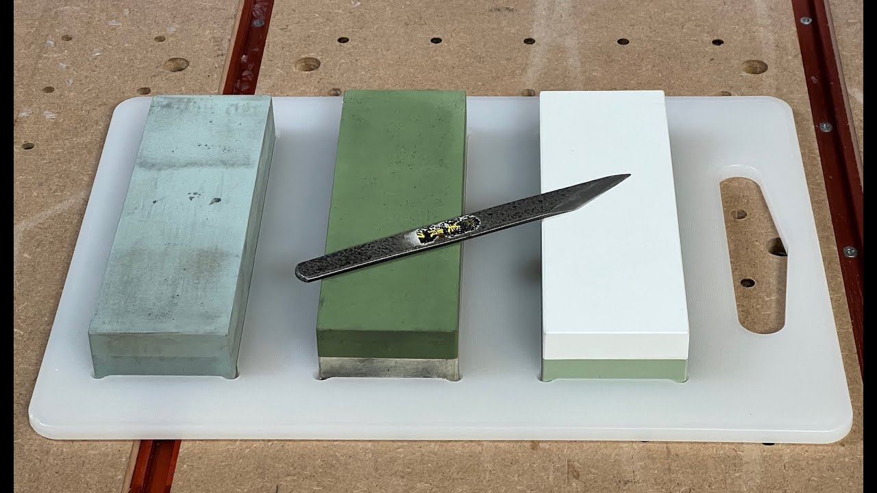

Slightly easier material but, here’s some LDPE
Cut at 20,000 RPM with an 8mm O flute plastics cutter, feeding at 2,500 mm / min and minimal stringies. Finish passes with a 1/8" single flute at 20,000 RPM and the same 2,500 mm / min feed rate.
