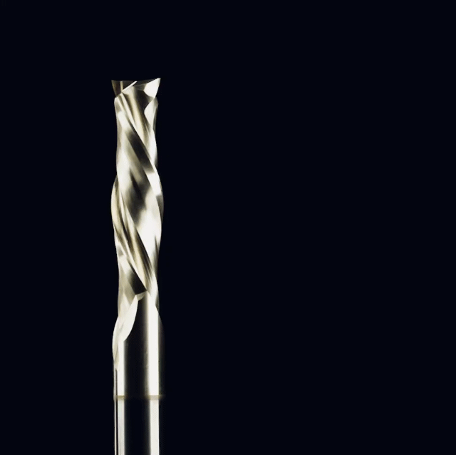

I also have a groovee jenny 60 degree down cut bit but they make other bits that are equally as good.

There are compression bits that can work with Shapeoko-class machines, they have a very short upcut region so that a ‘normal’ DOC still cuts as compression. Even though a thicker cut requires multiple passes, you still get the benefits of a compression bit - clean surfaces both top and bottom.
The ‘Jenny’ bit is such a bit, I have had good success with it in both hardwoods and softwoods. A DOC of 0.110 (or more) will cut as a compression.

Only plunge past the up cut zone & do multiple passes to final DOC.
