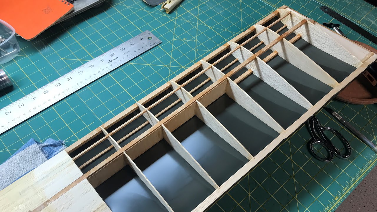

It’s probably less important for a turbine, maybe heavier is better, but for a wing aerofoil the weight is a major target. It’s pretty common to cut ribs and then fill the gaps with a light foam type material which can be shaved down to profile and then apply a resin and fibre skin.

Here’s a lightweight wood structure which looks familiar, this guy is ‘sheeting’ the wing in thin balsa, I’ve seen cloth and resin used on top of this for strength, also filling the gaps with foam and then lightweight fabric & resin skins, just make sure the resin isn’t a solvent for the foam core you use ![]()

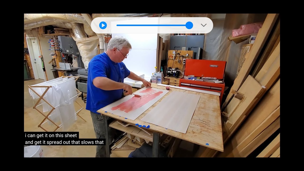

This gent has some things to say about fabric coverings

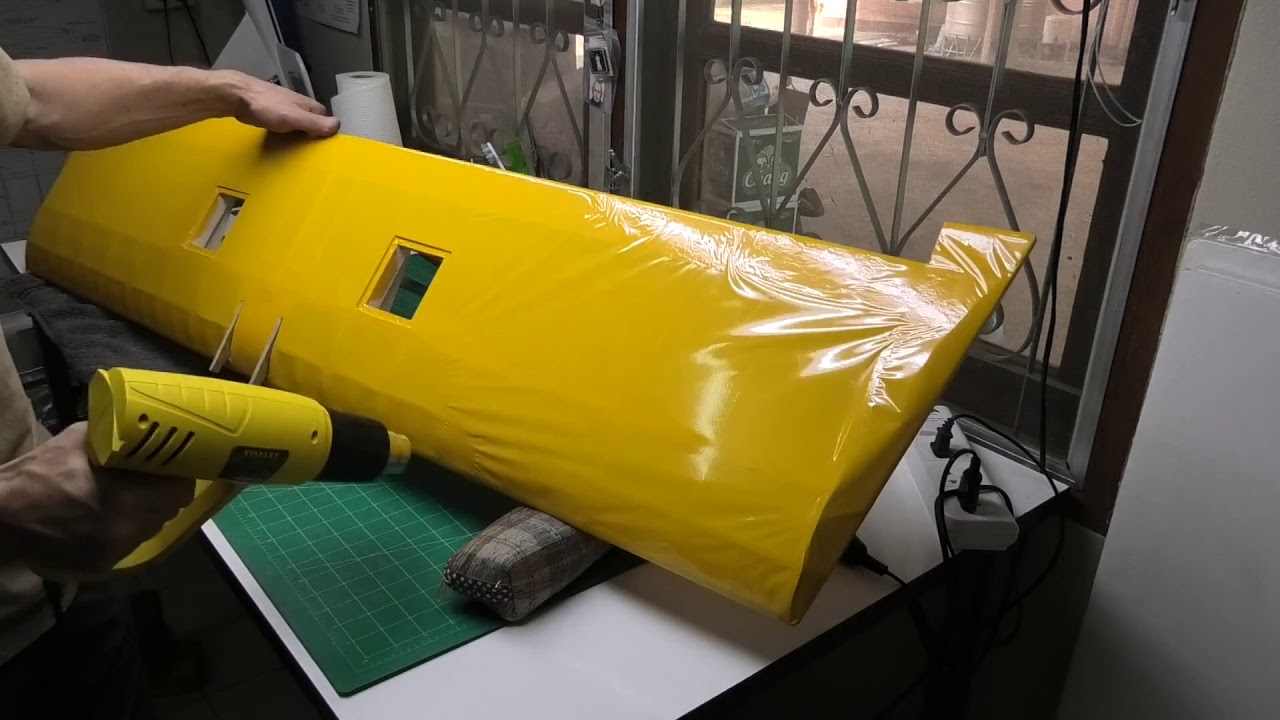

Glue on and shrink films seem to have become more common

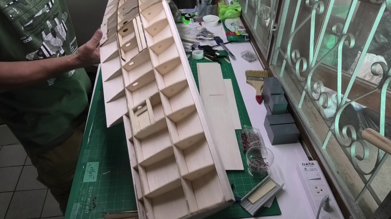

And here’s some folks using hot wire to cut foam between wooden rib formers
