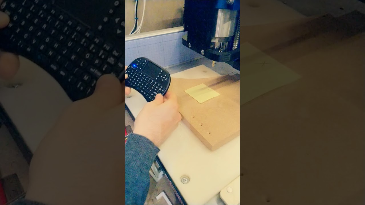

Wireless keypad pendant for CNCjs, with smooth jogging
After having been triggered by @ctdodge and @GoSmitty in this thread and @PaulAlfaro in that thread, I had a look at adapting one of the existing pendants for CNCjs, to derive something that would work with a wireless keypad AND have smooth jogging AND be compatible with using CNCjs on Windows.
Exactly as I knew would happen, the one hour experiment turned into a week-end of trying out various things, “enjoying” the fun of Node.js development under Windows (:face_vomiting:), getting prototype #1 to run, realizing this was a dead-end because Windows won’t let an app steal the control of a secondary keyboard device, and restarting from scratch with a different approach. Anyway, enough developer rambling, I ended up with a pendant that will catch specific key presses from a keyboard and send associated G-code commands to the machine via CNCjs, to jog around by steps or with smooth/continuous jogging.
I mapped it like this (illustrated with the keypad the popular kids have, but it will work with any keyboard/keypad):
  • pressing the left,right,up,down,pageUp,pageDown keys will jog the machine by the FINE step size, along X/Y/Z
  • holding the Alt key while pressing these jog keys will jog by the MEDIUM step size
  • holding the Ctrl key while pressing these jog keys will jog by the LARGE step size
The distances for FINE, MEDIUM and LARGE can be modified in the source code, they are currently set to 0.1mm, 1mm, and 10mm.
  • /!\ holding the Shift key while pressing a jog key will start a CONTINUOUS smooth jog along the selected axis (no need to hold the key). Pressing the jog key again WHILE still holding the Shift key will STOP the movement.
Here’s a quick demo:
Now, for the bad news: the way it’s implemented, the pendant needs to be started from a command line shell in Windows, and then that window needs to have the focus for the keypad presses to be taken into account. It works, but it’s a bit inconvenient because on typically has the CNCjs window/app active.
