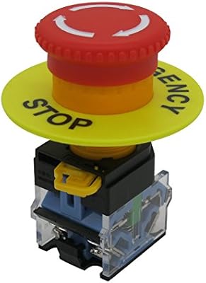

My current 120v E-stop is simply connected to a 4 outlet power strip that has my router, light and SO3 plugged into it. Hit the E-stop, everything off.
What’s the best way to incorporate this sort of manual disconnect with a 220v VFD?

I doubt naive, but all your circuits are 220. For us, here in the US, we need to wire two flavors (110 and 220) to an E-Stop. I’ve been Googling, just getting confused
Got it. Double pole E-stop maybe ?

I don’t know the right term/name for these switches, but they are modular, the top switch button controls the switch state (push button, on/off, rotary, etc) then the switch contacts control open/closed state and are stackable. I use several of them.
I stack two of the switch contact blocks, giving me two of each NO and NC circuits; 4 isolated circuits total.

So, I wire 220 to one and 110 to the second? Seems simple enough. Plus, I think that’s the switch I have now.

Yep, I actually bought a mix match of switches as I couldn’t find ones with the exact NO/NC combinations and reconfigured them to my liking and use cases.
I have a main power e-stop that cuts all power, and a second e-stop that uses the software stop/hold mechanism. Depending on the situation and level of emergency. Also, I have a router, so no spindle braking.
