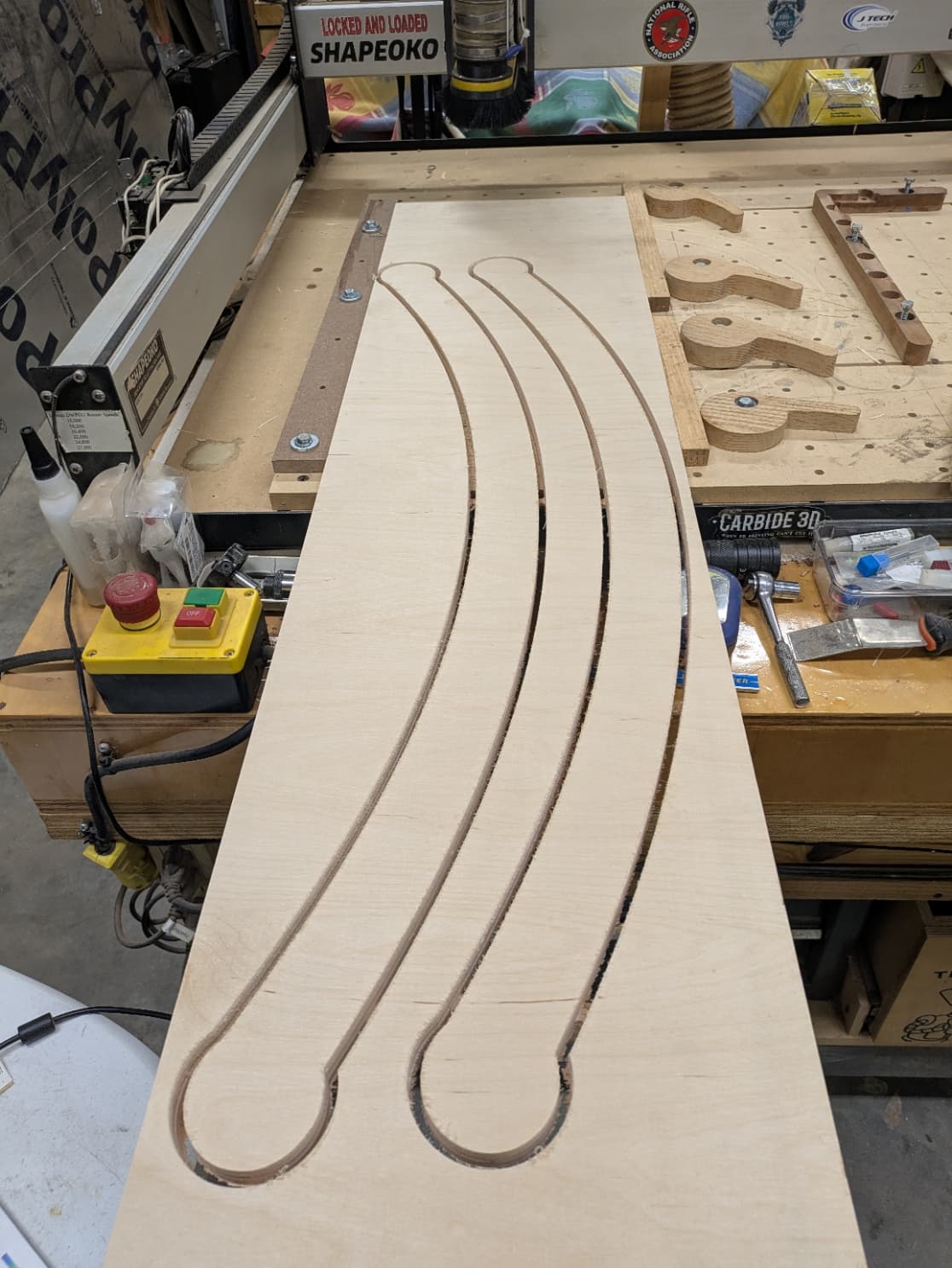

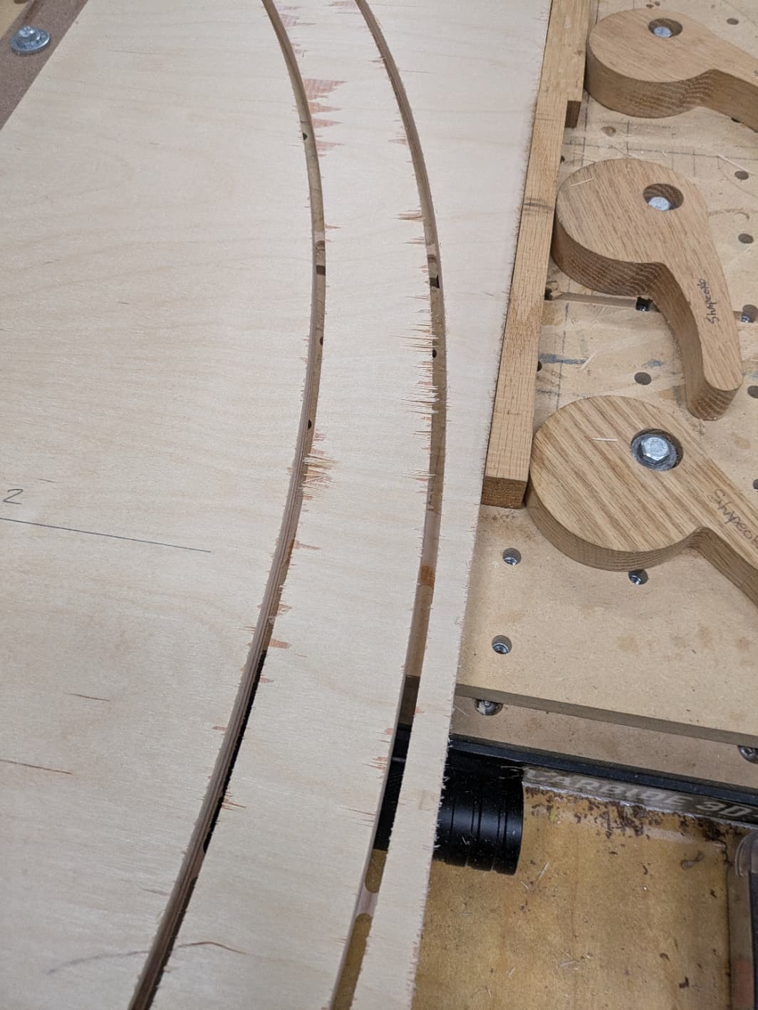

Here is an example of cutting plywood with a #201 bit. You can see at the bottom half of the cut there is very little chip out. But on the top half there is a lot. On the bottom half the bit is cutting with the grain and on the top half it is cutting against the grain of the veneer. Same plywood, same bit but different results.
This was a prototype of a rocker for a rocking chair.
I cut the second prototype after modifying it and used a #251 down cut bit and there is considerable difference.
On the second cut the bottom had some chip out but this will be a template to router out some 2" thick rockers for a chair. So the router bit will run on the edges of the template. But had I wanted a good edge on both sides you could have started with a down cut bit and finished with an up cut bit.
This plywood is made in Indonesia and is birch. It is very light in weight so cheap plywood acts like cheap plywood. I dont not use plywood very often and prefer solid wood but this was a request from a friend.
