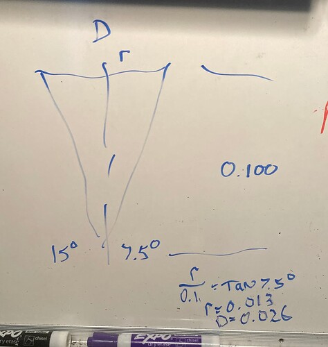

Vee bits are tricky because the cutting surface speed changes, gets faster the further up the bit.
Ideally, you would calculate the spindle speed based on the diameter at the depth of cut being used. So for a 15° cutter & a 0.100 depth

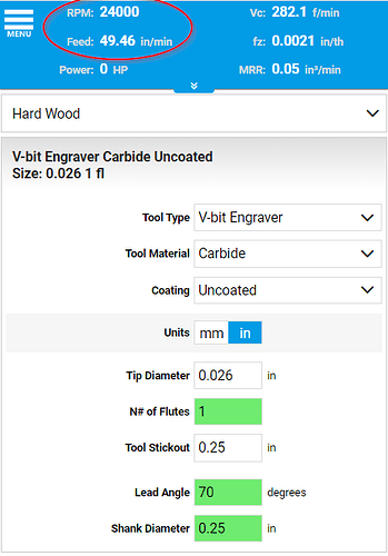

Your effective diameter is 0.026". Plug this in to fswizard…
At that small a diameter it’s likely going to use the max spindle speed
It’s probably shooting for a cutting surface speed (Vc) of around 1000, so you may have to play with the feedrate to get good chips & avoid burning.
