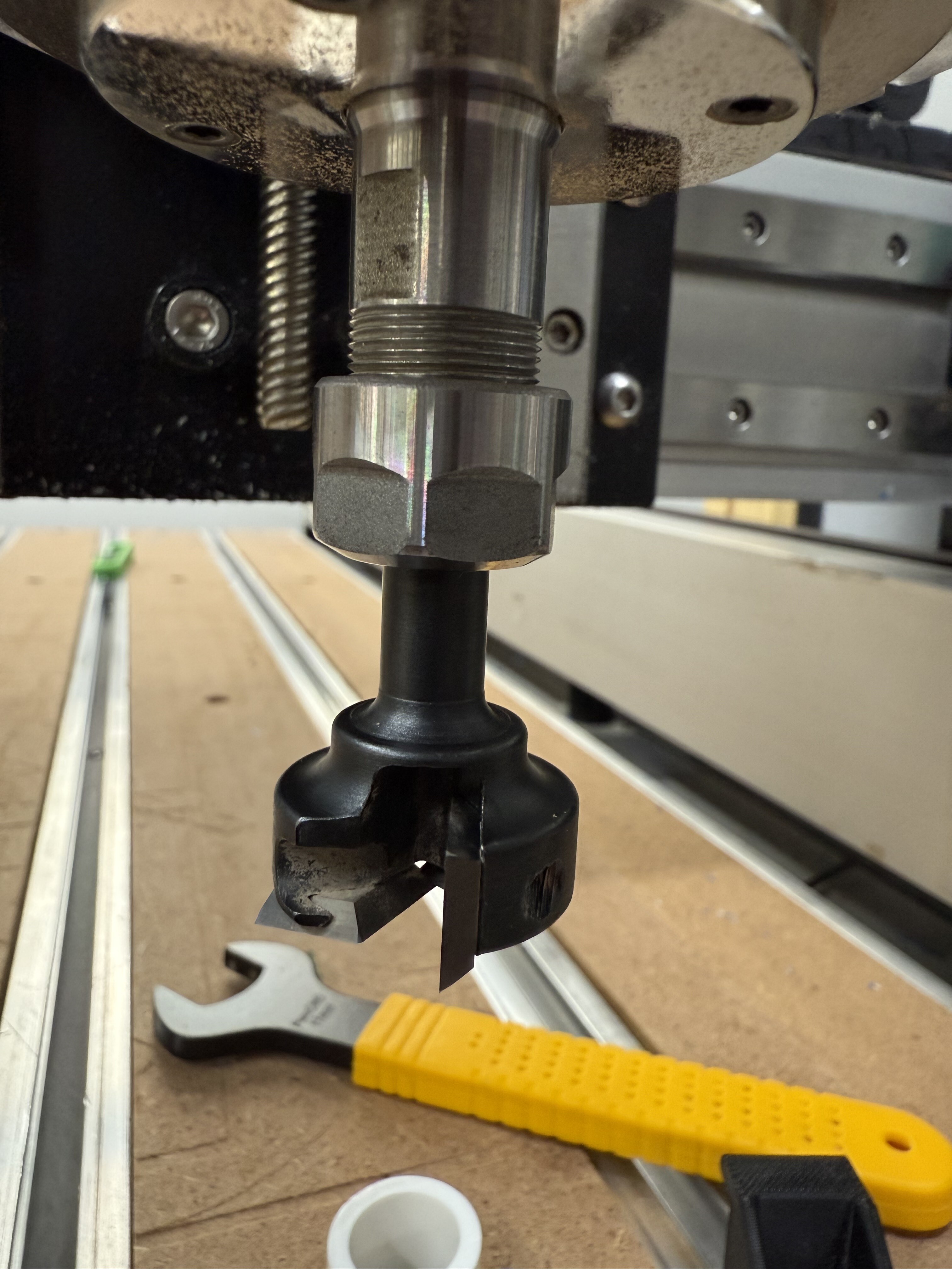

Hi Will,
I did purchase a Haas ER11 8mm collet and a couple of bits for my 65mm spindle hoping this would be a great upgrade, but what I found is that the bit will not slide far into the spindle. It seems the max may be 1/4".

So guys, I did some measuring. I wanted to see if it’s the same as your situation.
With the collet and nut completely removed, I can insert the 8mm bit into the spindle about 0.43 inches before it bottoms out. The 1/4" bit slides way further in than that. After installing the 8mm bit with collet and nut and tightening, the bit will be about 0.70 inches installed from the nut’s flat surface before bottoming out.
Is this aligned with what you are seeing? Would this be enough shaft installed as to not counteract the rigidity of the 8mm vs 1/4" bit?

The ideal position of a bit in the collet is all the way to the top of the collet. The collet holds the bit and the nut tightens it. The collet nut and collet are forced up an inclined plane inside router/spindle. So for the best grip the bit should be at least at the top of the collet. If you cannot go that far try it but at first I would pause every few minutes and check the tightness. If a bit comes loose it will mess up your project and could potentially come out and become a chuck of carbide flying possible at you. After checking that the bit is still tight after a few pauses then go ahead but it would be a good sanity check to still check the tightness on occassion. Another thing you can do is get your bit tightened up and put a magic marker where the bit and collet meet to give you a quick visual check. Just remember that the bit and collet have to be forced up the inclined plane so if it is already bottomed out before tightening it could lead to disaster.
Great info from Guy, however, what I’m looking for is actual dimensions from people currently using 8mm er11 collets and bits in the 65mm spindle to see if my setup compares or is something amiss. I can insert the 8mm bit into the spindle without collet and nut about 0.43 inches before bottoming out. When using the collet/nut 0.7 inches of bit are inserted before bottoming out. ( the 1/4" goes much further in ) . @Redlander , @WillAdams , is this what you’re seeing as well?

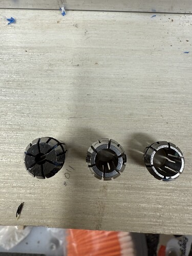

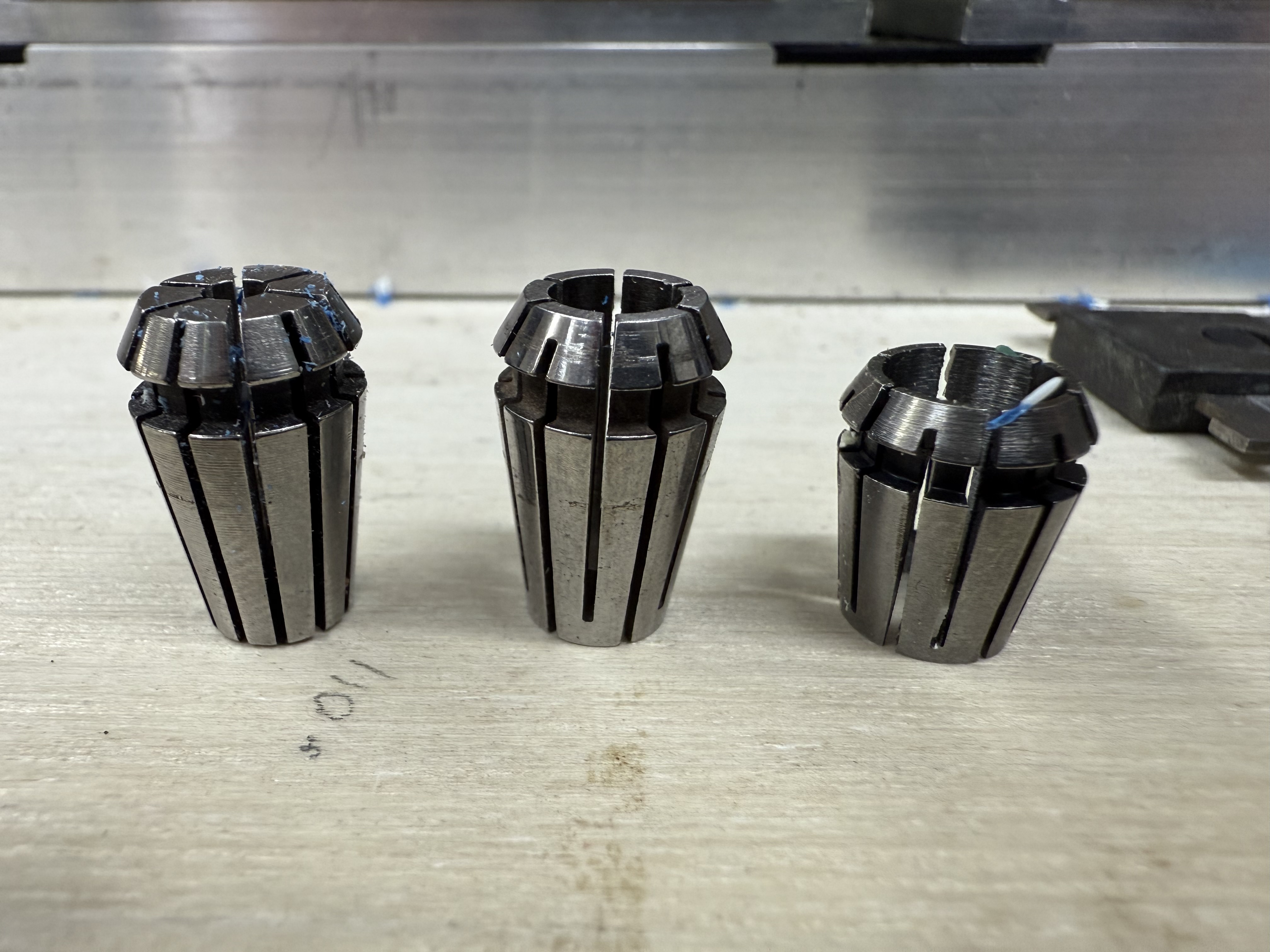

I finally got around to testing this today. I didn’t fully understand what you were saying before but you are right. The 8mm shaft can’t go as far into the spindle shaft as the 1/4” one does. Mine went in about 3/8” without the collet and nut so the hole in the center of the shaft is not large enough for the 8mm to go up further. I have the PWNCNC 65mm spindle.
I took a few pics for others to see. I was surprised when I got the 8mm with the lack of metal there but I guess it makes sense.

That 8mm collet is 9/16 tall so if only 3/8 of the shaft went in it wasn’t quite to the top of the collet.

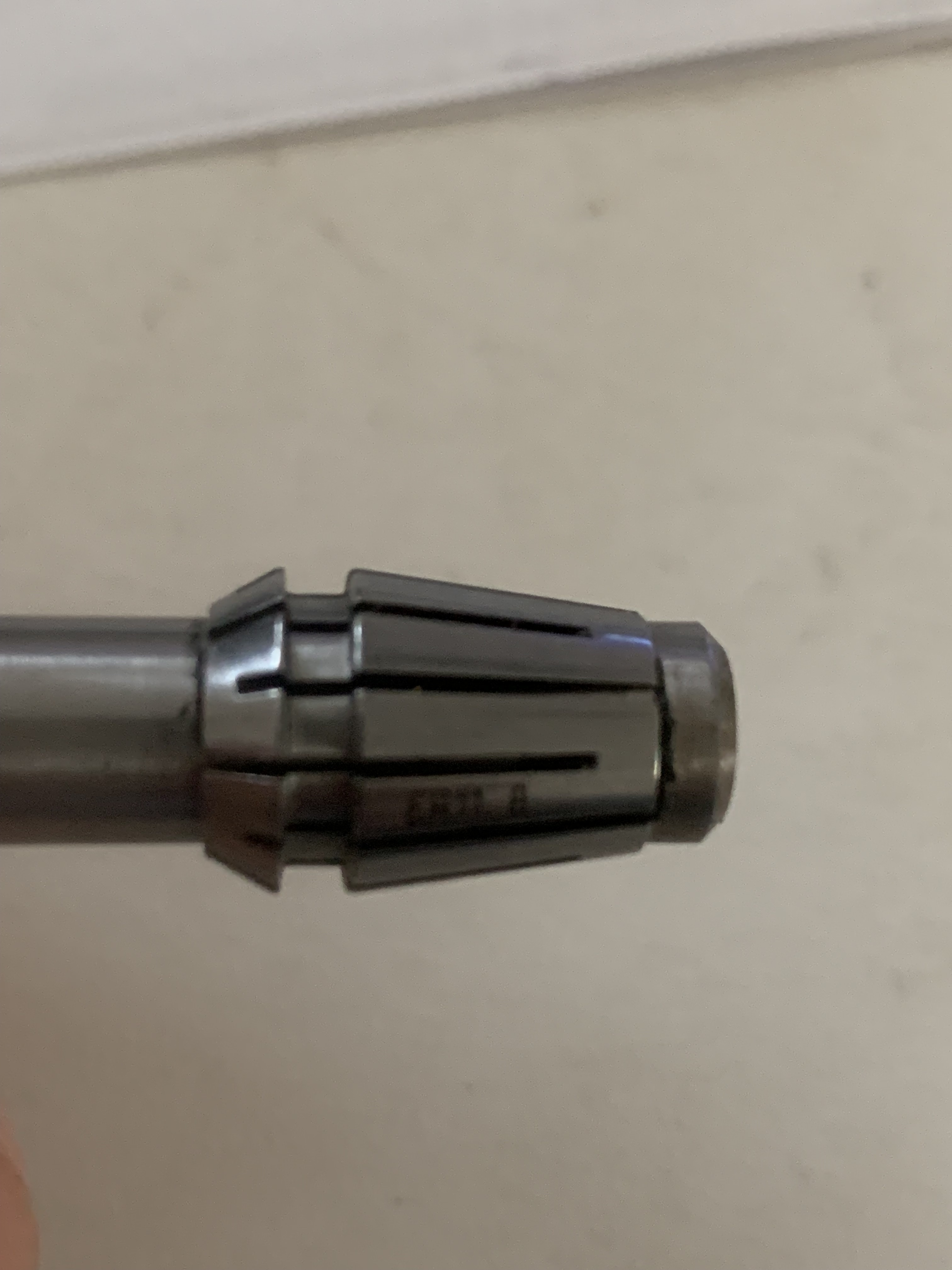

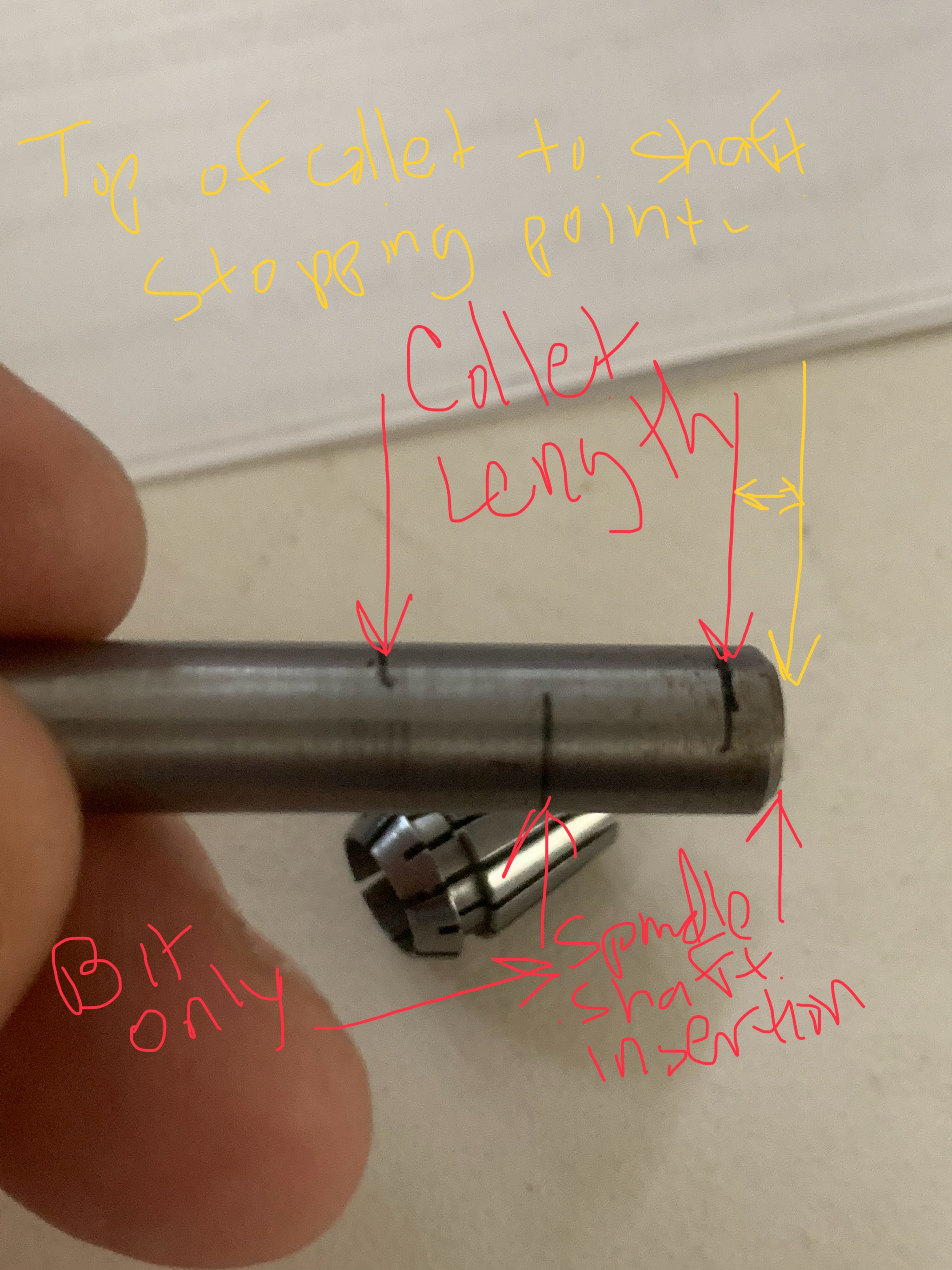

Sorry for the late reply, just got the dimensions (approximate, Fine sharpie). Attached in the photo;
WP Bowl Bit, US8121BB, 8mm shaft.
Bit only insertion in spindle = 0.463” (red)
Collet length = ~0.605” (red)
Total collet length to end of bit = 0.736” (red to yellow) (This was bit fully inserted and collet seated by hand fairly tight)
Top of collet to top of bit = 0.13”
So, plenty of room if the bit is seated even with the top of the collet. But not by much.
