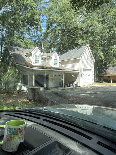

We bought a new house that includes a much larger shop so we have been moving for the last week.

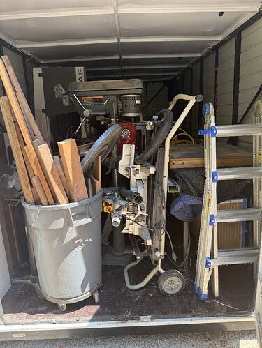

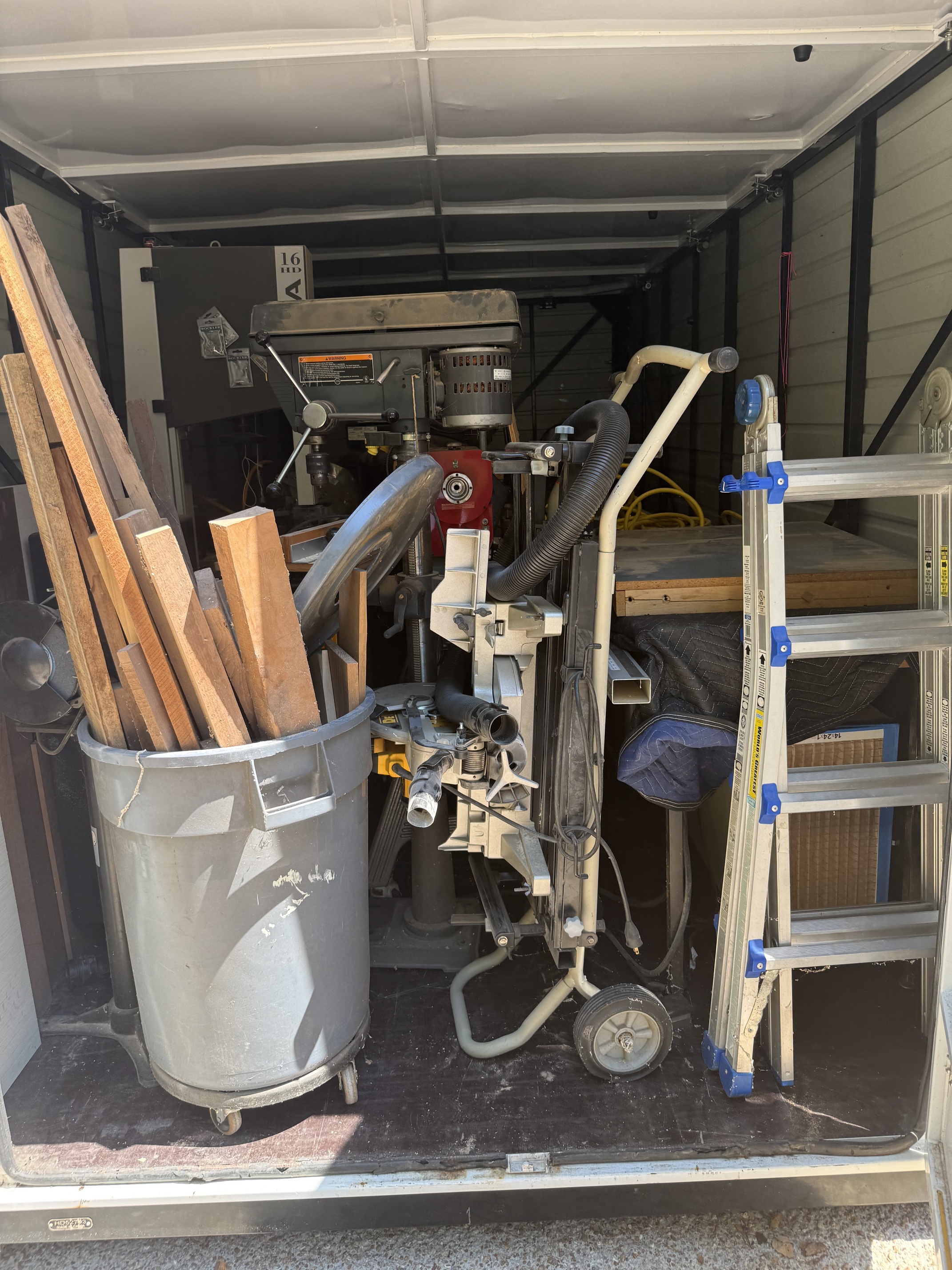

I had a POD like thing delivered for my shop equipment and paid the movers to help me load it. Our driveway is a lot of aggregate pebbles so I figure those fancy retractable casters linked above would have issues with the driveway. I couldn’t get the guy to place the container any closer so I had this “brilliant” idea to lay down tracks with old deck boards to roll it on. It was about 25’ from the garage to the container and then a 10” rise give or take.
We started and the movers (3 of them) decided it was too slow so they and I picked up my 5.1 Pro 4x4 with VFD, vac, coolant, etc… and carried it into the container. They were some pretty big boys.
Hopefully I can get the container closer to the new shop.
For those of you thinking about moving here are some thoughts:
  1. Don’t.
  2. if you have to, don’t do it in August in south East Georgia. It’s been a miserably hot week.
  3. a 16 foot container doesn’t go as far as you think it will with a 4x4 machine, lathe, Laguna bandsaw, Delta cabinet saw, drill press,
    Air compressor, router table, 2 miter saws etc.
They got all the heavy stuff in there but I have a ton of other small stuff and a work table I will have to transport.
The new house is only 4 miles away so I can make a lot of trips.

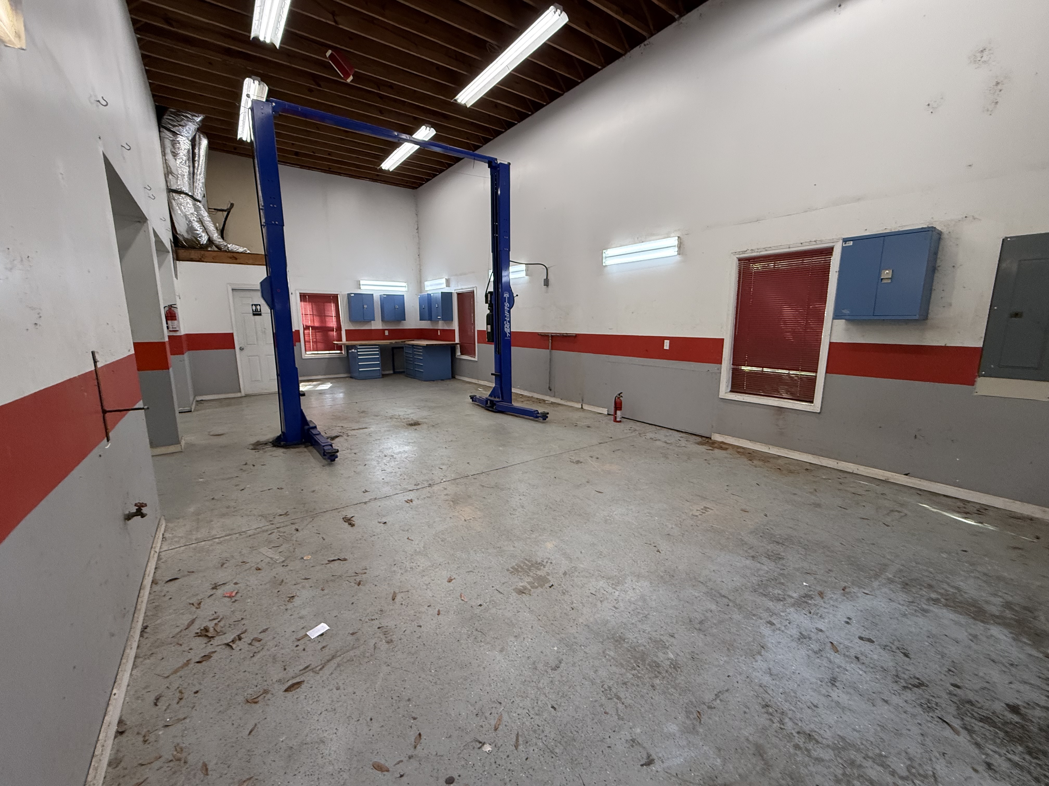

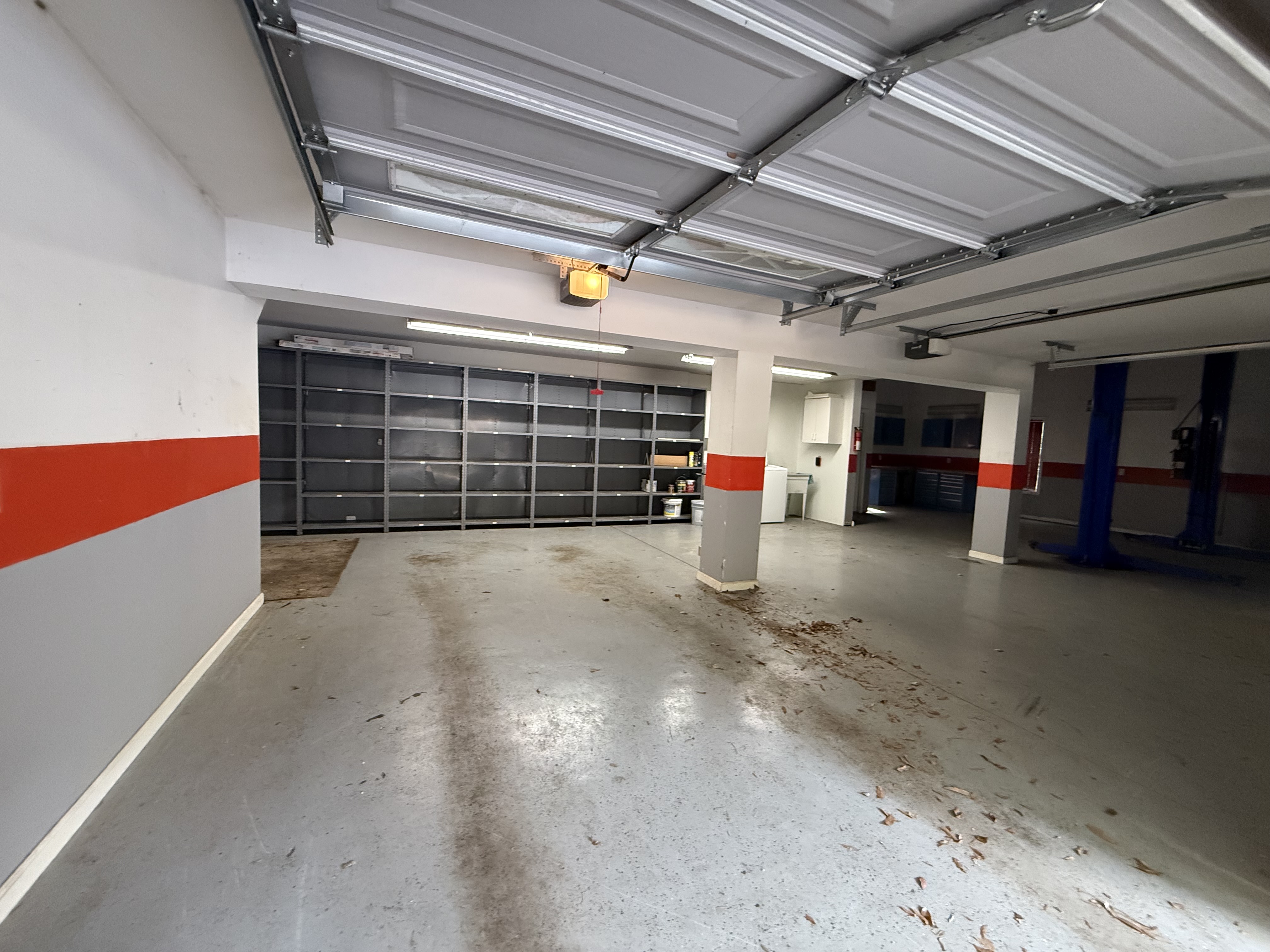

Now I have the problem of figuring out the best layout as well. The shop is 2 low bays that are about 25’ deep and then a high bay that is 18’wide and 40’ deep. It has a car lift in it now which I don’t want and will be selling.
I’m not sure it has enough shelving😂
