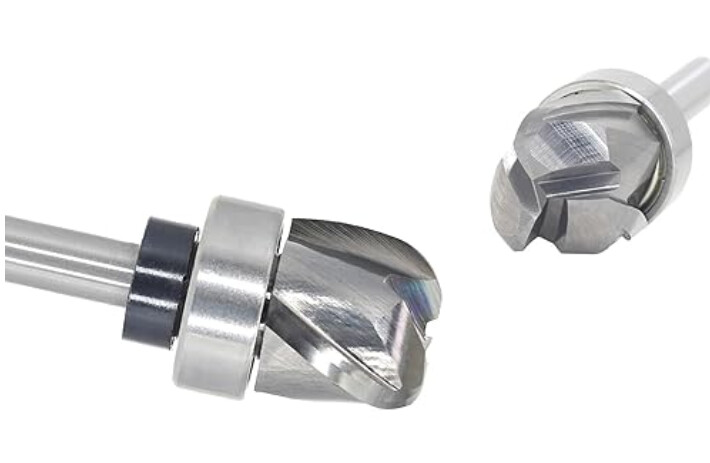

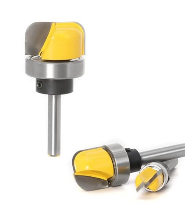

they are available in different diameters and radius’. With a small radius like 1/8" the bottom one creates is for the user difficult to clean: I cannot get into the corners with my sausage fingers, even for applying my wood butter, therefore the ones with 0.25"radius are the best for bowls IMO.
And: this kind
has 3 cutting edges, what makes a much smoother surface, and allows for higher speed, and -IMO most important- the cutting edges are sharp, not just 90deg like these:
that just scrape off dust instead of clearly cutting chips.

So… stupid question of the day. Do you leave the bearing on? Does it come off? I assumed from my reading and watching that bearings on bits were a big nono.
