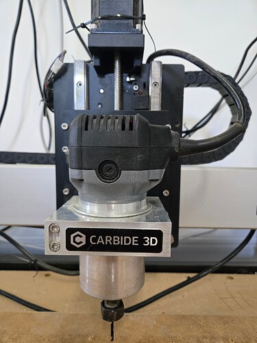

So I just got an old SO3 XXL that appears to be in pretty good condition. It has the Z-plus carriage, and someone upgraded to the EM limit switches.
I’m noticing that I appear to have very little Z-axis travel. I haven’t measured it, but it appears that there should be no reason why the router can’t lift quite a bit higher, other than the position of the limit switch itself.
Am I missing something here, or is that switch in the wrong place? In the attached image, the Z is fully ‘up’.
I didn’t do the setup on this machine, and I’m brand new to the Shapeoko family, so someone please educate me. :slight_smile:

If you look closely at the image, you’ll see that the top of the Z-axis sled is touching the limit switch, so that’s what is preventing it from moving any higher. I’m just wondering if that switch is in the correct place or not. If anyone has a link to the installation guide for those switches, I can check myself.
Hey @Elmojo Are you saying that Z travel is being stopped by the the top of the router plate tripping the proximity switch? It shouldn’t. The Z-axis is designed such that the router plate should travel past the proximity switch all the way up to just short of the Z-motor mount. If your proximity switch is triggering on the top of the router plate, the prox switch it is probably not laying flat enough on the carriage plate and/or is cocked to one side as shown. You probably need a second screw to hold the switch flat against the X carriage plate and square… Mine was really sensitive and had to be positioned just so in order to not trip on the router plate.
Also, there is a chrome pin on the back side of the router plate that triggers the proximity switch and stops the router plate as it is rising in Z. You can’t see it from front, only from above looking down between the router plate and carriage plate. It screws into the backside of the router plate about 2" down on the right side between the lead screw and right rail if I remember correctly. Adjust the height of the prox switch so that the pin trips it just before the top of the router plate hits the Z-motor mount. This will optimize your Z-height.

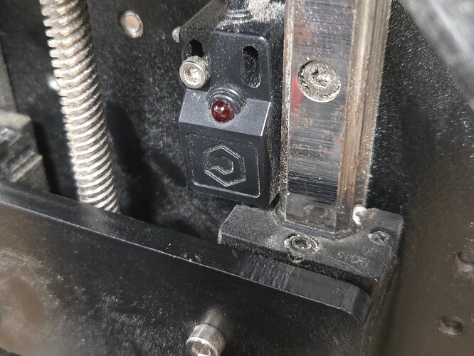

I’m pretty sure I understand your explanation (thanks for the details, BTW), but there’s no way mine will do that in its current physical configuration. Take a look at this…
You can see that the limit switch is hitting the top of the rail slider. In this position, there’s zero chance of it traveling any higher.
That has to be the wrong position for that switch, right?

Yep, that’s not right, you said the limit switches were replaced correct?
I looks like that switch should be moved to the left and mount the bolt in the right side of the limit switch. It should clear the linear bearing then. I believe it should also have two bolts mounting the switch.

In the meantime, I moved the switch as suggested. It appears that someone broke off the left-side screw, so I had to just stick with one screw, in the right side. It seems fairly solid, but I may try to go back and get that broken stud out and put in the 2nd screw at some point.
Hopefully, this will allow the sensor to pass, and give me the extra Z-travel I was expecting.

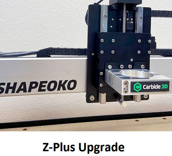

Picture from from the Upgrade Guide showing the position of the Z proximity switch.
@Elmojo
The photo posted from Bozo (Thank you sir!) clearly shows the switch offset from the linear rail which would allow the linear bearing to clear to allow full Z access travel.

I’ve confirmed that moving the limit switch has indeed restored my full Z-axis motion. Thanks to all who helped figure it out!!
