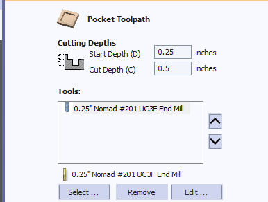

Z height discrepancy between Z tool path height and Gcode output in Vectric

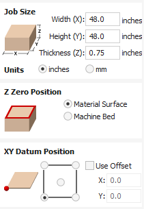

Where should I assign the X/Y datum point, on a Shapeoko 5 Pro (for Vcarve Pro setup page)? (Front left, etc?)
Also, anyone have a guess as to why the Z height is spitting out a different height, in the Gcode it generates?
(Here’s a SS from Vectric support)

set it to the lower left for starters. (and what Guy said is also relevant). If you have correctly set up the machine for what you actually have, then set up the XY in the lower left both in the software and litteraly where you set the xy on your machine must match.

Does the Z need to be set manually w every material change (or is smart enough to be able to reference off of wasteboard and the material thickness you provide)?

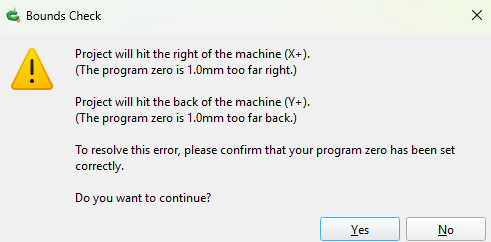

Separately, is this a stopper, or does the 1mm matter?

You need to set Z with pretty much every job unless you haven’t changed the bit.
You can zero Z off the machine bed or material surface. Your choice but make sure what you do in the software matches what you do in the physical world.
General guidance would be set Z zero on material surface of you are not cutting all the way through your material. If you are cutting through setting Z zero to the spoilboard will minimize the chances that you cut into the board.
Material thickness is much more critical if you set Z to the material surface and cut all the way through. If your measurement is off you could cut too deep.
It’s real strange:
I’ve entered one value, but the gcode shows another (when I hover over the toolpath, which I cannot screen shot)…

That is a warning as noted at:
As I’ve been trying to explain, how the origin is set in the file needs to match how zero is set relative to the stock.

Basically, the order of operations and associated concepts are:
  • set up a file — in that file there is a Job Setup where the origin relative to the stock is defined for that file
  • secure stock to the machine
  • set the zero relative to the stock to match how it is set in the file

Hovering over the toolpath is just a summary its not gcode. Save that toolpath to a file. Then open the .nc or .gcode file in a text editor and take a screenshot which shows the initial Z plunge.

The only time I’ve seen VCarve show a different Cut Depth in the summary then what’s entered in the toolpath dialog is when you use a start depth other than zero. This is by design. Example in this toolpath, the mouseover summary and the Gcode will show a cut depth of .75. The only reason to use this is when a previous toolpath has removed material so there’s no need to cut the top .25 again. I use this if I need to mill a smaller pocket or hole inside the perimeter of a larger pocket already cut. If you’re not doing that then just ignore this :slight_smile:
