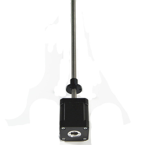

No bearings since it is a linear screw, not a ball screw. As far as I can see all the movement is coming from the lead screw nut and/or anti-backlash nut. Also possible the lead screw itself is worn or out of spec. Worn would be unlikely since I only have 150 hours on the machine. I think the lead screw nut and anti backlash nut are custom.
No coupling on the Z-plus motor, it is a direct drive captive screw motor like this one (couldn’t find the Nema 23 version, but same thing) :
