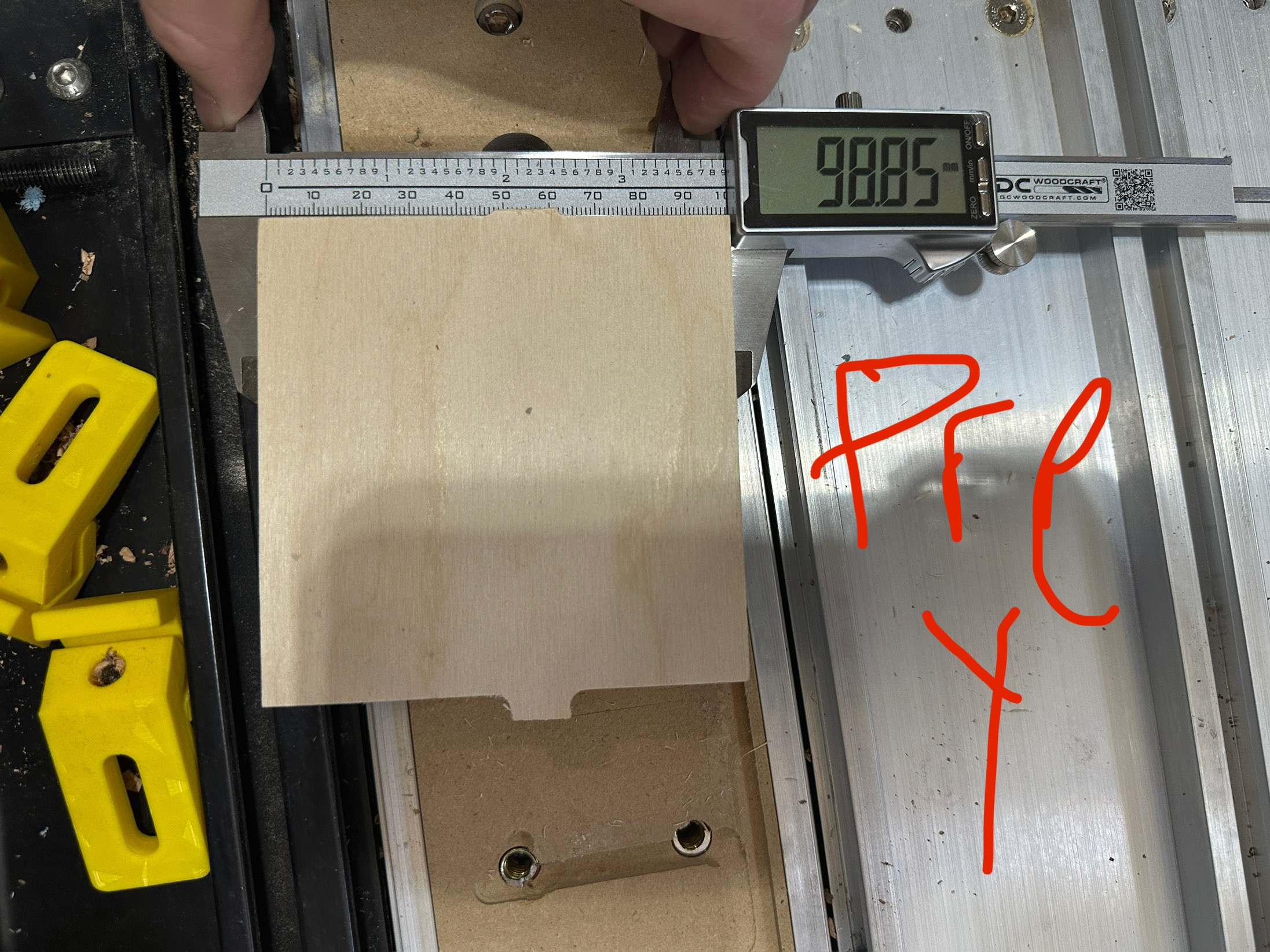

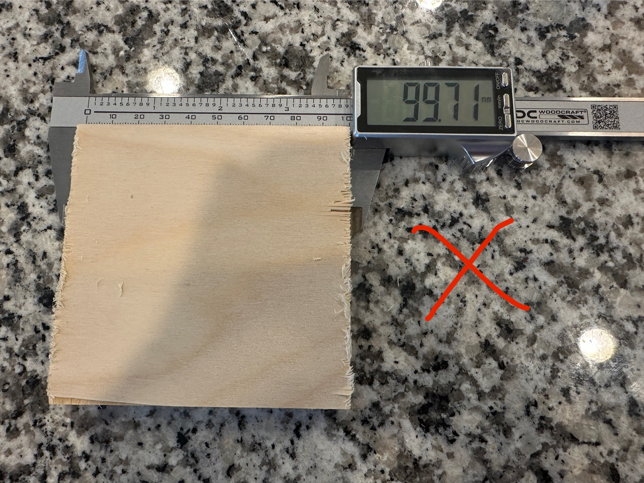

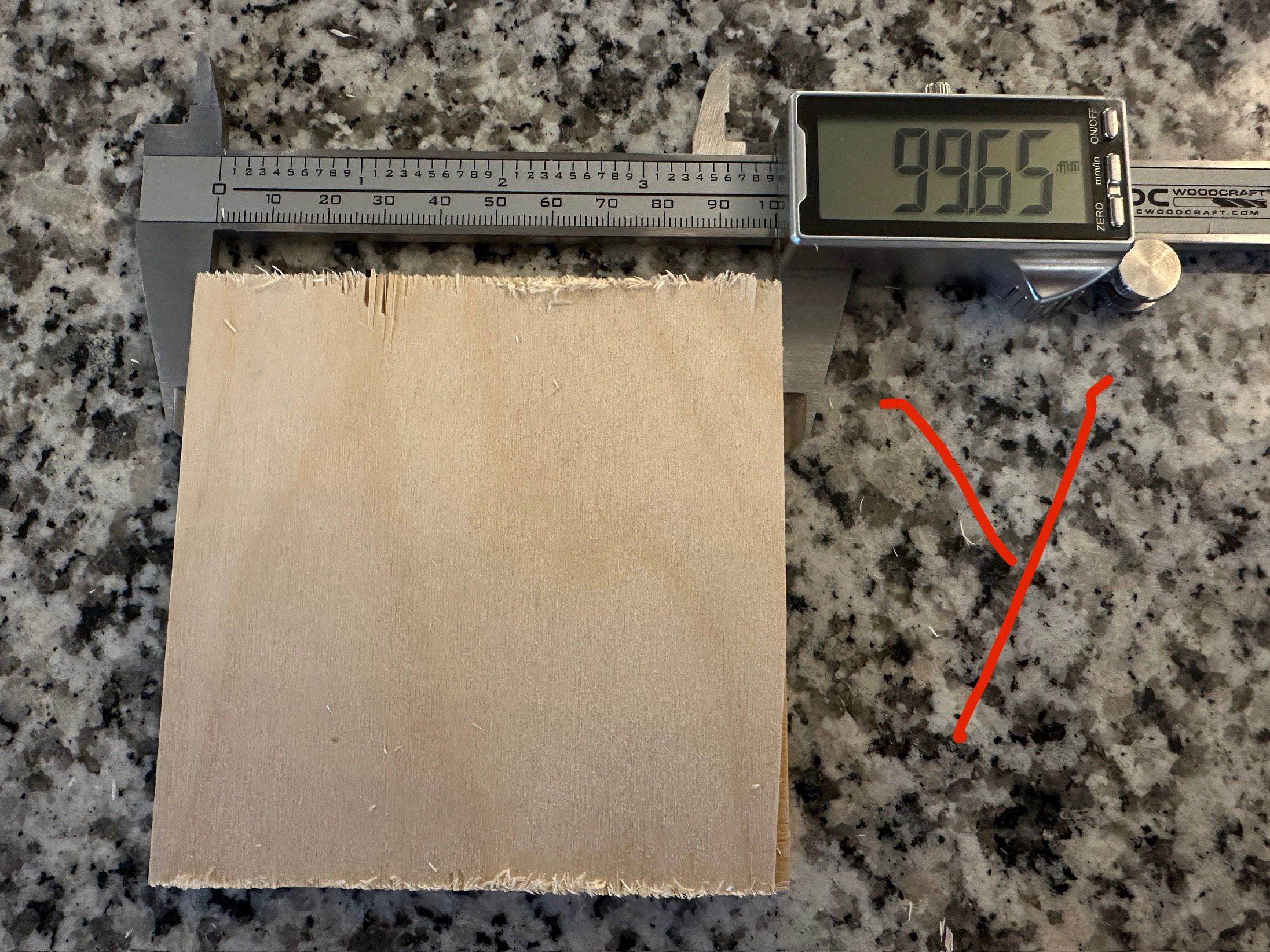

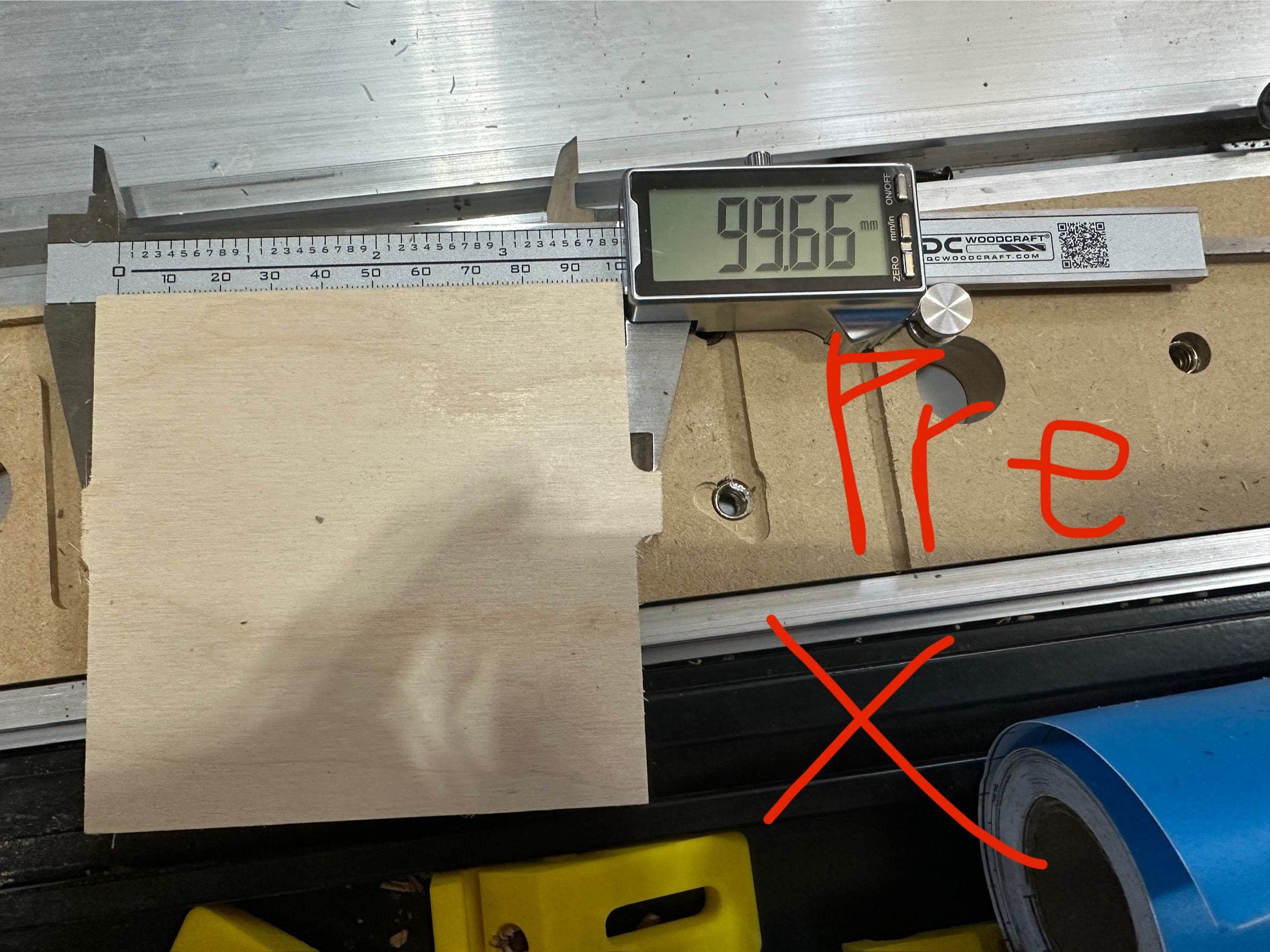

So I am trying to dial in my CNC. I am working on cutting a perfect 100mm square. I reached out to support, but I know they are out.
This is what I have done so far:
Remove all the slats and made sure the diagonals were equal (they were).
I went through https://www.youtube.com/watch?v=cb9RR2KZTHM and tightened everything and made sure it was all clean. The only part I didn’t adjust was to make sure the bearings were sliding equally.
Before I did this the numbers weren’t great. Attaching photos pre the changes and after. Any ideas? I cut the second piece twice and got the same numbers.

You are 0.0015” longer on one axis. That small of a difference could be caused by multiple things from bit deflection changes, to a piece of that fuse being in the way. And also an inconsistency in the calipers.
I’d rule out bit deflection first and do a contour with tabs and .020” stock to leave then do a finishing pass to reduce deflection.

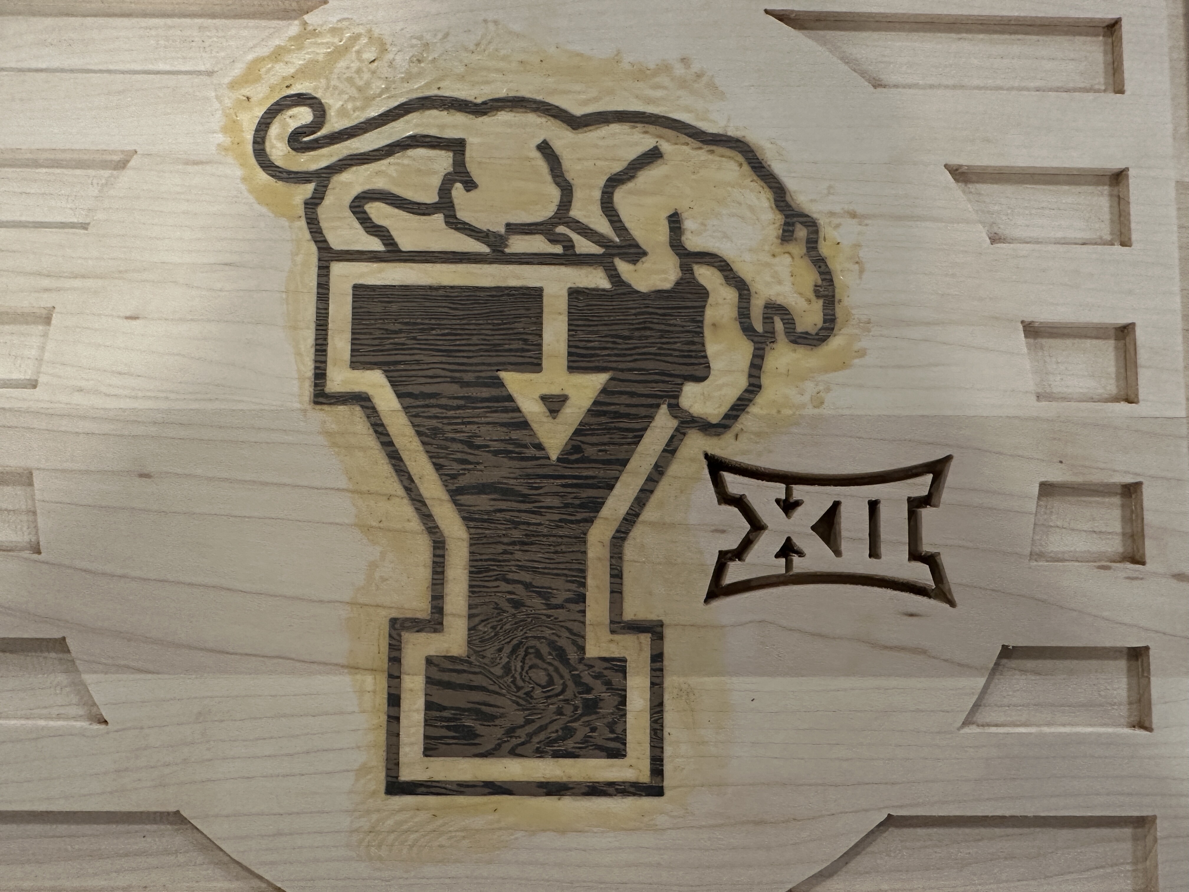

I went with the suggestions and the inlays have been solid. Need to clean off the glue but here is an example.
Thanks everyone for your time and thoughtfulness!
