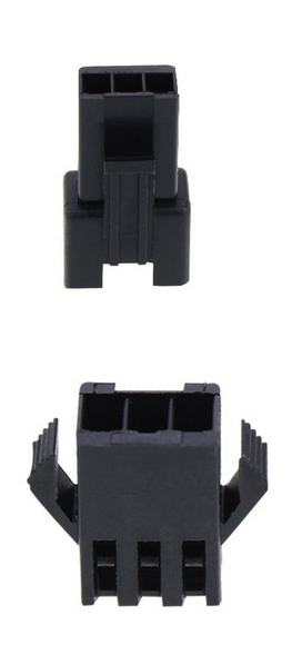

  • From the BitZero 2: Connect the male JST-XH connector to a female JST-XH pigtail with a crimped on male JST-SM connector.
  • For the 3D Touch Probe: Crimp a male JST-SM to the end of the supplied wiring.
  • For the wiring to the controller: Crimp a male JST-XH to one end of fresh wires (goes to board) to a female JST-SM connector (will connect alternately to either male JST-SM on either probe).
JST-SM are snap connectors and I’ve found them fairly decent for quick changes. EDIT: image was showing the 2-pin connectors.
